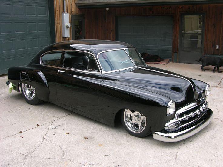

That is a shared observation, Bill, but I suppose the same could be said for a vast number of kits across the entire brand spectrum. To quote a famous physicist, "it is what it is".
I really like the car so I've got to deal with the kit. I just scored another one on Fleabay this weekend ( planning a custom for that one. The Fleetline can be such a wicked cool custom) so that says something about my capacity for pain and anguish

Exactly...and an accurate rendition of your example in scale would be a show-stopper.  :D

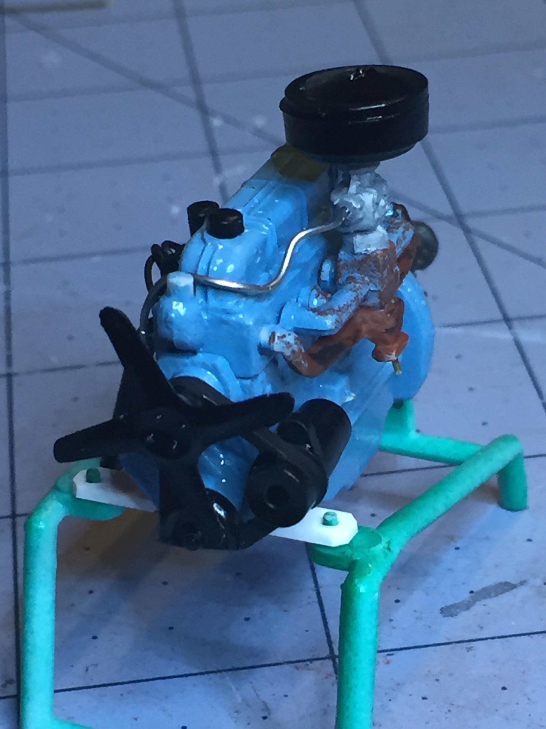

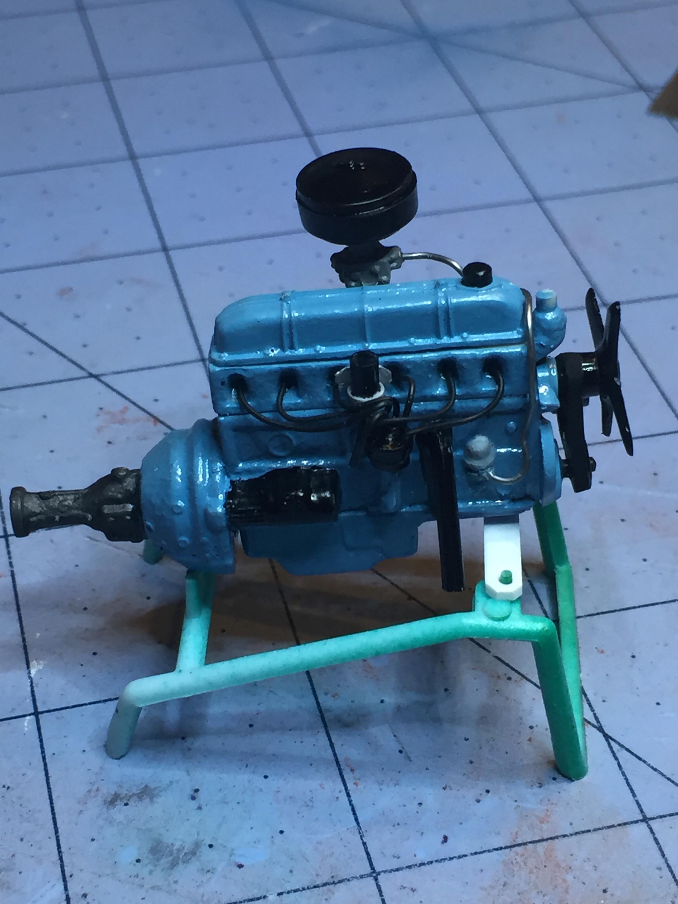

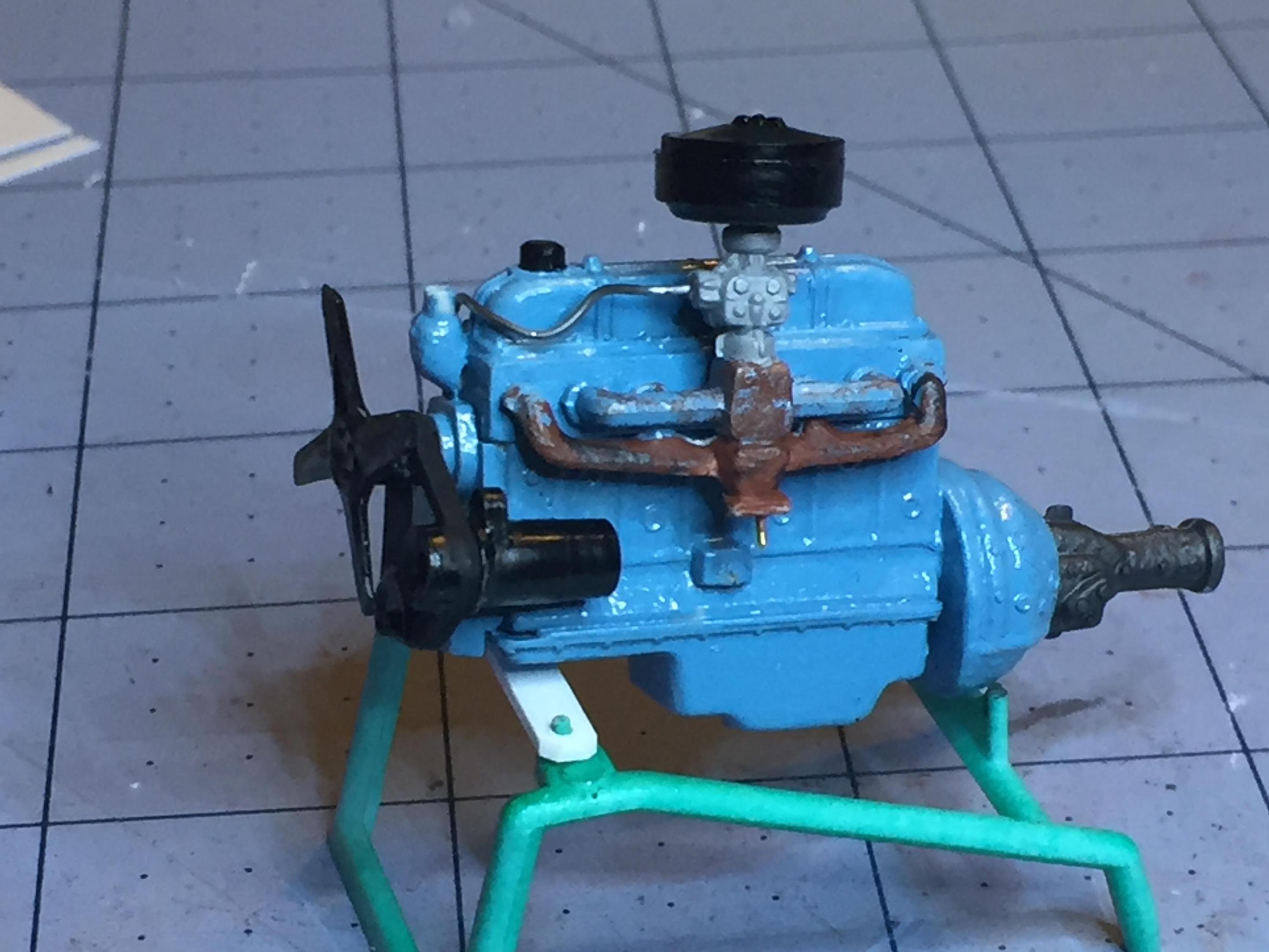

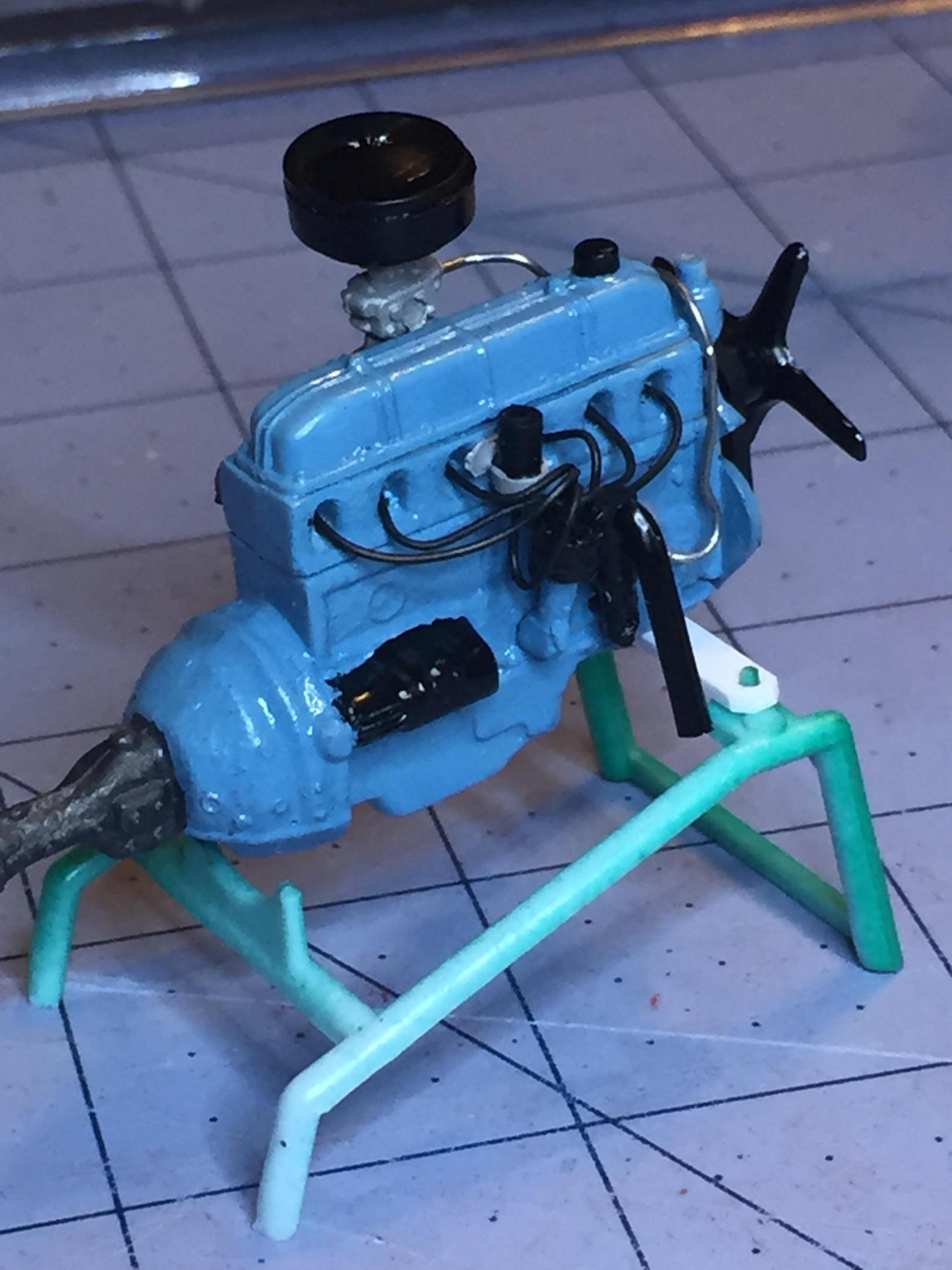

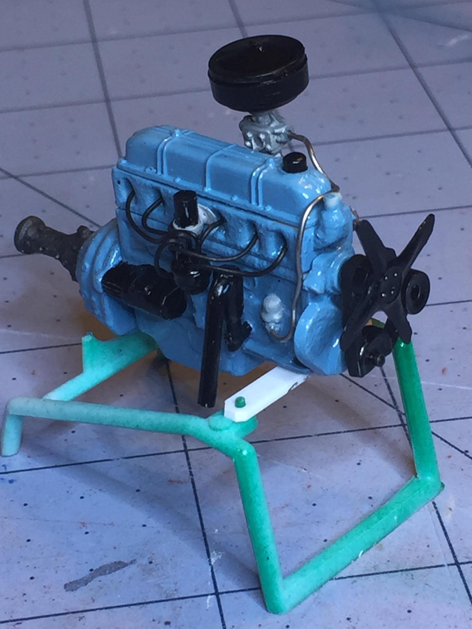

Here's the ol' Stovebolt in stock drag. As soon as the paint cures a little more I'll be washing with some brown and black stuff to give it a little age. The transmission looks way too small,, doesn't it?  The crankcase is badly formed.  Instead of having a boss for the distributor as part of the crankcase they made the boss like a stalk, a separate part like it was part of the distributor. Really goofy. They figured kids wouldn't know the difference. Good thing I'm not a kid, huh?   I believe they should have provided an oil filter but, because it was a dealer-installed option ( thank you, Greg ), they didn't so I guess I'll have come up with it somehow (you know... builder installed ? ) According to many photos I find on the Web, the air cleaner isn't right either. W T F?  Sorry....thanks for checking in  ?
IMG_5225.thumb.jpg.34e539b0473d13e93e1b34378d84fdef.jpgIMG_5227.thumb.jpg.b60f3daa5547b0e70368167a4c1c4c64.jpgIMG_5228.thumb.jpg.e35e07690fc6619c13d7e582daf3c9e1.jpgIMG_5230.thumb.jpg.e1d9b3830e2a495e2e6e564e3838c6ff.jpgIMG_5231.thumb.jpg.fff39192565af8c8b3a56ee0717c2d10.jpg

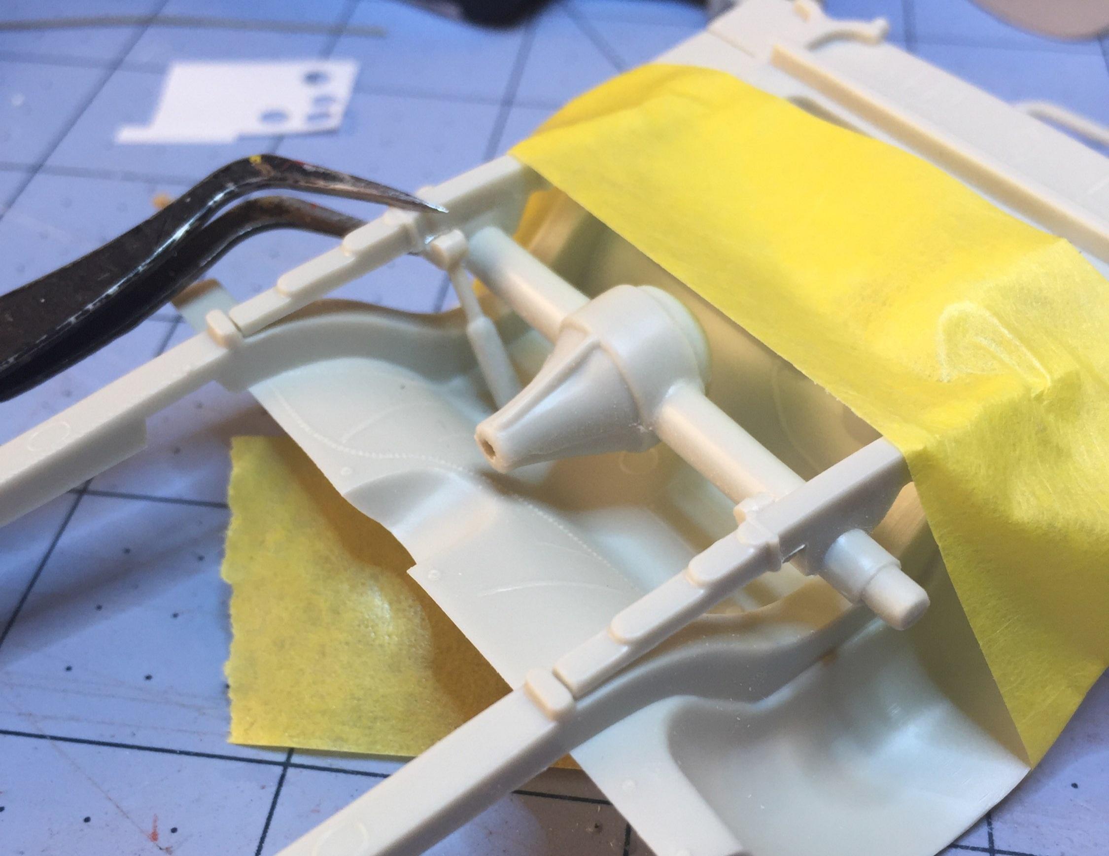

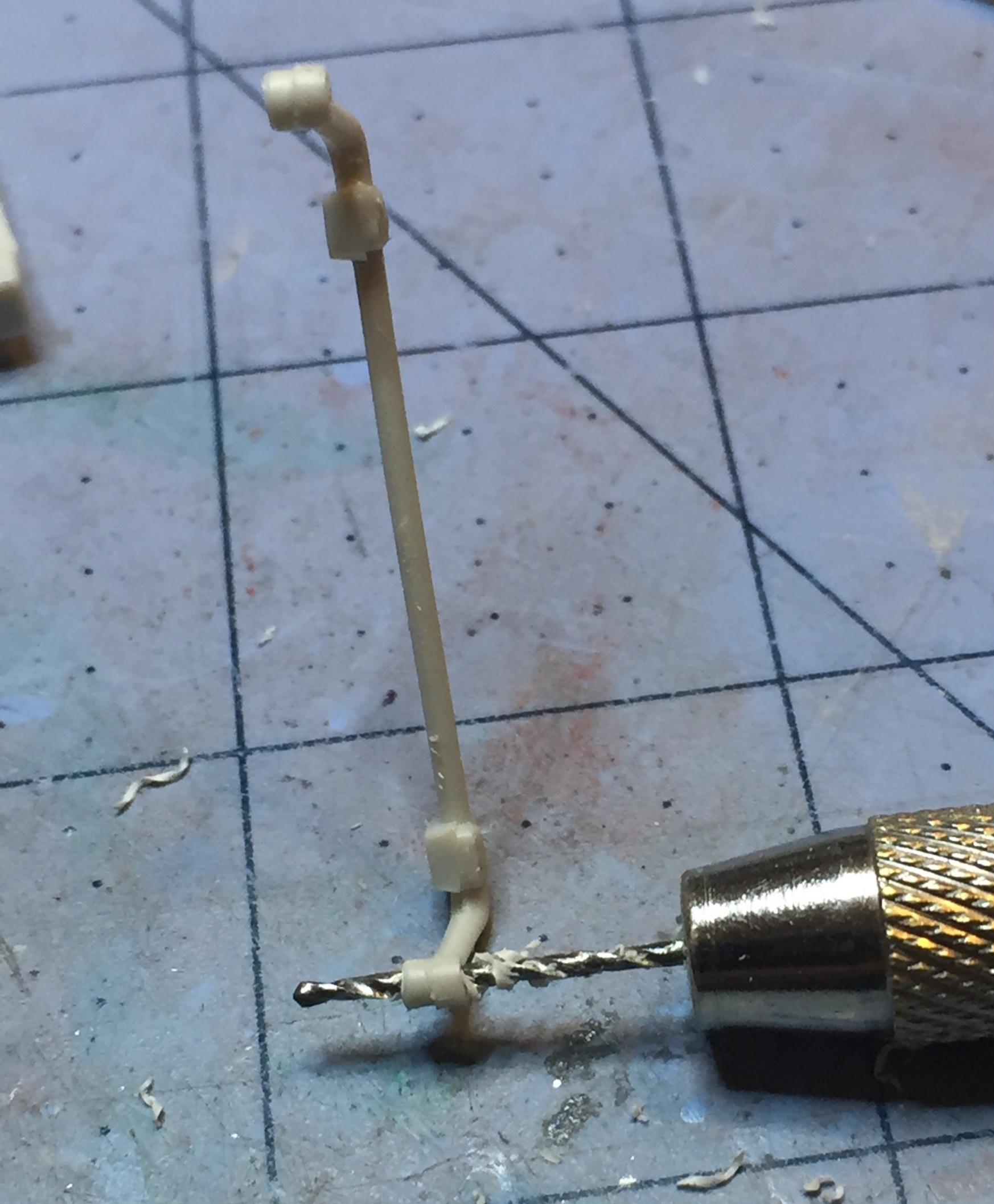

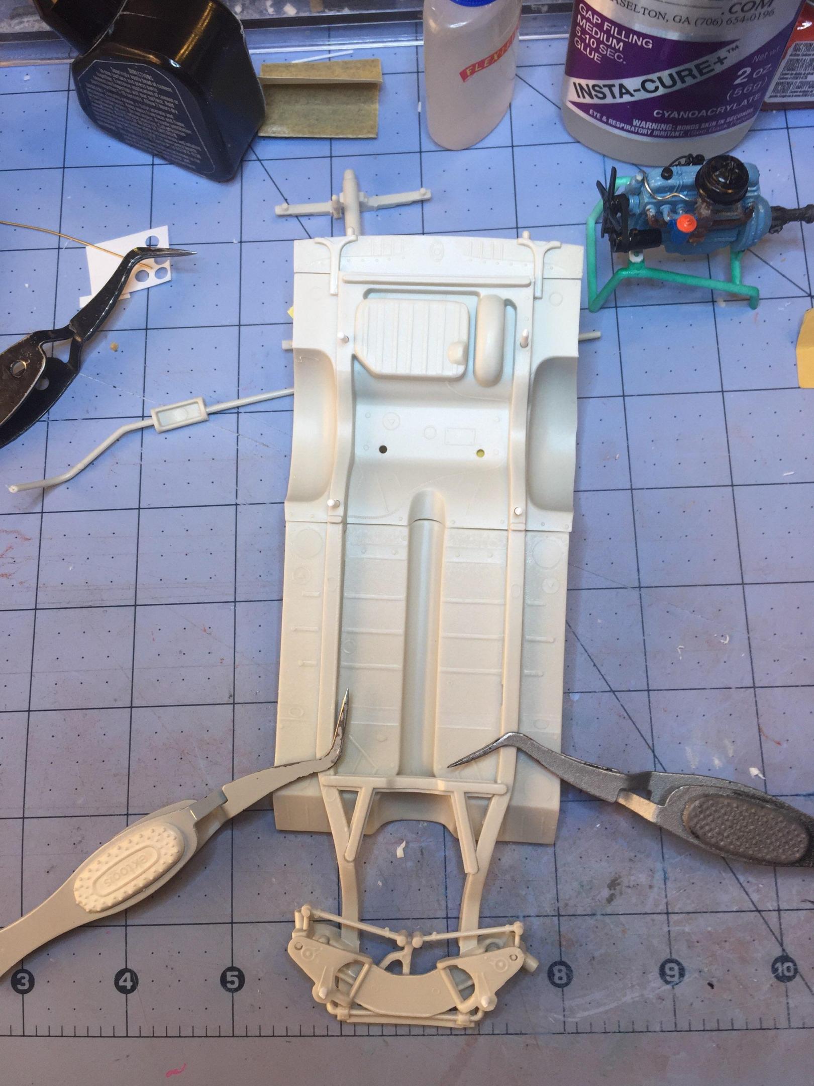

I figured I'd get the chassis assembled so starting with the front suspension seemed like it would be fun. It was not.  The parts fit is fiddly and difficult to to assemble. Because I did not want to paint everything first, I needed to ad lib and I'm sure glad I did. Anyway, I got the lower control arms, coils, and stock spindles all in place, leaving the spindles to swing free. They will be glued later. The instructions call for the wheels/tires to be mounted on the spindles and then assembled to the control arms . You can probably do it that way by forcing the spindles into place after assembling the the rest of the suspension first. The fit is pretty loose.  The spindles are just crude square blocks with round pins and the wheels fit on the dowels and are retained by rings. I glue my wheels, I don't like wobbly wheels.
Then I got to the sway bar ? .  They made it with the links pointing the wrong way.  Or maybe the anchor brackets upside down. Whatever. I had to fix it and I don't like how I did. I cut the links off and drilled out the bar ends so I could insert new links pointing the other way.  It was a big mistake to use solvent to glue the new links to the bar ends. They split open. Should have used CA. Next time I will make the links more to scale and kill two birds. The pictures tell the story. Thanks for not laughing. (Oh...go ahead ?)
IMG_5232.jpg.23a51fc88f495686be3ceaededb96f5d.jpgIMG_5233.jpg.3a20259e5563ff7f057491933872814c.jpgIMG_5235.jpg.12d29e2b844ce9e570a056e039674a46.jpgIMG_5234.jpg.26c011f519d20f04fa75809f4ccb90c7.jpg

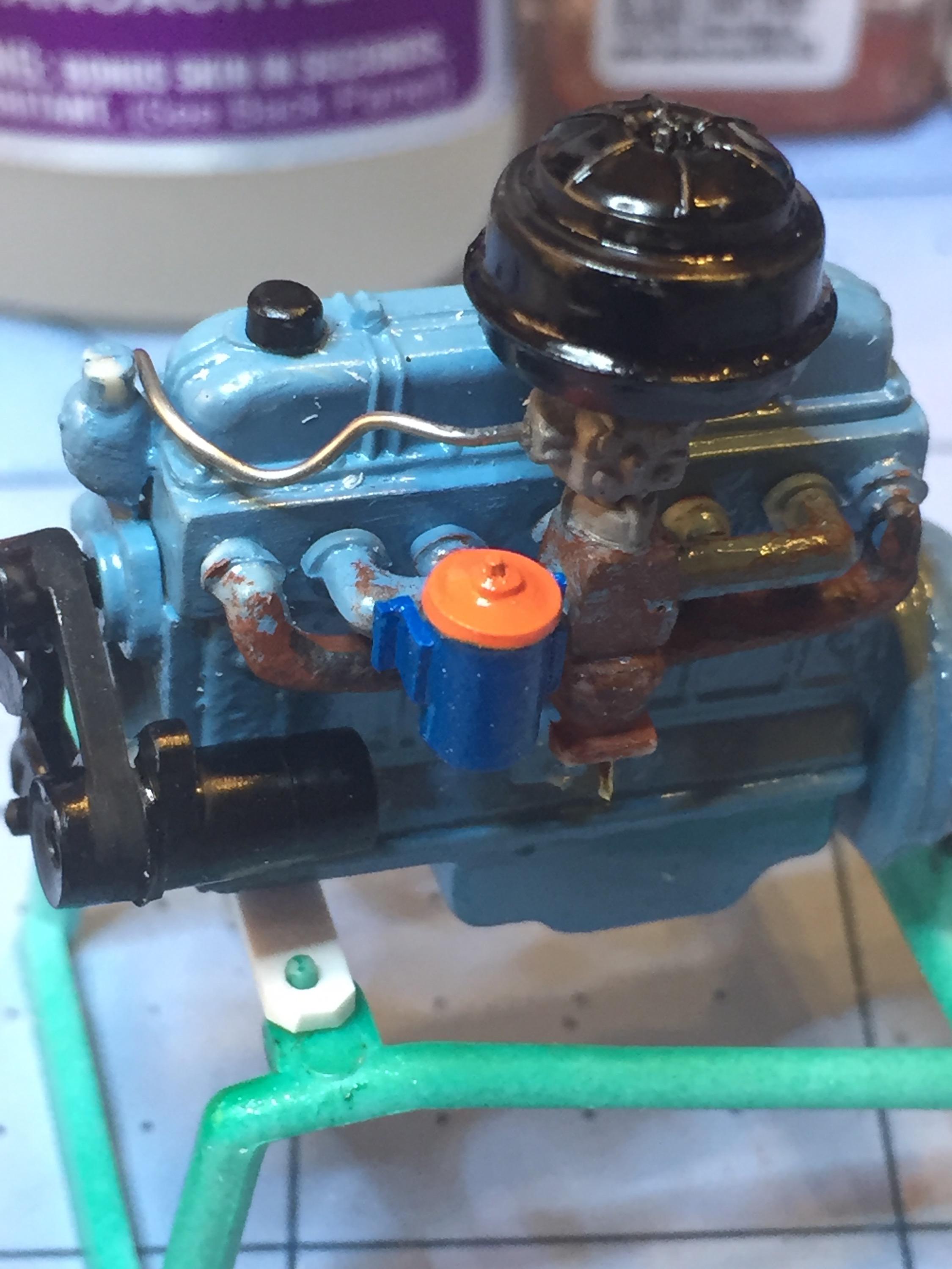

Here's a remote oil filter on a '41 Chevy six. Can't remember which kit had it but a simple scratch build is possible. It seems these colours were the way they were back then.
When scratch building things like this, don't overlook clear lenses or clear red tail lights, once painted they can look right!

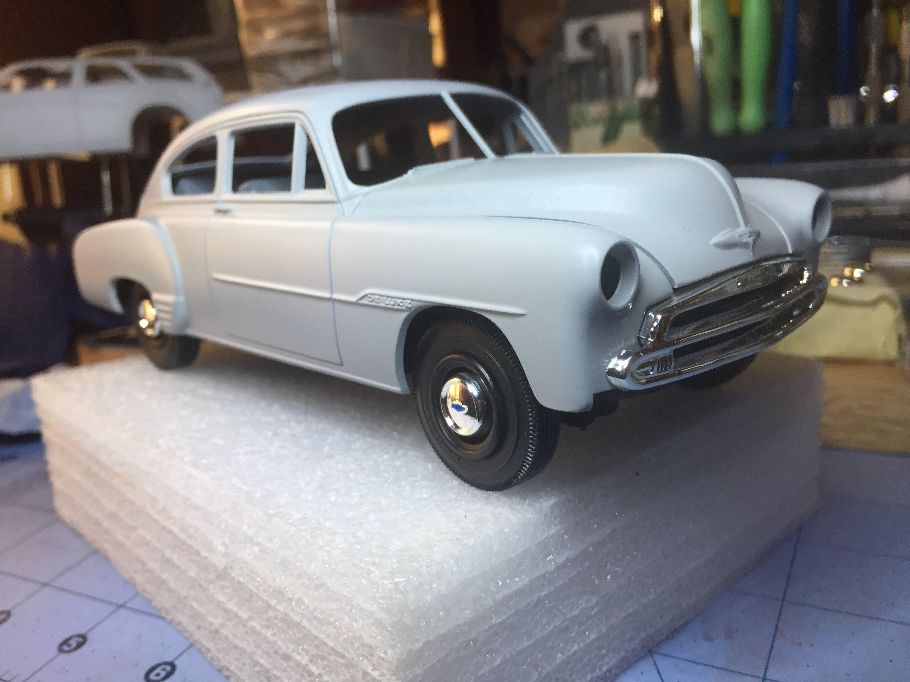

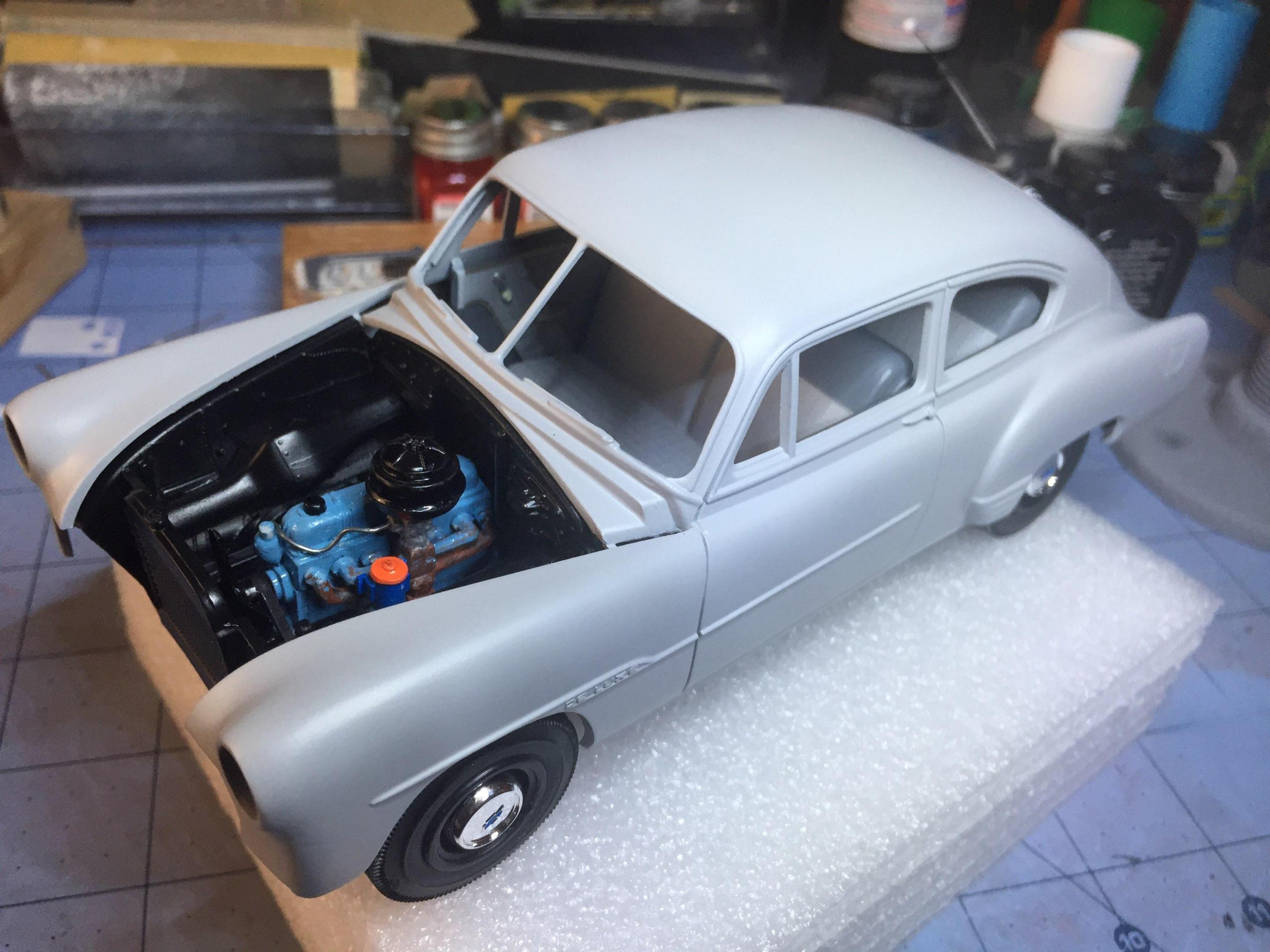

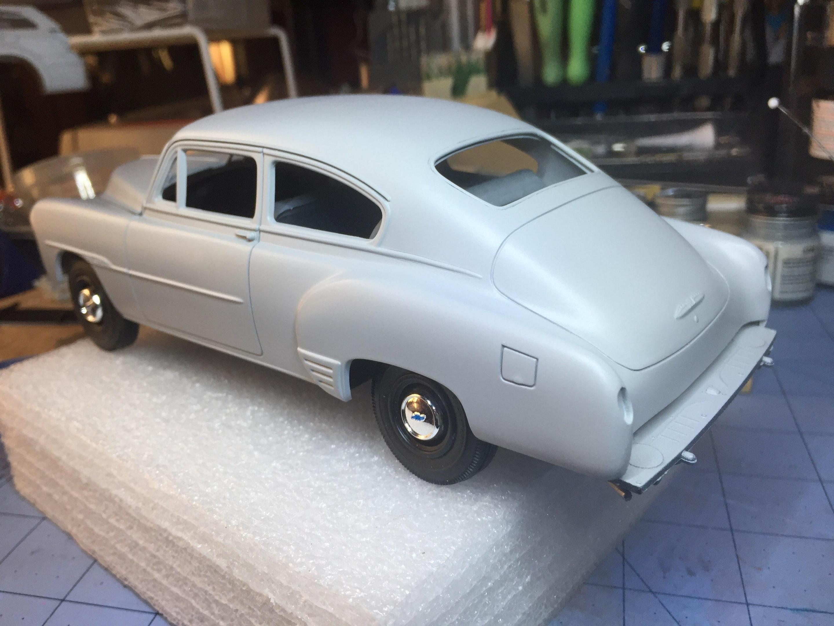

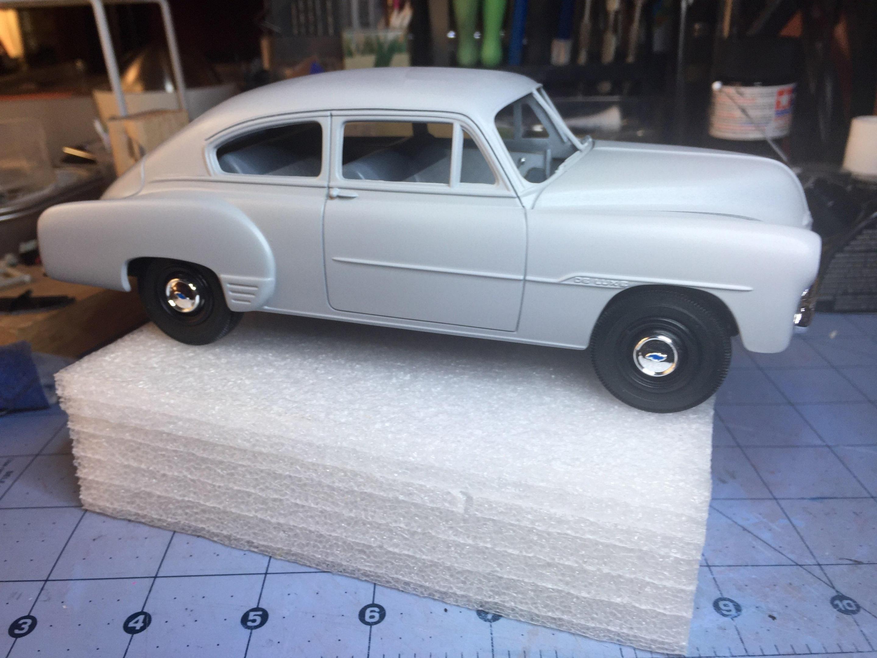

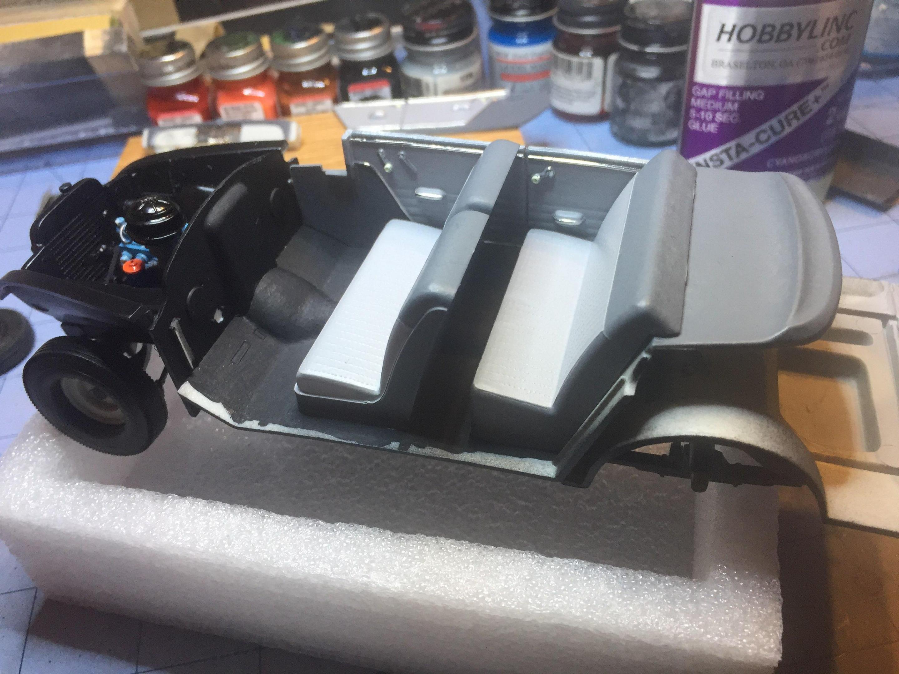

Moving along with the chassis, exhaust system,  and rear end, and the interior, I figured it was time for a mock-up since I had the body ready for paint (almost- I spotted a few glitches that I may or may not try to smooth out). I should have the dash completed in a few days but it's just waiting on guage faces.
Just an FYI on paint. I obtained 5 "jars" (?) of Revell Aqua Colors to see what that was all about. First, I gotta say whoever designed the containers has never, ever used paint and probably graduated from some tech college in East Germany at the bottom of her class.  I have made a habit of cleaning my paint bottle threads and caps to prevent difficulty opening them.  I'm afraid, with these strangely designed vessels, that will be way too difficult for my.....somewhat compromised dexterity. So no more of that, I don't need another paint spill in the dining room.  And just so you know, I'm not real crazy about Tamiya bottles either. Even if I liked this water based paint for models, the cans(?) are the deal killer. Thanks for listening ?.

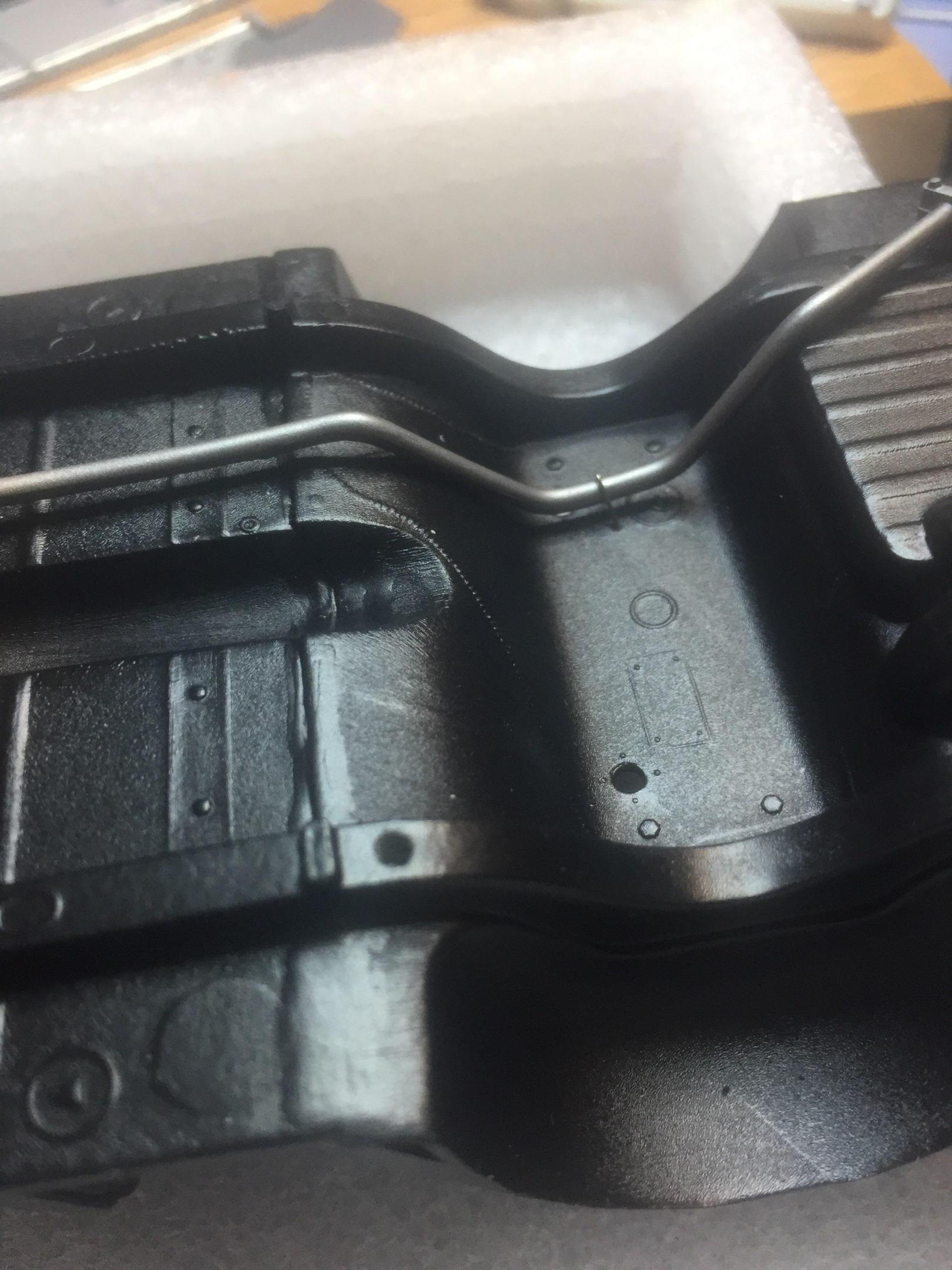

I wired the tail pipe to the floor and cut about an eighth inch off the manifold end to get the system up tighter against the bottom. I pinned it at the manifold. The pipe was painted with MM metalizer "magnesium ". Soon it will be no more. ☹️

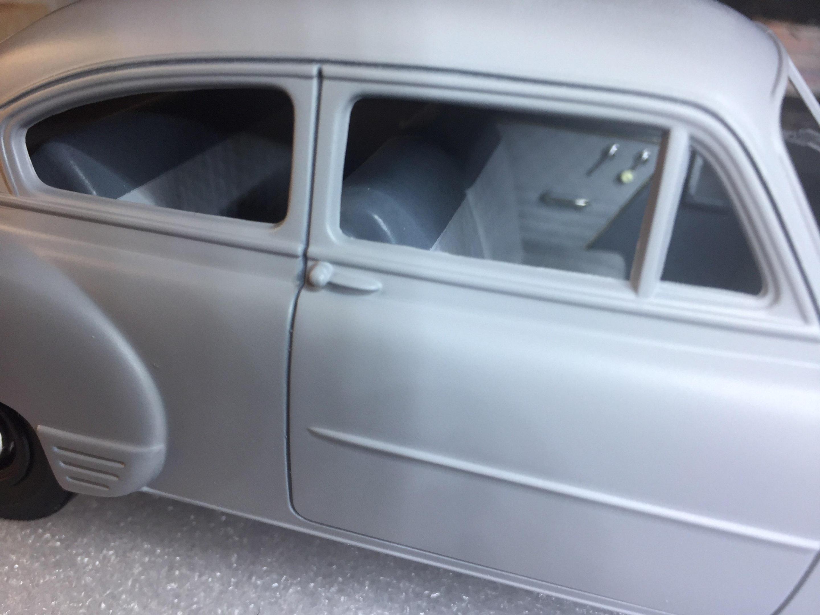

The interior is just primer gray.... nothing to see here.....
The inner fender/ firewall/ radiator/air ducts thing is a bit askew but it's staying that way as a reminder ( I scored another one of these kits )  it's not obvious to the casual observer (I hope)
IMG_5256.thumb.jpg.bf61d50221740280c635954d348dd1ef.jpgIMG_5257.thumb.jpg.a9cf1475b02a99508cd38726b9ab7051.jpgIMG_5254.thumb.jpg.108622c7740264e0805a9b375bc030b7.jpgIMG_5252.thumb.jpg.c030339d425e6844976dfab28eeacc5a.jpgIMG_5255.thumb.jpg.efc33756d6d568c36315c207234e9175.jpgIMG_5253.thumb.jpg.2f73972d4cdce88edcee7e5c2c3689eb.jpg
I think there's a slight twist affecting alignments but it's too late to fix it now ( I don't care ?). Thanks for looking!

A lot of work but the payoff in the appearance now has to be worth it.
