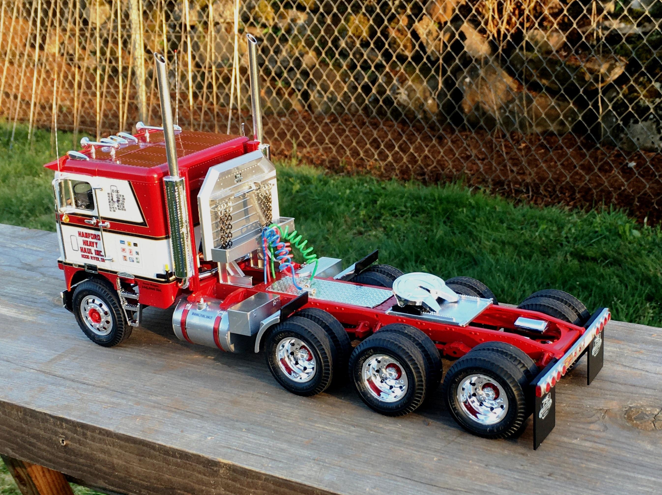

The after market tire sets they sometimes don’t touch the rimes.  They don’t look realistic being not looking like realistic.
The top being narrow. Please any ideas?

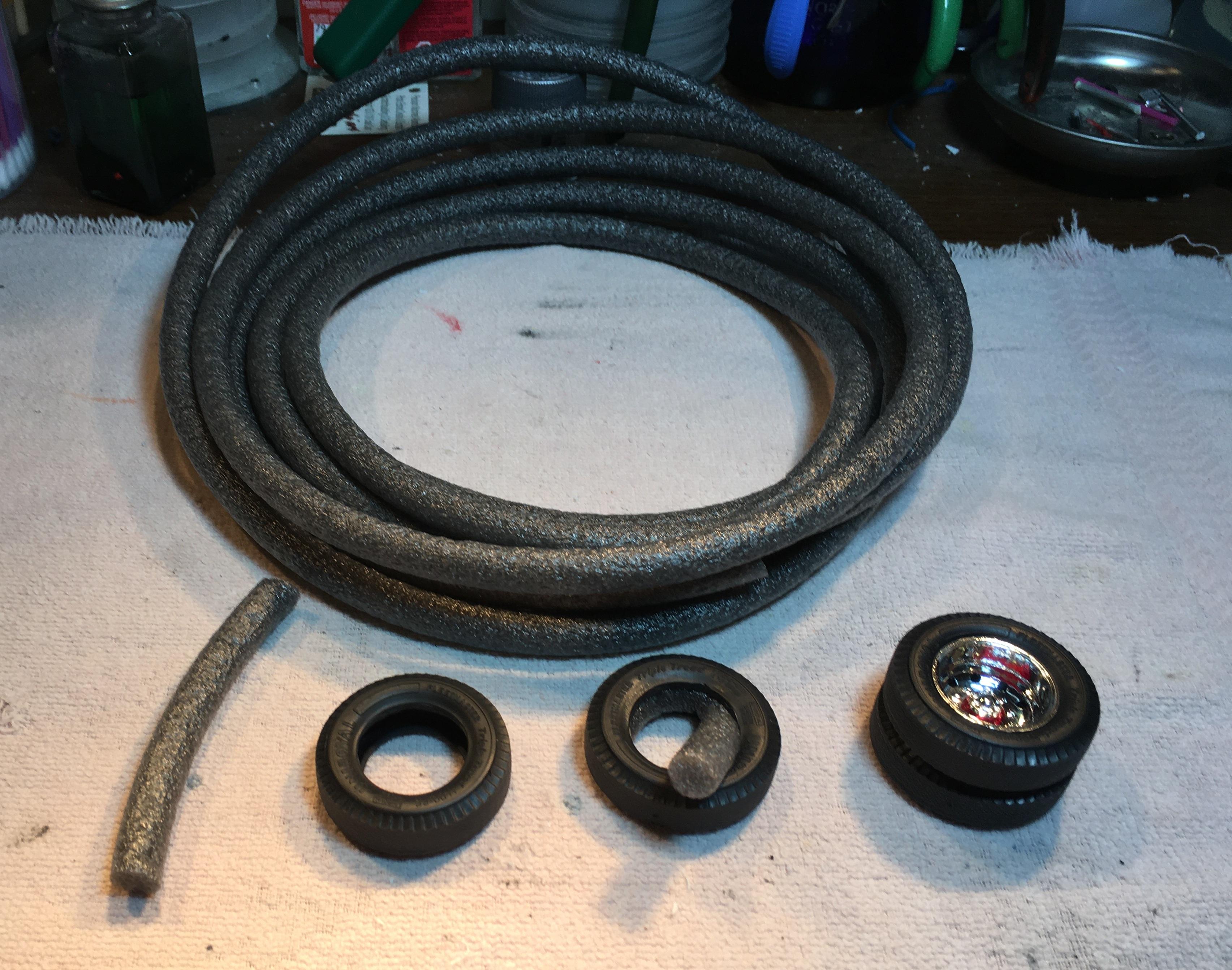

Carl, not sure if I understand your question. Do you mean that the bead area of the hollow tire is too narrow?  If yes, then like others mentioned, stuff the inside of the tire with something. I use a foam rubber insulation rod which is sold in various diameters in hardware stores.  It is similar material to pool noodles, but it comes in a solid diameter "rod"  It can easily be stuffed inside the tire to spread out the sidewalls.
Edit: It is actually called "closed-cell foam backer rod).
It can be trimmed if needed.
