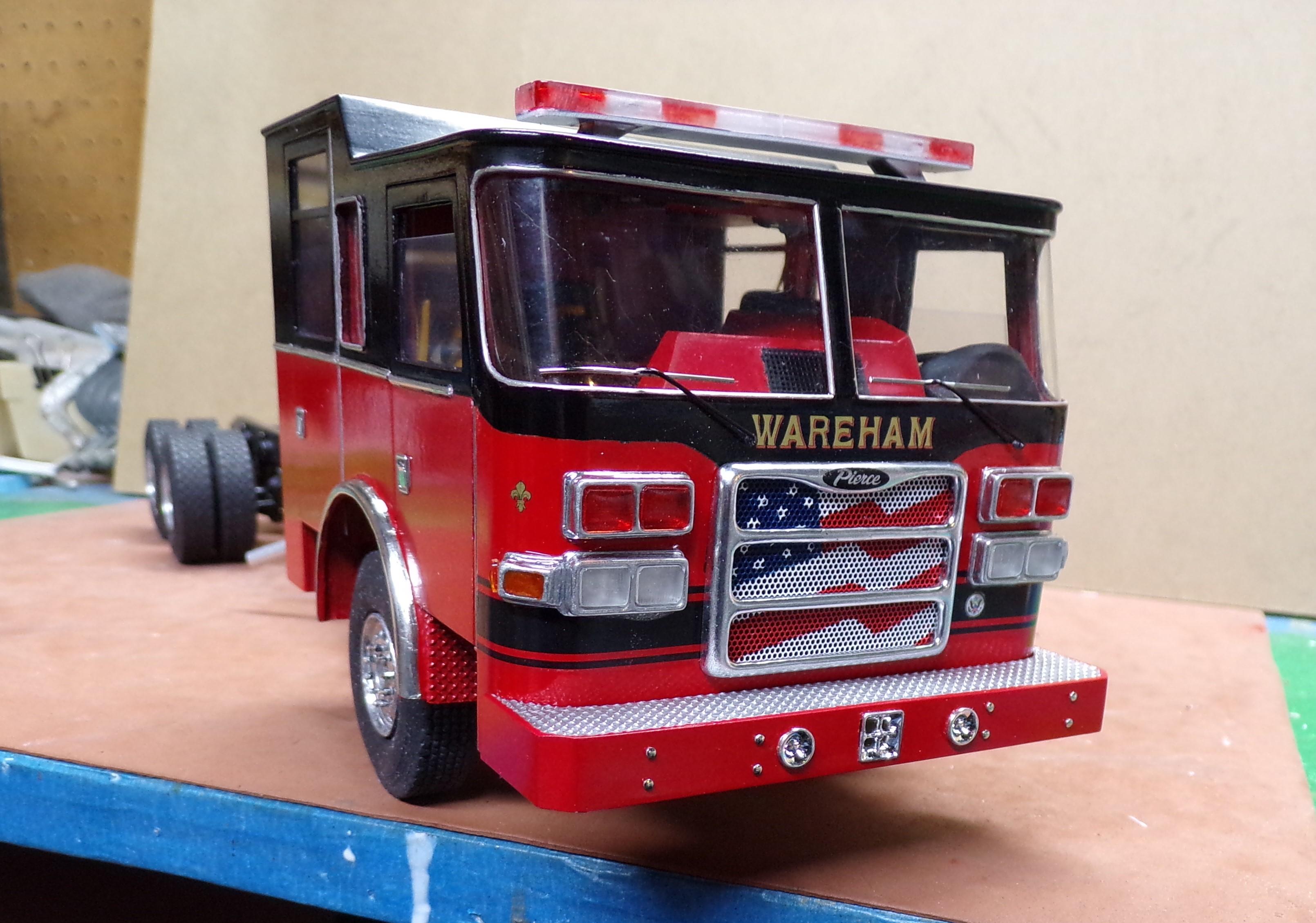

I'm fortunate enough to have an ALPS printer for decal work.  Not only does it print gold and silver but it prints white also.  The front of the Pierce has some gold lettering with a drop shadow that was done simply by copying the gold part and changing the color in the graphics program.  The printer knows which colors to select based on what is on the screen.  The fluer de lis and "Pierce" on the grill were also done on the printer.096.thumb.JPG.5a4328e0776d2e629df8306161d83a61.JPG
Your decals look great.  It is good you have the alps printer and the  skills to  use it !  I don’t think I can pull off letting like that with my ink jet printer.

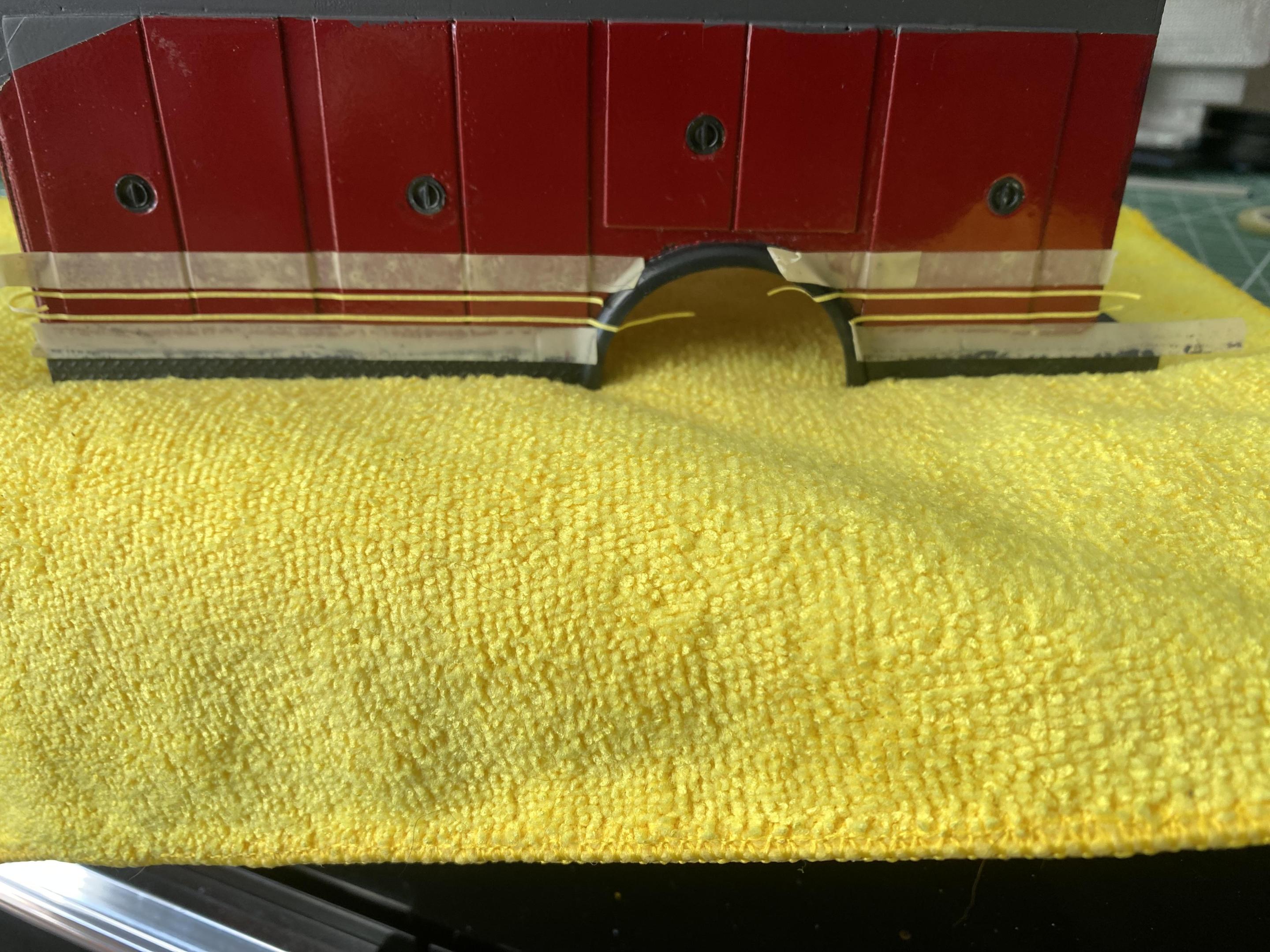

That is a hard thing to do, especially if there are continuous pieces that are separated by the wheel wells and cab.  Had the same thing with the decals I did for the Pierce cab.  Ended up taking the stripes off the rear doors to re-apply the decals.  Just a little difference is noticeable for sure.
Link to comment
I would have preferred a decal, it would have been  much easier. And you are right the wheel wells made it more difficult to  line things up.  For the cab I didn’t glue on the fender extensions making it easier to run the tape across the opening.  The box on the other hand I had  glued the Fender extensions on  prior to paint which made it much harder to line  it all up. I should have put more thought into that !  I wish I could have done it with decals, it would have saved a lot of time, and like you said, you  could take them off and re apply. With the paint it would be a project in itself to remove them. Some of the bleed through did come off with polishing compound. It is amazing that to my eye things look   pretty good, but then once a photo is taken and posted here, the flaws  really show  up so much more! Too bad I don’t have the eyesight I had 50 years ago.

I have a similar issue with 1-2mm stripes over a compound curved contour and you made me wonder if it might be easier to cut a wide band of tape rather than try to bend a thin strip over an edge. The cut edge  would stick better too and reduce bleed, gonna try it
Thank you,  I have tried multiple  ways of taping and agree the thinner tape has many bleed through issues. Have not been able to make any further progress, bench time has been limited. Hope to get back to it this week.
