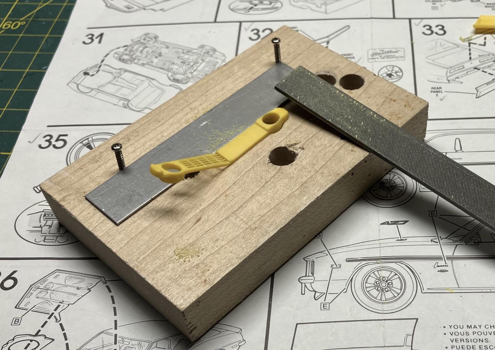

MsDano85gt Posted January 9, 2024 Posted January 9, 2024 Something I do regularly, but does get messy, but yields such a much better detailed model with more realistic looks is to remove material from.the backside of Grilles to open them up here is my latest. 82 ford bronco grille, thus can be done to just about any type of grille or wheels! There's 3 different ways of doing this as well. 1) Drexel or power rotory too (makes the process much faster, but very easy to melt or damage the part) 2) sanding part flat on sandpaper 3) (Dangerous) use no.11 blade to work back and fourth and scrape the material and flake it off everywhere! [Technique inused in photos] 6
NOBLNG Posted January 9, 2024 Posted January 9, 2024 Nice work Daniel.? If the grill is flat rather than curved, a file can be used. That’s how I did this ‘69 Camaro grill. 8

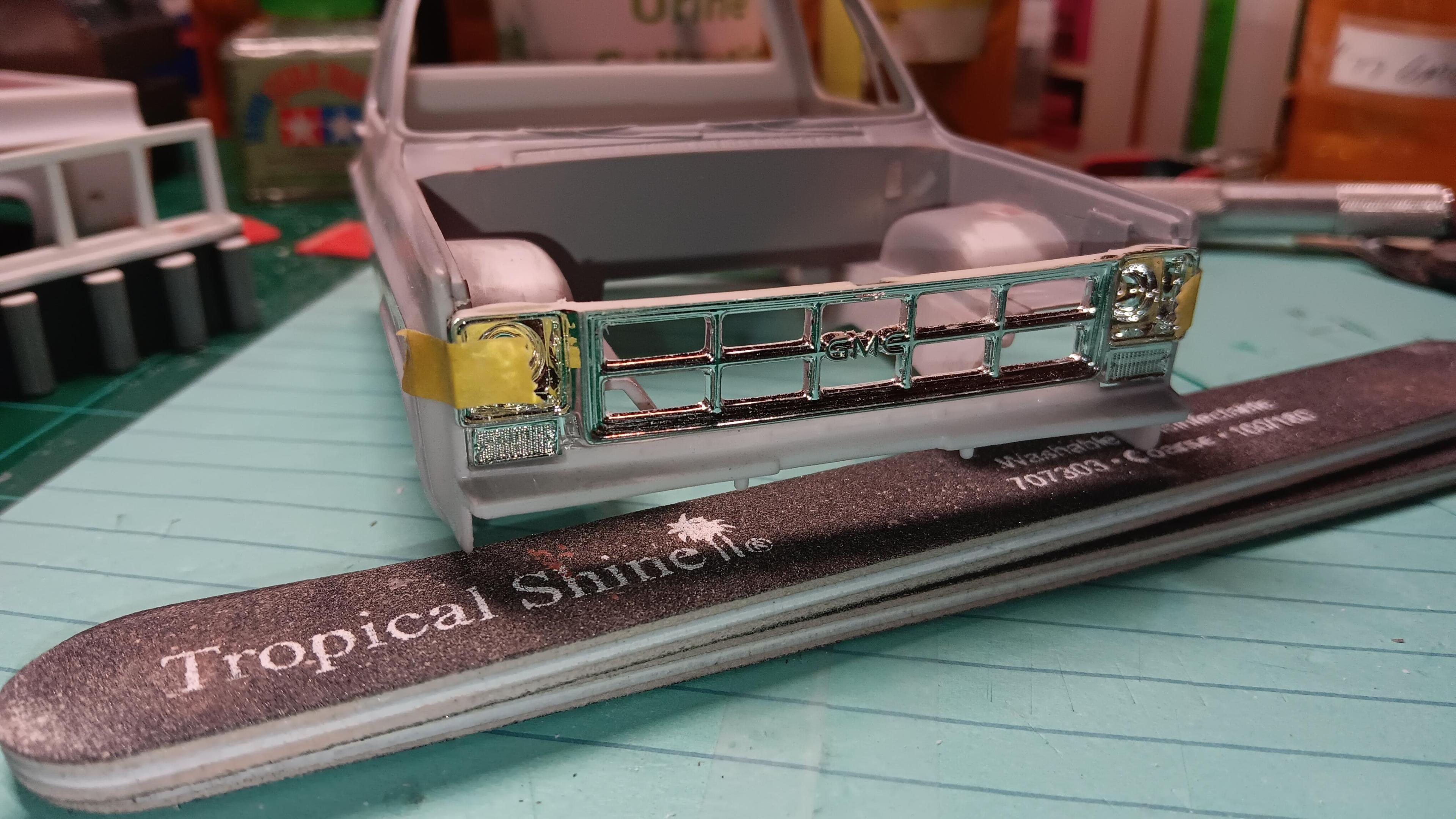

Dr Crapologist Posted January 27, 2024 Posted January 27, 2024 Yeah, these efforts produce effective results. I had a rheostat box (where did that go?) that I could plug my dremel into so I could dial down the rpm and get more precise and not melt the plastic. I also wrap/glue sandpaper around a block eraser for getting into corners. The Xacto flat chisel blade #17 works well for scraping. Depending on how much component detail you've got behind the grille, you can paint some loose weave fabric to replicate a radiator, etc. Cheers,

bobss396 Posted February 10, 2024 Posted February 10, 2024 I just did this one on a tow truck project. The leftovers are pretty stout, not fragile at all. 3
