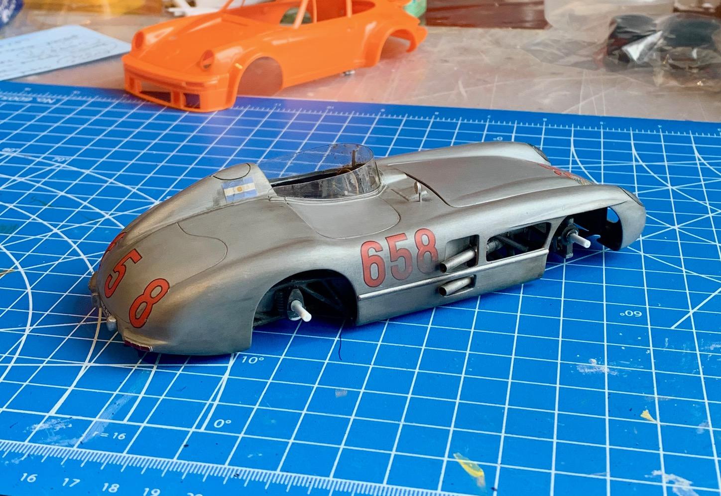

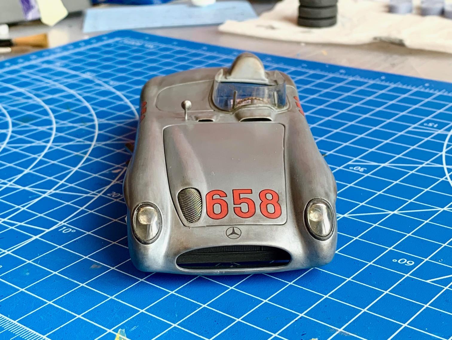

Pierre Rivard Posted March 31, 2024 Author Posted March 31, 2024 Baby steps starting the weathering. First decision was to start with a flat clear (after decals), then oiled earth wash. Step two was to simulate spills from refueling 3

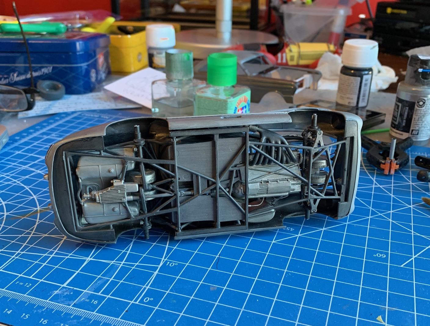

Pierre Rivard Posted March 31, 2024 Author Posted March 31, 2024 I decided to pause weathering and get the body to chassis integration finished. I did not know how much manipulation would be needed and how I could damage weathering effects so better get that out of the way. Good decision...despite countless test fitting during the build this step had to be done multiple times as more interference points popped up. Now these two are bonded for life. 3
Pierre Rivard Posted March 31, 2024 Author Posted March 31, 2024 Weathering of the underbody was done to reflect mostly toad dust accumulation. Everything had previously received dark oiled earth washes and I completed the weathering with light ochre yellow pigments. Tomorrow I will be tackling the next phase of the exterior body weathering. 3

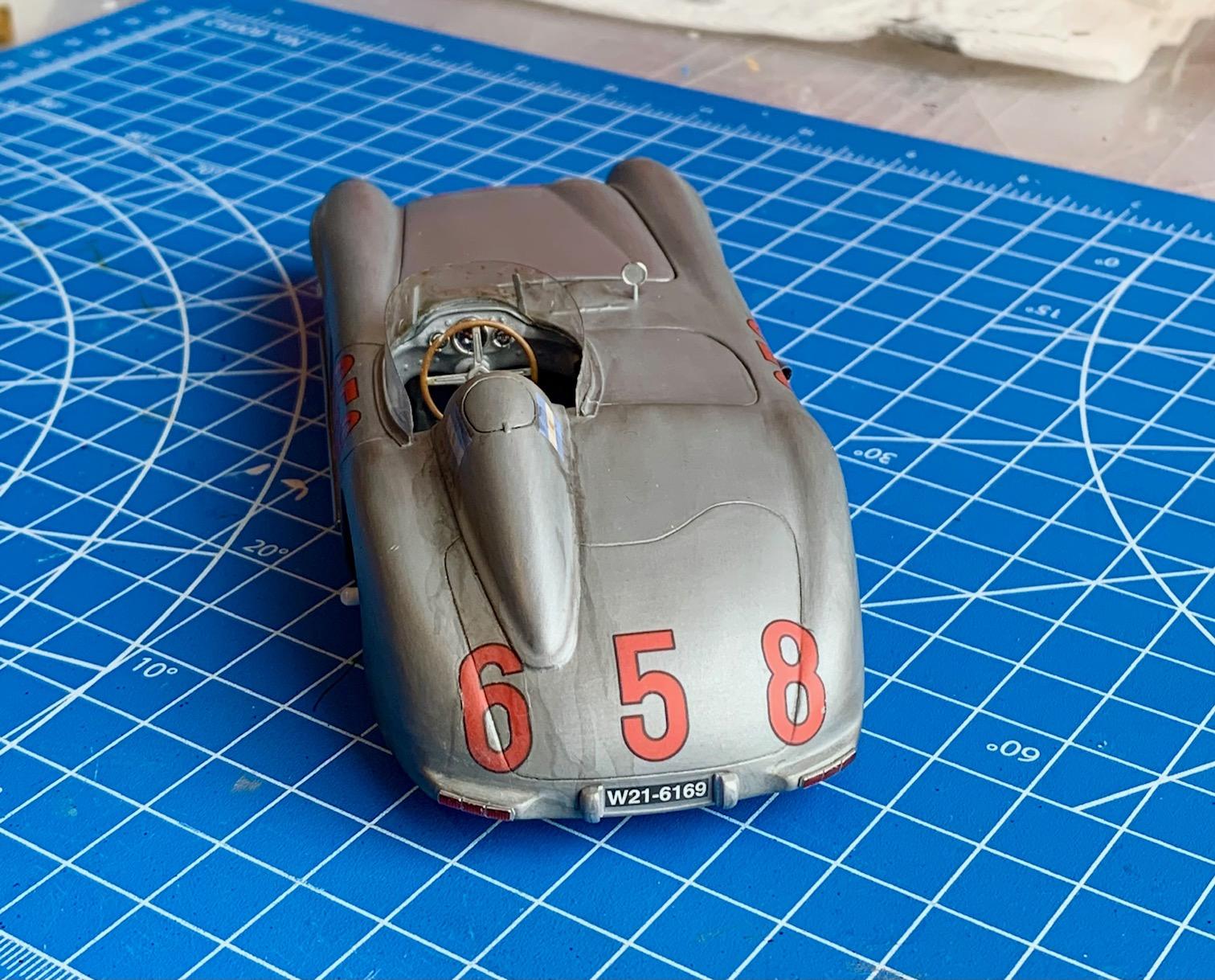

Pierre Rivard Posted April 3, 2024 Author Posted April 3, 2024 The rest of weathering... with these products...and the results. Might need to tweak some more...but could make it worse...not sure... 2
kensar Posted April 3, 2024 Posted April 3, 2024 I think it looks good. My opinion is that light weathering is better than overdone. 1
absmiami Posted April 3, 2024 Posted April 3, 2024 Do you apply the Valleyo pigments w a brush and do you thin them first ? Mite try them on my Maser …
Pierre Rivard Posted April 3, 2024 Author Posted April 3, 2024 4 hours ago, kensar said: I think it looks good. My opinion is that light weathering is better than overdone. Thanks Ken, I agree. I did touch up a few overdone areas with light slate grey pigments to tone it down and it looks more balanced that way.
Pierre Rivard Posted April 3, 2024 Author Posted April 3, 2024 3 hours ago, absmiami said: Do you apply the Valleyo pigments w a brush and do you thin them first ? Mite try them on my Maser … Personally I just like to slowly dry brush the pigments one little spot at a time. I'm still working out the technique over silver but I found it was easier to do on a red car (like your Maser?). Matt clear after decals, oiled earth wash and then dry pigments. 1

Pierre Rivard Posted April 4, 2024 Author Posted April 4, 2024 I toned down and finessed the weathering and happy with the results. So this one goes into waiting mode until I receive the set of wheels from Jason. 1
