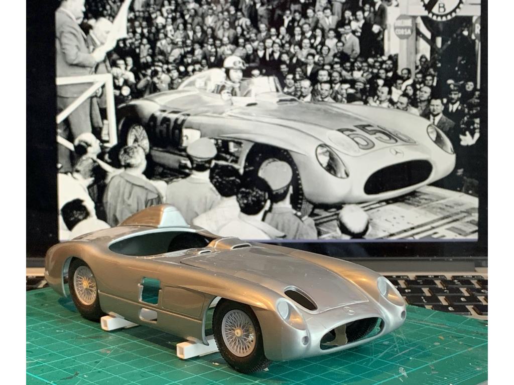

First task is a quick mock up with tires on and a reasonably good ride height and track width, then take pics of it with the real car in background, to see how the shapes compare.
The front end flows pretty good vs the real car. Some finessing and detailing but essentially the kit body looks ok to me.
Moving to other views I can se some reshaping will be needed. The rear car has a a more rounded and lower rear fender arrangement, and perhaps a bit wider as well vs the kit body. The head rest fairing is also quite different.
That's what I see and will start to work on. Please add your comments/advice if you see stuff I may have missed on. Thanks.

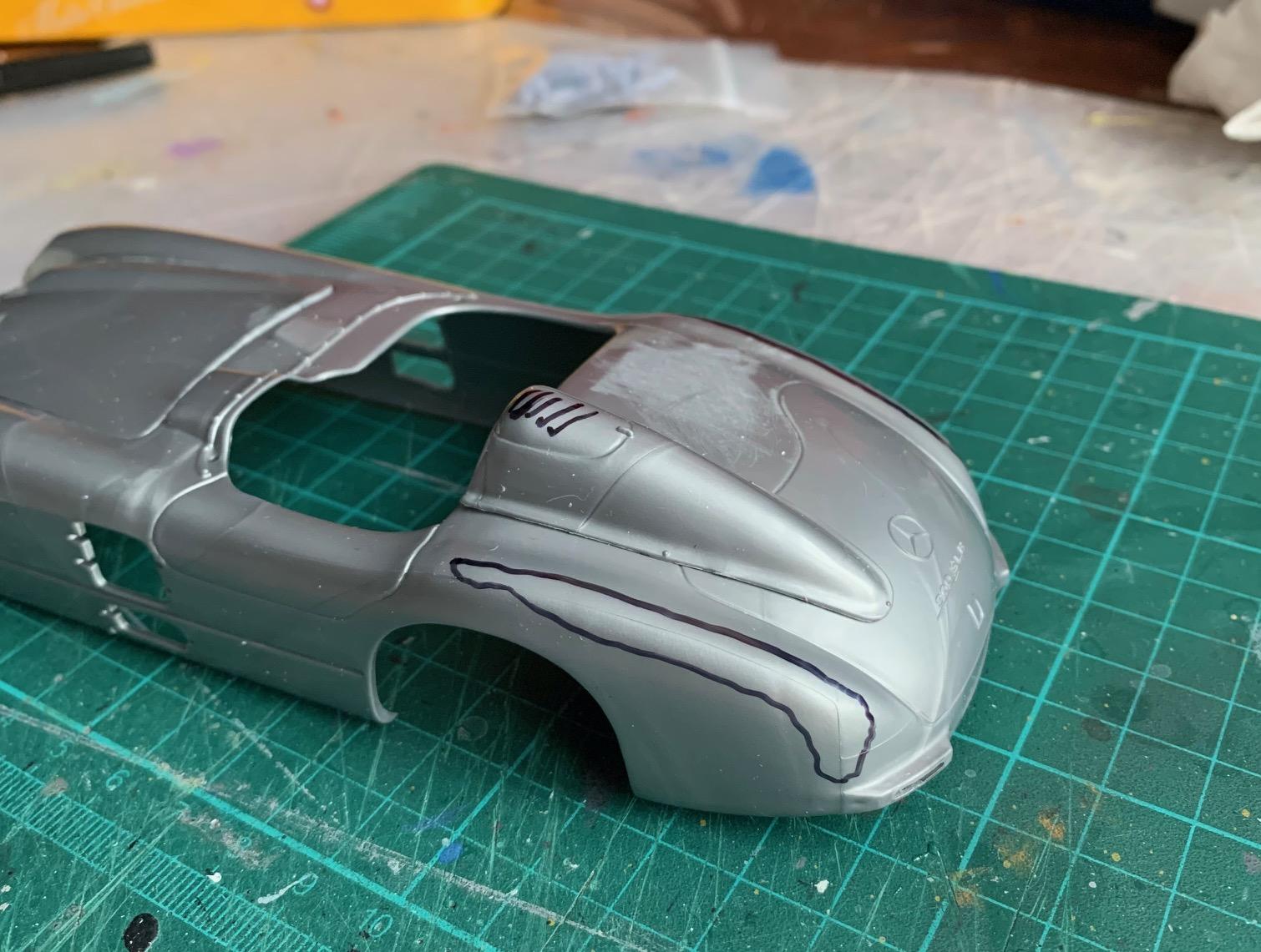

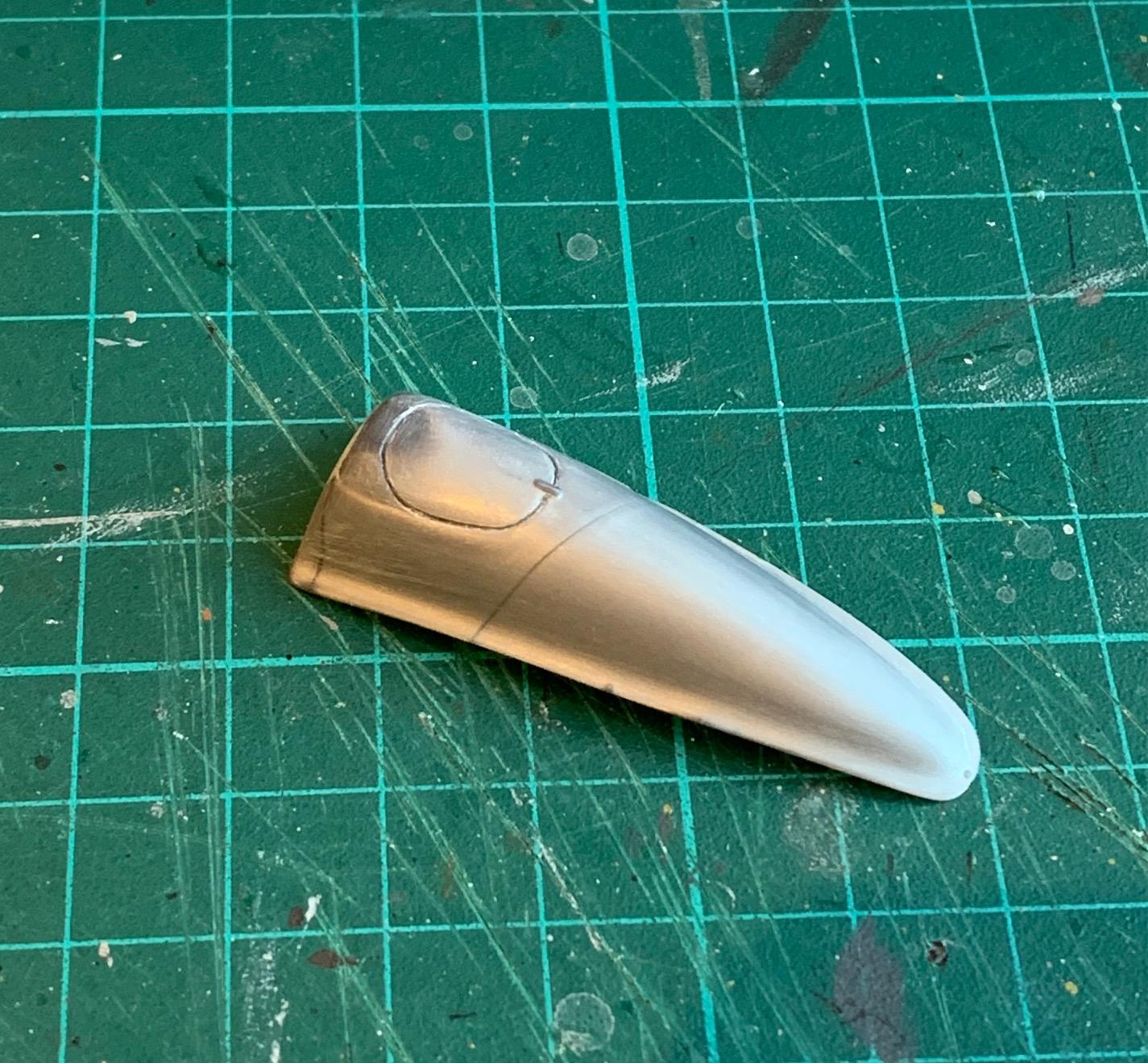

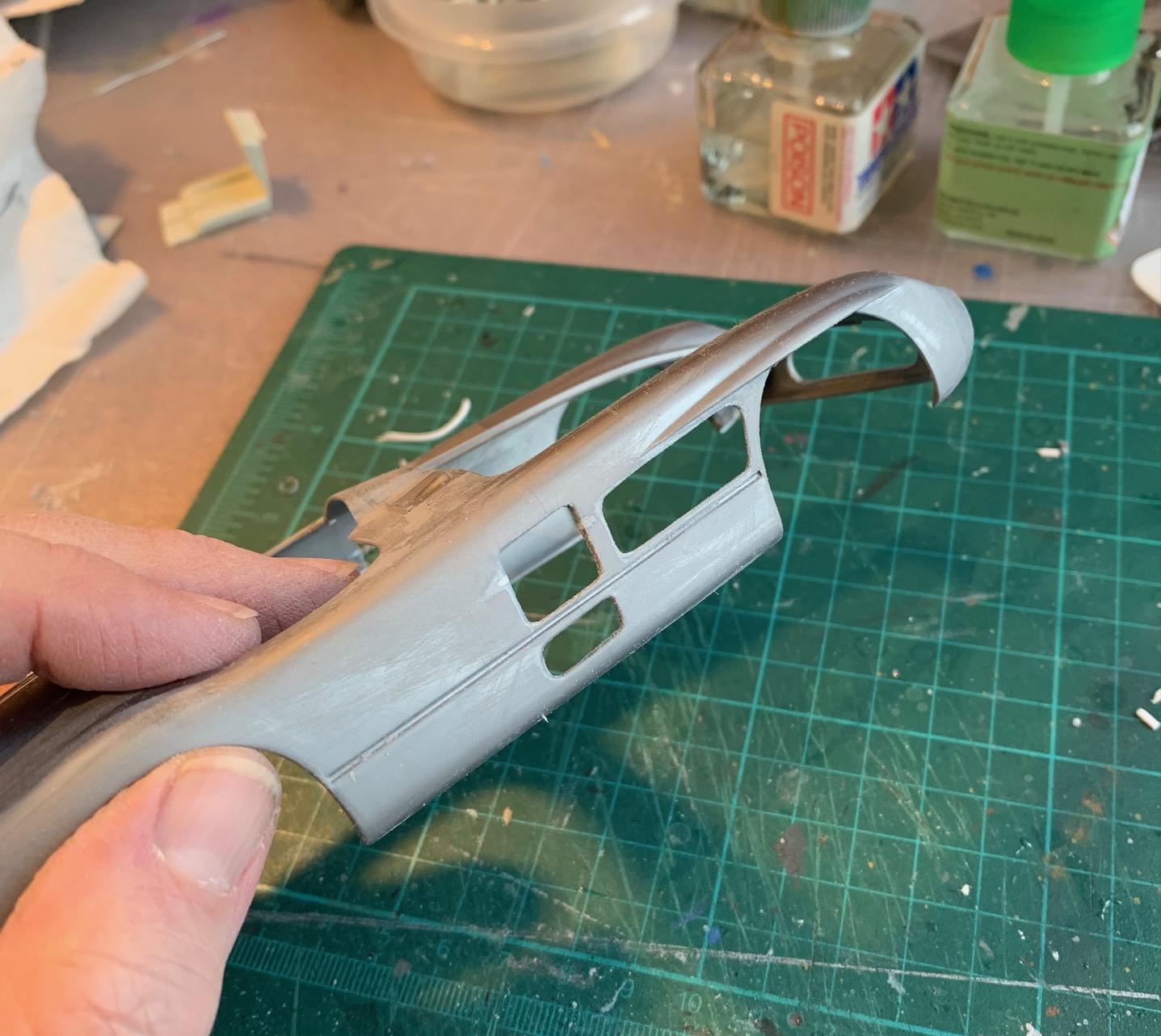

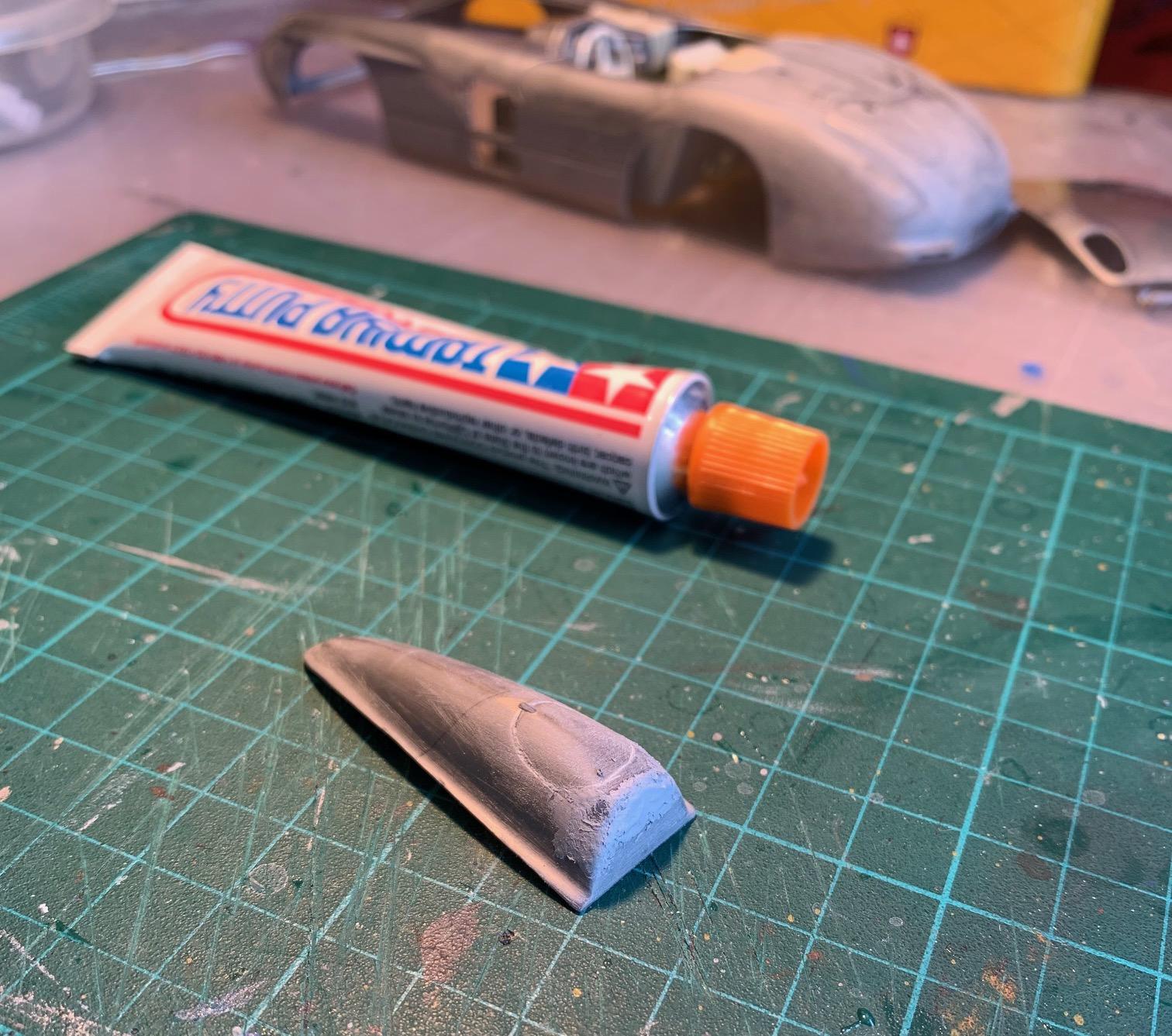

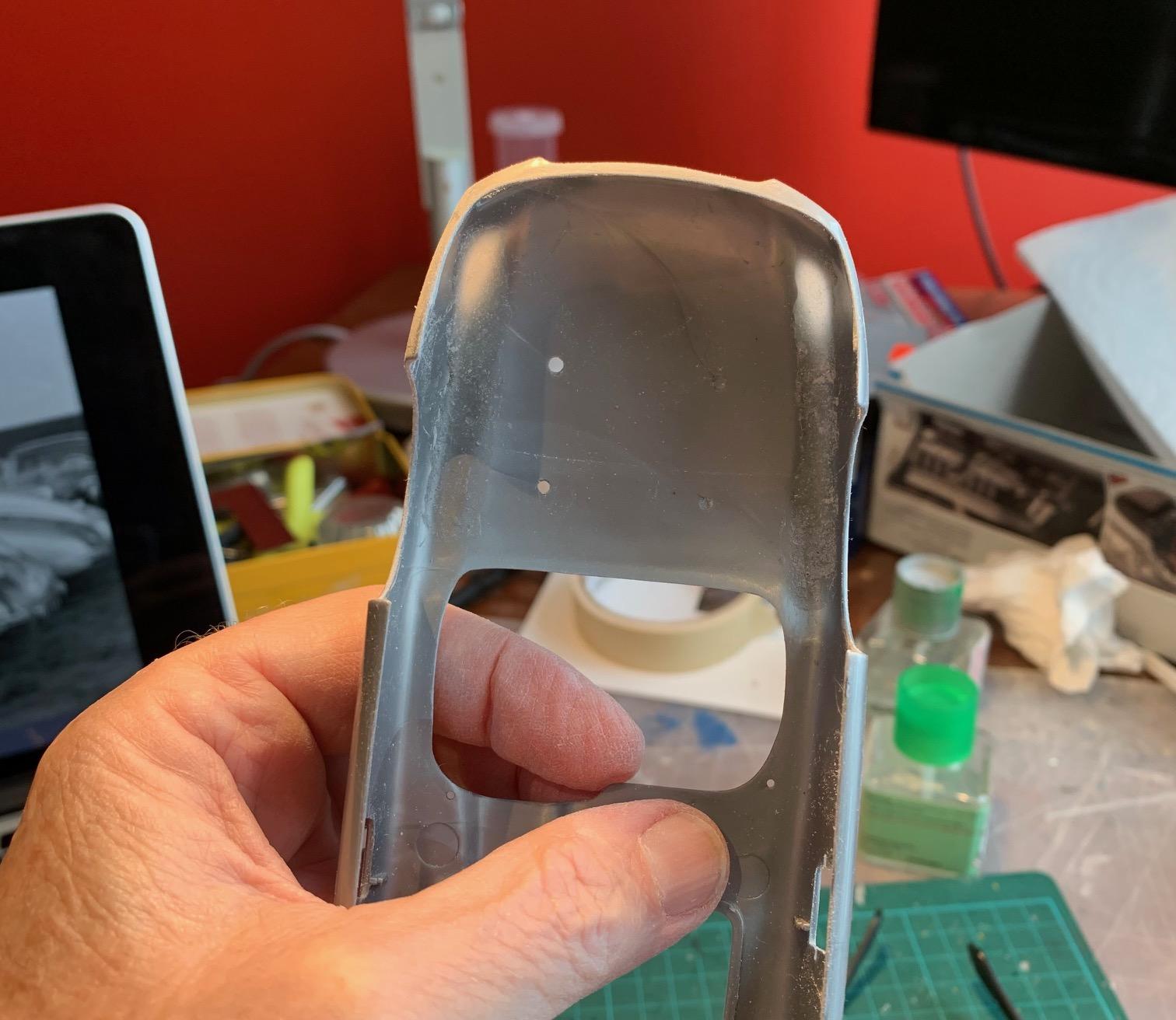

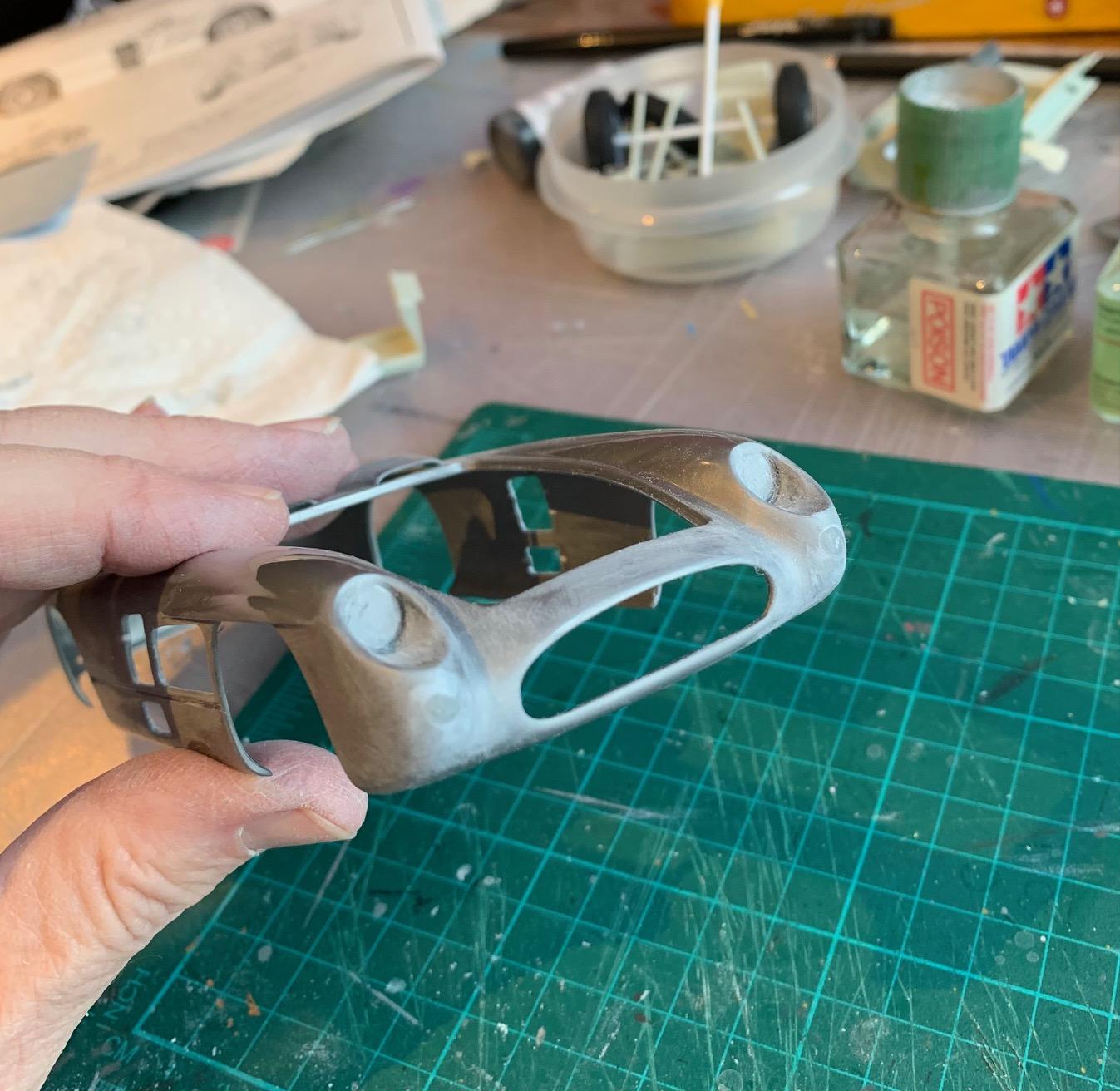

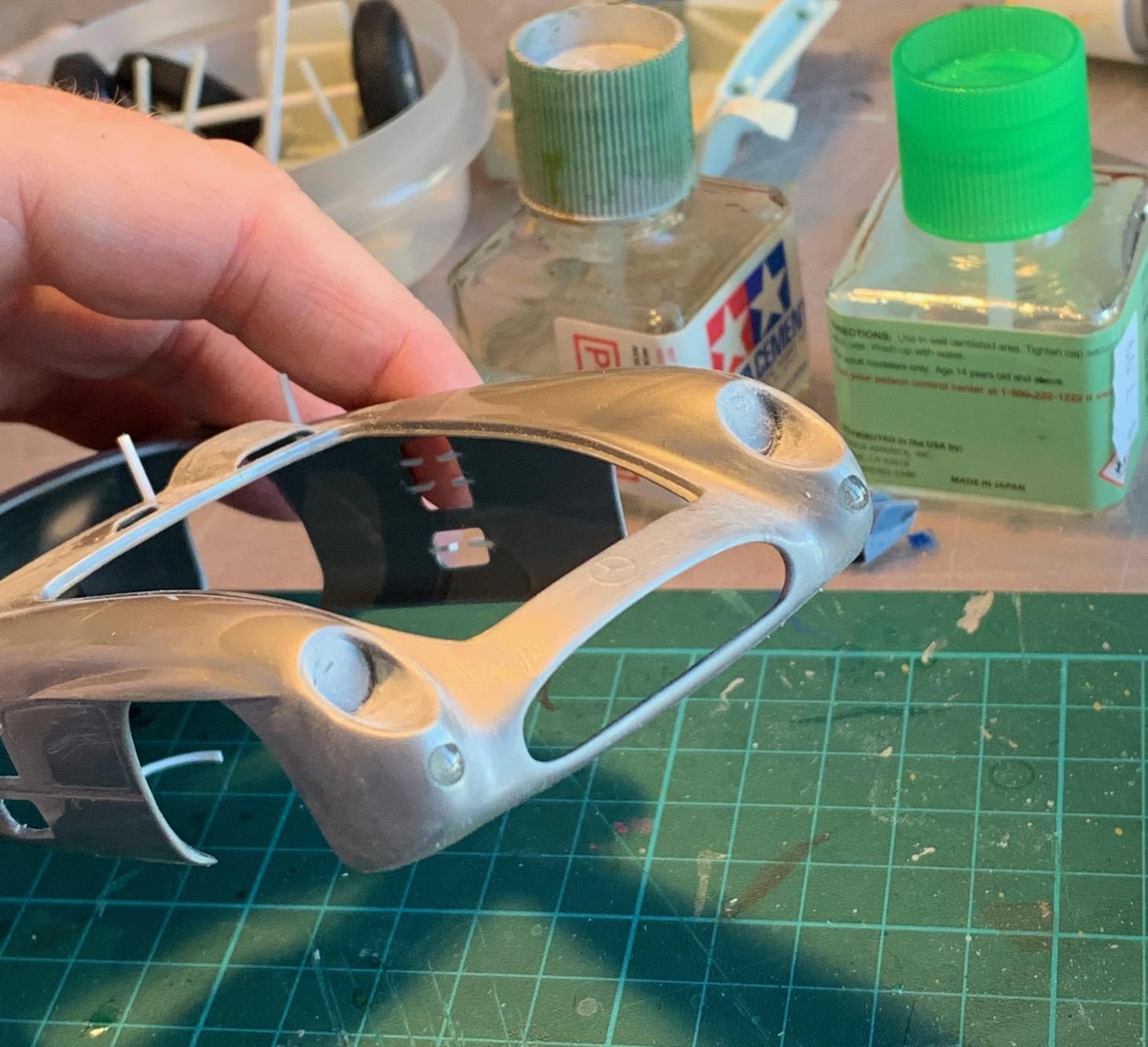

Work on reshaping the back end, which is quite more off than I initially estimated. First I back filled the fenders with epoxy lo allow to take away a lot of material without breaking through. The head rest fairing will be thinned from the underside and the top as well.
Third pictures shows how hard this styrene is. I actually had to use the Dremel with a coarse sanding drum to cut through! I did eventually cut through the styrene in my reshaping efforts so the epoxy underlay paid off.
The back end looks significantly better now. Perhaps not fully accurate but with more realism. I'm happy with the change.

Pierre, you are doing your usual excellent job on the body mods. The cutting out of those doors is crisp and basically perfect. I usually try to avoid cutting out trunks and doors if I can. I don't trust myself not to ruin a body and have to buy a whole new kit which might be hard to find. Plus, it is very labor intensive.
