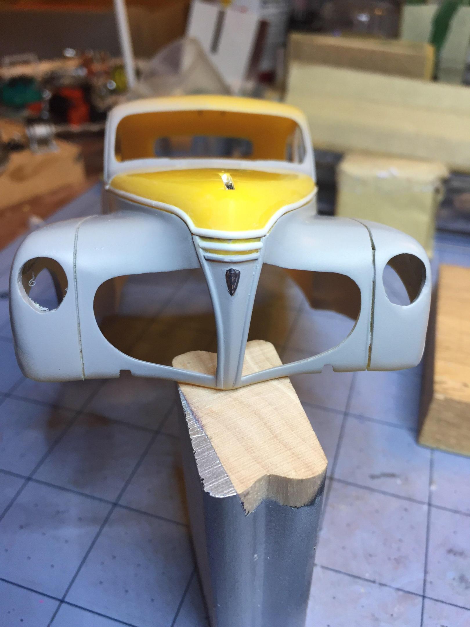

customline Posted February 6 Author Share Posted February 6 Another update. A re-do of the trim on the hood- the left side trim was removed and replaced.....twice. I'm having a great time with this one ?. I think I got it as good as I can get it. We won't know till the foil is on. I'm thinking about trimming the foil on the body a tiny bit wide and then tight on the new stuff to maybe compensate for the difference in width. My estimate for chance of success on that is about 50/50 ?. When it warms up out there I'll get some more primer on it. Thanks for sticking around ? 1 Quote Link to comment Share on other sites More sharing options...

customline Posted February 7 Author Share Posted February 7 (edited) I love these little magnets. I use 'em to keep doors and trunks and hoods closed. But not just closed but, more importantly, in alignment. in the case of this hood, the rear alignment is provided by the "stubs" at the back corners. All I needed was something at the nose....MAGNETS! ? I was waiting for the glue to dry on the magnets so I "created" a distributor from sprue. Crude but the wires have gotta go somewhere ?. Also, I just remembered to add the correct seam lines to the nose. I haven't done it yet....but I did remember it and that's something ?. Edited February 7 by customline Quote Link to comment Share on other sites More sharing options...
maxwell48098 Posted February 8 Share Posted February 8 Having worked on several 1:1 versions of these old Mopars, I must say that nearly every single one had various panel gaps and fit far worse than those on your model. On 1:1, we've spent days getting them even close to being equal and tight. Kudos on your efforts. A.J. 1 Quote Link to comment Share on other sites More sharing options...
David G. Posted February 8 Share Posted February 8 Removing and replacing the chrome trim seem to be the perfect way of addressing the fit issued between the hood and body. Great call Jim! David G. Quote Link to comment Share on other sites More sharing options...
customline Posted February 8 Author Share Posted February 8 2 hours ago, David G. said: Removing and replacing the chrome trim seem to be the perfect way of addressing the fit issued between the hood and body. Great call Jim! David G. Thanks, Dave. The trim on the cowl was pretty poor so that was replaced too. I was after a better alignment with the trim on the hood, which was narrowed in the process by removing material beyond just the hood trim. The sides were sanded quite a bit. My hood had a slight twist so I twisted it the other way and it seemed to fit better. Styrene is pretty good about that sometimes ?. Quote Link to comment Share on other sites More sharing options...

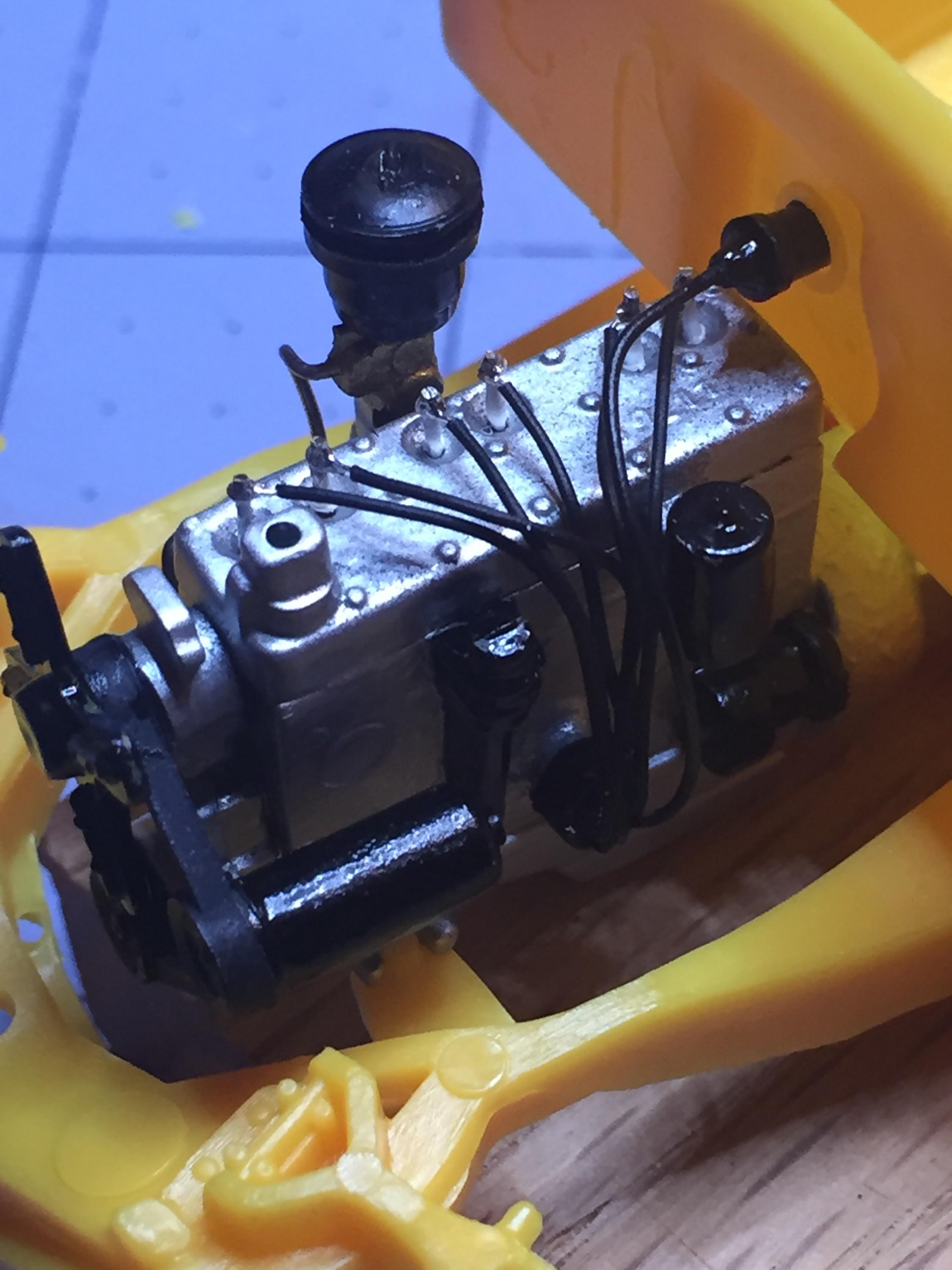

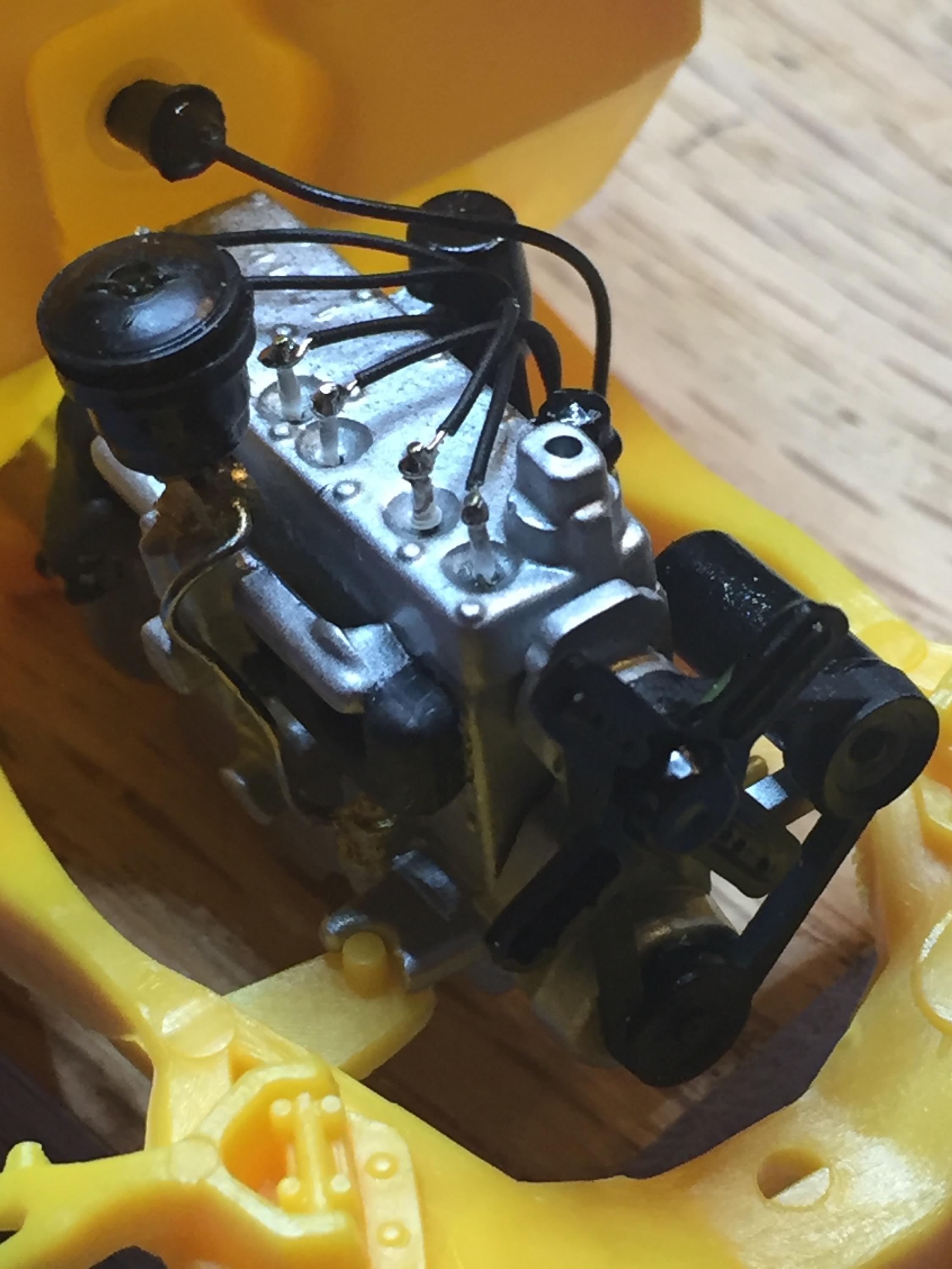

customline Posted February 11 Author Share Posted February 11 While waiting for my Hobbylinc order to get here I figured I try to complete the boat mooring. I found a great photo of one and thought it would be cool to connect the ignition wires like they did back in the day I figured I give it a try. I soldered my wires to .020 brass and painted below the connection with gloss white. Drilled out the molded-in plugs and inserted the brass. Cut the wires to length and inserted in my "distributor". A very fiddly operation(for me ?). So I got my .020 styrene and installed the fender welt. Thanks for your interest ? All right then. 4 Quote Link to comment Share on other sites More sharing options...
David G. Posted February 13 Share Posted February 13 Great progress on this Jim. I wired the engine in the one I built too. I tried to make one of those clamshell wire guides but couldn't quite get it to look the way I wanted it to so I did without it. The fender welt looks great! I wish I'd thought of using styrene rods when I built mine. Another case of what I call "delayed intelligence". David G. Quote Link to comment Share on other sites More sharing options...
customline Posted February 13 Author Share Posted February 13 5 hours ago, David G. said: Great progress on this Jim. I wired the engine in the one I built too. I tried to make one of those clamshell wire guides but couldn't quite get it to look the way I wanted it to so I did without it. The fender welt looks great! I wish I'd thought of using styrene rods when I built mine. Another case of what I call "delayed intelligence". Yeah...I tried that too. As far as the welt goes, It's a bit large but there's so much out-of-scale nonsense going on with this kit, it's not relevant to me anymore. The liberties they took with the chassis and drive line turn the whole thing into a joke. I started the assembly of the suspension and when I got to the rear axle/springs/shocks I found very little resemblance to the 1:1. I started to "fix" things and realized it was useless . ? it's pretty "toy-like", not a serious model. Maybe it can be detailed by someone with a better attitude but I've had enough of this one and just want to settle for making the body look more realistic and move on. There's your delayed intelligence, Dave. ? Quote Link to comment Share on other sites More sharing options...
