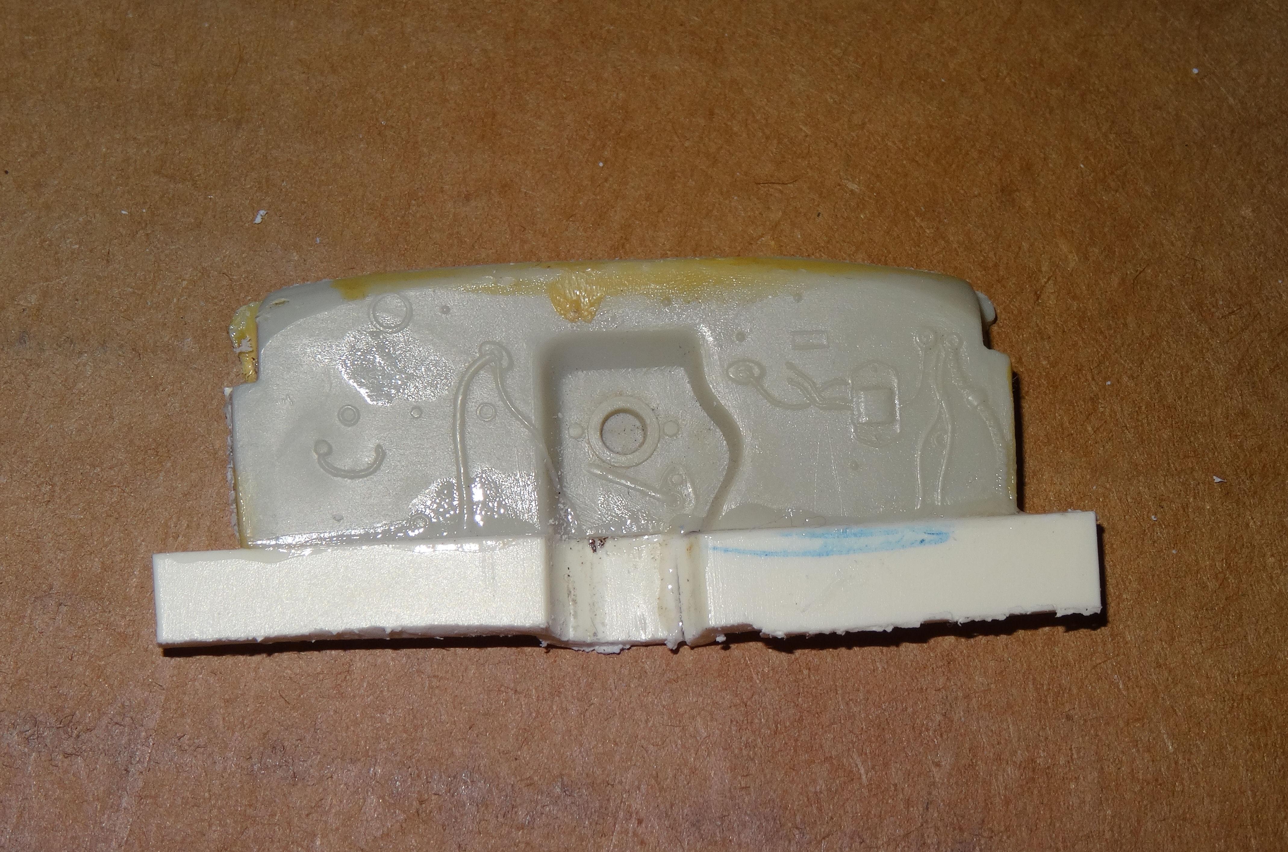

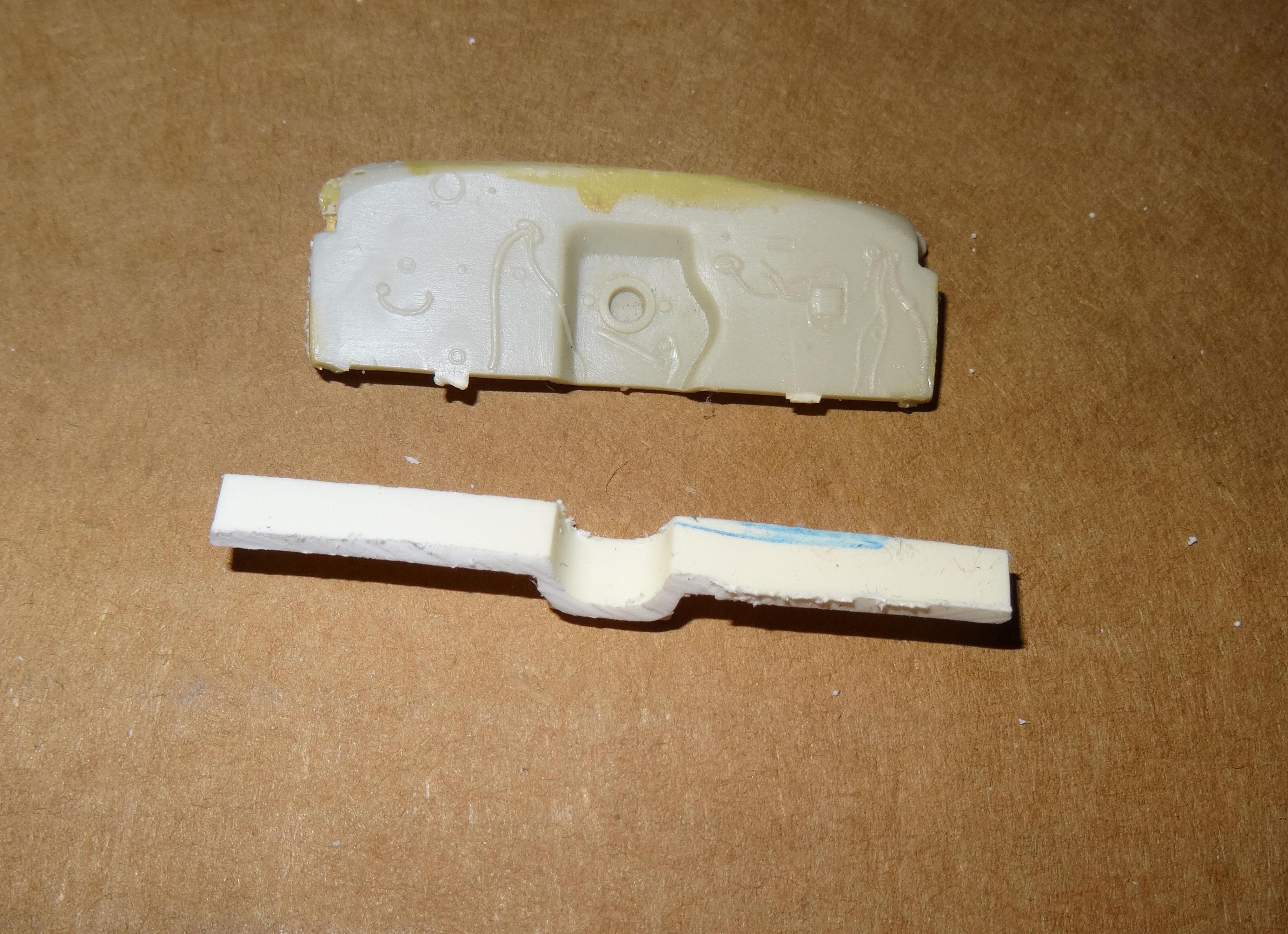

The Woody has been getting a bit neglected lately so I started working on fitting the interior.
I suppose I got a little ahead of myself by assembling the chassis as now I had to adjust things to fit. Here I've laid out the components. That's the Ford chassis floor on the right.
The interior from the 48 Ford Woody is a bit too long and extends into the engine compartment. The foot-board extends forward and will interfere with that powerful flathead six.

First thing I needed to do was remove the top of the wheel tubs from the Plymouth as the Ford interior had it's own. And cut off the front of the floorboard.
I remove a 5.75 MM section off the back of the removed section of floorboard and reattached it. Then had to trim the side panels to match.
Also needed to remove part of the tunnel from the Plymouth chassis to clear the Ford floor as well.
Still had interference issues with the transmission hitting the interior floor. Sound familiar Jim? I solved this two-fold. First by trimming a bit on the inside of the tunnel and second by tipping the front of the floor-board up slightly. No-one will ever know unless they have big feet.
DSC00127.jpg.6232d704083c5a21c95ce68628ae28bc.jpgDSC00130.jpg.10241ae925a12748f072ad0ede4f280f.jpg
After this I decided to check the fit of the firewall and the dashboard. Turns out the firewall was too short to cover the gap from the cowl to the floor-board and I needed a spacer to take up the slack. As they say, waste not want not, the piece I cut out of the floor earlier will work fine to bridge the gap.
