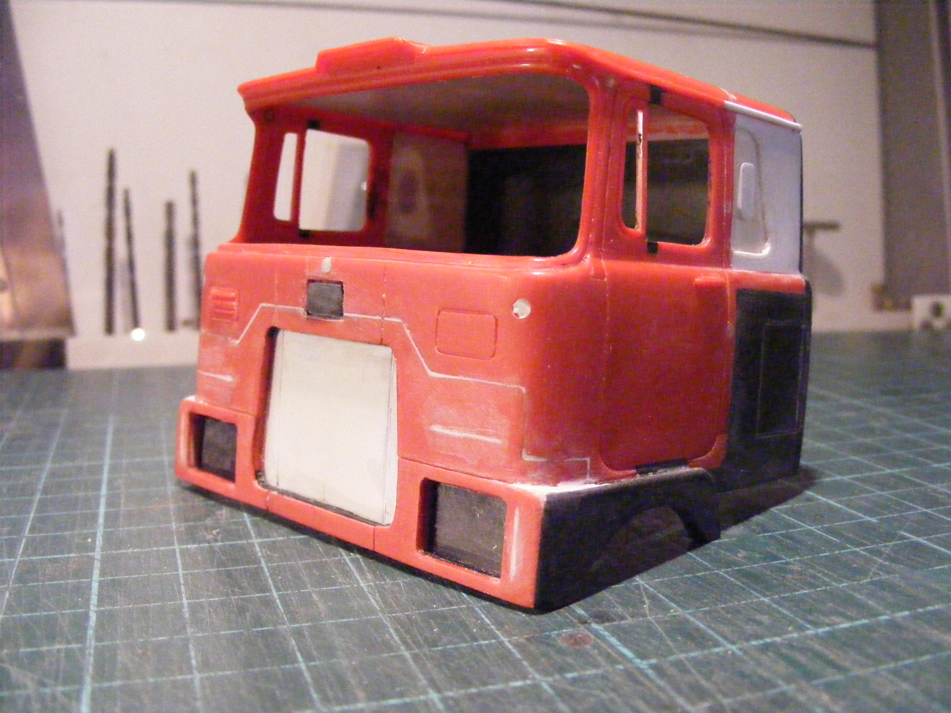

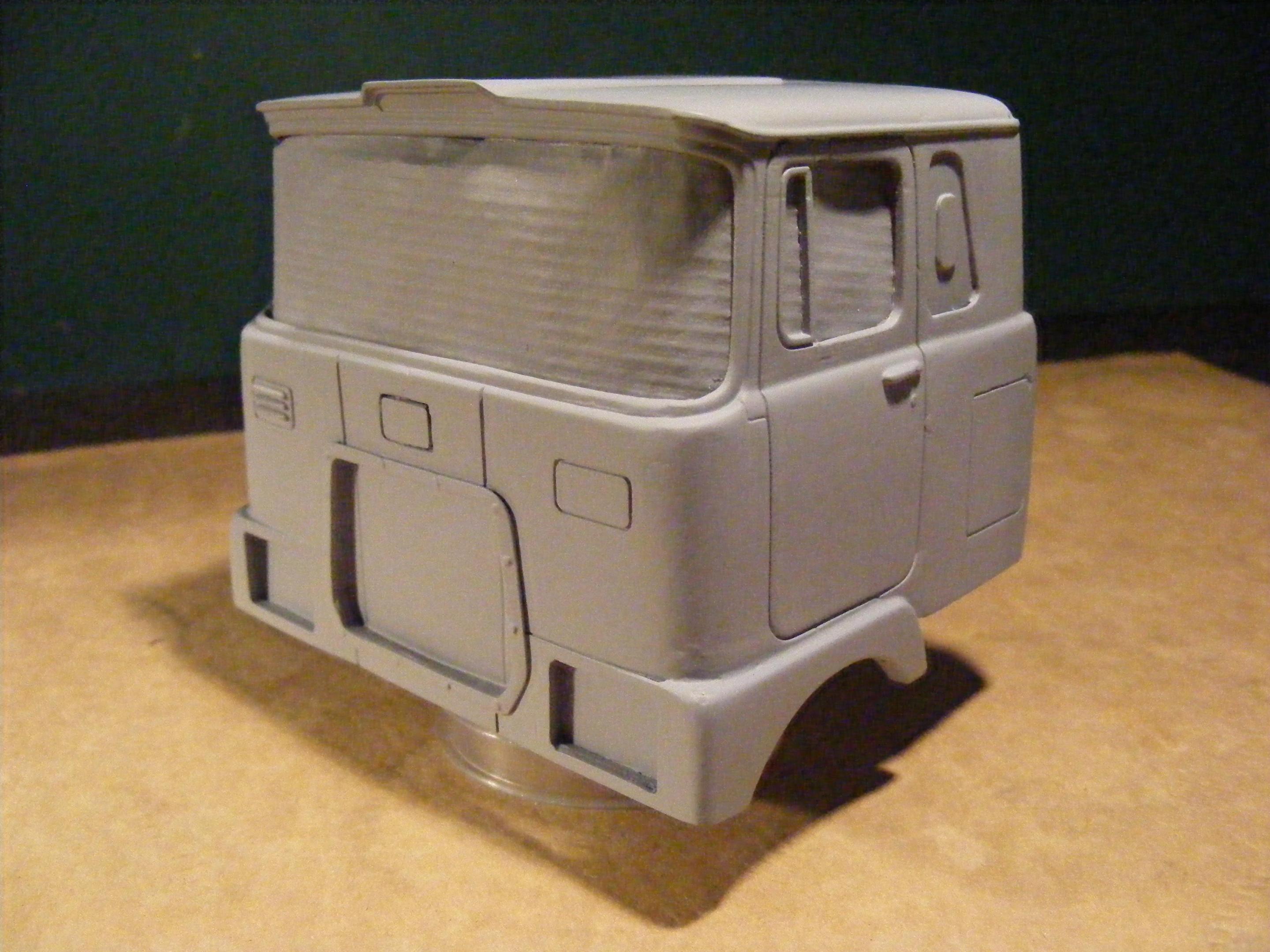

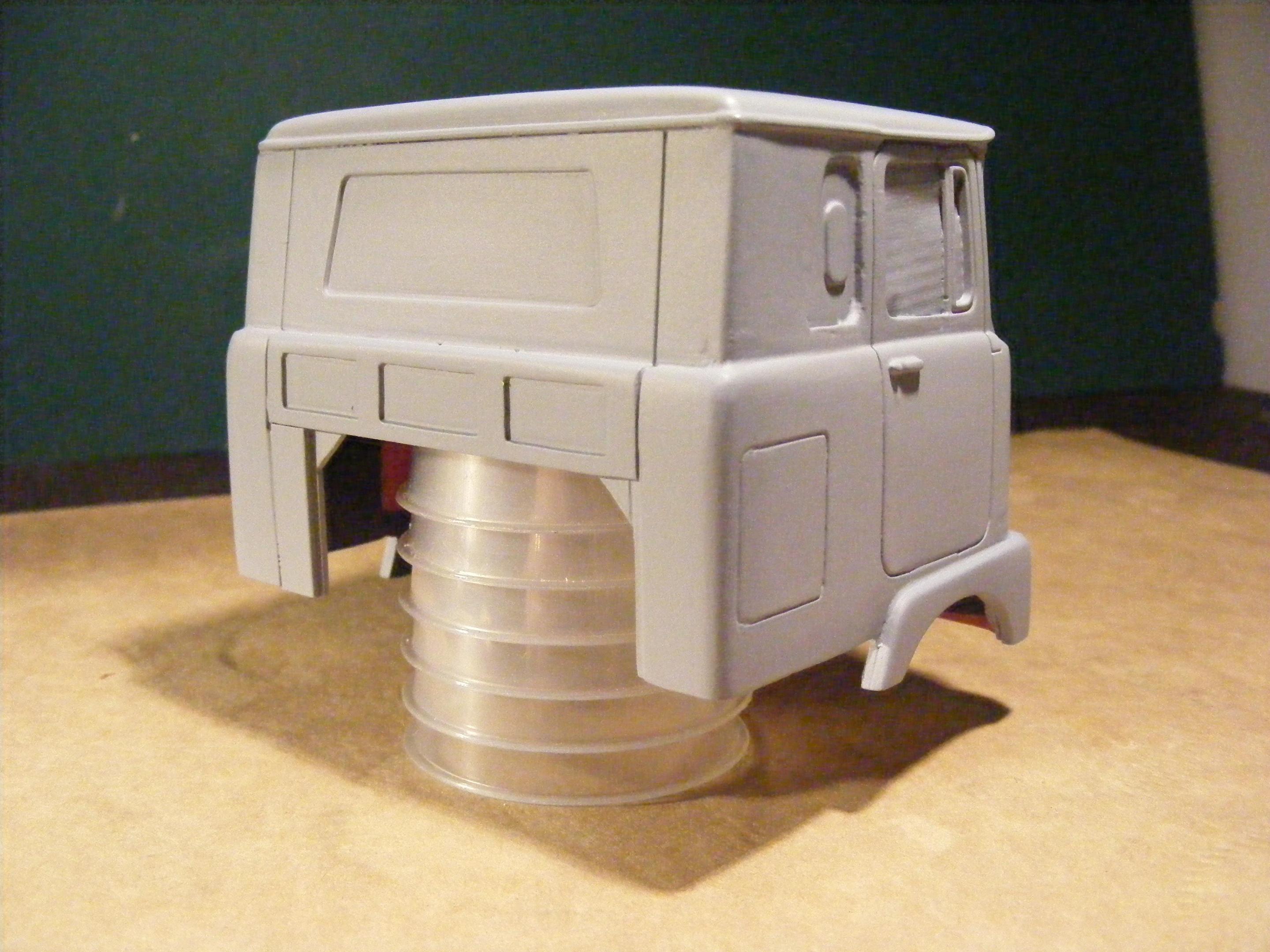

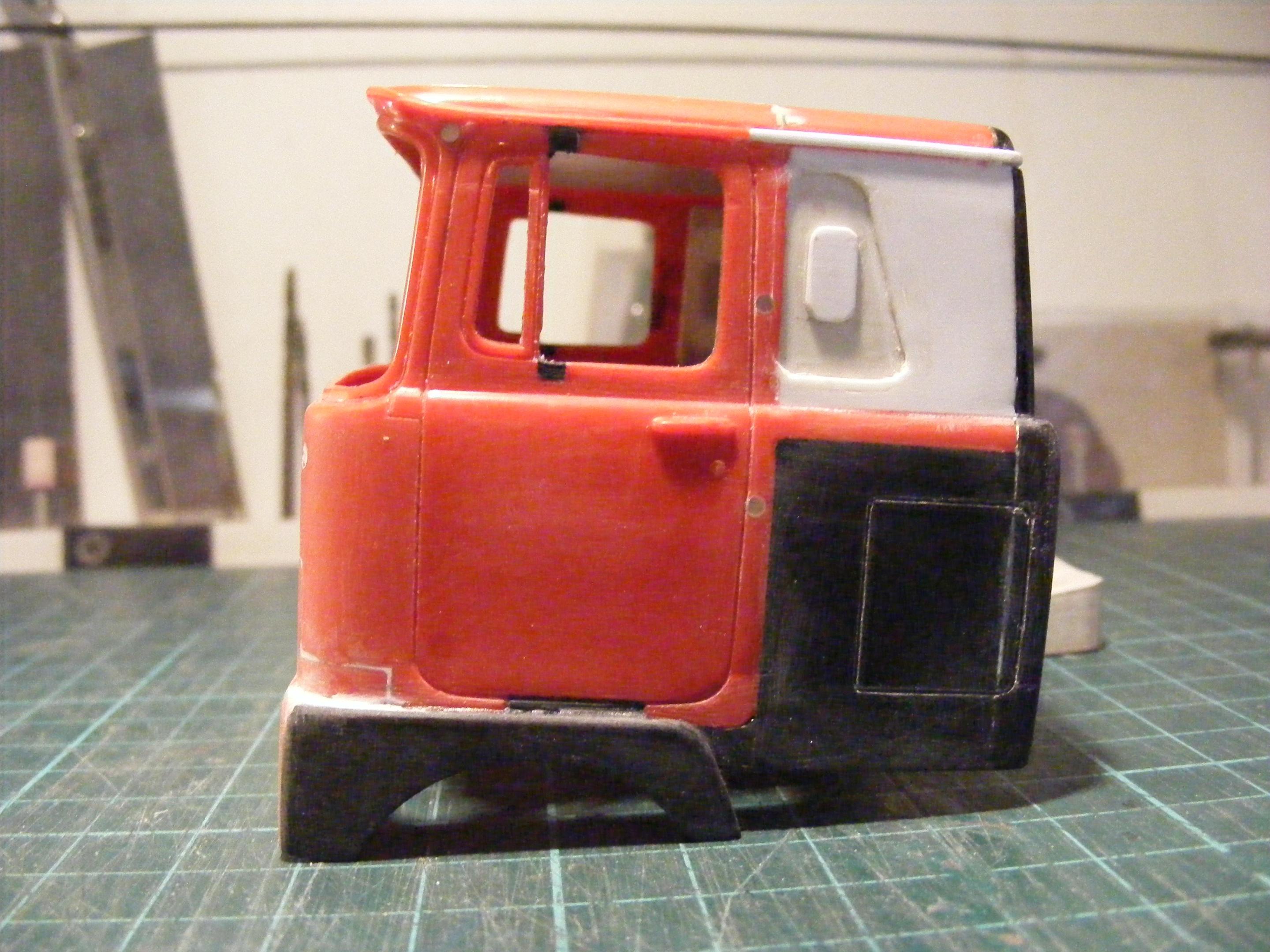

The Brush Posted February 13, 2024 Posted February 13, 2024 Hi, I decided to finish off a couple of unfinshed projects, This is a build started a few years back, Mack F700, using a cab front from the pumper the rest is scratchbuilt. I had good intensions to build a few variants so i made a mould, Cab could also be used for a Brockway & Hayes. The rest of the truck will also be scratch built or adapted to a mack r frame if one ever became available, I have`nt seen any for sale lately. Heres a few pics to start us off. 5
Firebuilder Posted February 13, 2024 Posted February 13, 2024 Looks good, different use of the CF fire cab. I like that 2
Rockford Posted February 14, 2024 Posted February 14, 2024 That is very tidy and very innovative! Well done. 1
cifenet Posted February 16, 2024 Posted February 16, 2024 I have a feeling you will turn this build into an amazing result. Nice prep work so far. 1

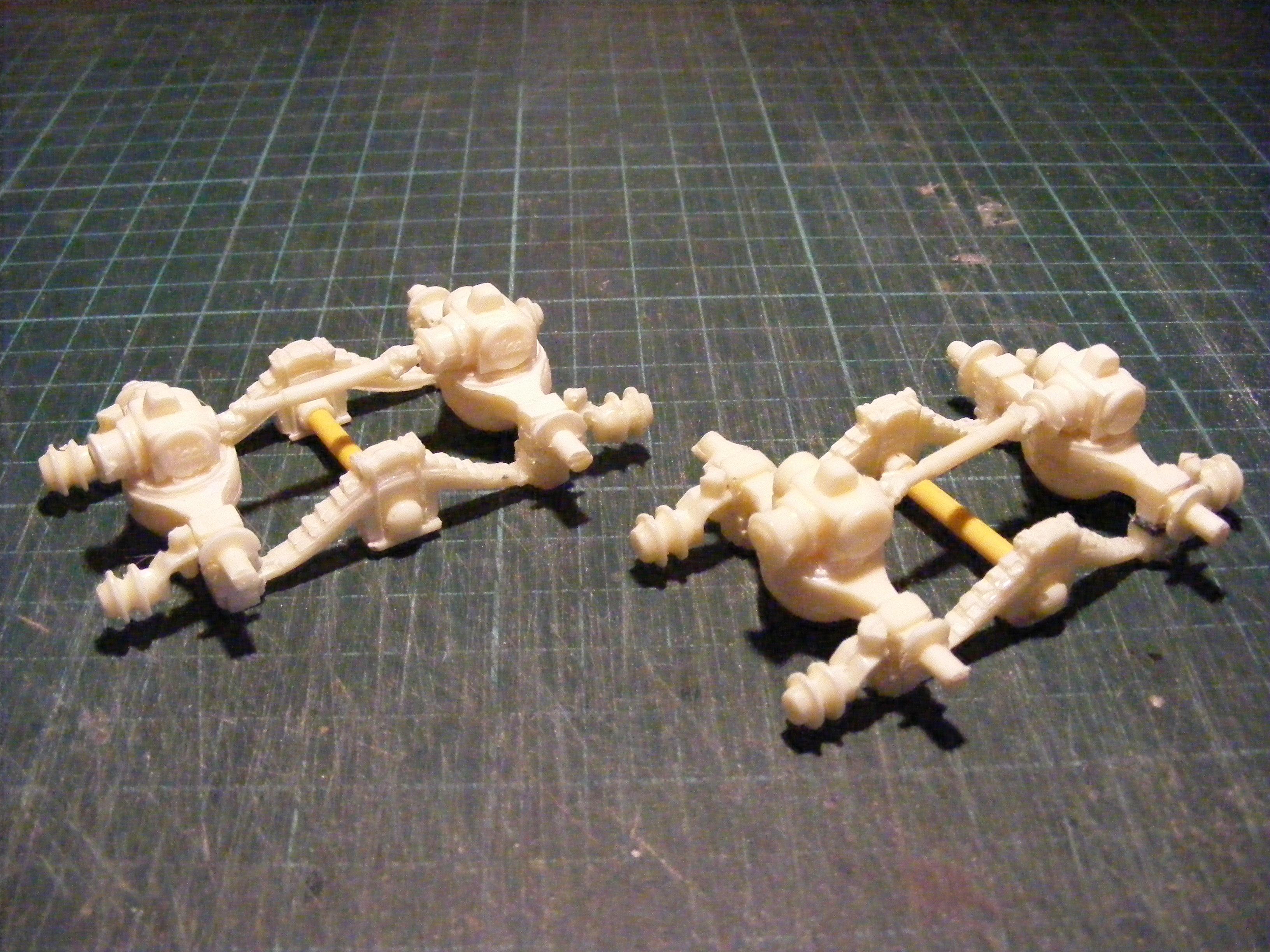

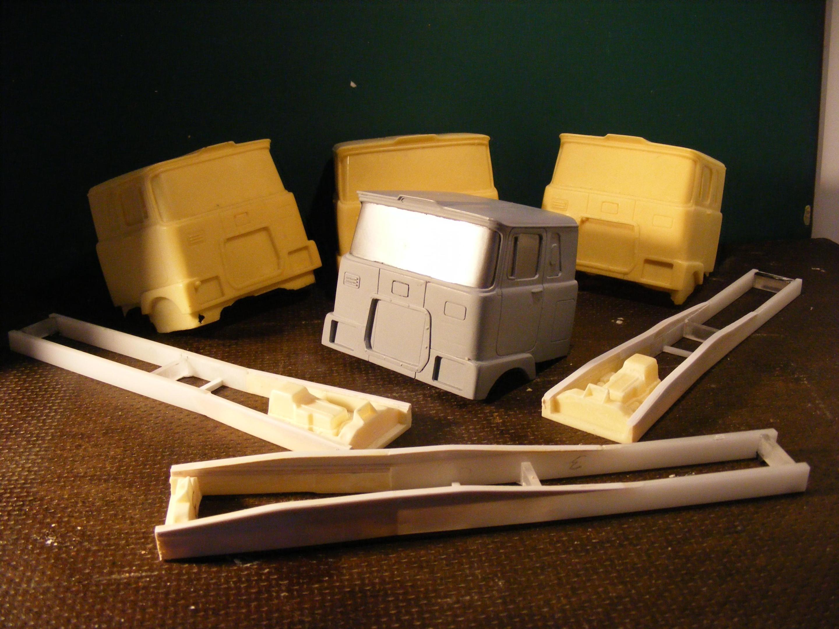

The Brush Posted February 21, 2024 Author Posted February 21, 2024 (edited) Hi, Thanks for the replies, Heres a few more pics. I have made 3 frames-2 for the first builds & 1 to make a mould from, Also 3cabs + cleaned up parts & assembled to make the suspension & axles.I only had a normal axle to convert so for now it will have to do.till i get one with an offset diff, I used the half engine which can be cut out to fit a full engine Edited February 21, 2024 by The Brush 4
Bennyg Posted February 23, 2024 Posted February 23, 2024 Wow!! That’s awesome! Did you base the Mack rear end off the Revell/Monogram R Series? Ben 1
The Brush Posted February 25, 2024 Author Posted February 25, 2024 Thanks Ben, I downloaded a diagram of the spring & scaled it to size, made a template from wood, the bottom arc, then built up the springs with strips of plastic card from there the rest is from photo`s, The brake chambers should be more angled downward next time. Thanks Graham. 3

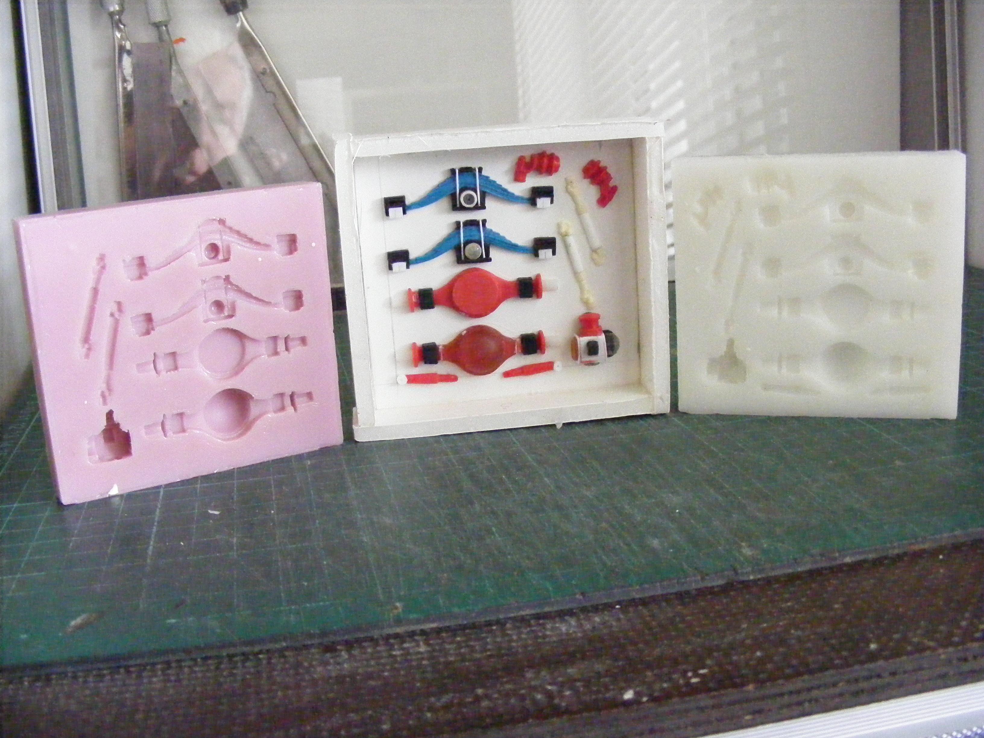

Jürgen M. Posted March 2, 2024 Posted March 2, 2024 Hi! Nice work there! How do make the moulds? Looks really nice! 1

The Brush Posted March 3, 2024 Author Posted March 3, 2024 23 hours ago, Jürgen M. said: Hi! Nice work there! How do make the moulds? Looks really nice! Hi, I make the mould boxes from 3 or 5mm foam board stick the parts on with PVA glue, then fill with silicone moulding rubber, The parts i need more of i make 2or3 rubber moulds, I used to mke the boxes from plastic but found foam board more cost effective & easy to cut. Cast the parts in fast cure resin. 2

Jürgen M. Posted March 3, 2024 Posted March 3, 2024 3 hours ago, The Brush said: Hi, I make the mould boxes from 3 or 5mm foam board stick the parts on with PVA glue, then fill with silicone moulding rubber, The parts i need more of i make 2or3 rubber moulds, I used to mke the boxes from plastic but found foam board more cost effective & easy to cut. Cast the parts in fast cure resin. Nice! Thanks for sharing! ? 1

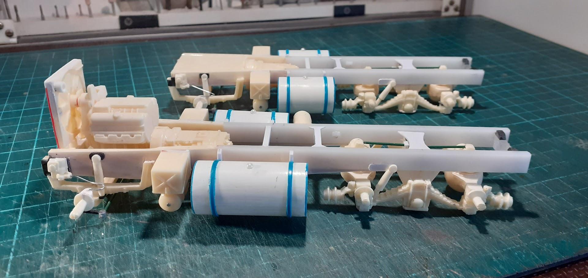

The Brush Posted March 24, 2024 Author Posted March 24, 2024 (edited) Hi, Had a busy month with other life jobs to do, But managed to get more done on the frames The only engine i have in this scale is a DD 8v92 from AMT so far, Next job is to fit the cab. & sort some wheels & tyres. Not 100% perfect but looks passable. Thanks for looking. Edited March 24, 2024 by The Brush 6
