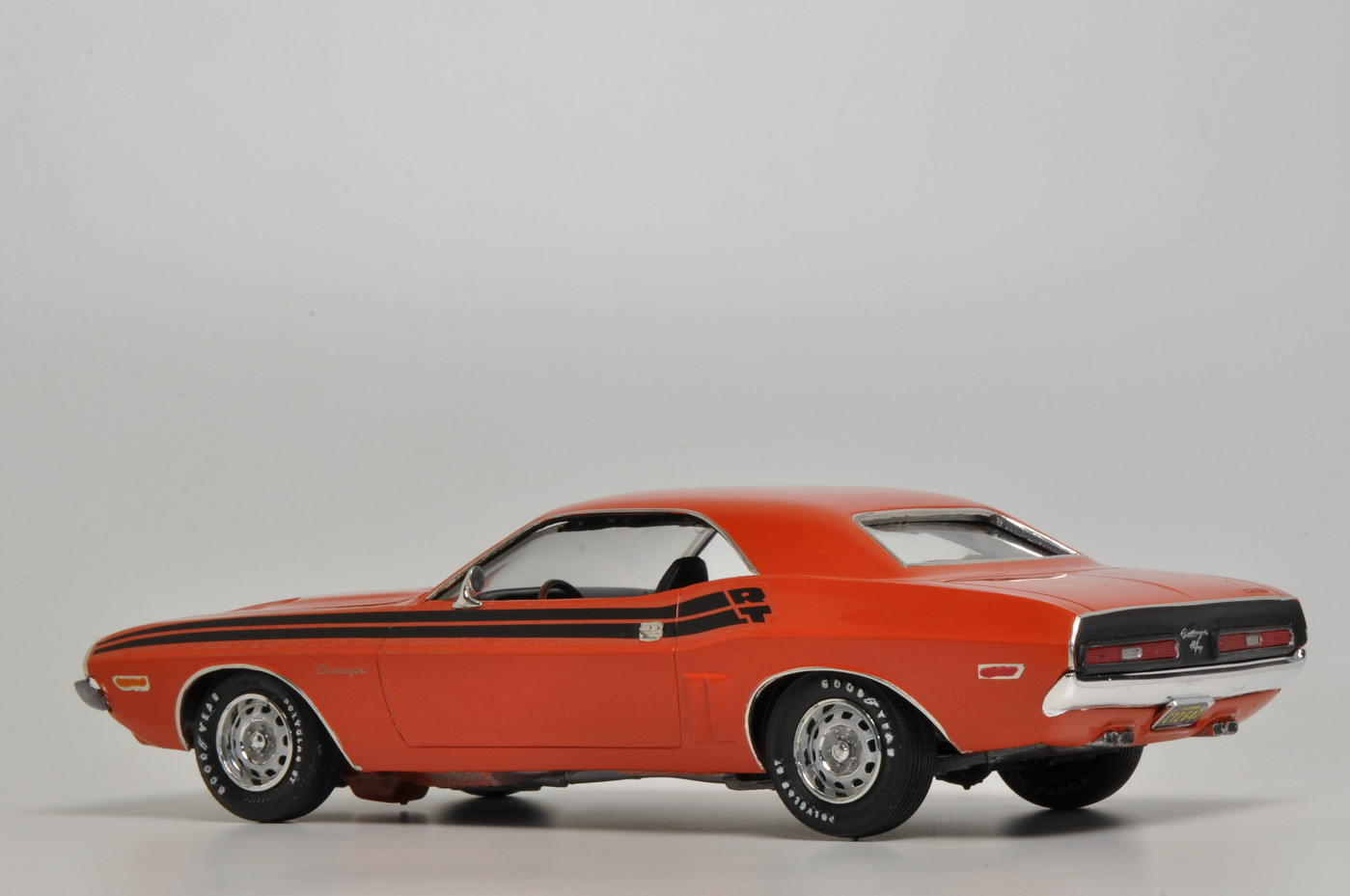

The 3/4 birds eye rear view...
The resin body did not come with windows. I ended up using the front windshield from an MPC 1970 Barracuda kit (an ancient leftover piece from a funny car project).
But naturally the rear window from that kit did not fit the Challenger body, So I found an acceptable substitute in the Model King "Plum Crazy" funny car kit. It was not a great fit but got the job done.
BTW, the slightly orange peeled decals are from the 1971 Charger and Challenger R/T promos (the decal sheet provided with the promos had the graphics for both the charger and Challenger on the same sheet).  The MPC 1971 Challenger assembly kit had decals that omitted the factory R/T graphics. Miraculously, these 53-year-old decals were soaked and applied a little over a week ago, and other than that slight orange peel, they did great!

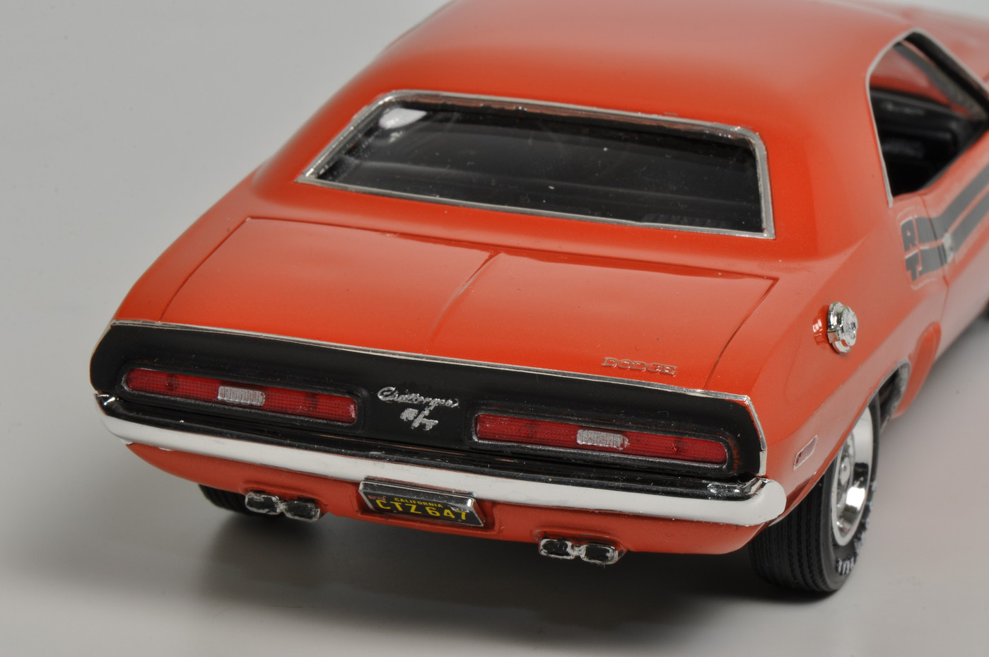

Here is a closeup of the rear end detailing. It was patterned after careful study of 1/1 scale 1971 Challenger R/Ts.
I didn't notice until just about the end that the resin body molding of the Challenger's distinctive quad exhaust tips was pretty poor. I did what I could to rectify it, but the result is still far from satisfactory.
The resin kit's rear bumper was poorly molded and unusable. The 1970-74 MPC Challenger kit rear bumpers have a cutout for the license plate, but it was not present on this plated piece found in my parts box. I presume it was from one of the old MPC funny car kits.

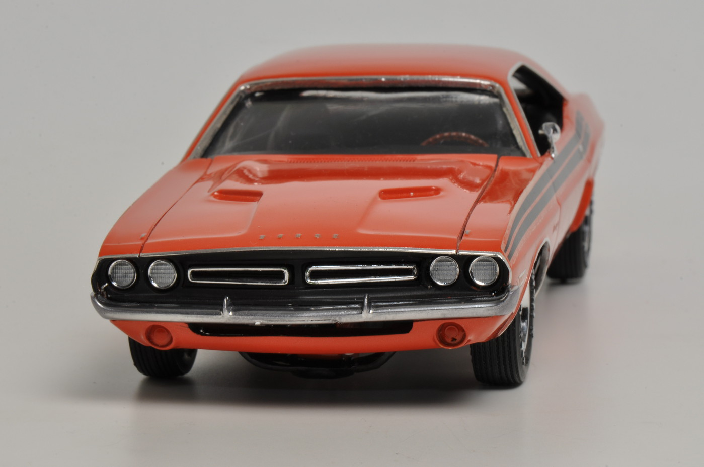

The grille molding of the MPC kit (and the resin rebop) is oversimplified vs. the 1/1 piece, but I paint detailed it to the best of my ability. The resin kit front bumper had all kinds of extra material on the backside that made fitting to the body impossible. This slightly cut down piece came from one of those two leftover projects shown at the beginning of the aforementioned build thread.  It was painted with Revell "Chrom" paint, and the results were beautiful until the paint on the bumper edges showed wear during handling while being glued in place. Cursis! (N>B> yes, ordered some SpazStic clear for chrome this week...).  One final comment...although the resin body appeared to be from a two-piece mold, it was still a bit thicker than the original MPC kit, which placed the windows a little too deep in the body as you can see here.

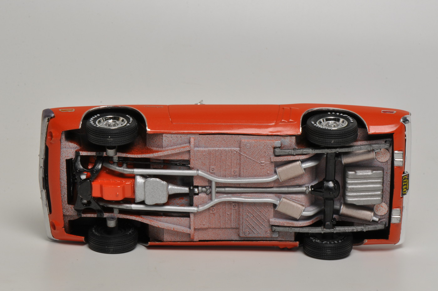

The paint detailed mostly one-piece platform chassis view....

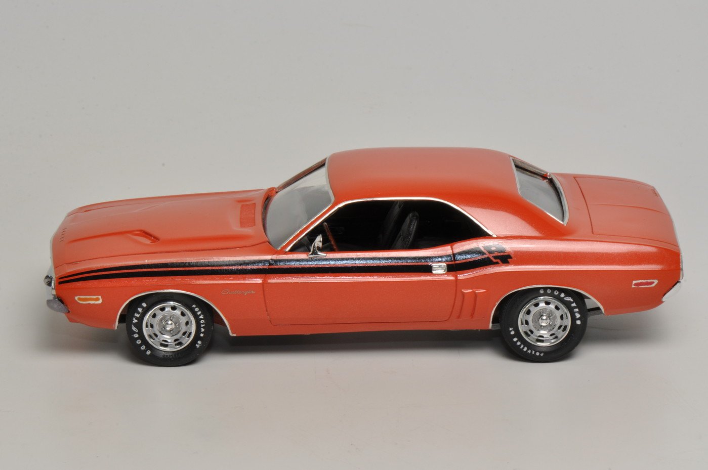

In keeping with the minimally equipped spec of this particular Challenger (and that I've raided way too many otherwise complete kits for Mopar 1970-74 dual racing mirrors), I used the seldom seen (in 1/1 scale) standard outside mirror for those years, sourced from the AMT Ertl 1971 Charger R/T kit.
While MPC's 1970/1971 Challenger annual kit was clearly deficient in a number of areas, they nailed the overall body proportions, and for the most part, the body detailing. But they missed adding the subtle chamfered/recessed areas just beyond the wheel lip moldings on the 1/1. (N.B.: The later AMT/Ertl Challenger kit included these recessed areas, but in a greatly overdone rendition of the actual appearance).

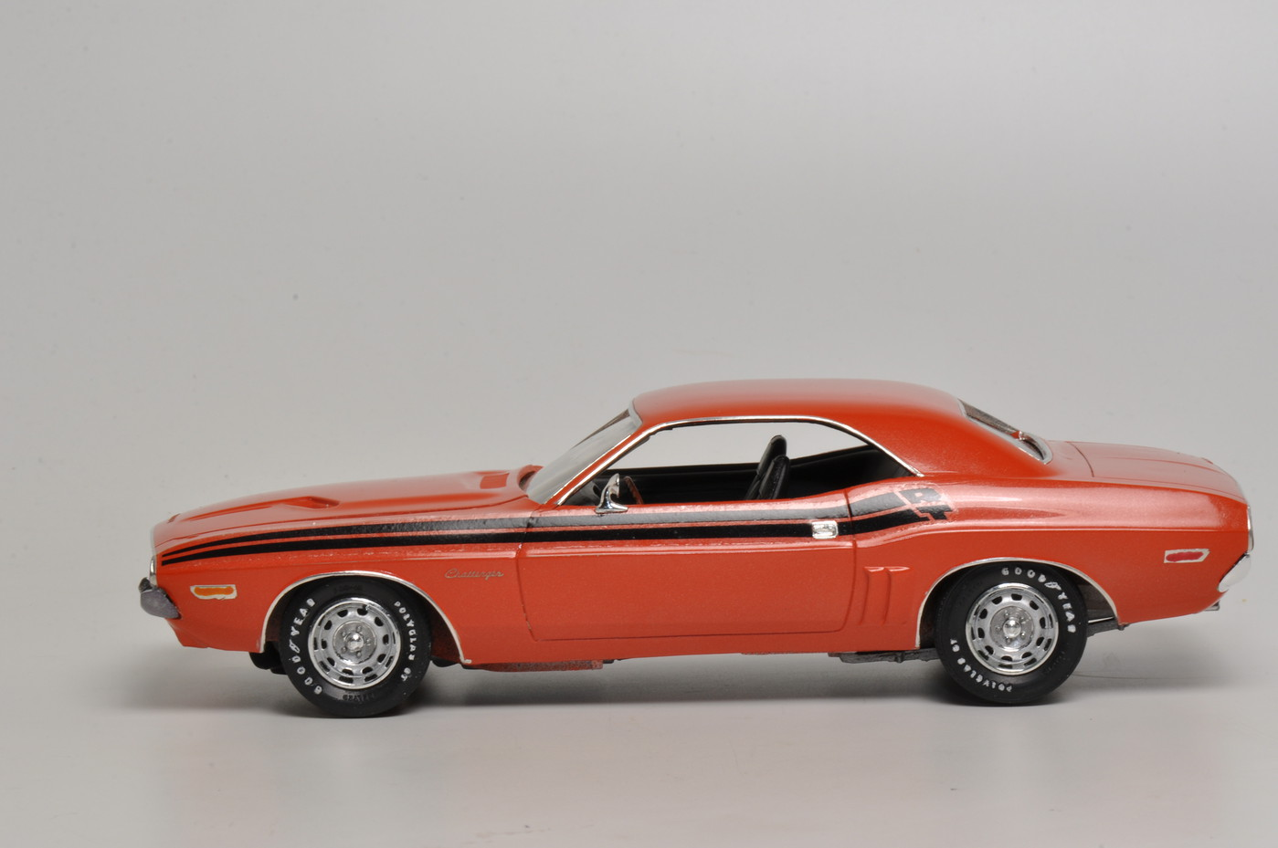

Yes, I lowered the front suspension from the kit format, which like many MPC models back in the day placed the stock version front end unrealistically high.   Even the 1/1 factory setting, depending on the prep dept. of the dealer where the car was purchased, sometimes placed the front end too high.  Thank goodness for my Craftsman rachet wrench and those torsion bar adjusting bolts!

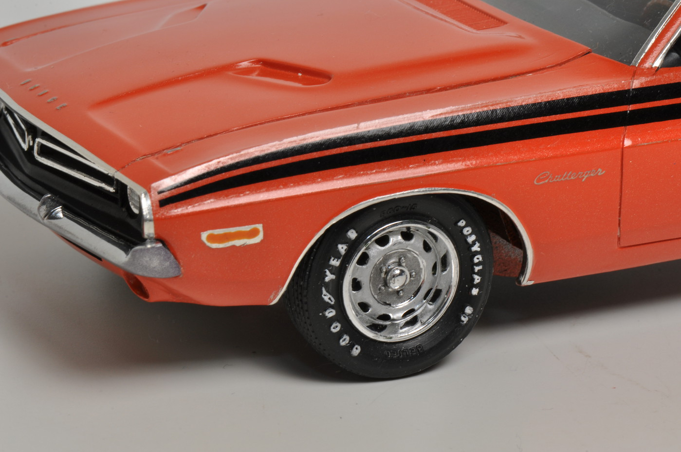

Here you can see the damaged chrome paint on the bumper end tips. The side market lamps were very subtly engraved, making paint detailing a bit of a challenge. The resulting somewhat sloppy appearance here does not meet my normal standards, I must confess. But it is OK in my book for a shelf model, which was the goal of this completed project.
Finally, you can see just a slight bit of non-conformity of surface along the upper and lower edges of the stripe decal. Again, not exactly what you would wish, but then again, any decal that is 53 years old and goes on as well as this one did is a victory in its own right....
