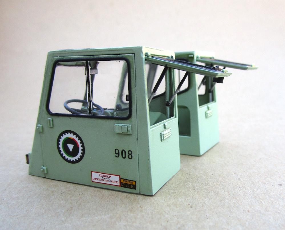

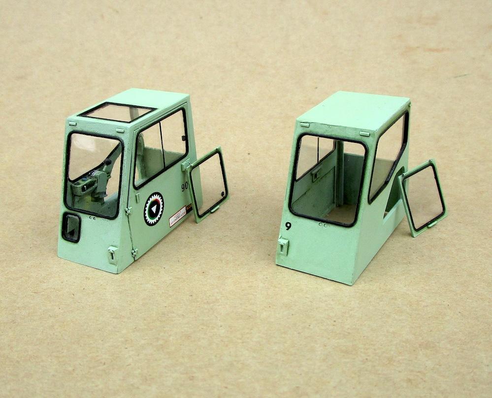

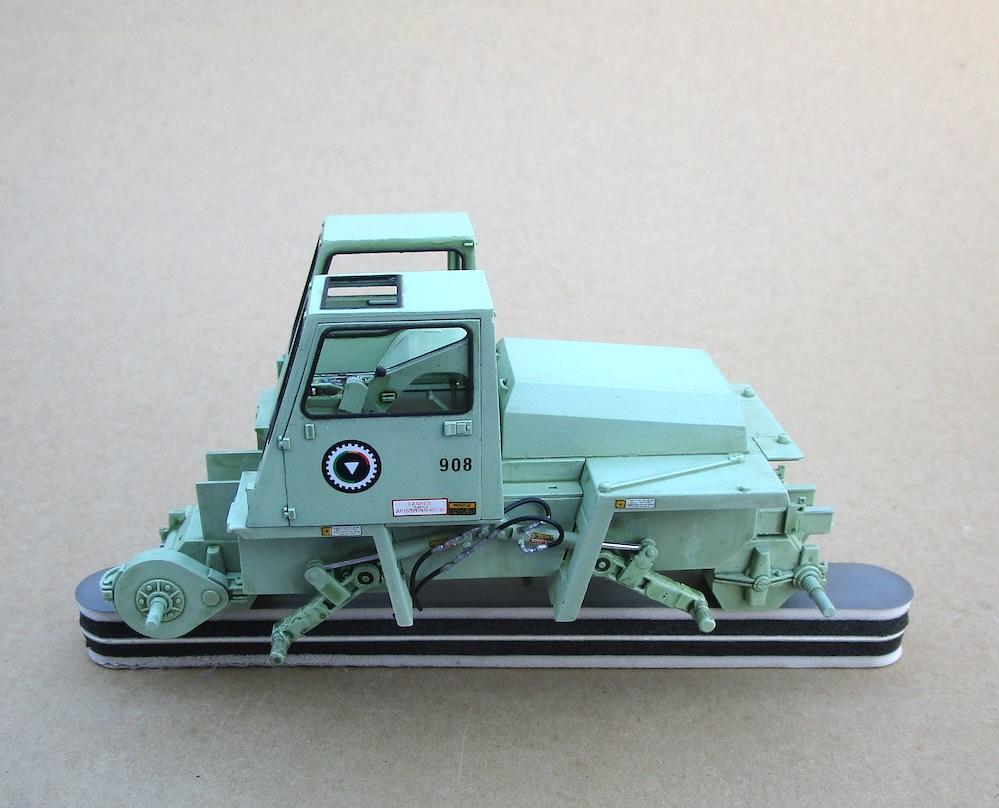

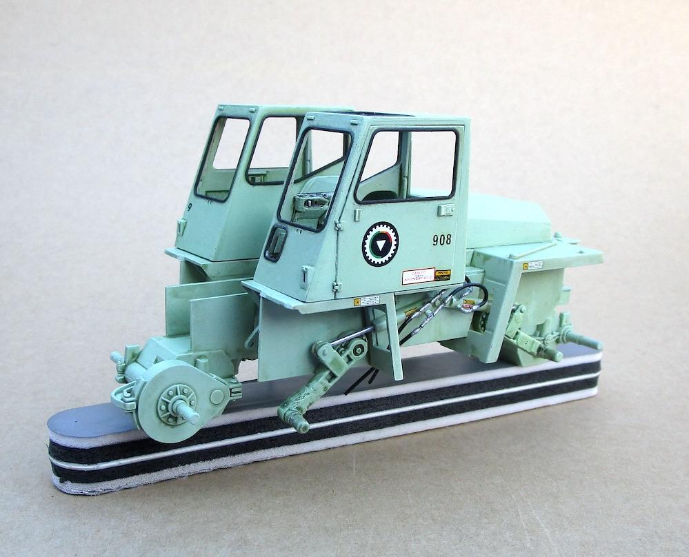

Edward Gore Posted April 21, 2024 Author Posted April 21, 2024 Dry fitting the cabs for progress assessment before glass parts are installed. Also added a few more decals to the cabs. 1

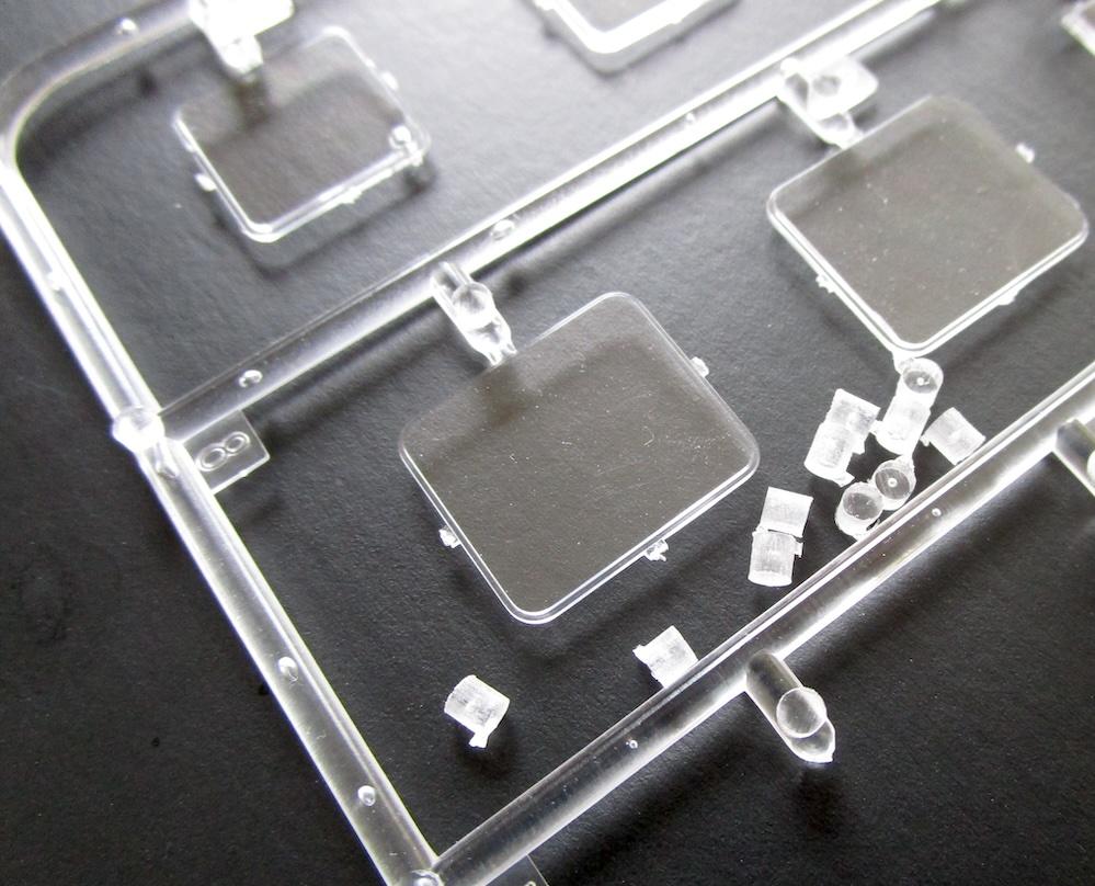

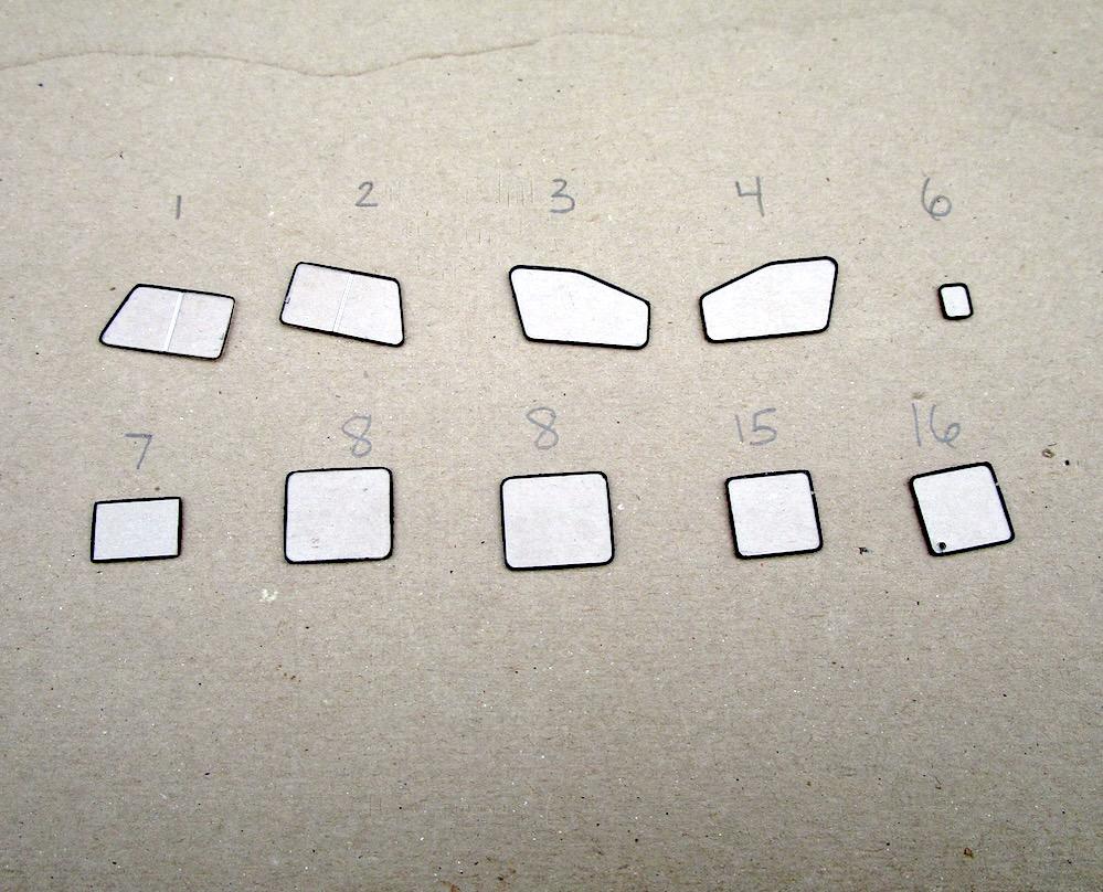

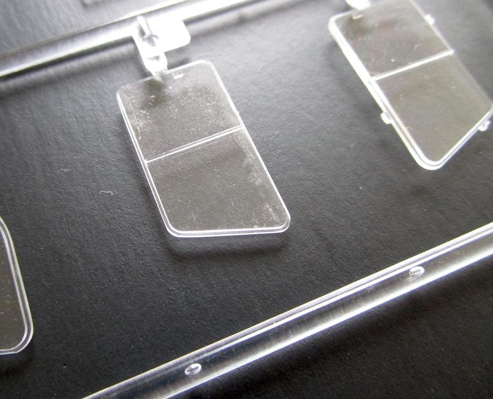

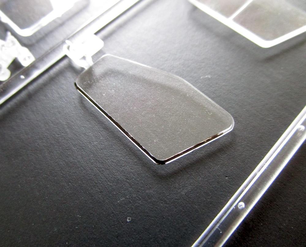

Edward Gore Posted April 26, 2024 Author Posted April 26, 2024 Started cutting all of the sprue bits from the ‘glass’ parts. There are a lot of them. Then sanding carefully with sanding boards. Then finally carefully painting the edges black. This will hopefully block the glass prism effect that would make it look toy and out of scale. This is just the dust from sanding the parts of all the sprue gates. 1

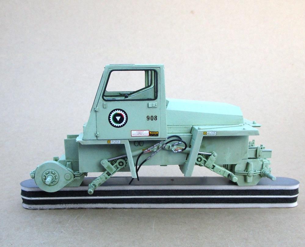

Edward Gore Posted April 28, 2024 Author Posted April 28, 2024 @cifenet, Thanks! I was going to install the 8 wheels for the photo but forgot ?

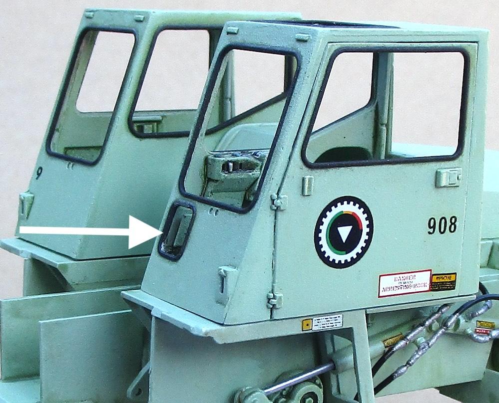

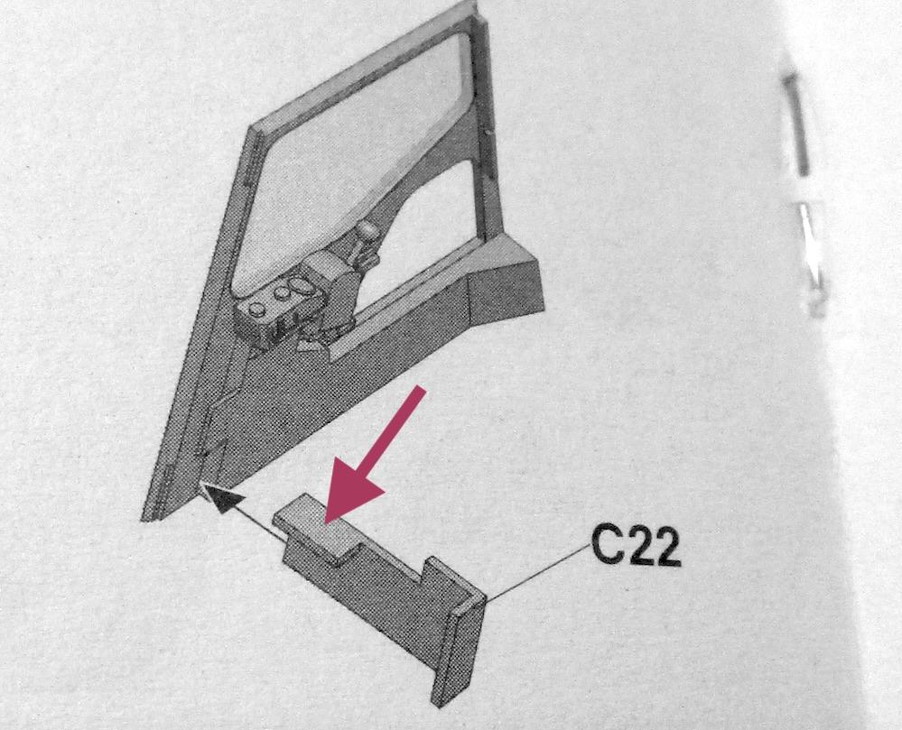

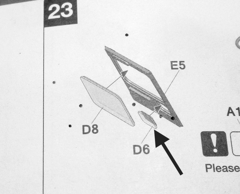

Edward Gore Posted April 28, 2024 Author Posted April 28, 2024 ‘Glass’ part D6 didn’t fit because of part C22 at the arrow (see arrow) for clearance. I had to pull part C22 out then glued it back in after glueing in D6.

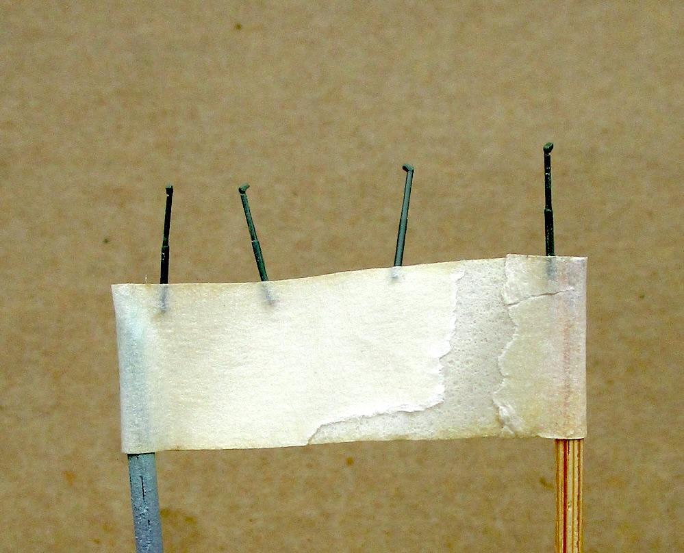

Edward Gore Posted May 4, 2024 Author Posted May 4, 2024 Cleaning the tiny G43 parts was actually more challenging than painting them. I’ll touch up the ends that are under the tape with the outer strut color by horse hair. thanks for looking... 1

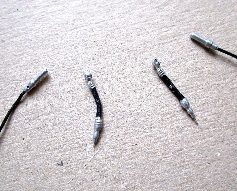

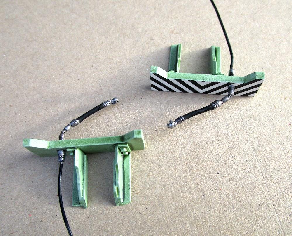

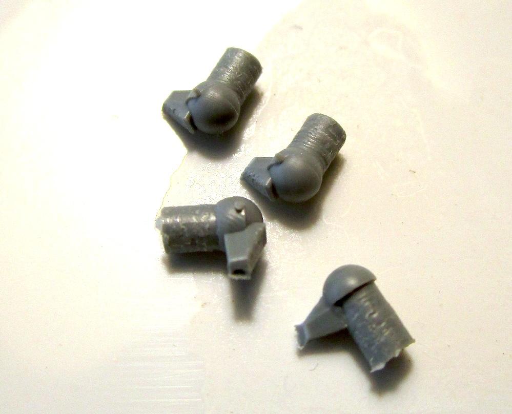

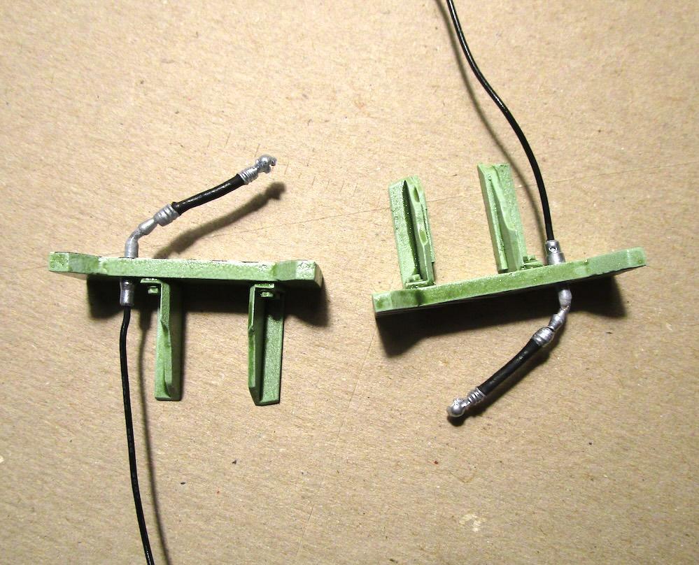

Edward Gore Posted May 11, 2024 Author Posted May 11, 2024 Back to the pilots and the air brake couplers. I made these from sprue bits and disposable lighter parts. Then painted thanks for looking... 2
cifenet Posted May 12, 2024 Posted May 12, 2024 Interesting application and use of parts, I really like it. You are definitely making something very unique here. 1
gotnitro? Posted May 12, 2024 Posted May 12, 2024 Great use of random parts to add details! Such an enjoyable build to watch develop 1
Edward Gore Posted May 14, 2024 Author Posted May 14, 2024 @Gary Chastain @cifenet @gotnitro? Thank you for your comments. I'm very pleased on how those pieces and parts worked out.
NOBLNG Posted May 14, 2024 Posted May 14, 2024 Great ingenuity you are displaying with this build…and fine scratch building skills as well.?? 1
