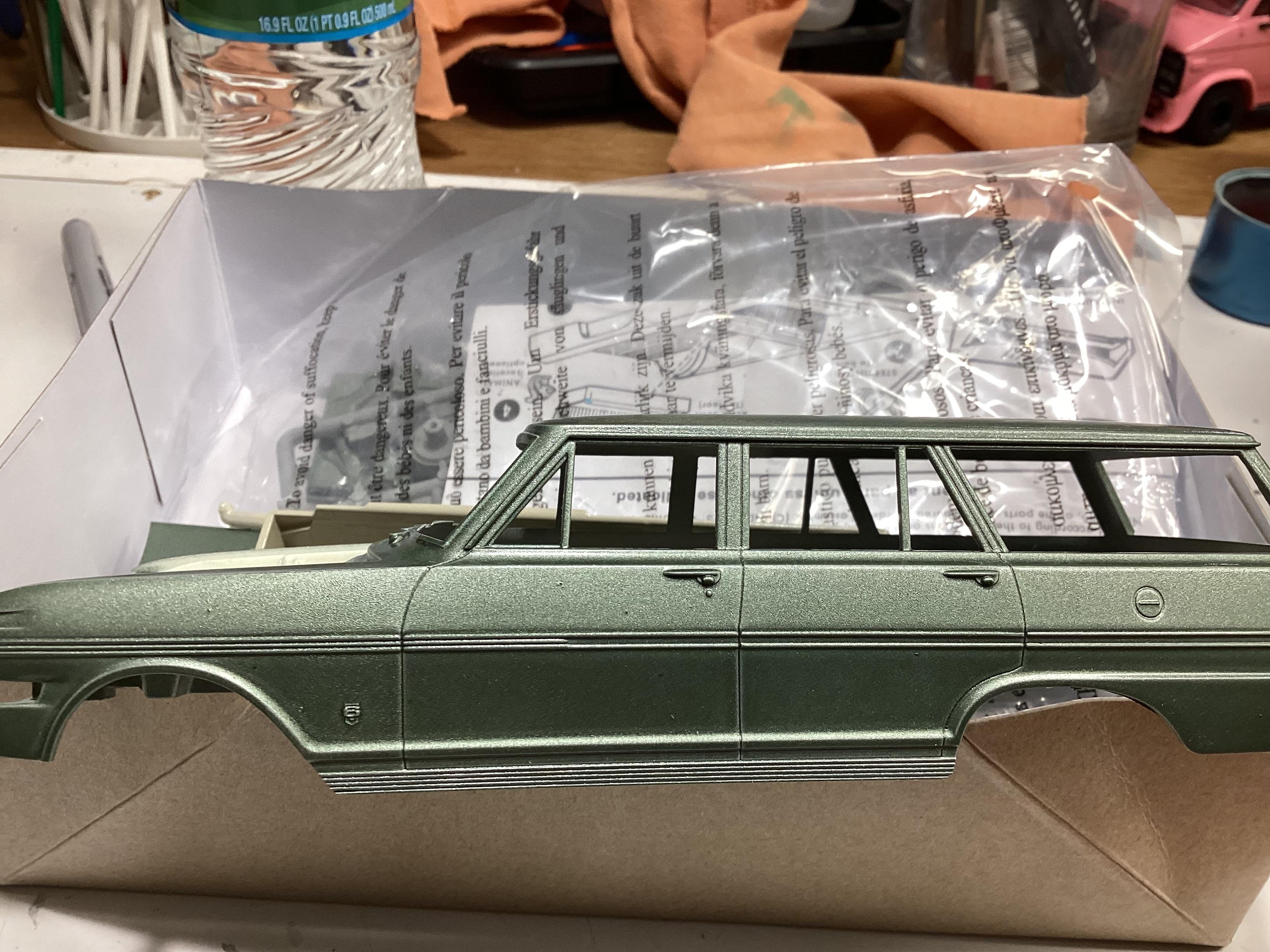

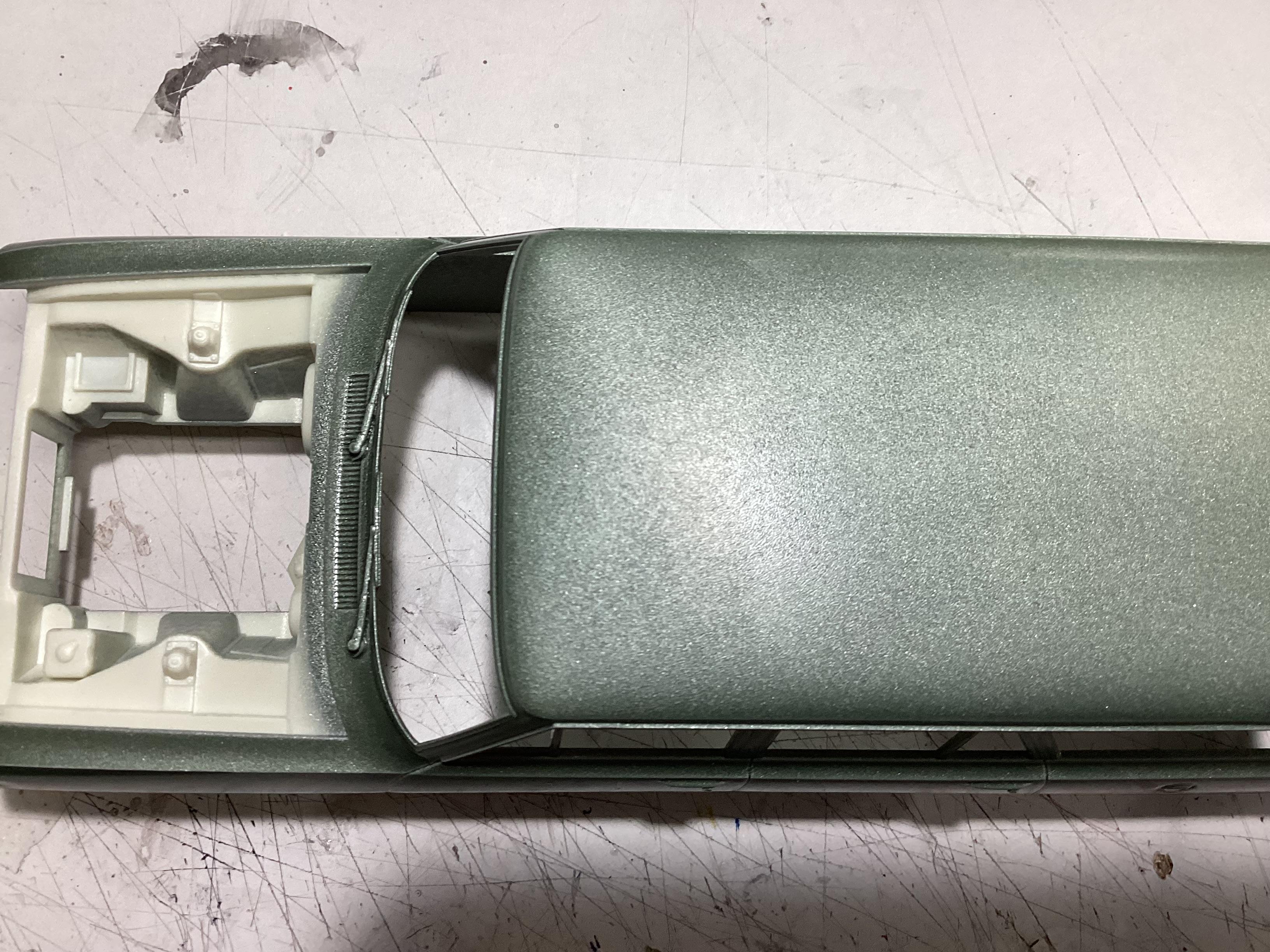

ewetwo Posted March 5, 2024 Author Posted March 5, 2024 This is what happens. Primer. Paint. Then clear. Won't polish out either so it's in the purple pond right now. It was special ordered paint from the parts store. My Caddy and Oldsmobiles were fine. Same paint. Different batch of primer. 1
stitchdup Posted March 5, 2024 Posted March 5, 2024 if you still have the paint try and test it some scrap sprue from another kit. it could be something between the primer and plastic and it would let you know if its a bad can. I've got a tin of their filler primer that sprays out fibres of primer instead of what i would call paint. its not even the same colour as filler primer usually is
