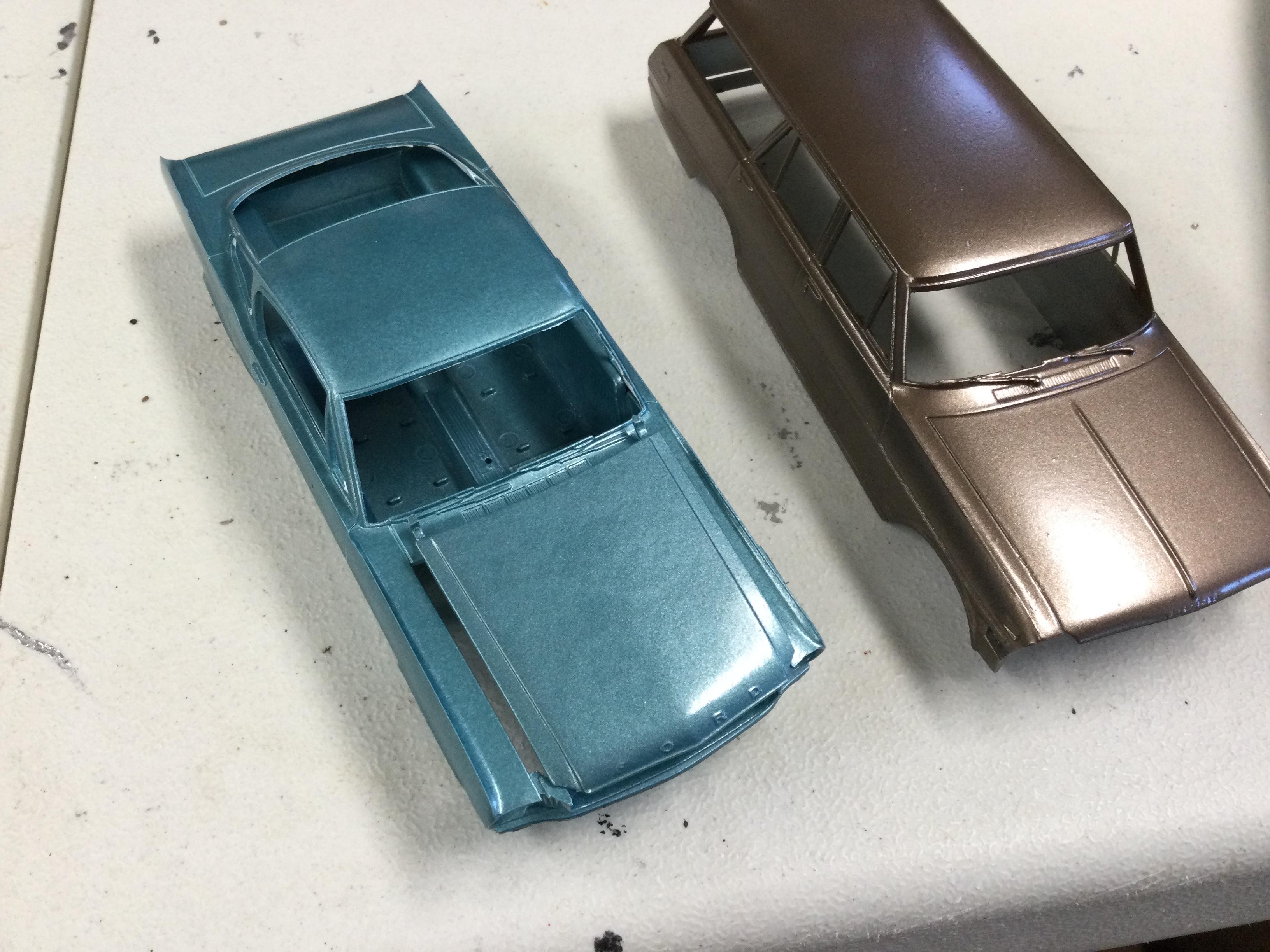

ewetwo Posted March 15, 2024 Author Posted March 15, 2024 The Saga continues. 3 light coats of primer followed by a slightly heavier coat. 15 minutes apart. All 3 looked great. Though I wasn’t use to seeing the primed bodies looking like they had talcum powder on them rather than how they looked with the primer I used before. That looked like primer on a real car. A little sheen to them. Sprayed multiple light coats of paint waiting 15 minutes between coats. Just like I did with the primer. Mustang looked great. Then I noticed just the hood starting to change. Not good. Ford looked good. I’m thinking a good polish and that would be presentable. The Nova? Horrible. I threw the hood into the PP as I knew that paint had to come off. Well not soon enough as it etched the hood. Not completely. Don’t know if I could sand it and re-prime and re-paint it or not. Might have to beg for a hood if not. The Nova? Maybe a junker for a junk yard. Ugh.

ewetwo Posted March 18, 2024 Author Posted March 18, 2024 I am going to Carl. Just got my polishing compound. Try and shine them up. ?
