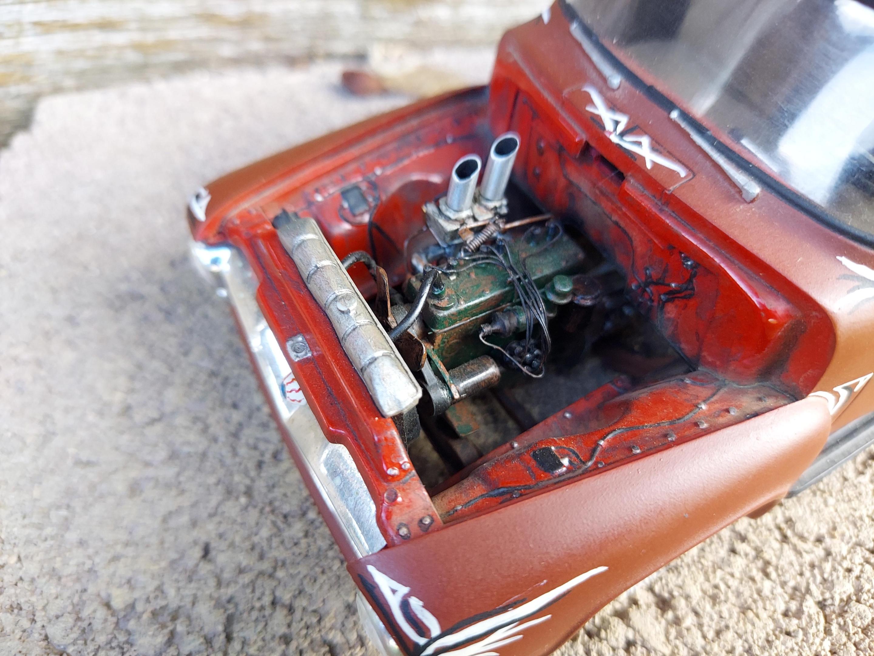

Rbray47 Posted April 4, 2024 Posted April 4, 2024 I used the straight 6 out of the amt 41 Plymouth. I rearranged a few parts to make it look like a Ford engine if you squint. So I'm sure other sixes will fit too. I deleted the metal wire axle by using stubs glued into the brake drums. 2 1

stavanzer Posted April 7, 2024 Posted April 7, 2024 Here is the engine from the Ford Truck. Looks like a long transmission.
