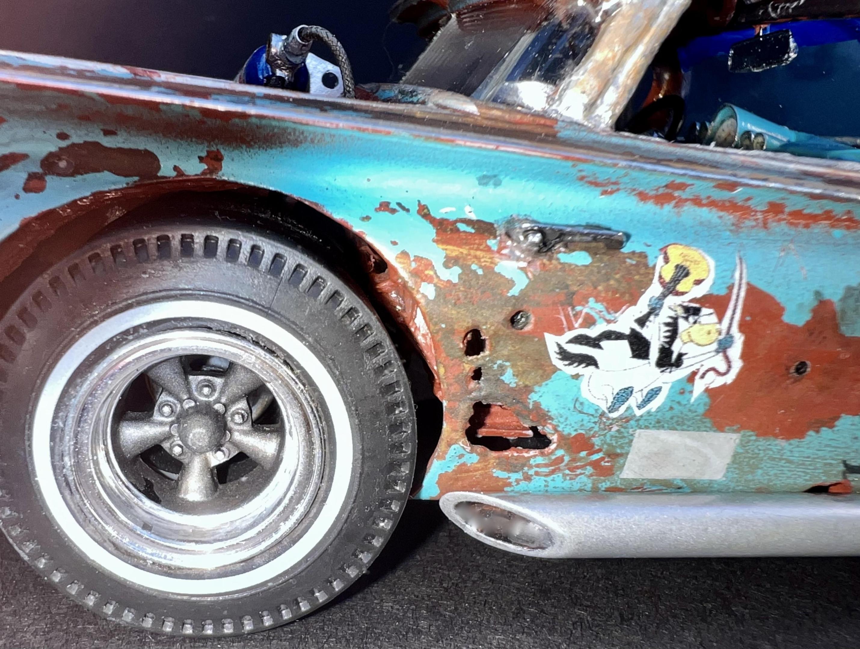

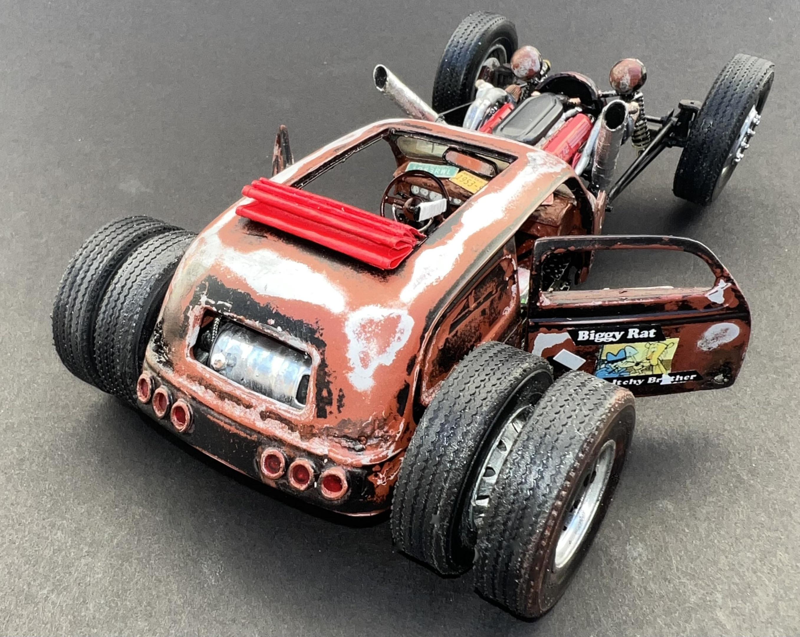

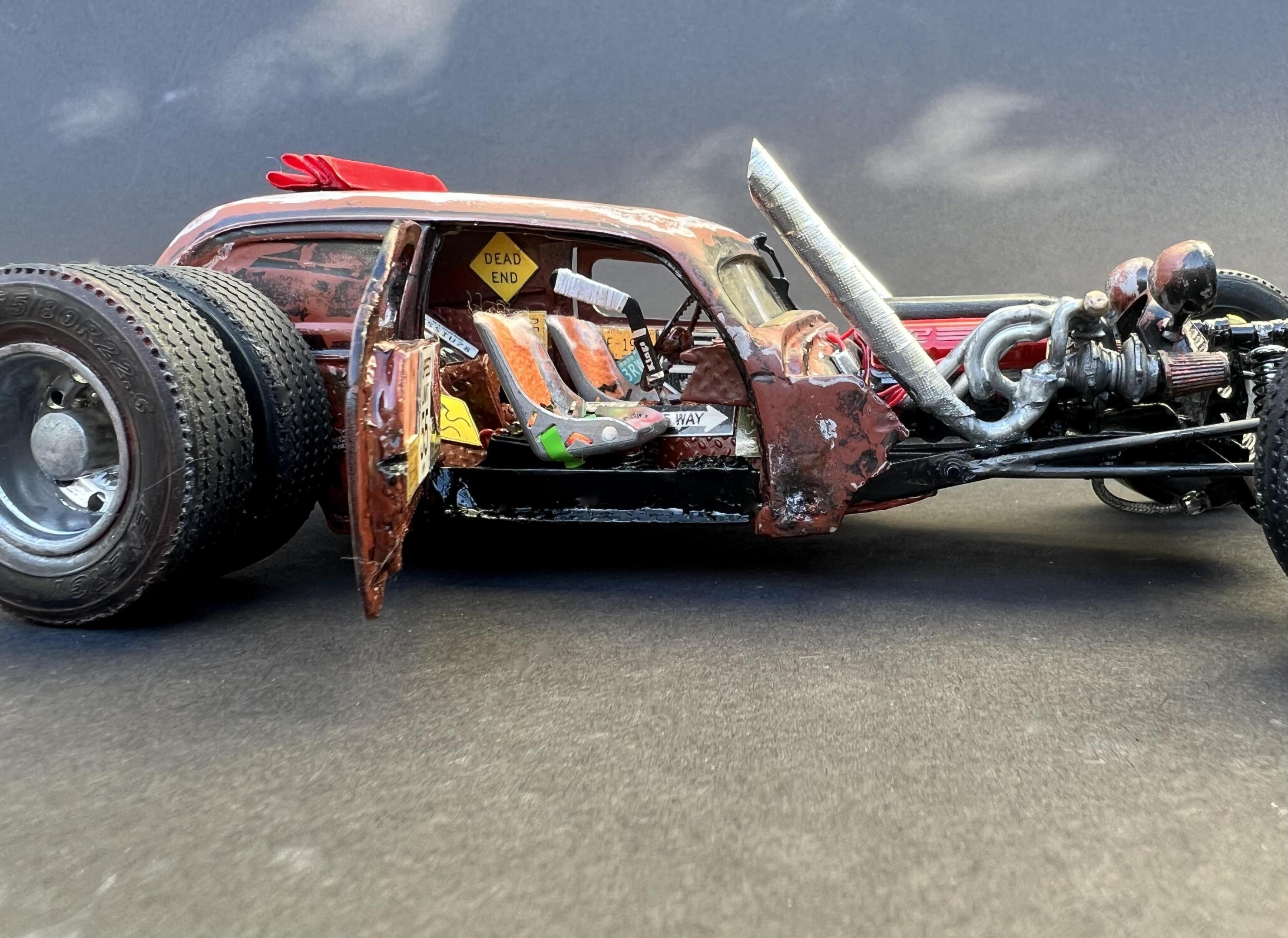

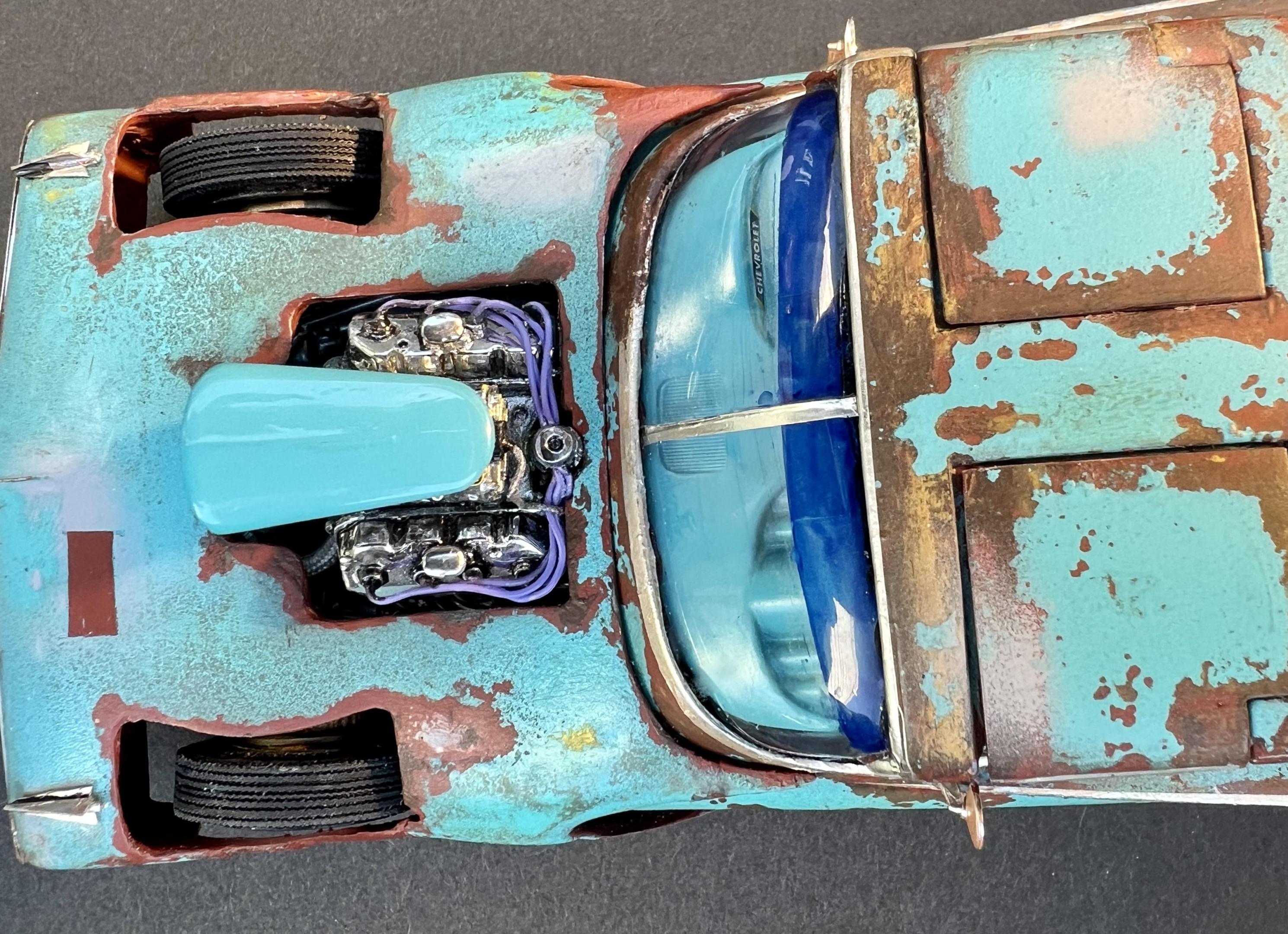

Sure - see pics below of two of my favs, El Kabong ('59 El Camino) and Biggy Rat ('38 Ford Van). I used a “hybrid” rust technique of Elmer’s glue and salt in the following order;
1.     Prepped body and applied Mr. Surfacer 1000 primer (gray)
2.     Created rust damage and holes with various drill bits and Dremel tools
3.     Highlighted holes and rust damage using various shades of dark browns, yellows, and reds and mixed a variety of rust colors then dabbed inside of holes and areas then covered those spots with more Elmers glue and salt to make distinctive layers
4.     Sprayed the entire body (inside and out) with Red-Oxide Primer (Ace Hardware)
5.     Applied more Elmer’s glue and salt to major body seams and around door panels, holes, spots, and damaged areas. Painted several layers of gray and red oxide in a few spots; some areas even got a sprinkle of fine salt powder
6. Then, I applied what I envisioned was left of the original paint jobs after years of weathering, sun, and DYI fix attempts (see small patches). El Kabong - Sprayed body sections Tamiya Dark Green and Tamiya Coral Blue through vignettes and masks cut in cardboard sections. Biggy Rat – same process but using black instead of green and blue. Also, hit them again with small shots of gray and red-oxide primer in a few spots
7.     Removed glue & salt with a toothbrush, used different grits of x-fine sandpaper, and steel wool to highlight areas. Be careful to go through various layers, but not all the way through!
8.     Dabbed rust particles made from steel wool & vinegar mix in a few holes
9.     Applied custom decals
10.  Dullcote over the entire body
I hope you found this interesting. I also grew up in the mid-west and saw a lot of road salt damage and rust.
All the best,
Steve

Thanks for such a detailed response. It's so interesting how different everyone's technique is, when it comes to rusty & crusty.
