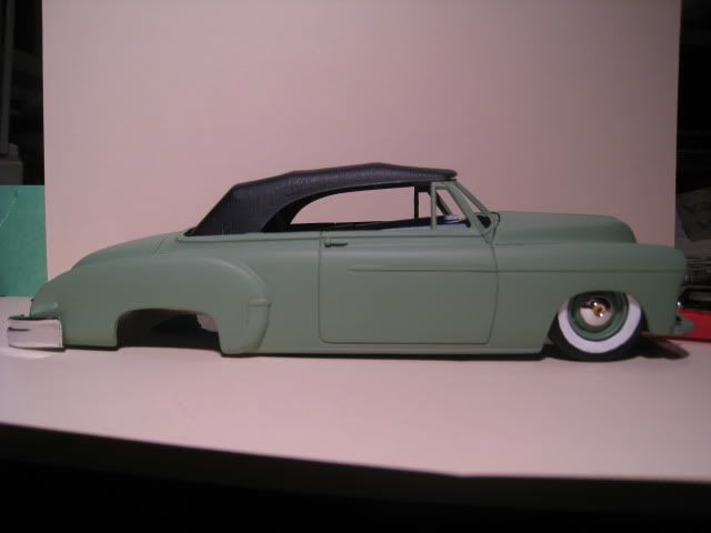

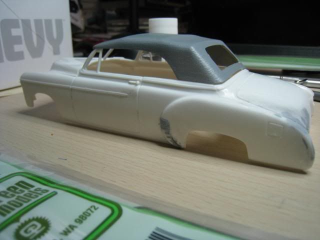

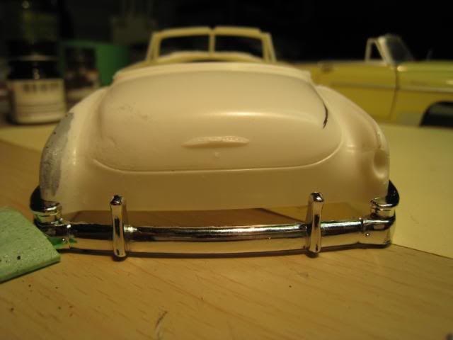

First thing I have done is strip the trim from the front fender, and started reshaping the rear fender and trunklid. The correct bumpers are from the diecast...

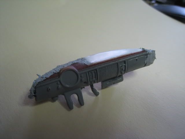

My areas of concern are the back window, the rear fenders, the dash, and the side trim. I finished one of the side spears using .040 Evergreen strip. This is the first time I have used Evergreen, and it was easier than I thought it would be. The dash that I have from the die cast is too narrow, but after looking at the real deal, the fix is going to be fairly easy. I thought the whole dash was smaller, but it appears that it was shortened on the glove box side to fit. The radio grille was off-centre in the diecast, and it will centre up by extending the dash on the right side.

I love building old family cars so gonna be keeping eye peeled on this. Looks like a good start. Looks like a decent fit on that rear bumper.

Thanks for the comments, guys... Yes, it will have the straight six, with three on the tree. The rear bumpers are off the diecast, and have the correct guards and optional corner guards on them. Right now they stick out a bit too far to the rear of the car and will require som trimming to tuck them in closer.

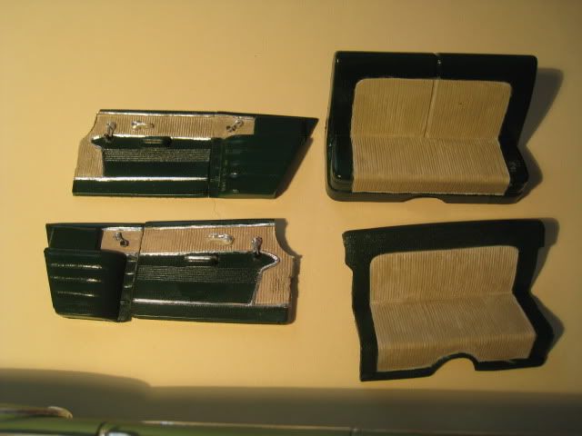

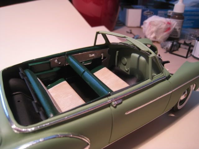

I started to piece together the interior last night. The seats are from the diecast, with a lot of trimming. I may still have to section the rear seat. The rear panels are from the '51 kit, and the fronts are from the diecast with the upper trim from the '51 kit. The dash has been all stretched out to fit the body. I cut the top of the AMT'51 dash to fill in the curve against the windshield, and lengthened the glove box side to centre the radio grill with the centre line of the car (It was off centre in the diecast car)

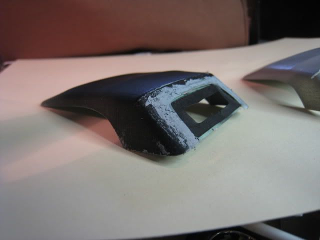

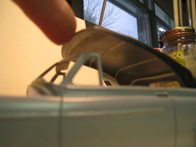

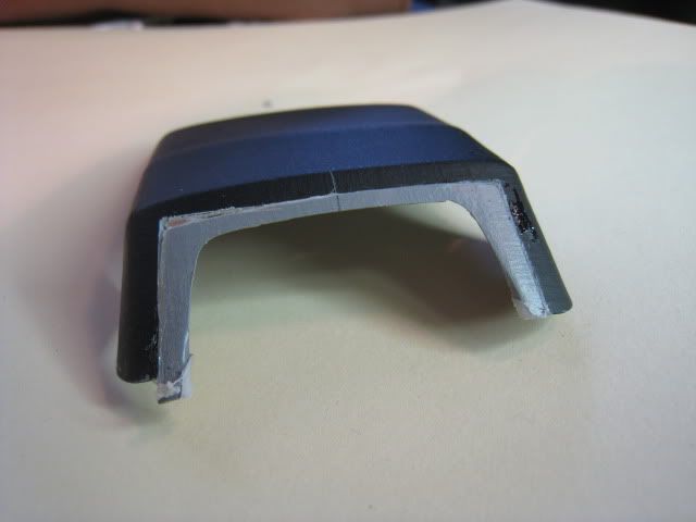

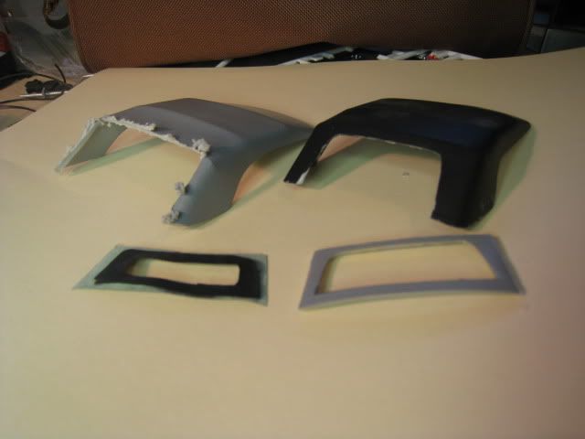

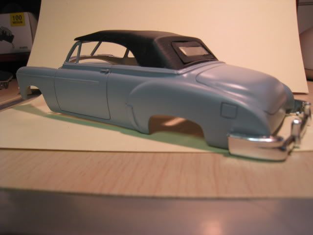

Last night I tackled the roof issue. The back glass is from a Jo-han 1931 Cadillac Cabriolet kit. It is a bit too big yet, but I don't want to risk sanding it down and ending up with something not straight. The canvas zip up is masking tape, but I am going to re-do it so it goes right to the bottom of the roof and attatches at the belt line. Another thing I did was reverse the angle of the edge of the beltline where it touches the roof so that it is angled parallel to the roof angle. Now the top comes from under the body, like on the real car, instead of sitting on top of the belt line like the kit does. I primered the body, but still have some smoothing to do...

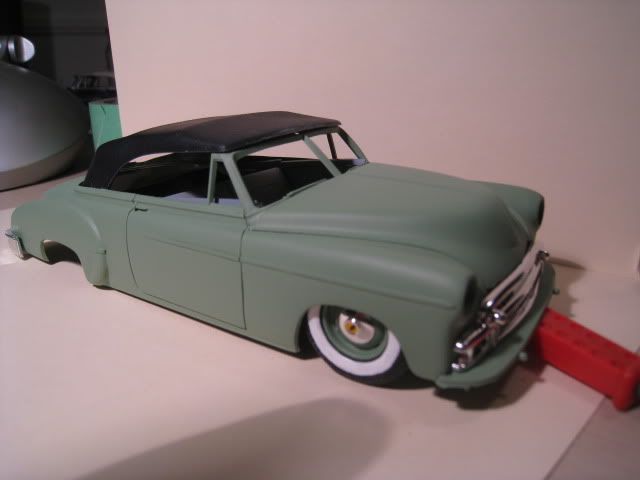

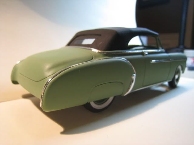

I took a couple weeks off and went to Europe on vacation. (Lots of donkeys, but few old Chevies in Moracco!) I'm back into the swing of things here now that work has settled down again, so it's back to the work table A trip to my parents house, and my first paint job by airbrush is done. I'll be doing a little body work and going back for another couple coats, but here is the first attempt. The colour is Tamiya Pale Green, mixed with white. It is a flat colour, so I will be clearing it after.

I also forgot to add that I fixed the rear of the roof. The kit has a solidpiece that runs below the window, and the entire opening is too high. I didn't want to lose the shape of the opening, so I cut the entire window and moved it down, and filled the gap at the top. I still need to redo the fold down part in the tape, as it has a wrinkle in it.

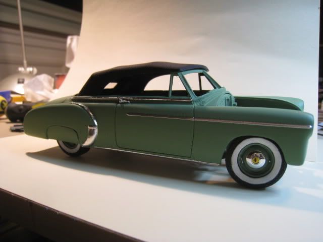

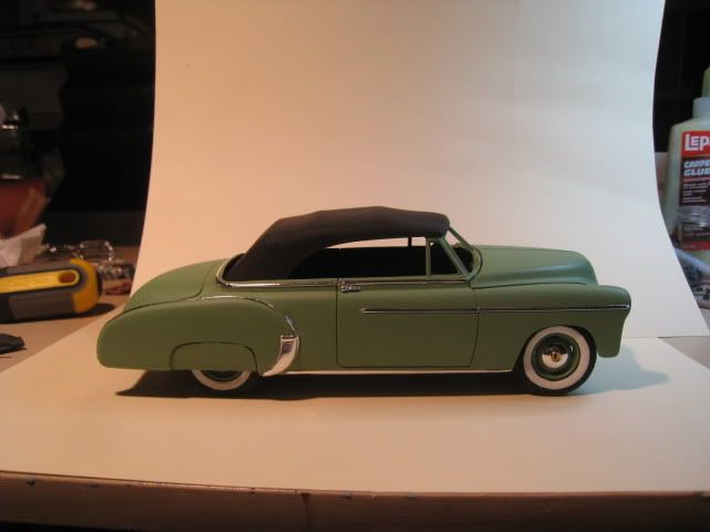

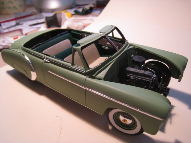

I've finally got the interior sorted out... The paint was giving me fits, as I couldn't match the Beige to what it should be like, and I kept getting it running with the green. The paint is Tamiya acrylics... I airbrushed the green, and hand brushed the beige over white. Then I had to touch up the green by hand. The interior panels are just the plastic from the die cast. The back seat and window garnish are spliced in from the '51 kit.
