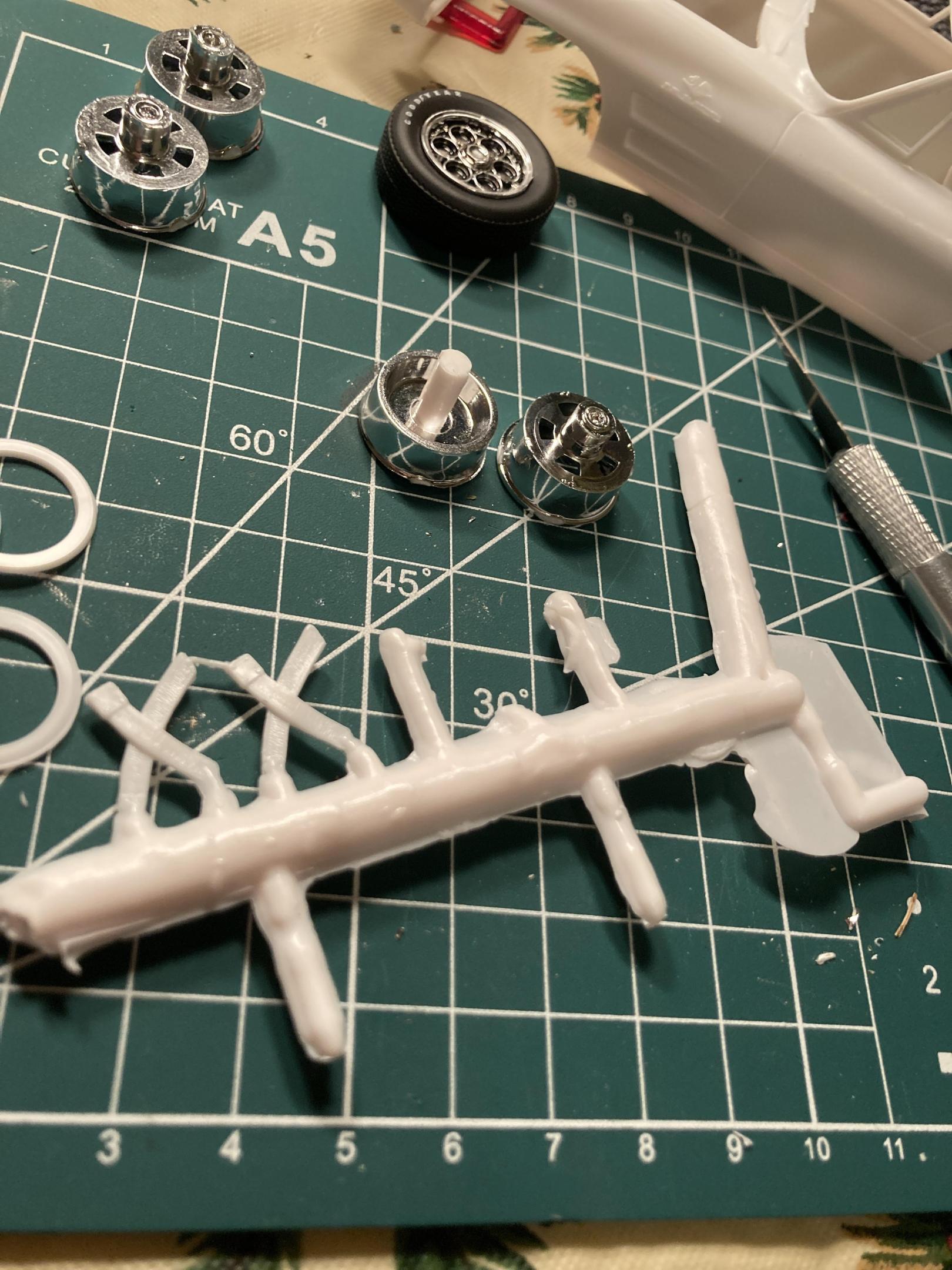

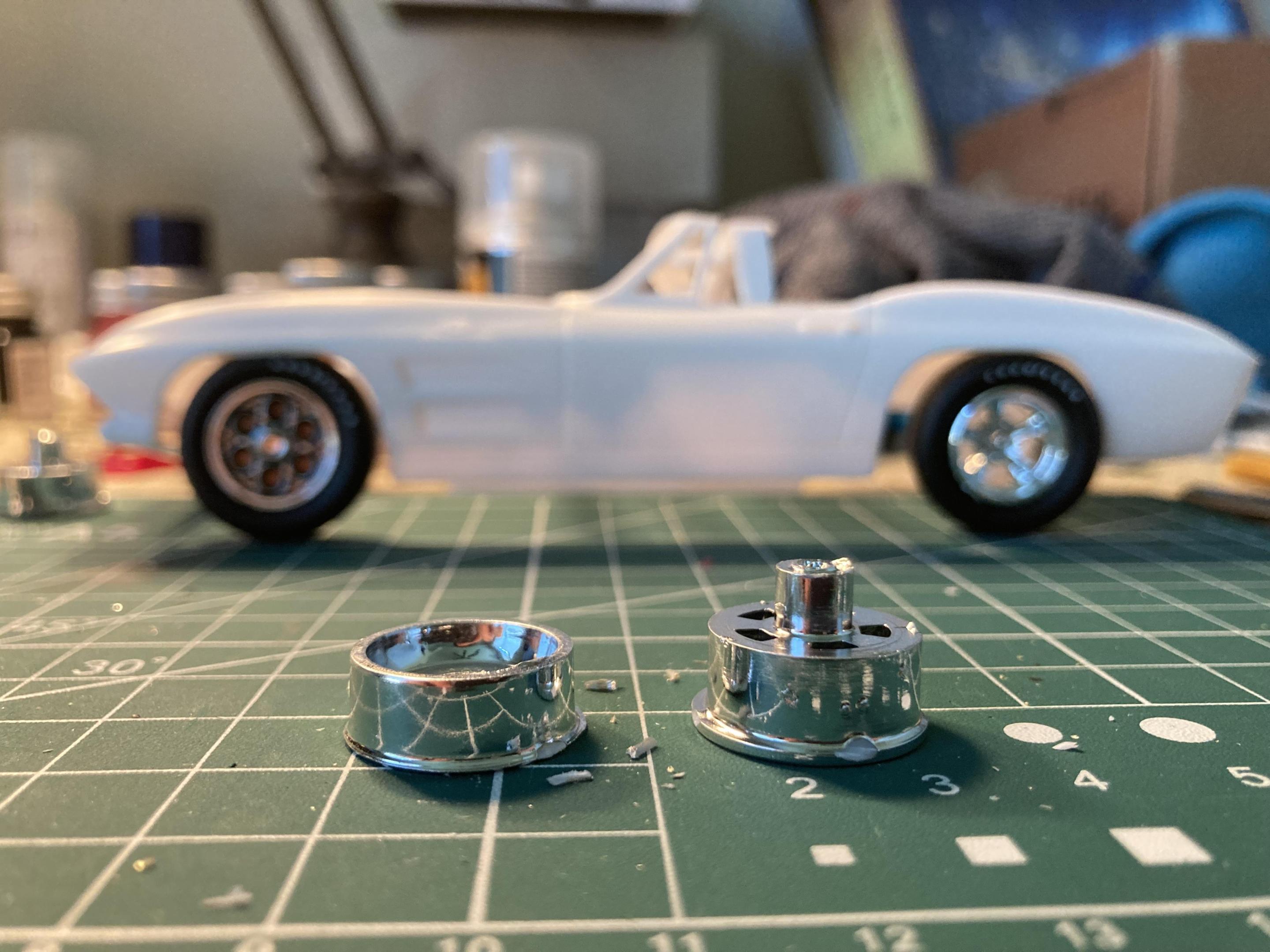

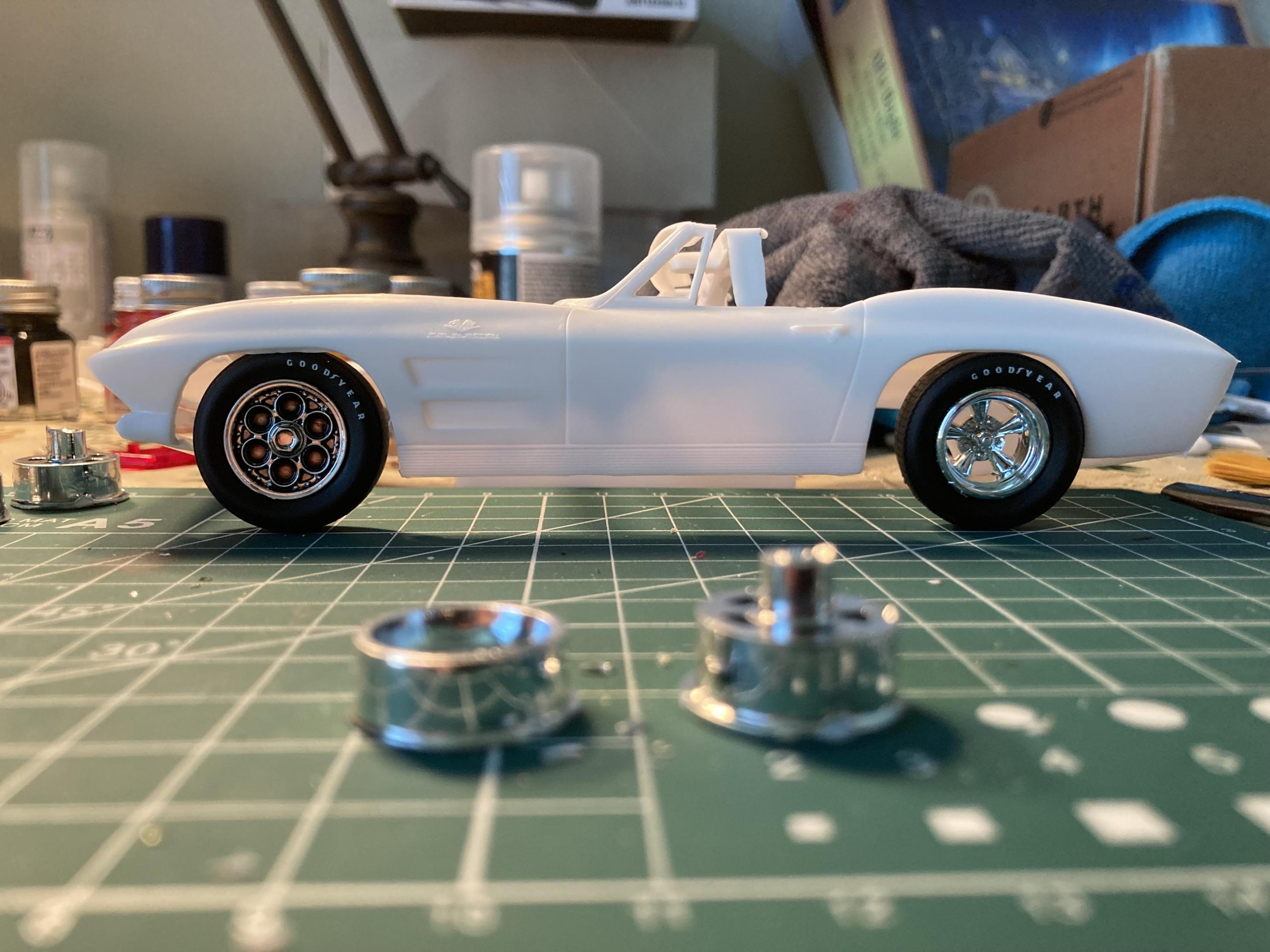

Milo Posted April 24, 2024 Posted April 24, 2024 (edited) I genuinely hate the wheels that my corvette kit came with, because I’m going for a clean and mostly stock model. Sadly the kit didn’t come with the classic c2 vette wheels, and I’m really bummed about that. So I went to another kit, and figured that anything is better than what they’ve given me, and I really like the wheels depicted on the left. The one on the right is from the corvette kit. As shown next to it, the wheel on the left (from another kit) does not fit with the kit. Any way I can actually make this compatible? The kit uses metal rods. Edited April 24, 2024 by Milo
Ace-Garageguy Posted April 24, 2024 Posted April 24, 2024 (edited) It's often pretty straightforward to swap wheels from kit to kit, even when the design of the backs is that different. ONE way with those would be to cut off the protrusions the metal axles plug into from the kit wheels, and attach them to the wheels you want to use...paying attention to axle width and the resulting depth of the replacement wheels in the body. You may need to measure and add spacers to get everything right. OR...you could make receivers for the metal axles from appropriately sized styrene tube, and just glue them to the backs of the new wheels. Those are just two possible solutions. There are many ways to do it, clean and easily. Edited April 24, 2024 by Ace-Garageguy 1 1
Oldriginal86 Posted April 25, 2024 Posted April 25, 2024 This is why I like the two piece wheels. You could use the wheel of choice(within reason) and the wheel back from the kit. I despise the new style (Moebius type) wheel. And to the OP, the wheel from the other kit appears to need a wheel back. Do you have the other kit the wheels are from? 1
