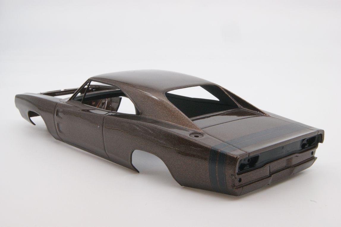

This kit is from Revell 1/25 scale.
After my Charger was finished in the Race version, I continued straight away with the Factory Stock version. I usually paint the body first
because that's the biggest thrill for me, making sure nothing goes wrong. I also have a second engine with an engine stand. I want to upgrade this again with
metal parts and ignition cables. I just ordered the parts for this engine from Mr.Model in Brazil. A new chrome color for me should arrive in the next few days.
This is Super Chrome from AK. I'm curious to see how this can be processed. I completed the engine for the compartment in the car on this weekend.
The decal for the air filter was a disaster. Despite warm water, decal set and sol and using a hairdryer, it cracked when applied. The stripes over the rear, on the other hand,
were quite easy to apply (seen for this kit).

the Super Chrome from AK is really good to spray. I brushed the first parts with my airgun.
The last 2 evenings I applied the bare metal foil for the window frames and used Molotow chrom pens for the lines at the rear of the car.
The rear bumper is painted with Exreme Chrom. At the picture the shiny surface is not so good to see than in the reality.
The exhaust pipes are bad. Square, the end not open and at both sides signs from the mold. I opened them with a round motorized cutter and painted them in chrome and black inside.
Now I have a choice between 3 different rims and wether I should use the red stripes on wheels. The right ones are similar to the rims of my Mustang Boss 351 from Revell (a new kit I bought today). I think I prefer the middle rims with the red stripes and paint the wheel caps in a not so shiny chrome. What do you mean?
