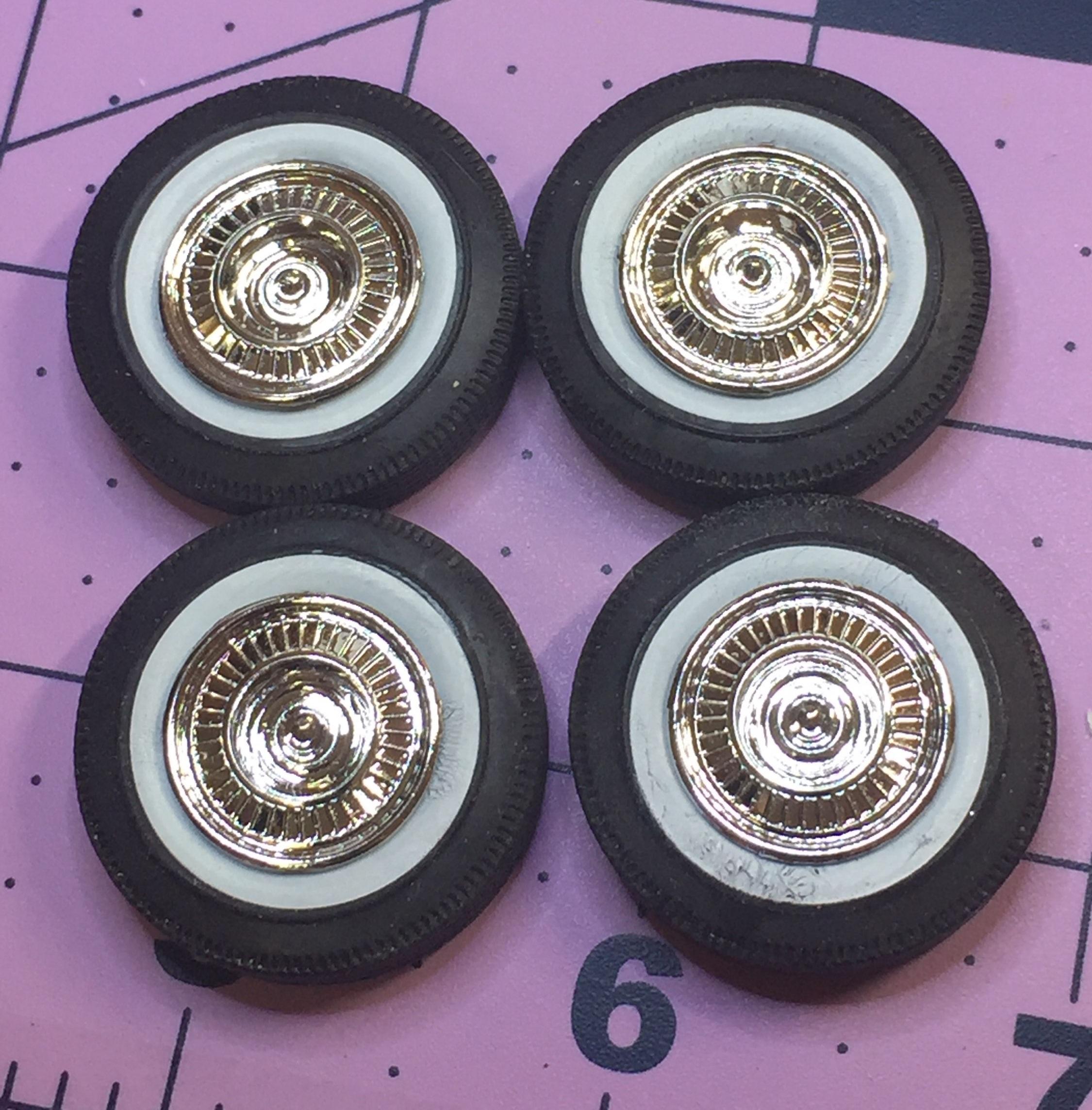

 I think it makes the tires look too big. White walls would help. Gotta look in my stash.
A T-Bird with flotation tires
I love it! :D
I love it! :D
David G.
Oh David....yes it does look like it's ready for a day at the lake. This is the inners without the outers- they kept falling out ?. But never mind, I  cracked open one of my....wait for it.....'41 Plymouths and lo and behold....
WHITE WALL TIRES!  I remembered this from a previous endeavor( that I still haven't finished ?.)  Perfect fit!

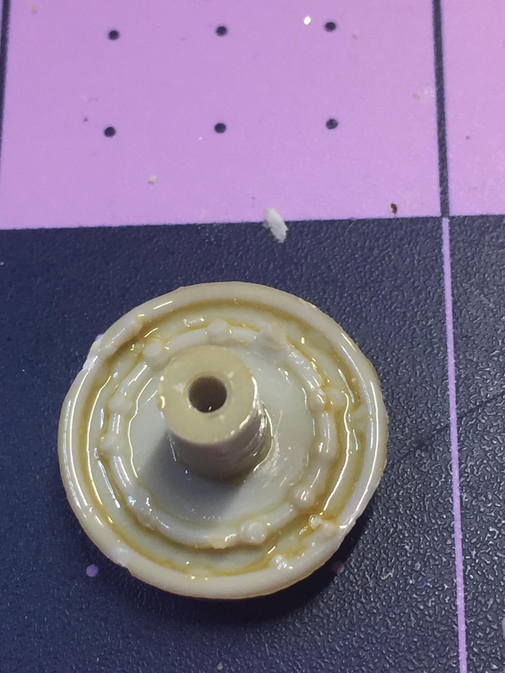

It seems my inner wheels have contracted a case of Monkey Pox.

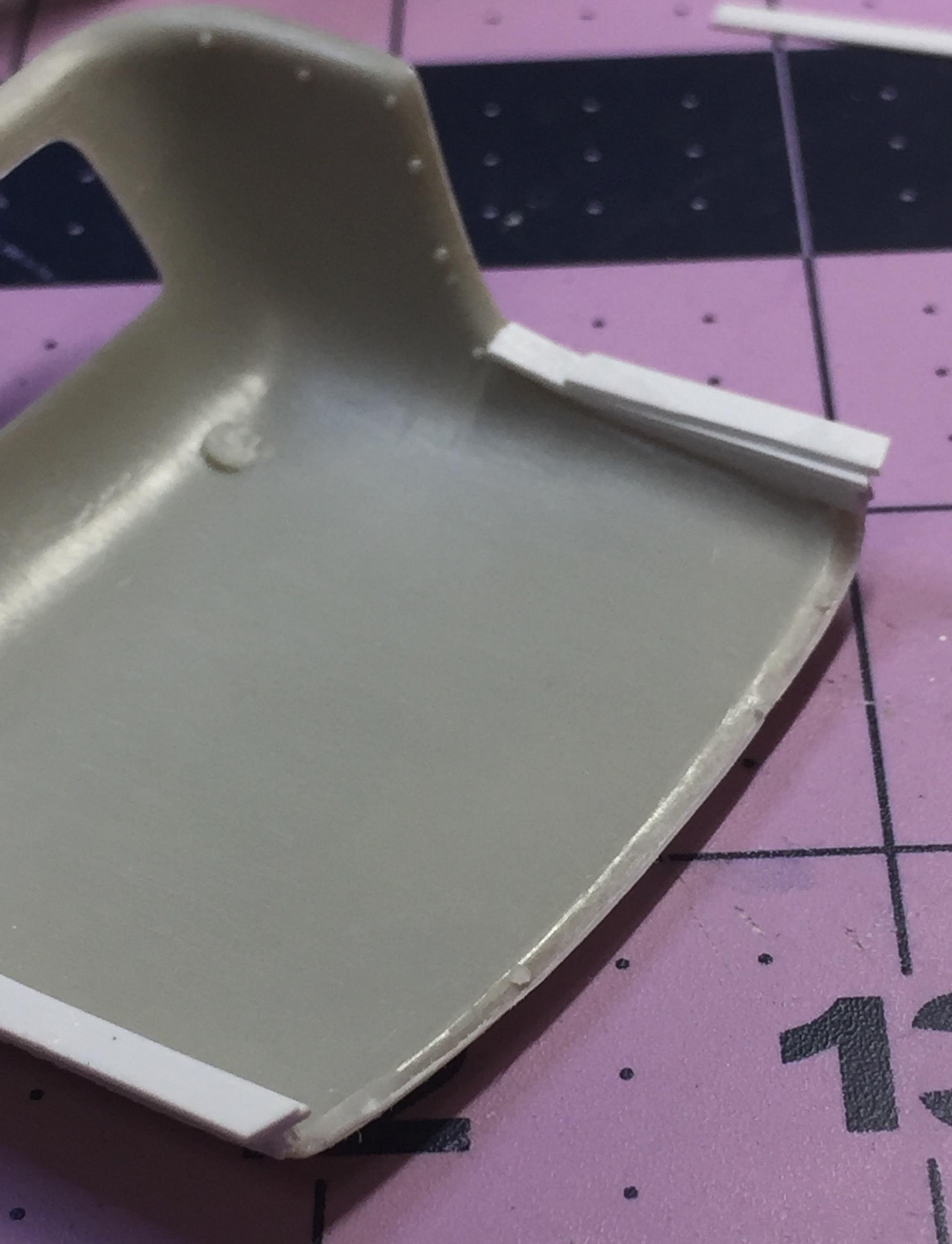

Well, after some moderate fiddling I got the hood hinge to work reasonably well. I know, but I had to try.  There was no spring clip in the box so ....anyway, this project continues to provide me with a fair amount of "fun" so maybe I'll finish this one.  Note to self: replace radiator tank.

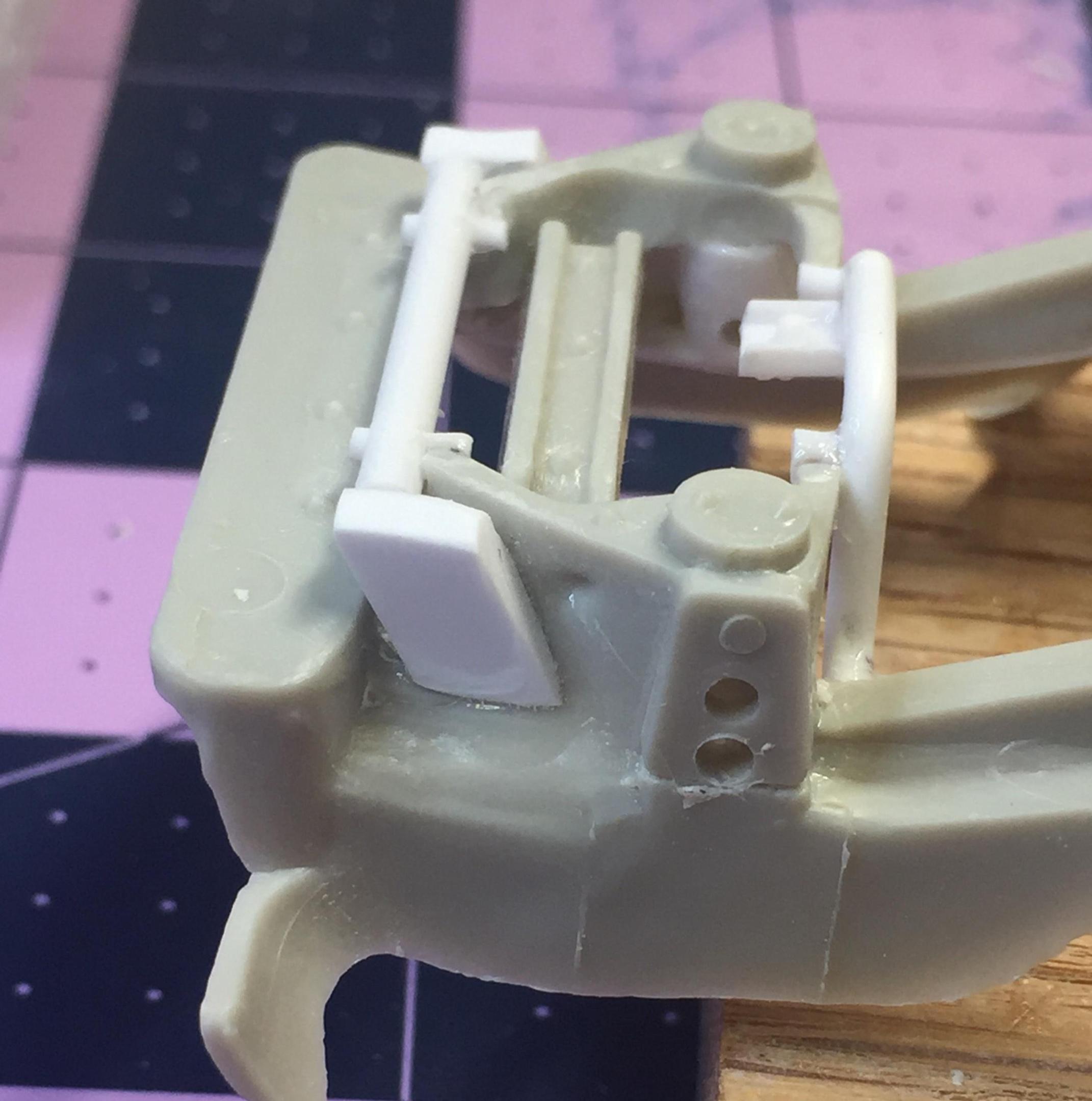

A bit more improvement on the front of the frame. I wanted the lower A-frames to attach to something so I faked a front cross member and frame horns.  It's about all I could do for it.
IMG_6269.thumb.jpg.7cf8bea48e5fa4f041d75138ea009c24.jpgIMG_6268(1).jpg.8d813ef729c54d73b14df8fbbe57e660.jpg

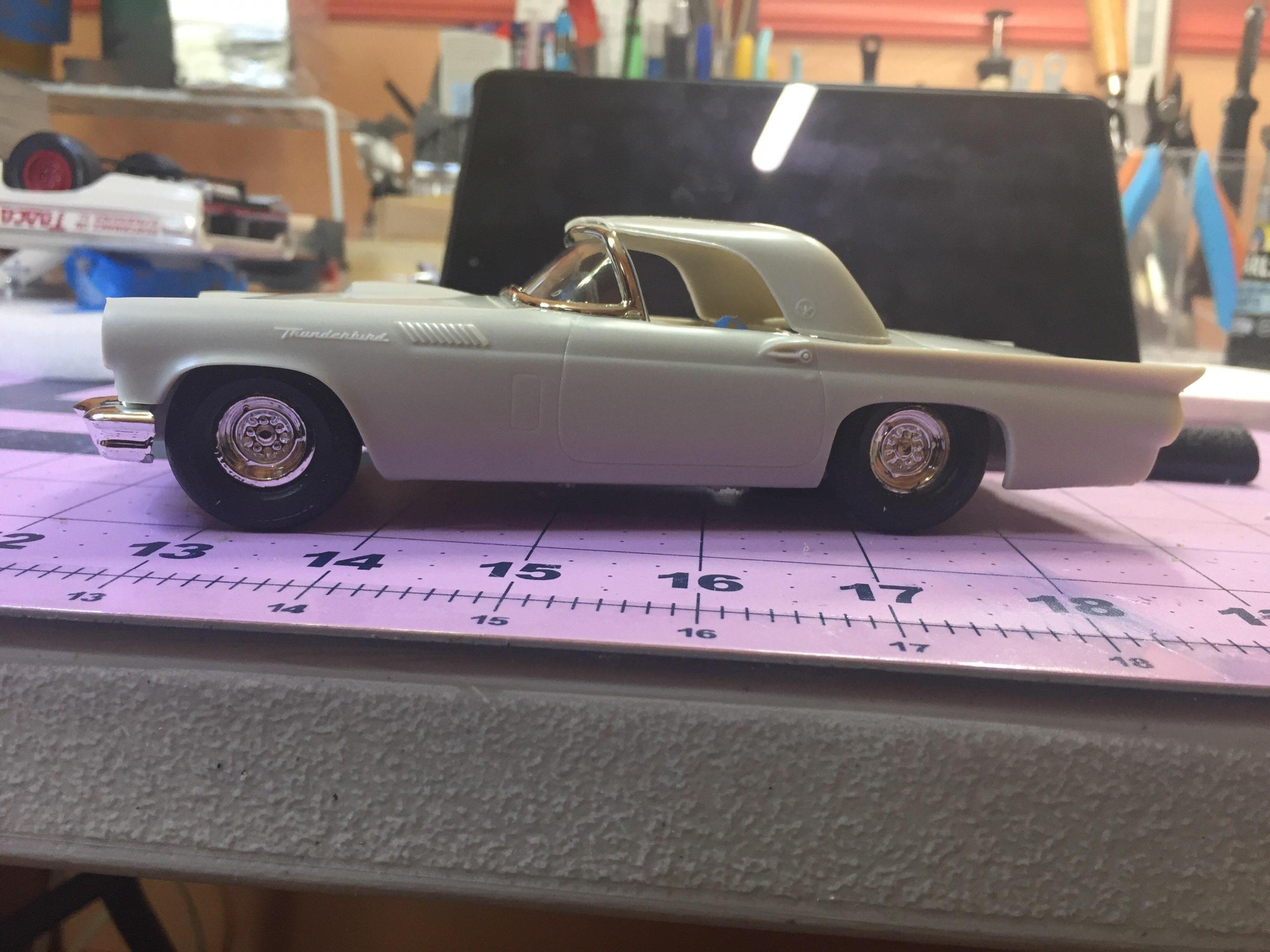

Anyway, here's some mock-up pix for your inspection. Here I have located the rear wheels in the stock height holes and the fronts in the "lowering" holes. A little rake - good? bad?  Thanks for looking and your comments are welcome
IMG_6267.jpg.2d1464618b2e08b17952e29943b4a6be.jpgIMG_6259.jpg.9a8be2d9c27f136a73912b5623e4ca45.jpgIMG_6263.jpg.bcc2506d525034de21e736ec025229a9.jpgIMG_6261.jpg.ff32352fa6c5a2898b428914841123c1.jpgIMG_6262(1).jpg.f18580f9763fee469f79de27c6906747.jpg

I don't know, Greg, what I see now is the top of the body is level to the ground and the taper of the body to the rear makes the rake. I will need to mock it up with the skirts on and see how that strikes me. Thanks for weighing in.

The top picture says it all. I need to "improve" the roof. Is there a correct porthole roof out there somewhere? In resin, maybe? I can make vent wings easily enough and modify the roof but the porthole might be .....not much fun??  It's the chrome trim around the glass...hmmmm ?

And the tires look much better too. Though the still seem a little big compared to the 1:1 photos, sort of like 15's on a car that normally wears 14's.
The ride height looks spot-on.
David G.
Yeah, they do look too big, Dave. They are the same exact size as the ones in the kit.  I dunno, Dave, they had a 6 volt battery in it too so all they had in the boxing department that day was black wall 15s from the '41 Plymouth. But it's a pretty small car so...they're staying, dam it! ?.  I'm out of options without busting another kit.  Now.....I've been busy.....
IMG_6278.jpg.f362f65431a5b0c265a90072c45d85c8.jpgIMG_6277.jpg.b696299daf799c74b769f3985ebe71b8.jpgIMG_6275.jpg.9920c916221593cf8f89fcbde50e9ee1.jpg
Now with the skirts on its a bit easier to accept the " big feet" attitude. The bumper fell off for the side view. It may improve the look with it on.  I'm going to go back down in the rear. See how that looks with skirts. And then up on all fours...just to see ?.

Now, just some info if anyone wants a more accurate build.
1) The 56 Ford Victoria has the correct frame/suspension just needs the X member and shortened.  The AMT 56 Thunderbird is correct also.
2) The front fenders extend behind the bumper, some trimming on the bumper and extending the fenders help it out.
3) you can cut out the grill and surround and use a 56 Thunderbird grill. Grill is the same 55-57, just bumper differences.
4. Personally I am still trying to figure a tail light fix. The bezel and tail light from a 57 Fairlane is the same on 1:1 cars, The Thunderbird kit lights are undersized.
As an FYI, your air cleaner is backwards.

Thanks, Andy.   Yeah, man, I know about the air cleaner. The "D" pin on the part locates it backward.  Lots of stuff like that in this kit.  I have resigned myself to making some corrections and a few repairs of crappy molds. It-is-what-it-is. I bought this kit off of ebay in my ignorance and now I am dealing with its shortcomings. It's kinda fun, though, like resurrecting a gloo bomb.  I appreciate your heads-ups on these issues. I'm not sure I get the grille fix, maybe you could expound a bit on that.
