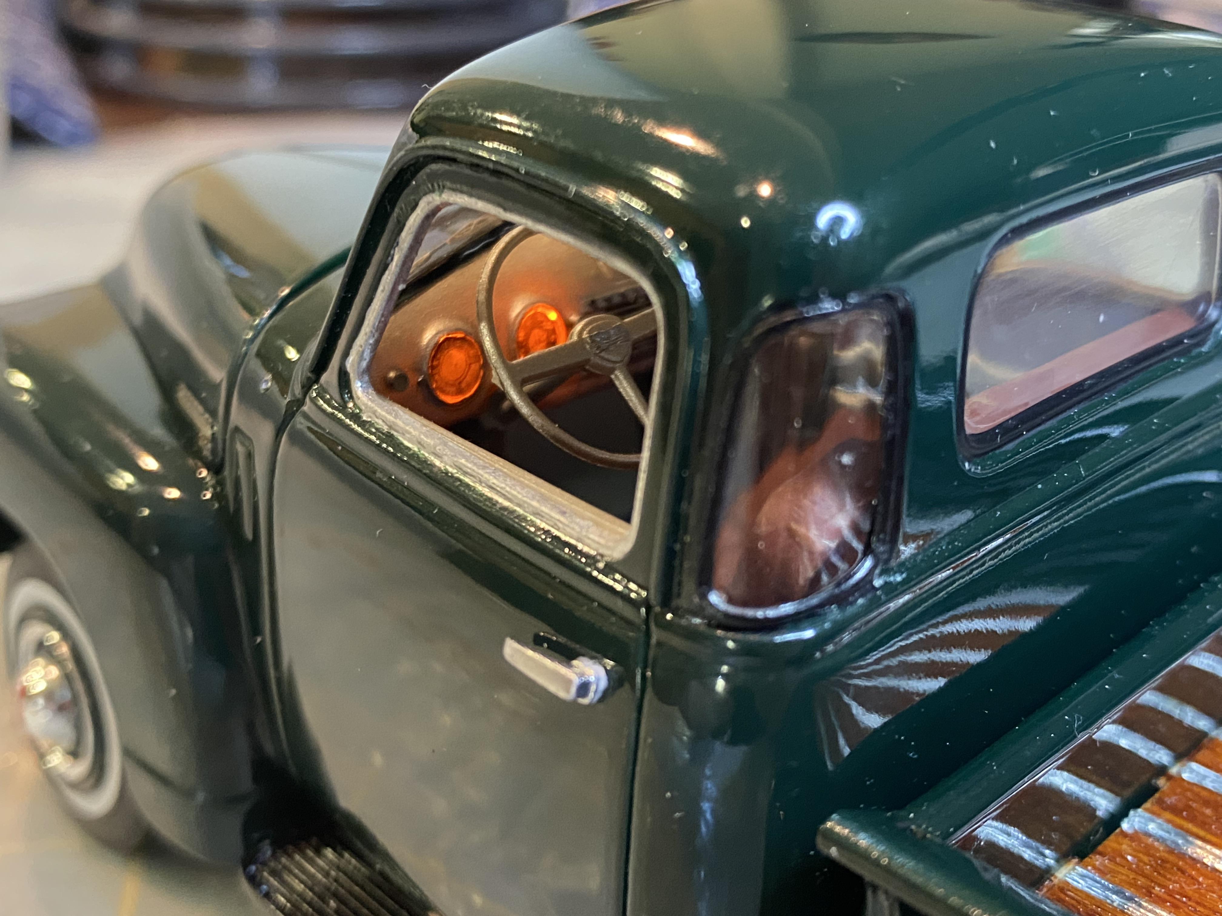

I will think about a more thorough how to when I work on my next car. It is going to be a 1969 Cougar Eliminator, so hidden headlights again.
I get a lot from Evan's Design and from Amazon. The LED lights do seem brighter from Evan's then the amazon versions, but you can get a bunch for cheap. Evan's has a car kit that includes taillights and headlights that I have used that works nicely in many cases.
Classic (Pre-68) cars really only require 2 taillights, 2 headlights and 1 gauge light so a single 2032-coin battery. Newer cars need more for the side markers. I have tried fiber optics to varied success. You need a battery holder, switch some wire and lights, shrink tubing and solder. The 2 battery holder I use from Amazon also comes with the switch built in.

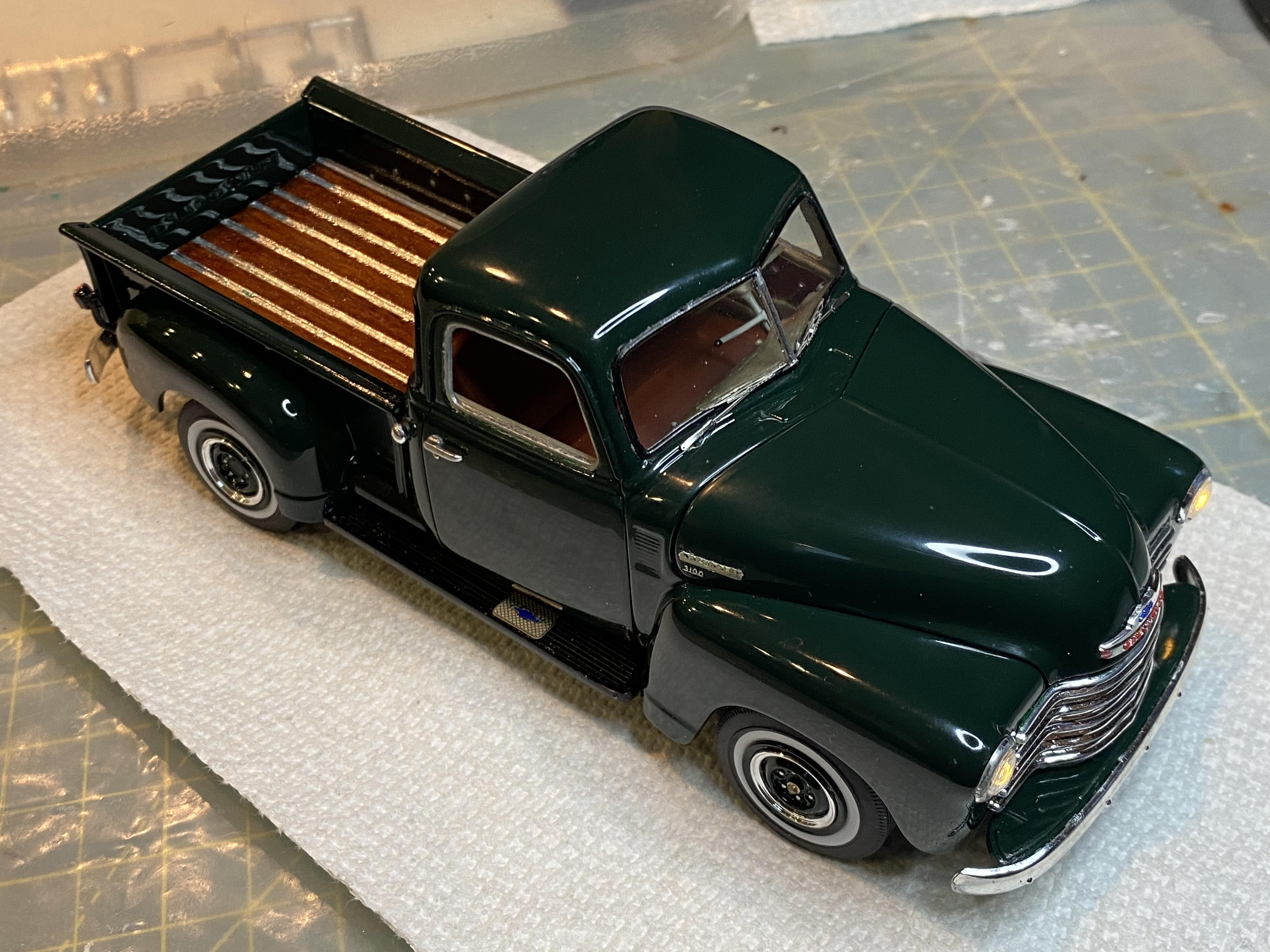

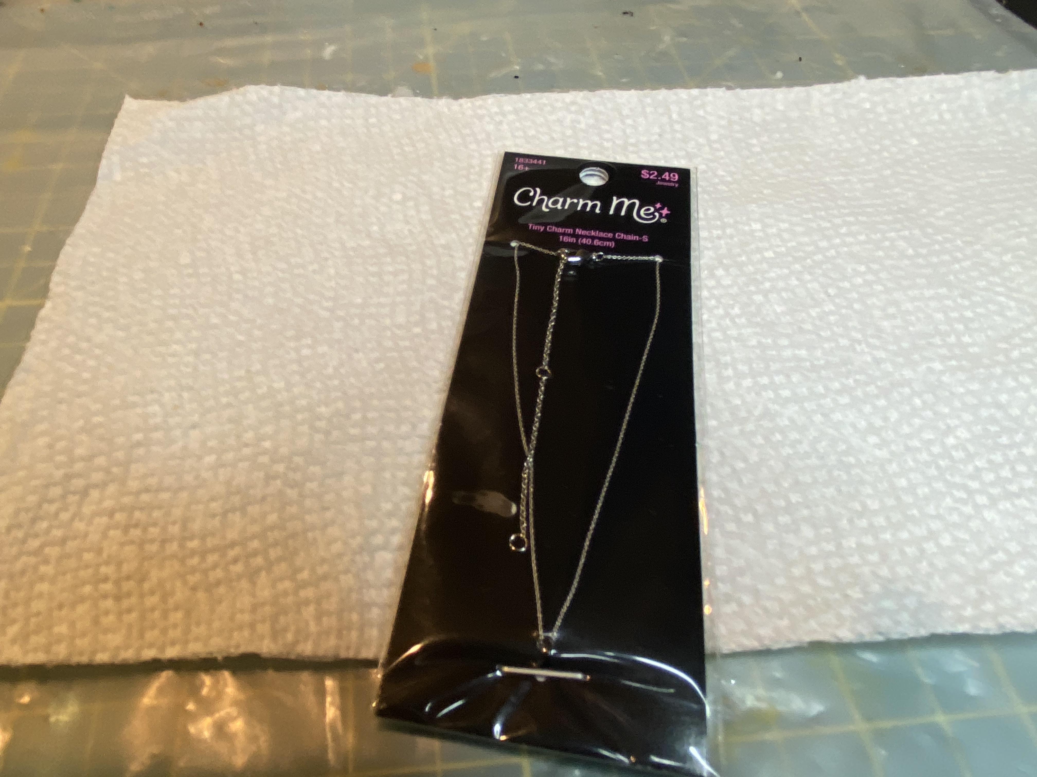

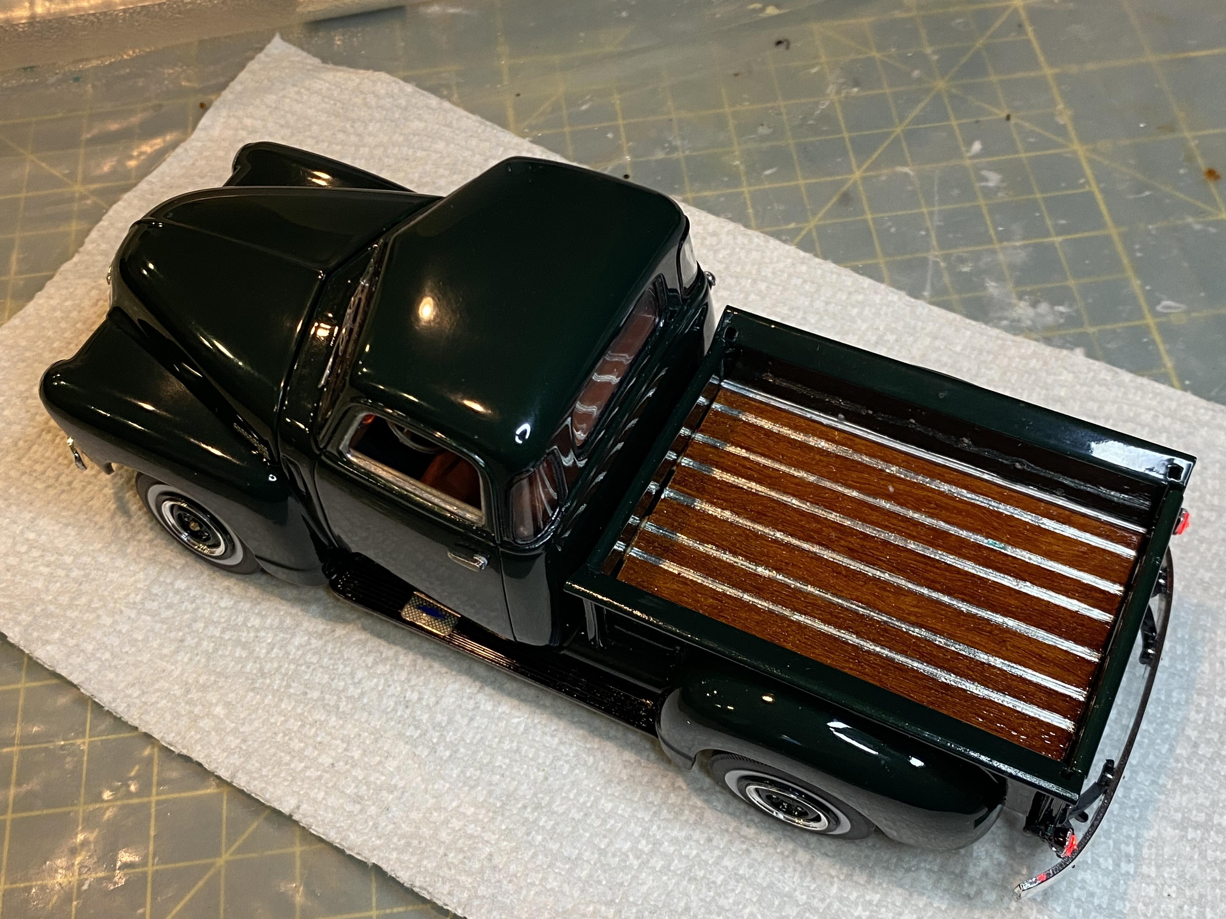

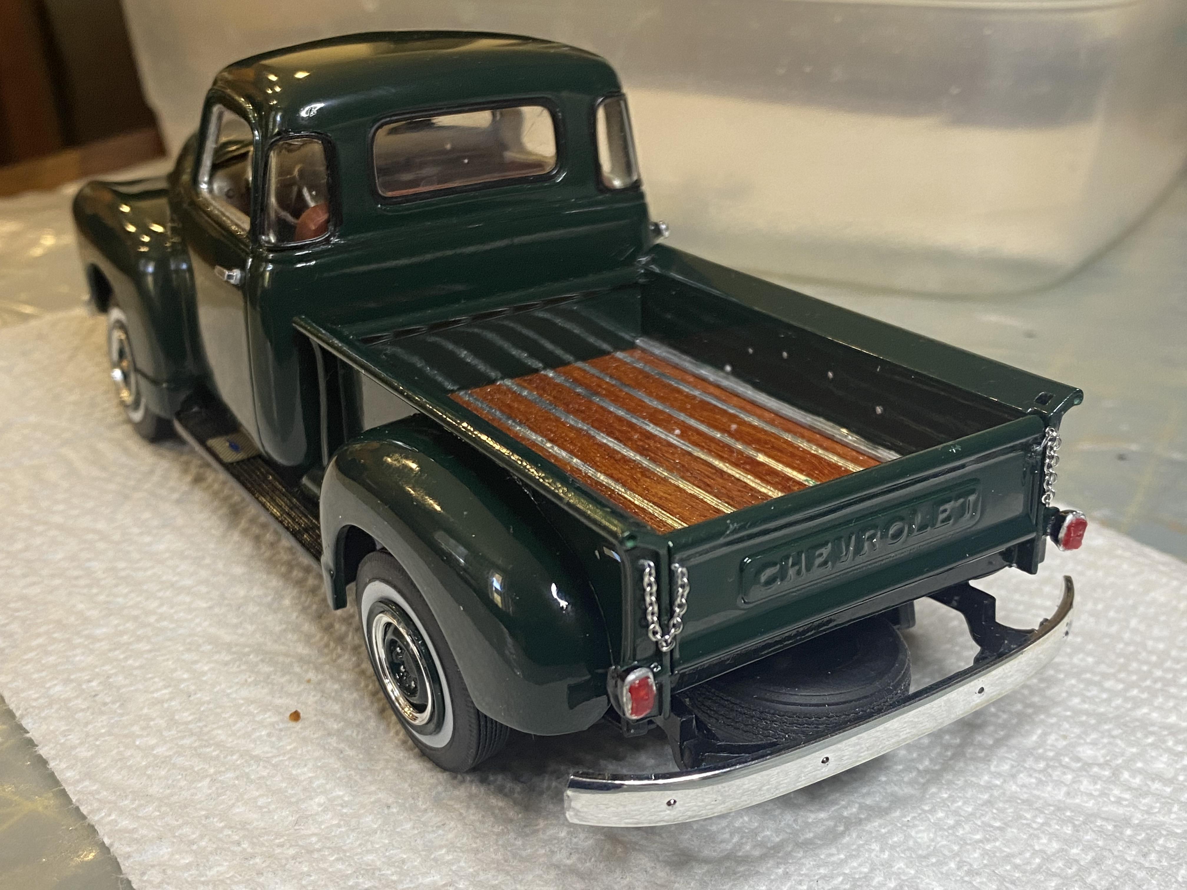

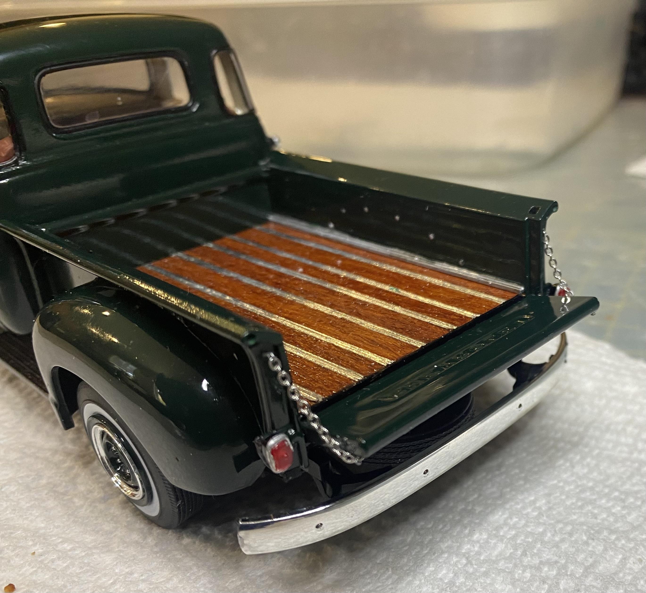

A little more detailing today. Added the bumpers, step plate photo-etch, photo-etch wipers and door handles. I picked a charm bracelet chain from hobby lobby to make the tailgate chain.

That's looking really sharp there Donald.  That's going to be a fine looking model.

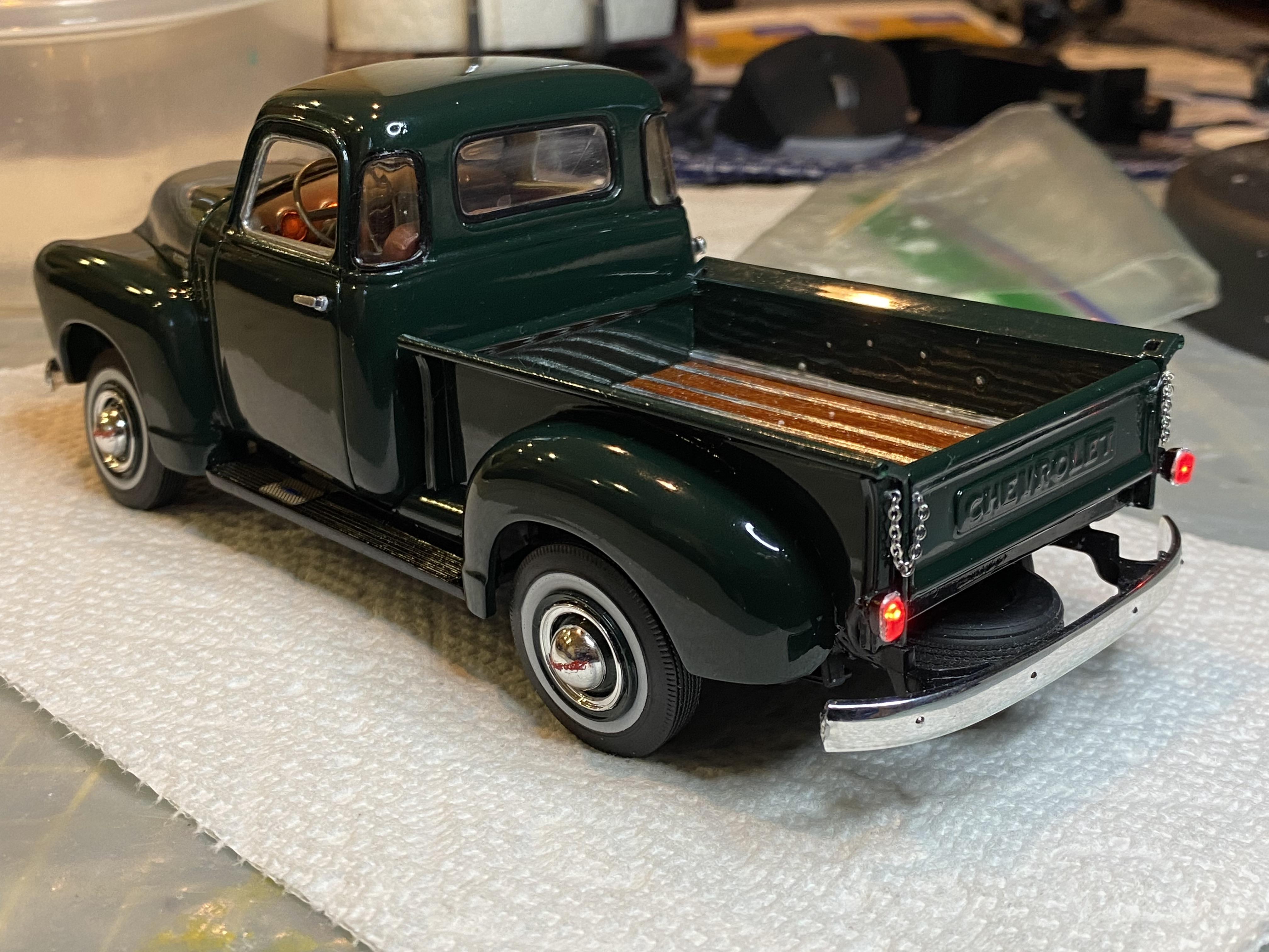

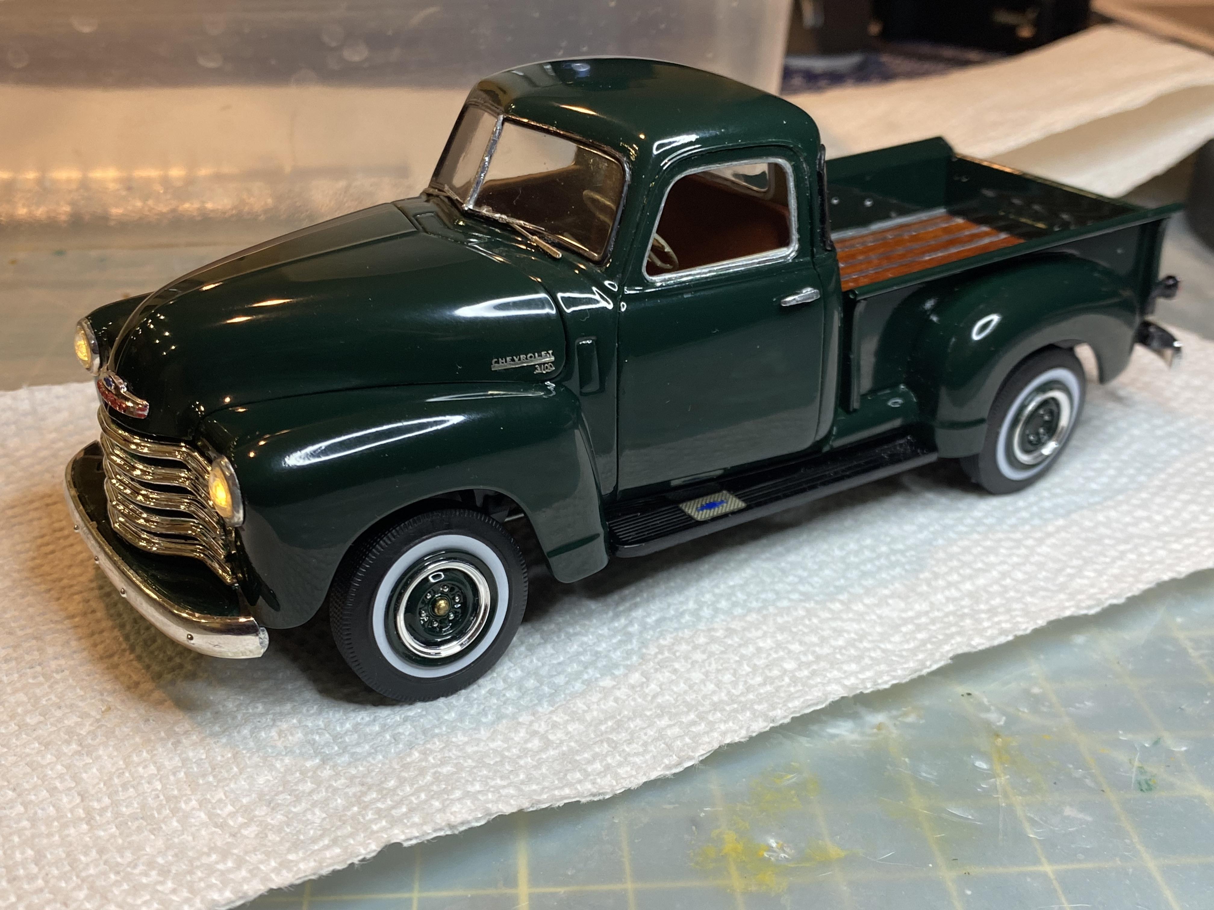

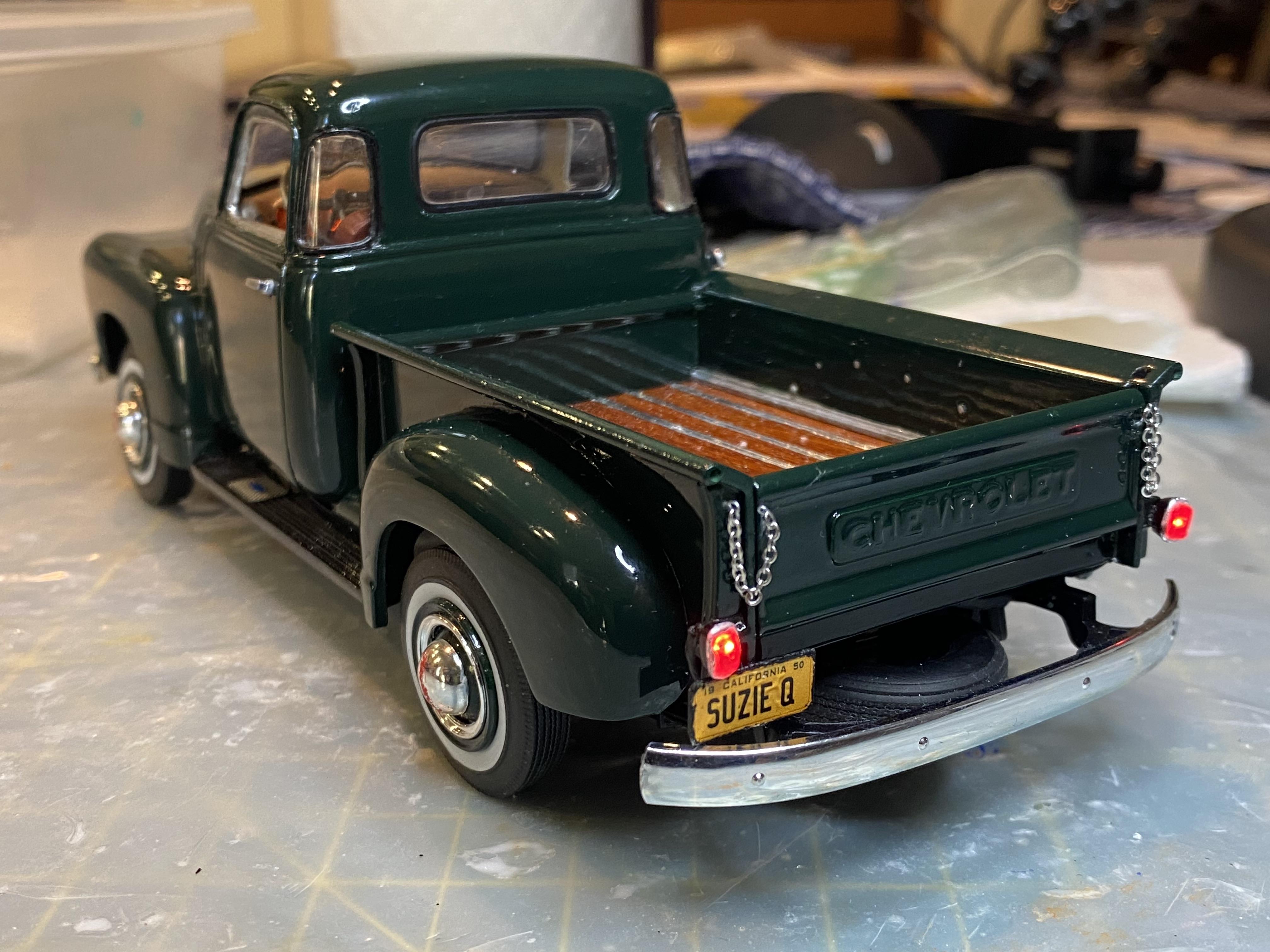

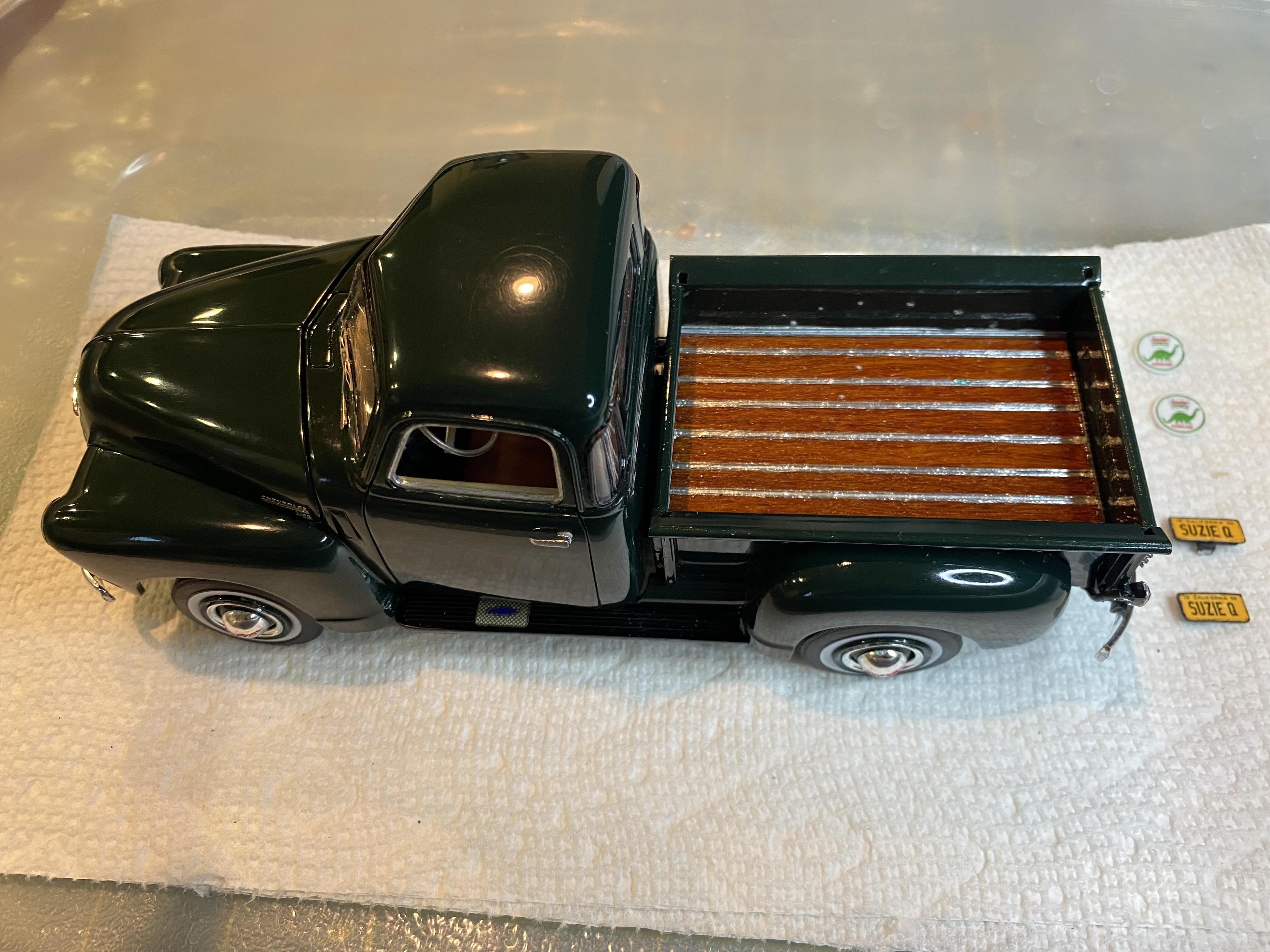

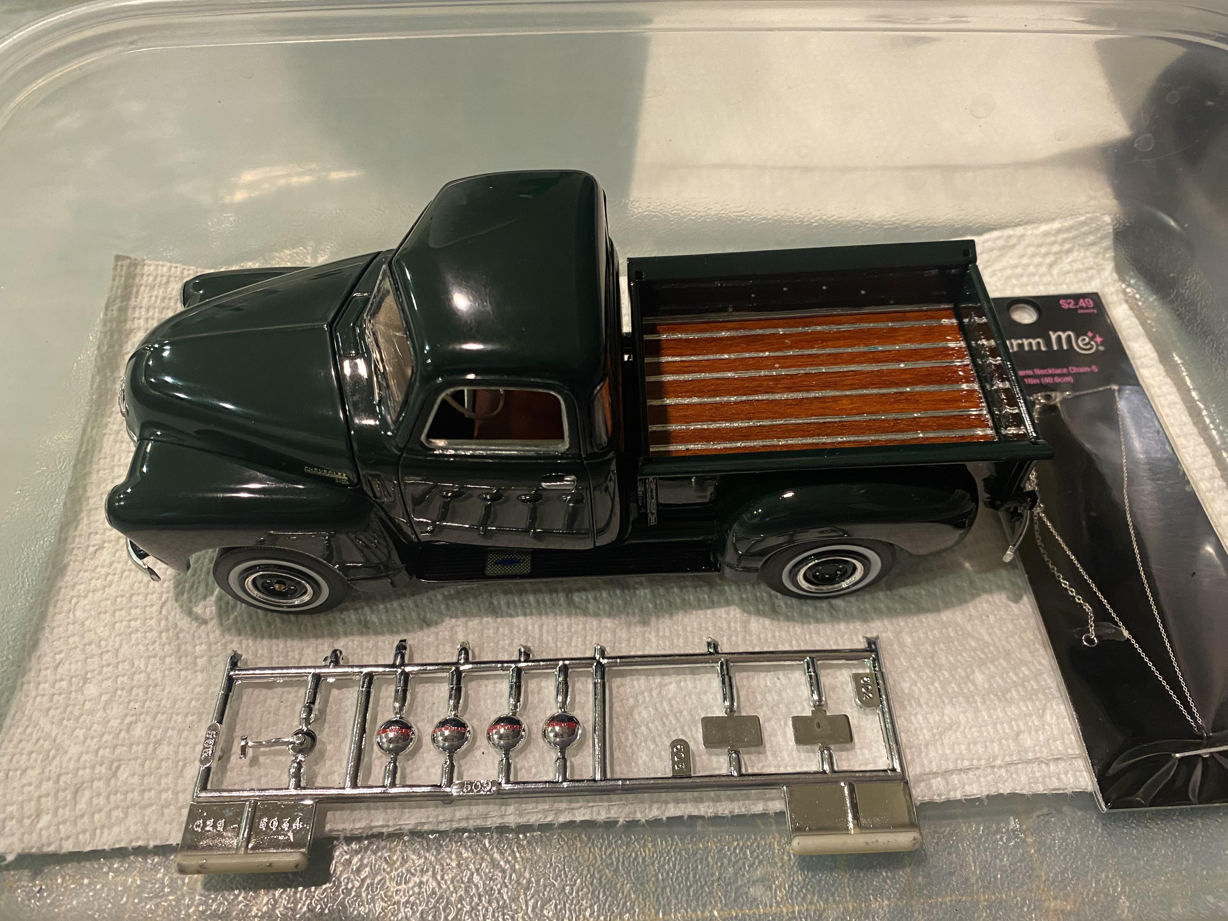

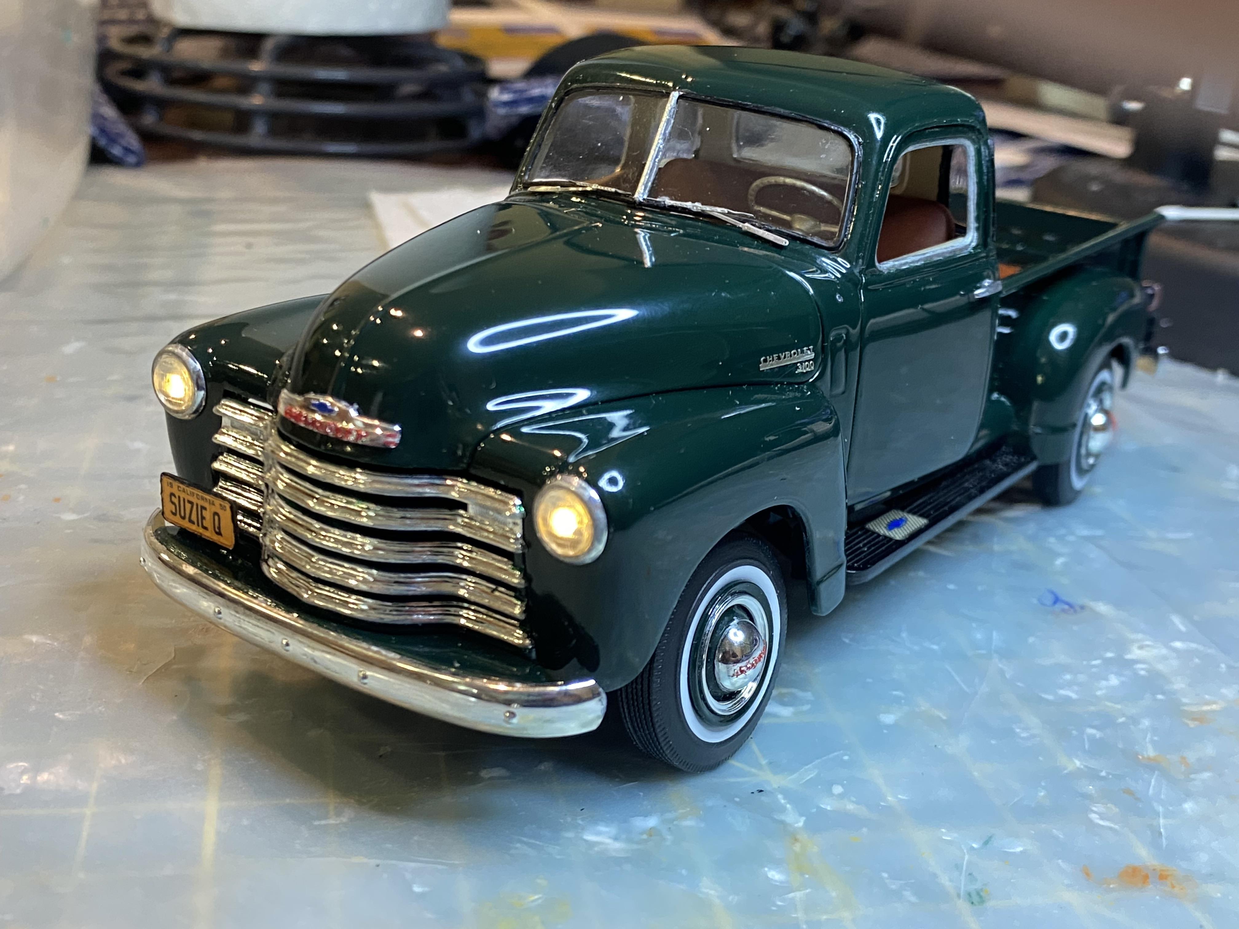

I am getting really close on this build. Added the hubcaps and license plates. The truck is now named Suzie Q. My wife goes by Suzie and this was the build she most wanted done and to her specifications.
IMG_5132.thumb.jpeg.1498f6f32e9ddebebd107e2094731d6b.jpegIMG_5133.thumb.jpeg.6afc6fbf90f1882b045723faca33184b.jpegIMG_5134.thumb.jpeg.0bbc96c54724027f030a0a7d2e208bf2.jpegIMG_5135.thumb.jpeg.01d76ead944e9bef797caff5a82c45c2.jpegIMG_5136.thumb.jpeg.9648a0f8560962395f060dce8ab69e94.jpegIMG_5137.thumb.jpeg.56e0d87fbbc0e90486ee1212040225d9.jpeg

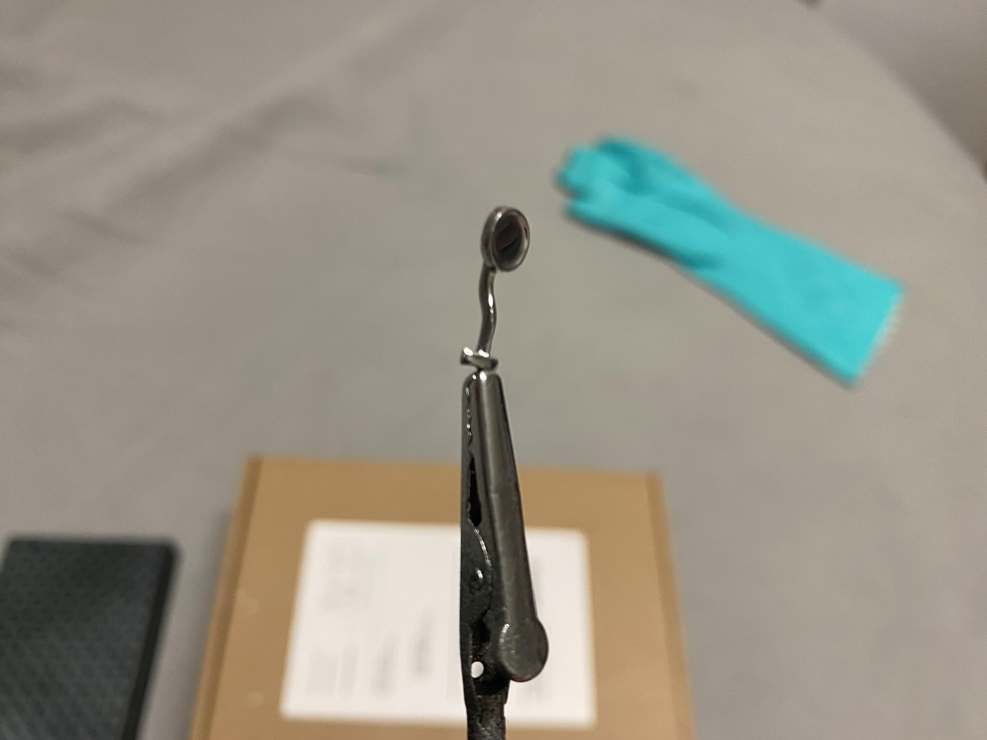

I didn’t like the mold lines and sprue issues with the rear view mirror so I stripped, smoothed the bar, pinned and rechromed.

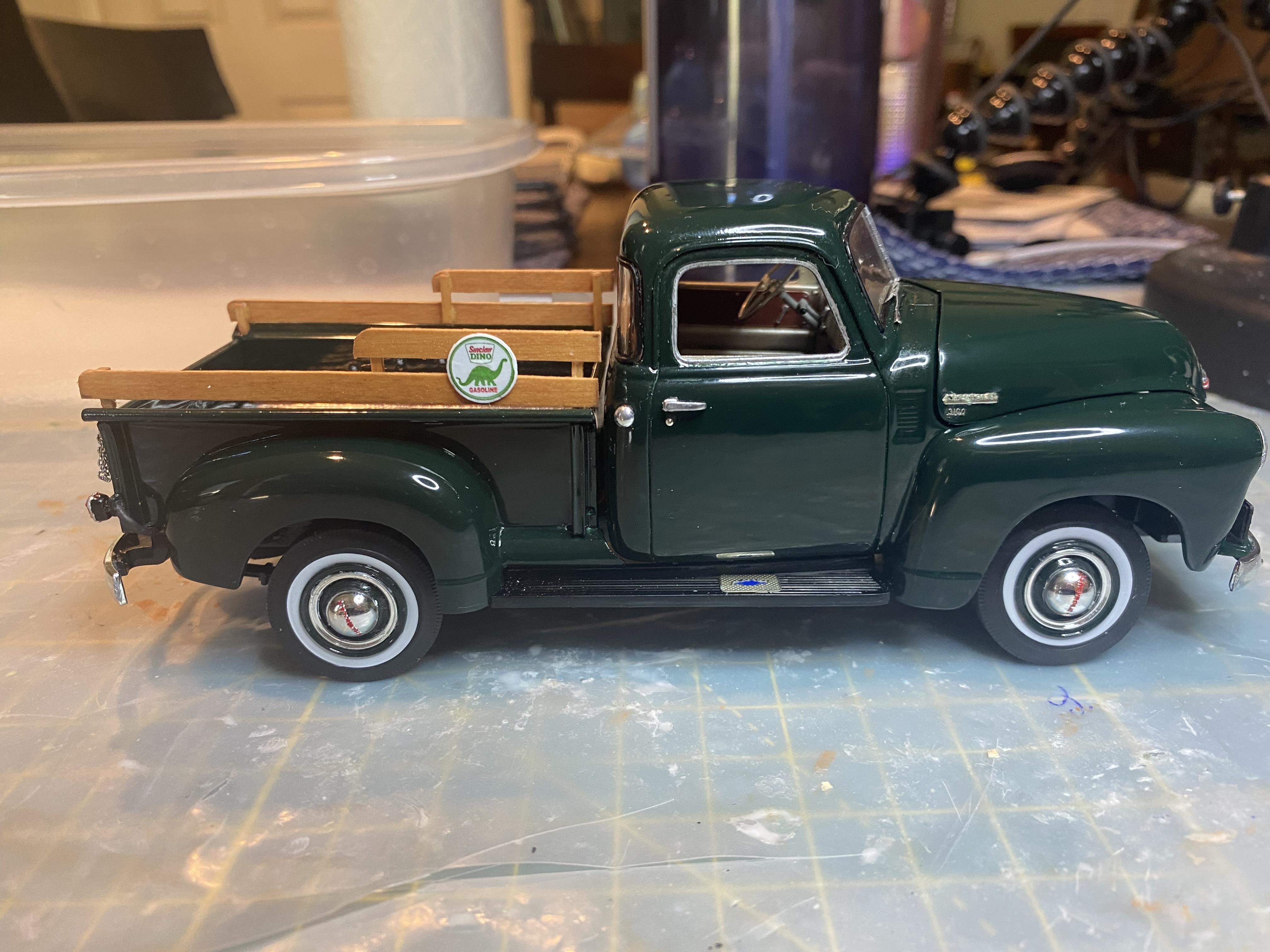

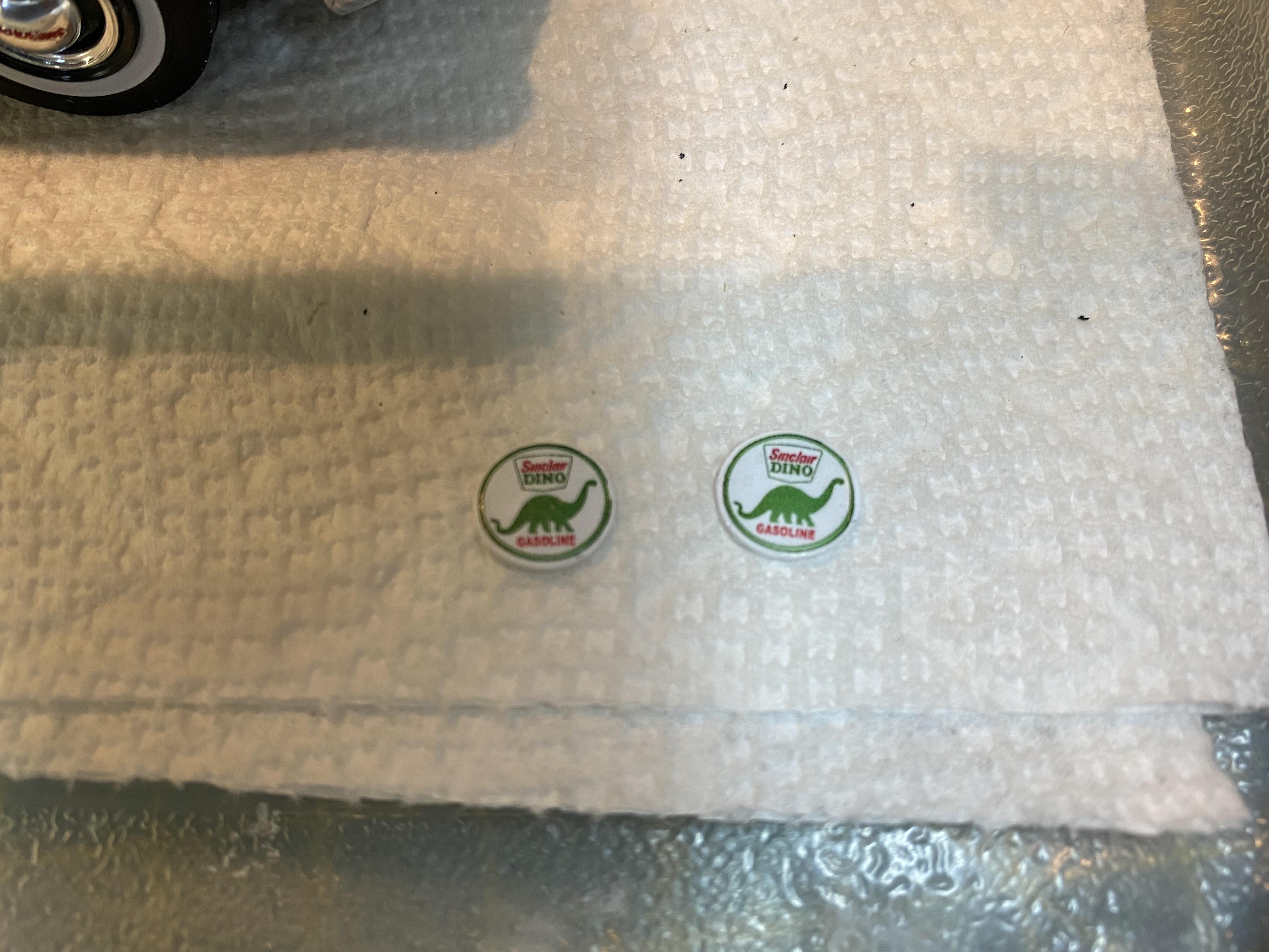

my son has a Sinclair vintage gas pump globe in his room as a light so the signs for the bed slats are of that image. I have some bass wood to make the bed side slats.
IMG_5138.thumb.jpeg.3e896a92f021f55c560259e693273c83.jpegIMG_5139.thumb.jpeg.3ac290157ad98c3d392fa55242c1d048.jpeg
just a few more things and final polish and coating. It has gotten covered in finger prints and dust during the process.

Great job on the mirror and the signs.
Thanks Zippi. btw, I get the Molotow refills from Amazon. I have seen them as low as $25 for a 30ml bottle. A lot more than you can get out of several pens. Just food for thought.

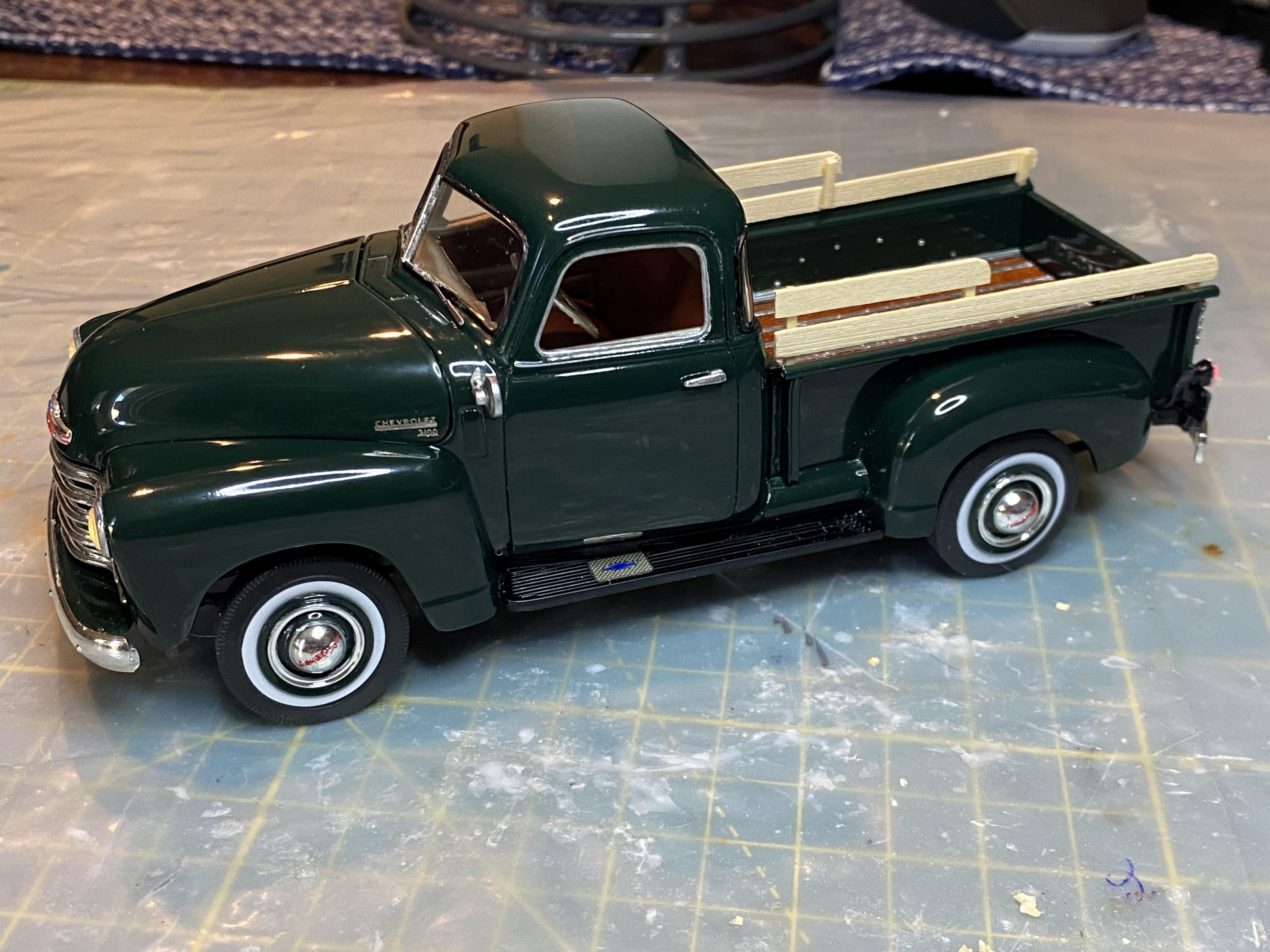

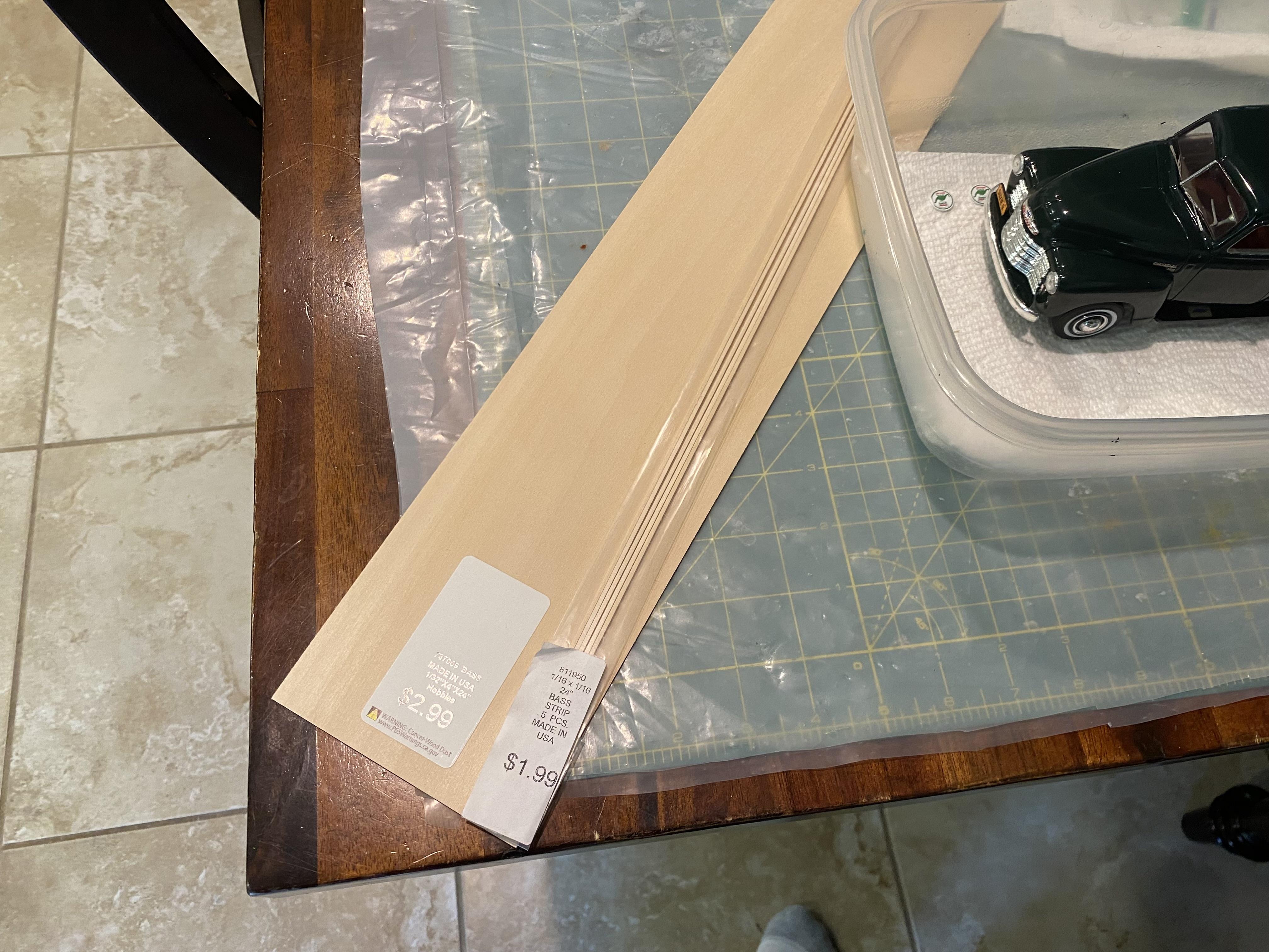

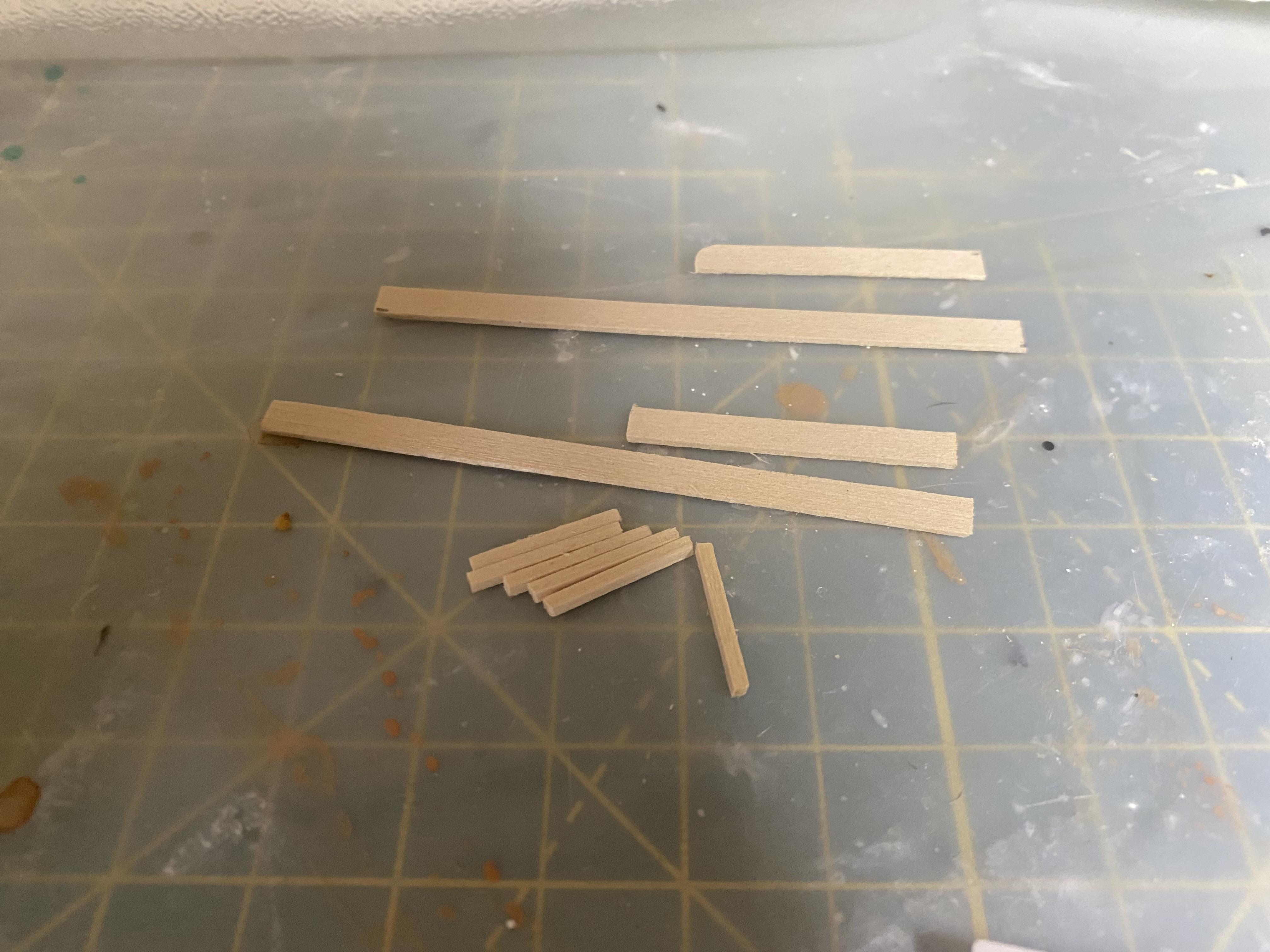

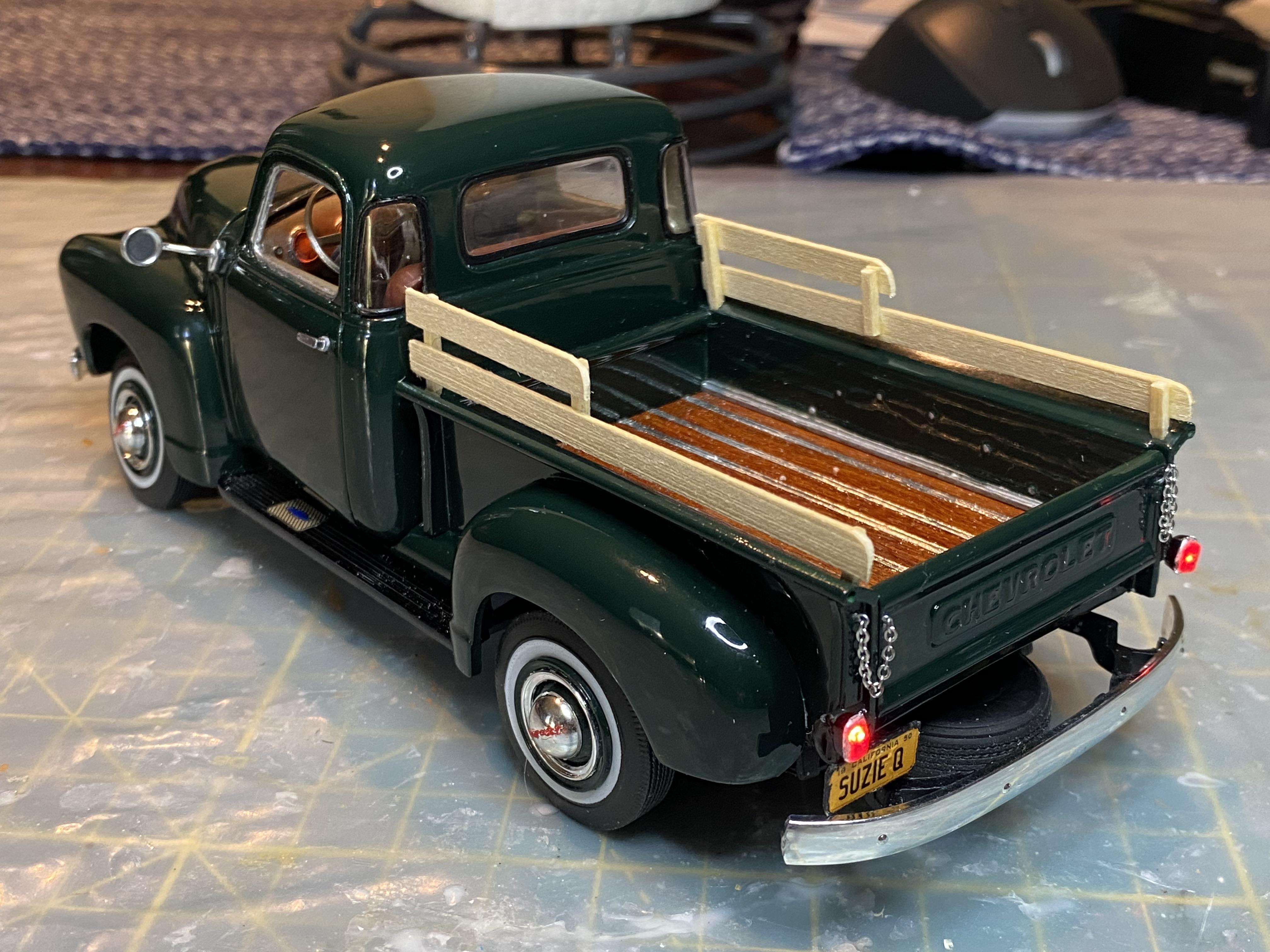

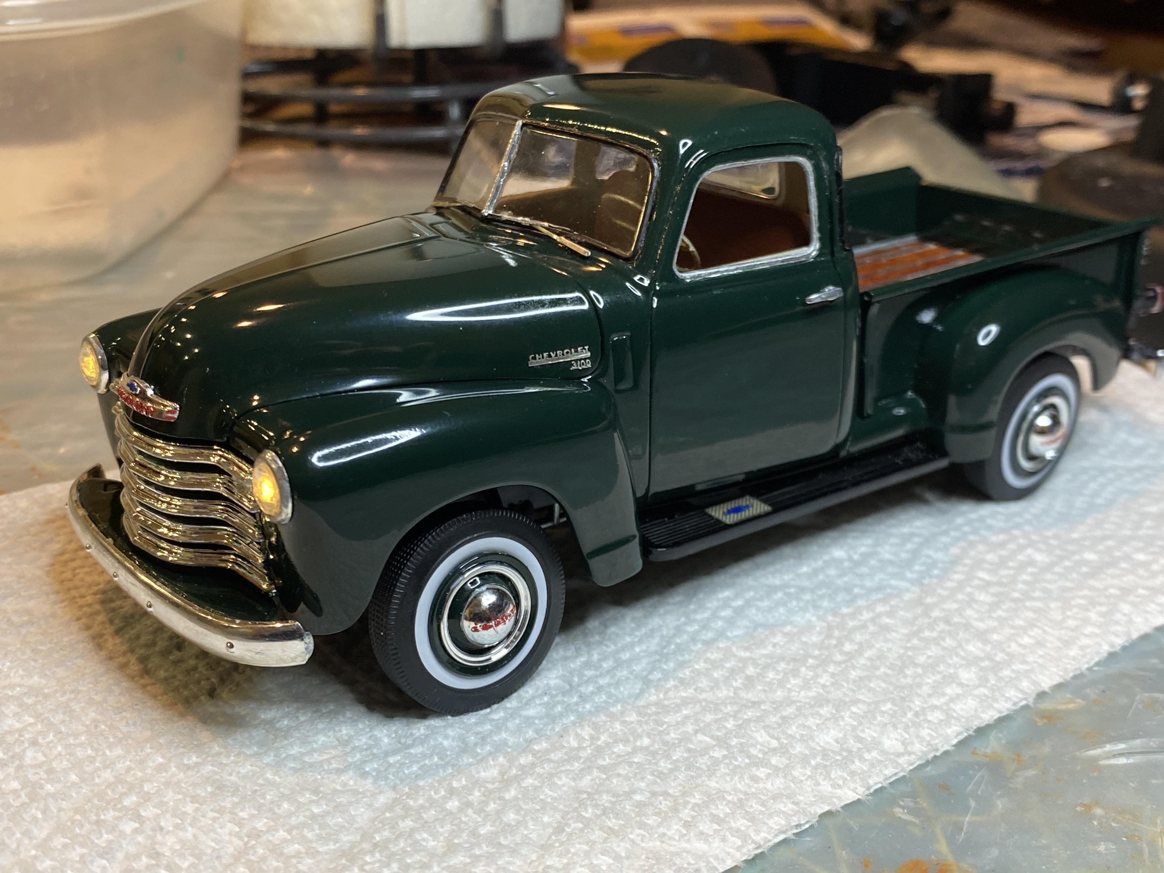

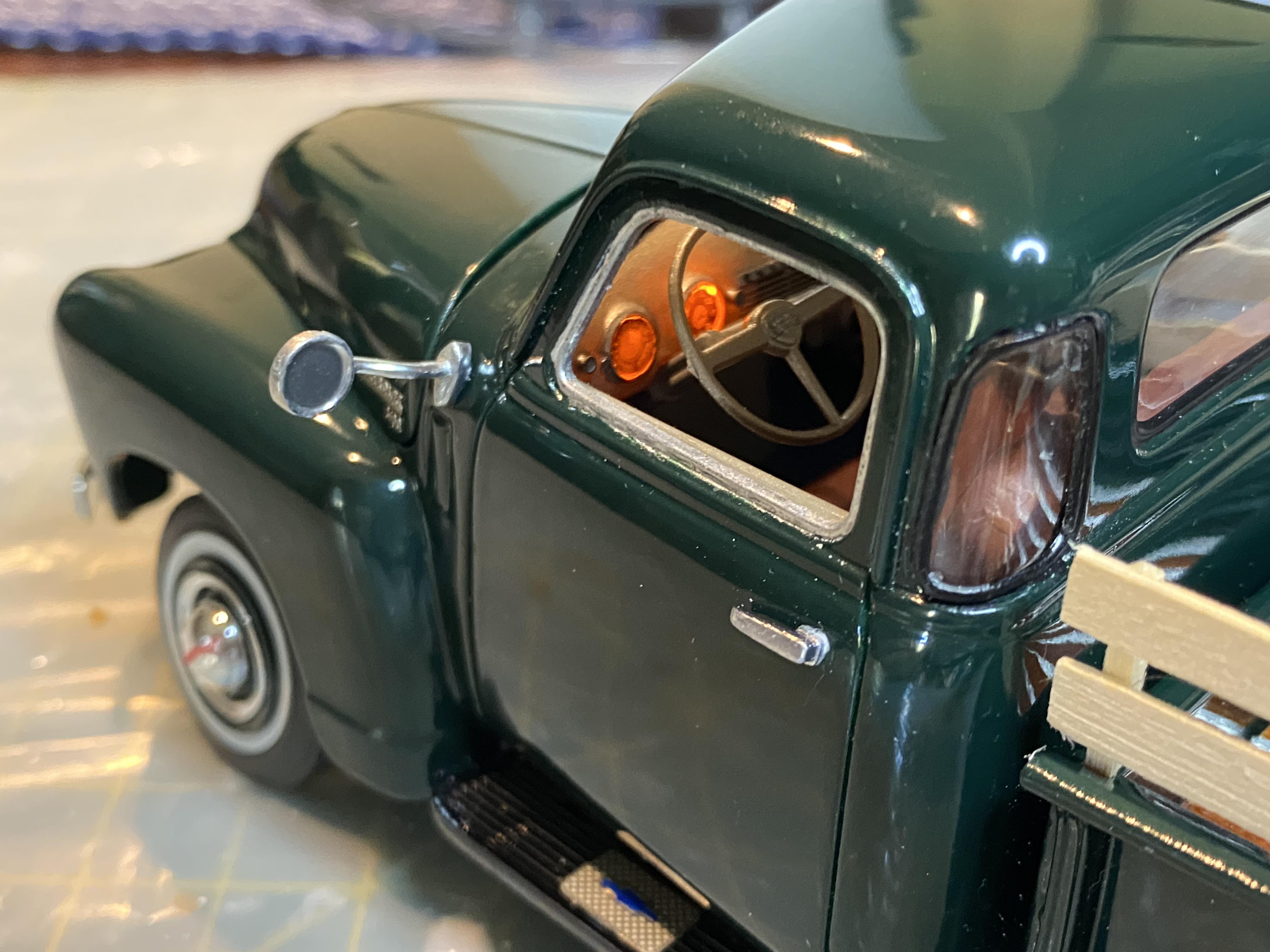

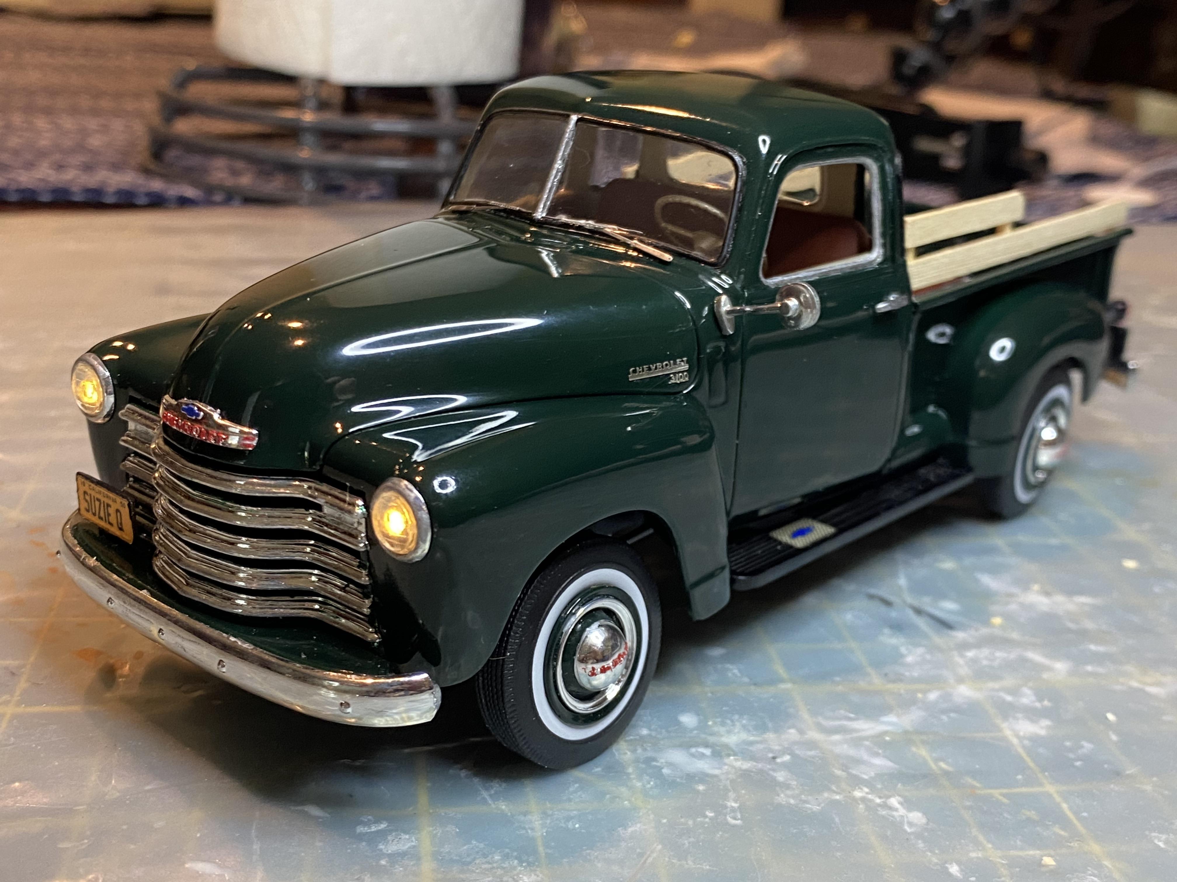

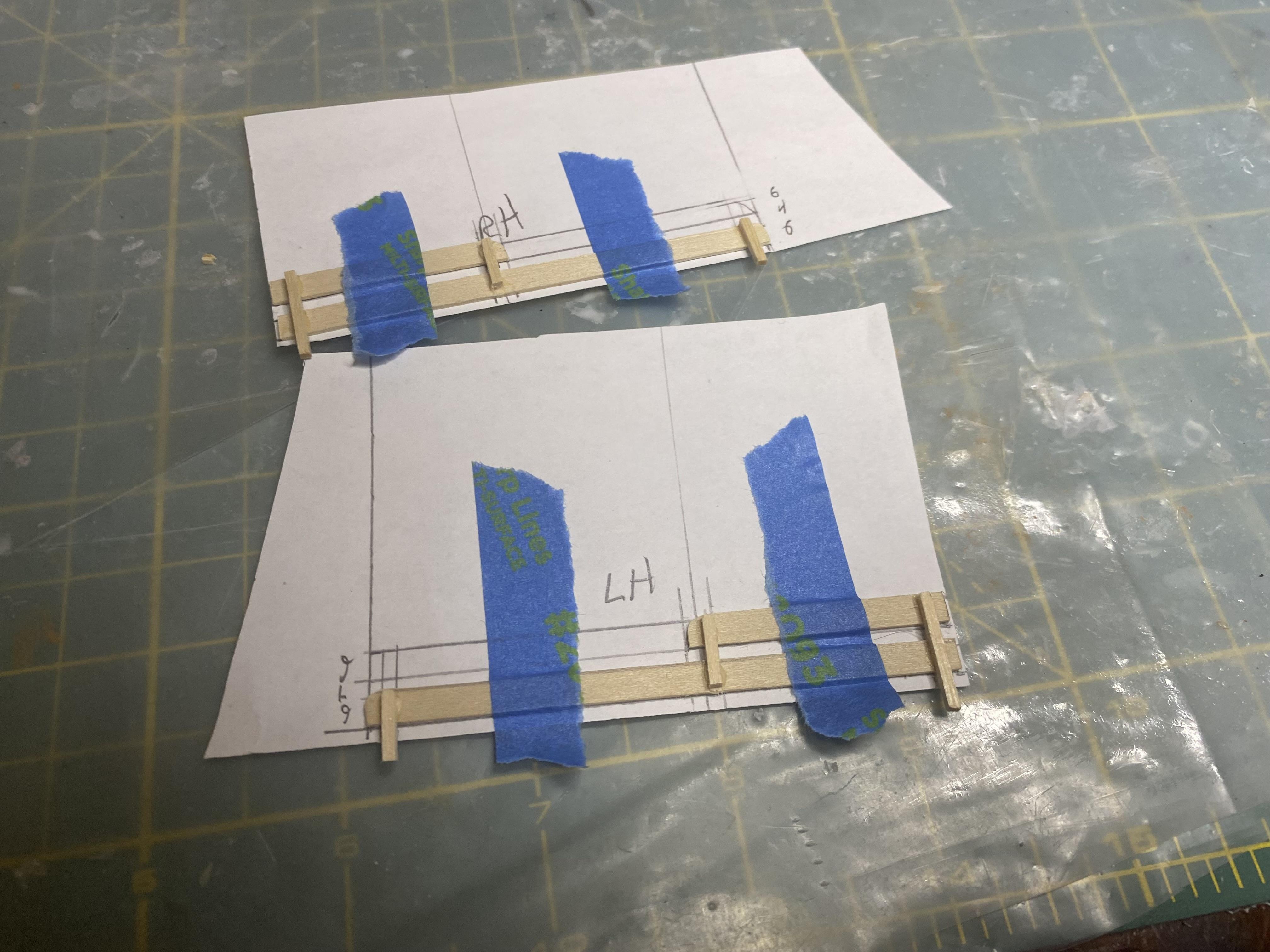

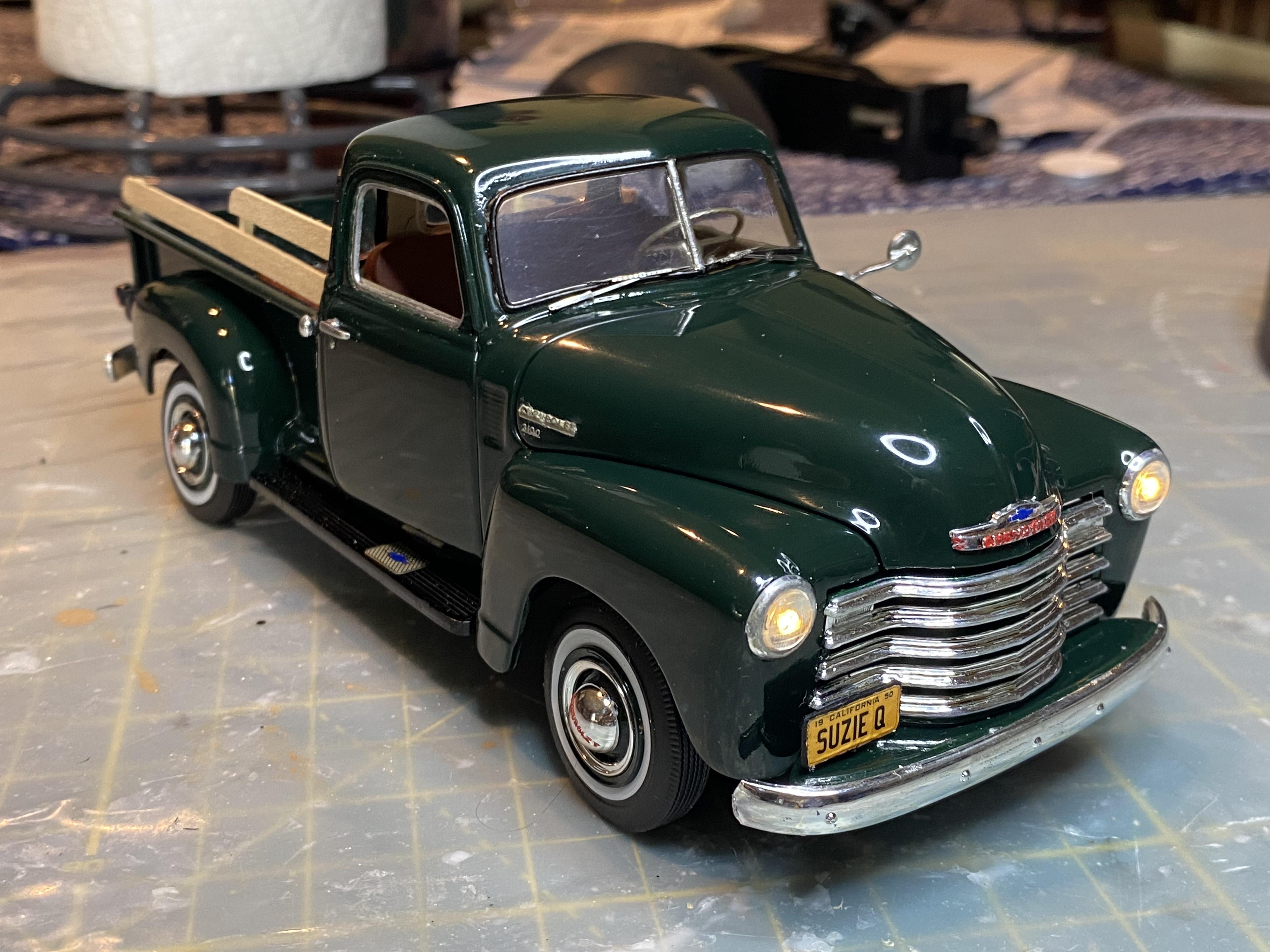

Started creating the bass wood bed slats and added the side mirror. My wife is going to pick out a stain at Lowe’s she might like for the slats. :)

Well Donald, with those headlights shinning bright you can clearly see the end of the tunnel. Looking good.
  • Like 1
Thanks, it is getting close. Need to start ordering the paint and supplies for the next build.

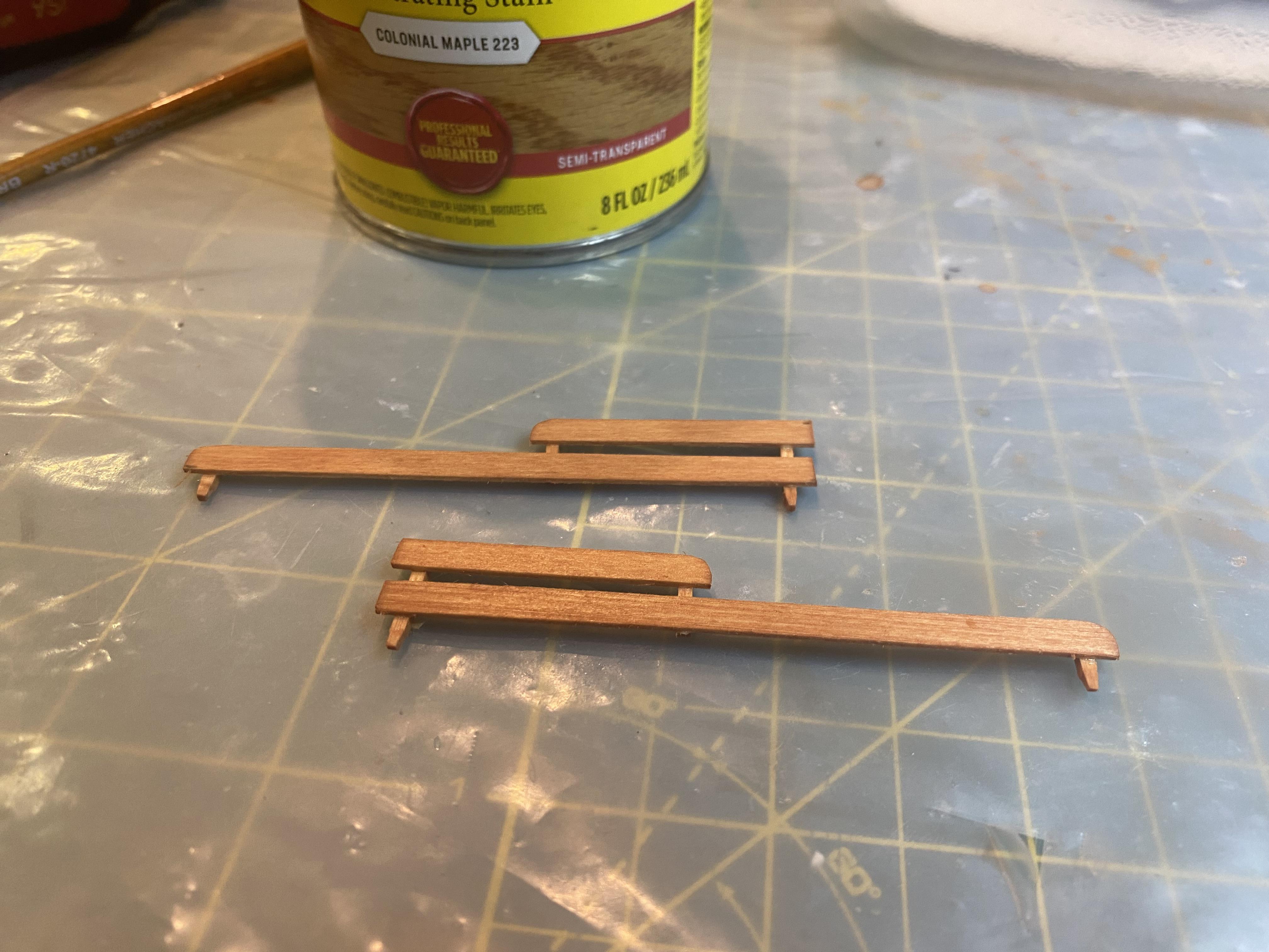

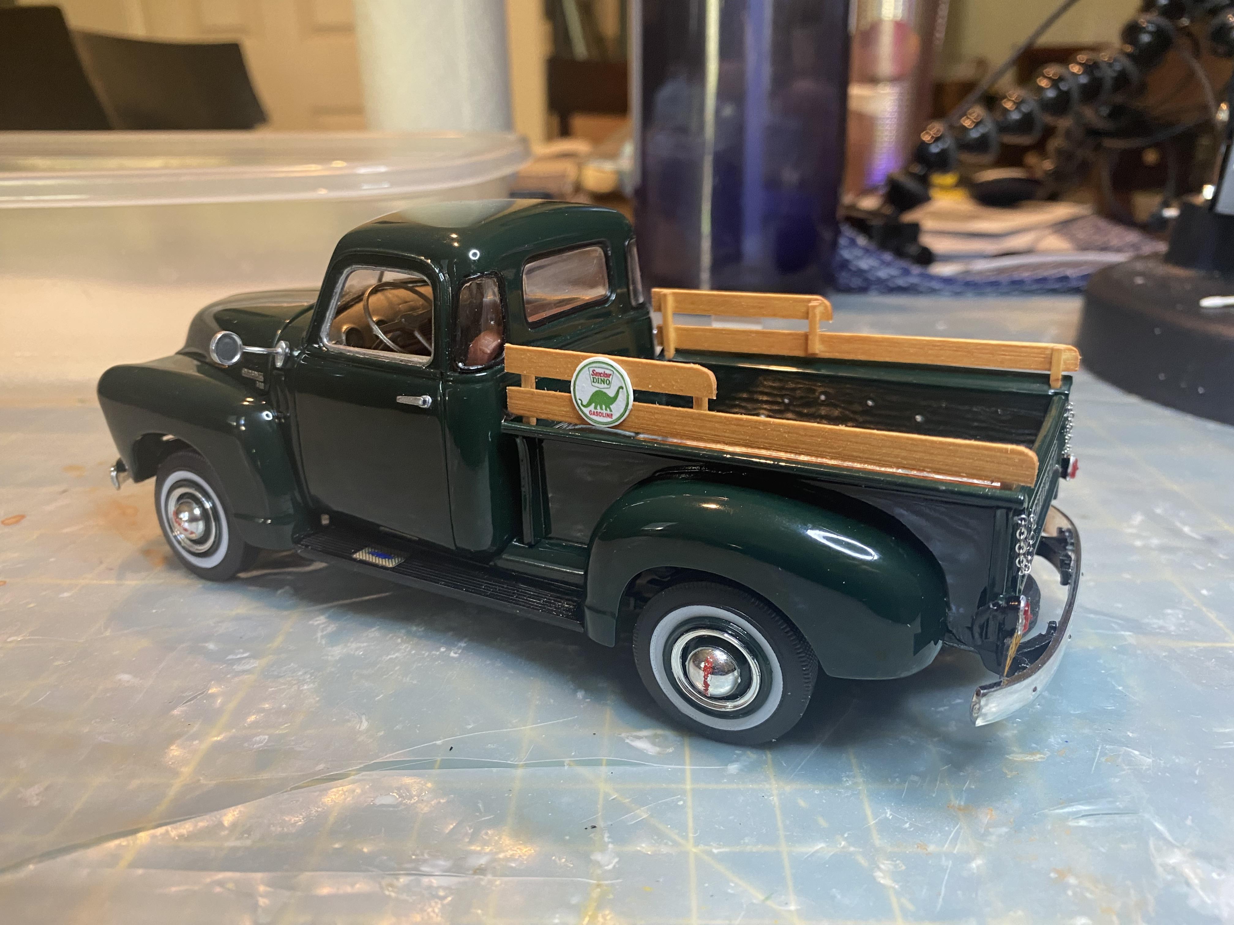

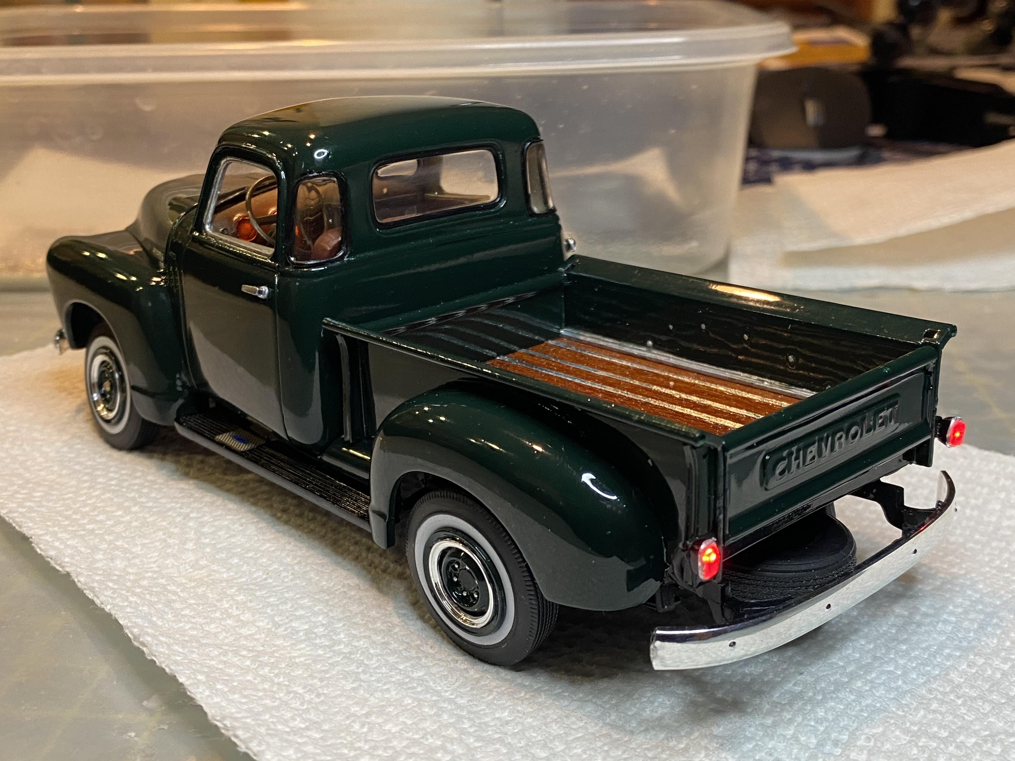

I got the bed slats stained and cleared. Just need to final polish and then I will take some pictures for under glass.

Beautiful build!

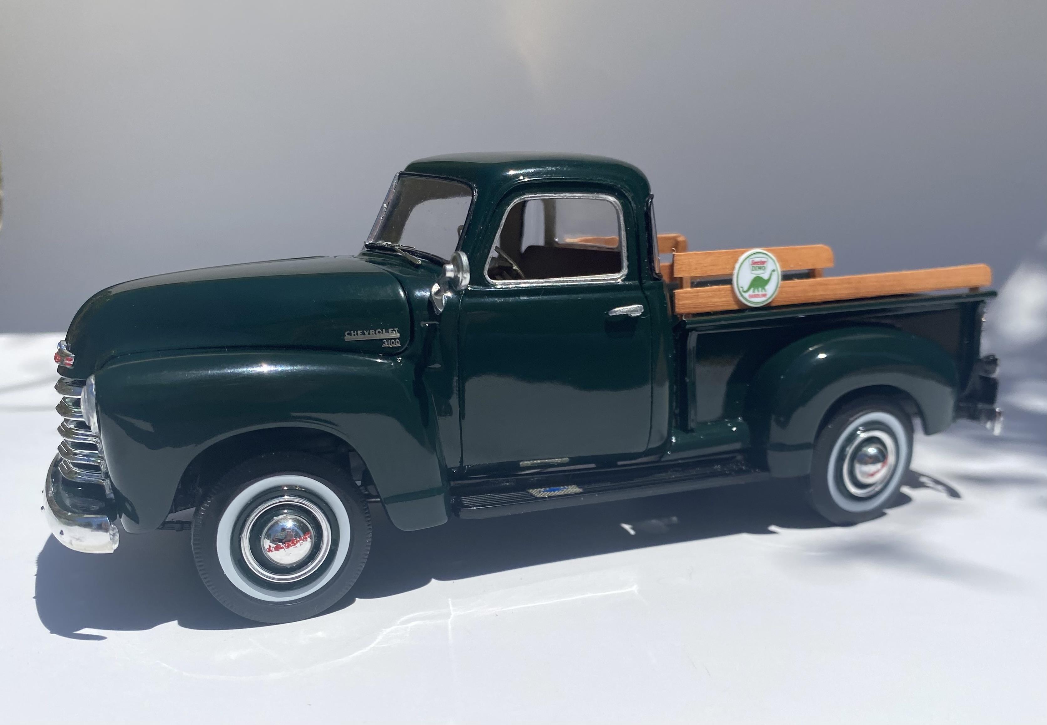

I started taking underglass pictures and found a bunch of issues to fix. One being the hood emblem on the passenger side full of polish or something. This is when I alway see things to fix. This is what it looks like in the sun btw.
