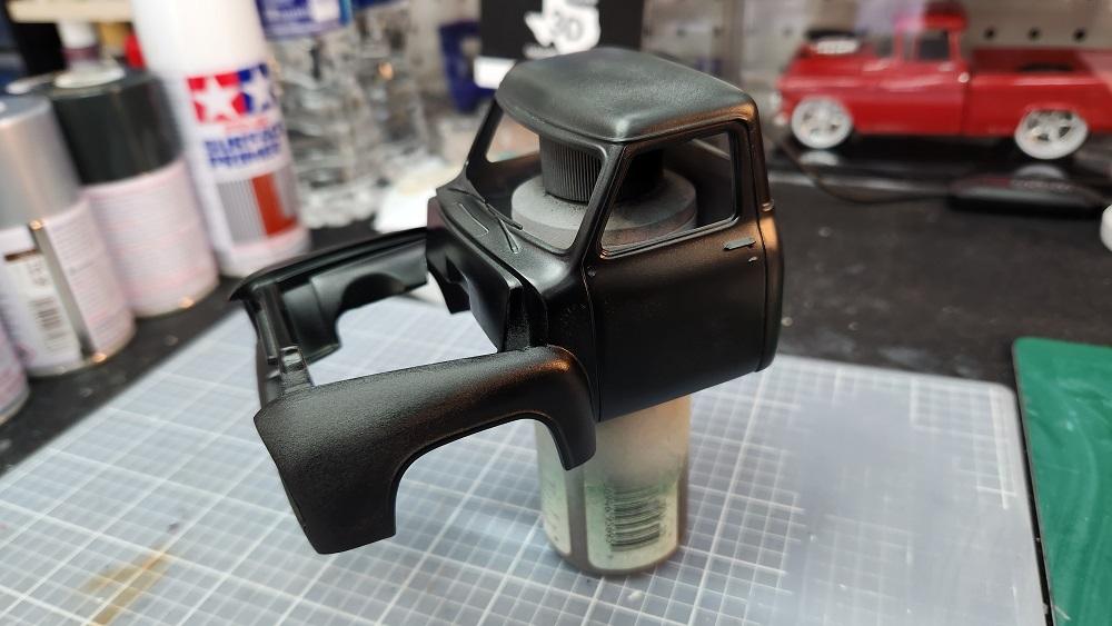

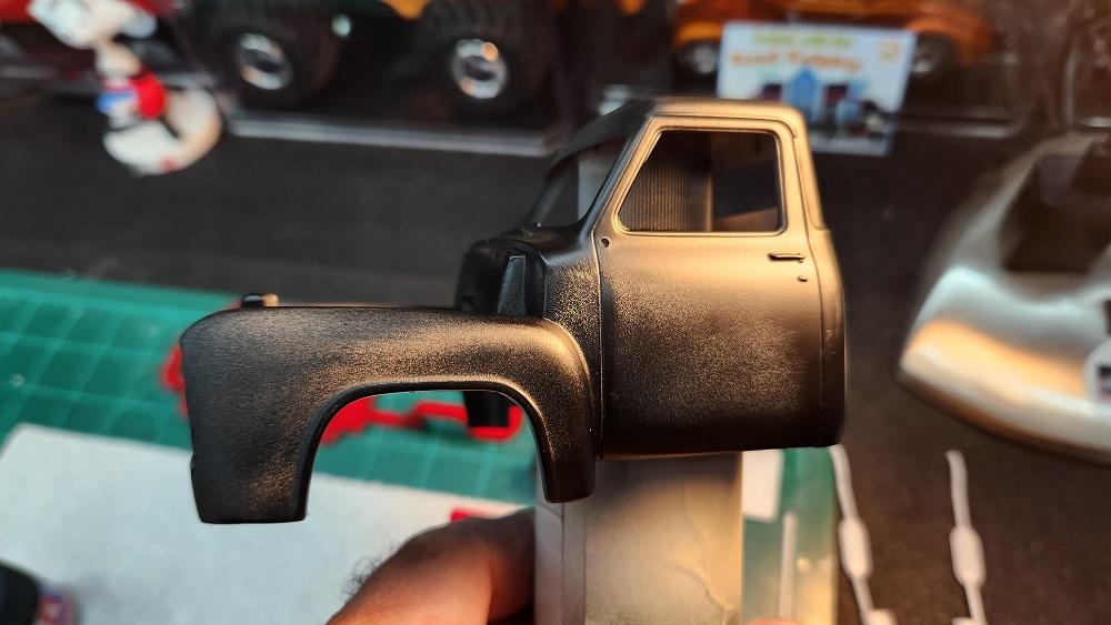

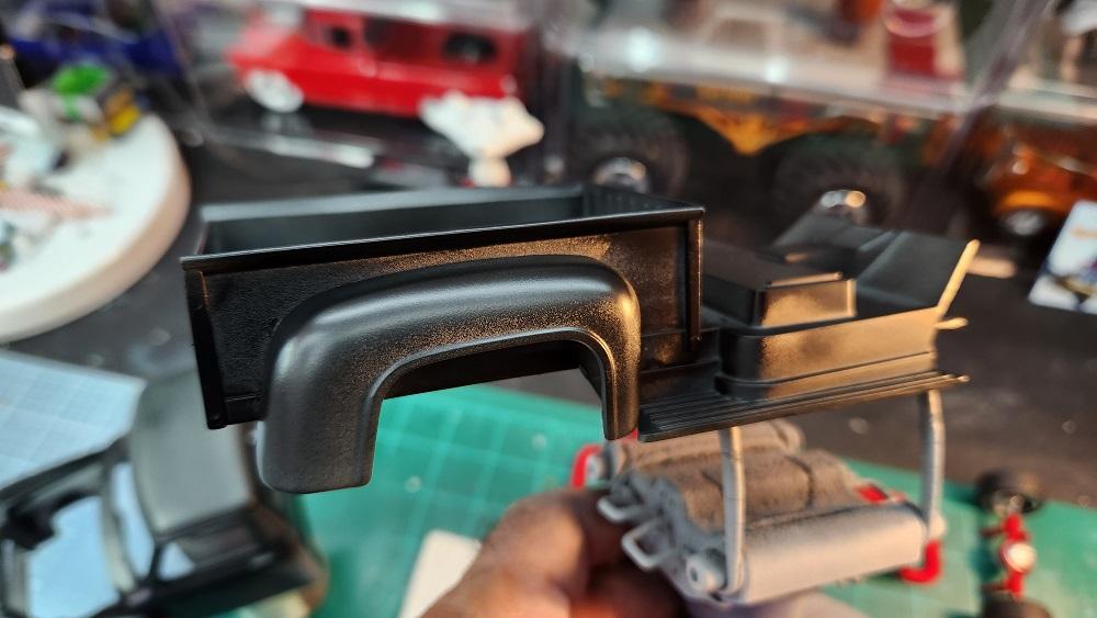

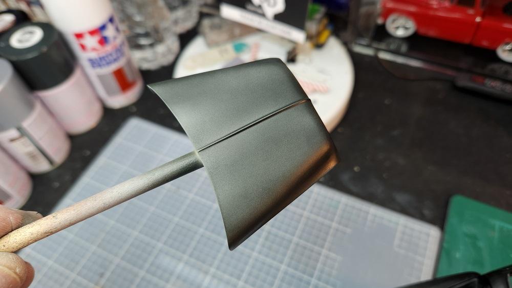

Zippi Posted August 11, 2024 Author Posted August 11, 2024 Well fellows....looks like disaster struck this time around. This is the Splash Paints Nocturnal Black. I used the same paint process I used on the last 3 builds that came out fine. The only difference was I used Tamiya Light Gray primer this time vs the white. That should not have mattered so I'm shocked at what happened. On the cab it looks like it started eating into the plastic. It's differently looks like a reaction to the primer. This body may be history. 2
SpikeSchumacher Posted August 11, 2024 Posted August 11, 2024 As if black wasn't a difficult enough color to work with...
DJMar Posted August 11, 2024 Posted August 11, 2024 Nooooo. That's such a bummer. Do you think there is any chance you can sand it out and use it as a base for another paint or color?
espo Posted August 11, 2024 Posted August 11, 2024 Might try striping the paint and see just how bad the plastic is underneath. Sometimes, and only sometimes an automotive type of filler primer may smooth out the surface enough to try again. I just had the same issue using some Duplicolor touch up on a Charger build. Striped the paint and was able to save the panels I had painted using this method.

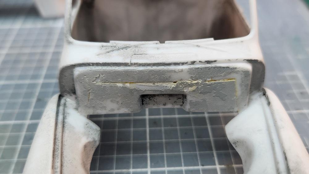

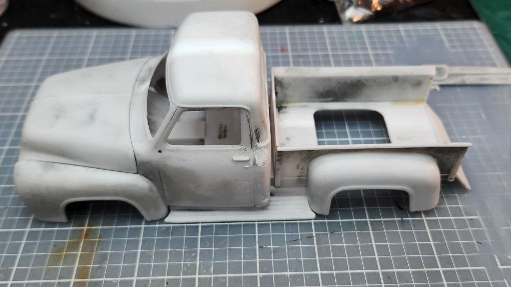

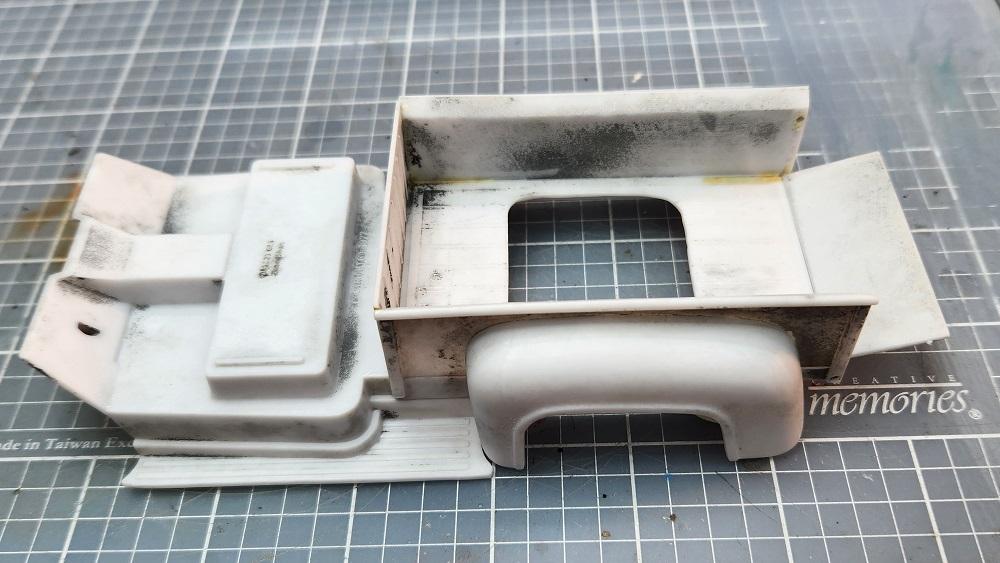

Zippi Posted August 13, 2024 Author Posted August 13, 2024 I pulled the 55 out of the Easy-Off this morning and cleaned it good with a toothbrush and Dawn soap. looks like it ate the Mr. Hobby white putty and the body in some areas is rough and that's not from the Easy-Off. This came out worst than I thought it would. Don't know guys. 1 1
Zippi Posted August 13, 2024 Author Posted August 13, 2024 1 hour ago, bobthehobbyguy said: Absolute bummer. Yeah, I know but it happens sometimes. I'm trying to make the best out of a bad situation.
DJMar Posted August 13, 2024 Posted August 13, 2024 Easy Off (or any lye based cleaner) can, and often will, attack solvent based putty. It's one of the downsides of using it to strip paint. I've also seen the rough texture where it feels like the plastic has been pitted in areas where there's still paint "staining". I'm not sure what causes this, but I've had it happen before. I've been able to sand those areas smooth without any further issues. Still, it's a tough break. Don't get discouraged, though. If you fixed that '36 Ford, you can fix this.
Zippi Posted August 13, 2024 Author Posted August 13, 2024 39 minutes ago, DJMar said: Easy Off (or any lye based cleaner) can, and often will, attack solvent based putty. It's one of the downsides of using it to strip paint. I've also seen the rough texture where it feels like the plastic has been pitted in areas where there's still paint "staining". I'm not sure what causes this, but I've had it happen before. I've been able to sand those areas smooth without any further issues. Still, it's a tough break. Don't get discouraged, though. If you fixed that '36 Ford, you can fix this. I hear ya DJ. Yup, not my first rodeo. Like my Granddaddy used to say, hope for the best and expect the worst.
