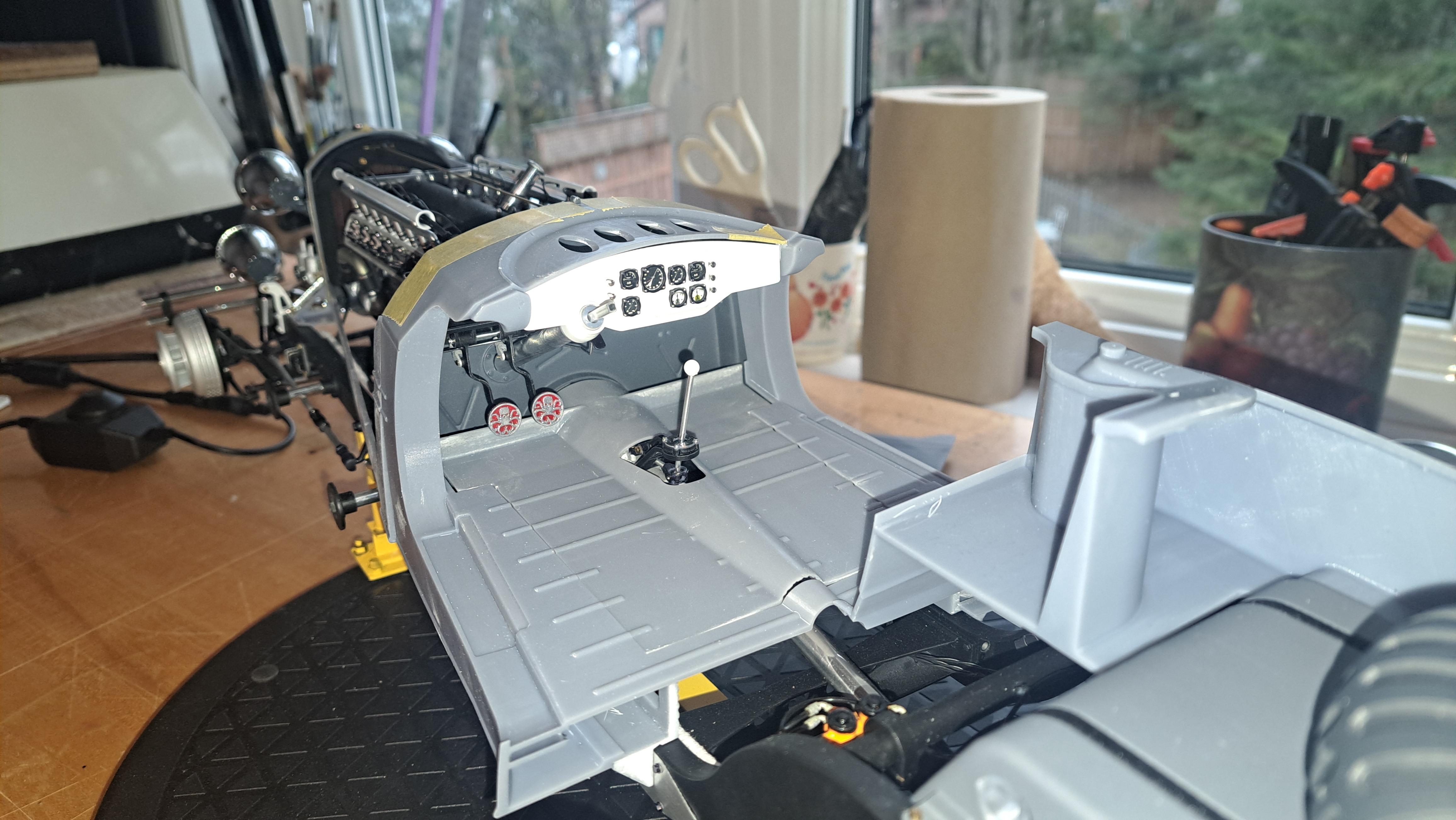

The body is slowly coming together,  and the fit is surprisingly good. The doors open and close easily as does the trunk lid. I still have a lot of fitting and sanding/puttying to do. I'll ve applying a sandable primer before paint. Here are some shots as of today. I also took a few shots of the undercarriage.
Door sill, will be chromed with black lettres
Trunk lid prop bar added
aluminium micro tubing over brass pivot rod
Leather trial,  it's a nice reddish brown that I think should look pretty good with the gun ship gray of tge body
Undercarriage
Close up of the wired starter
