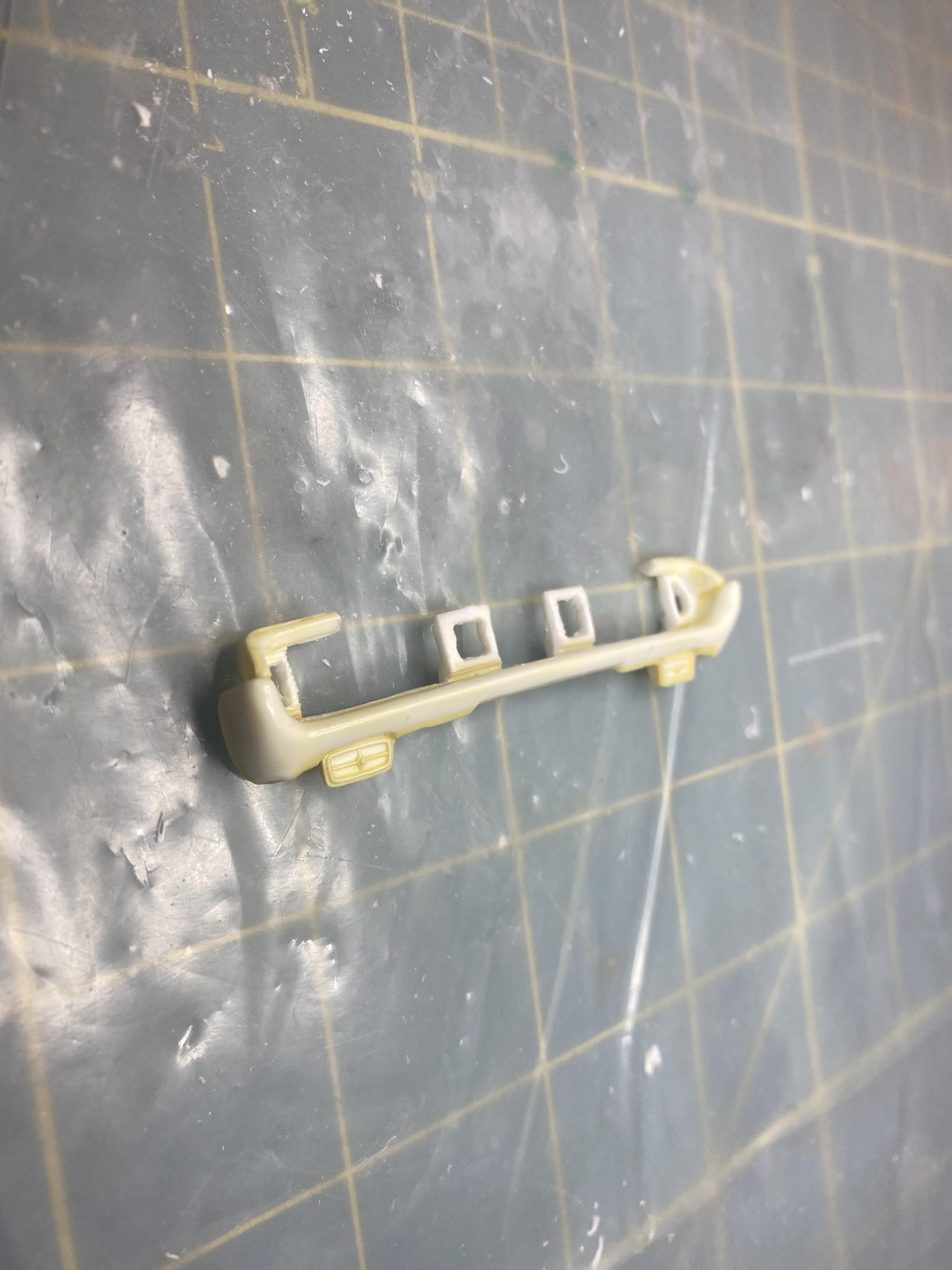

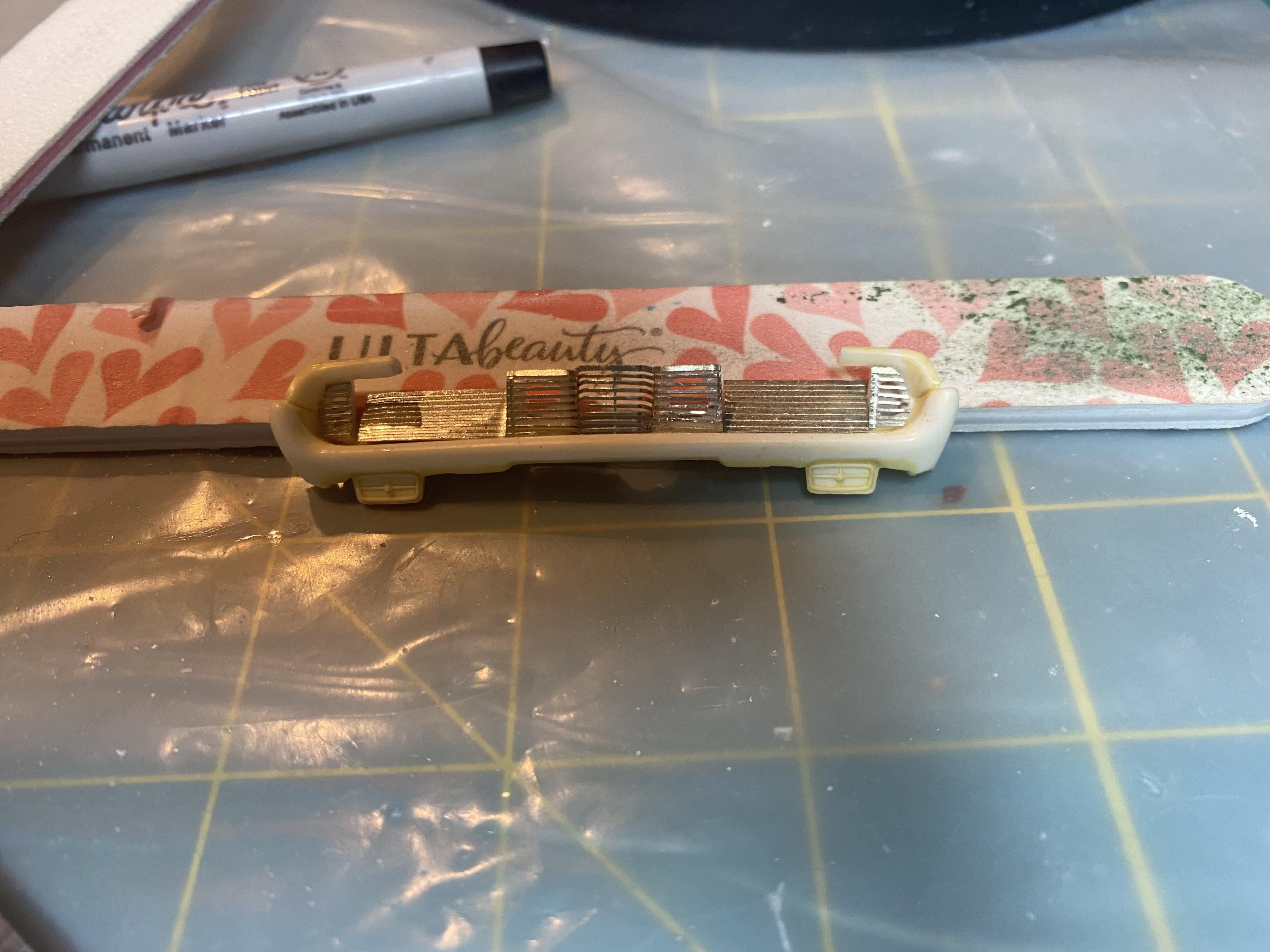

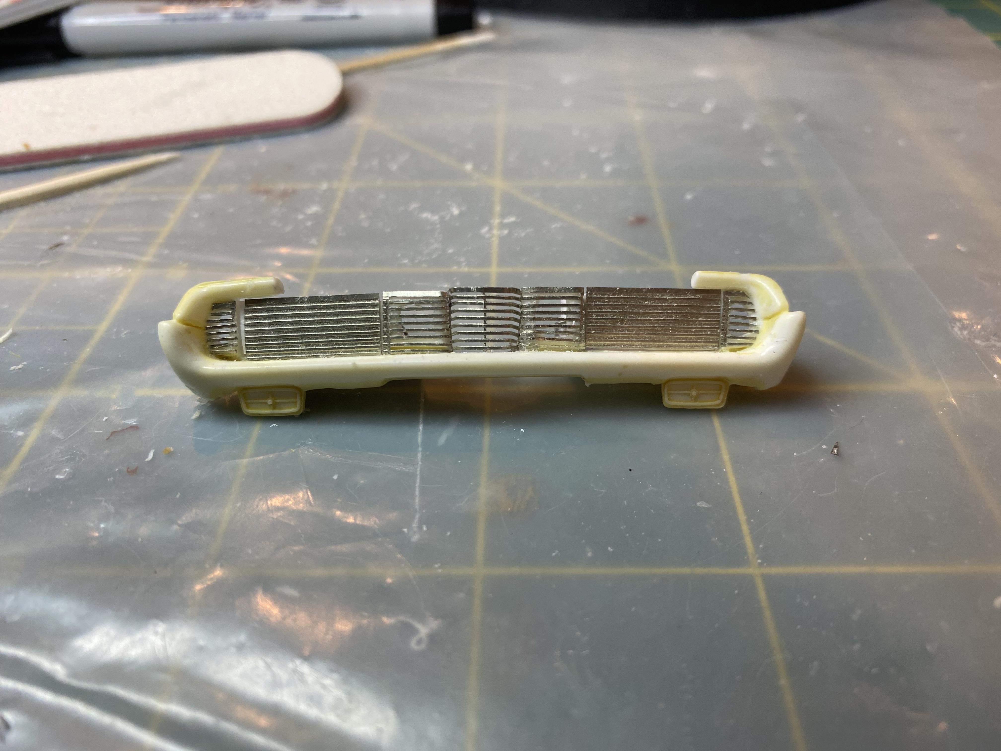

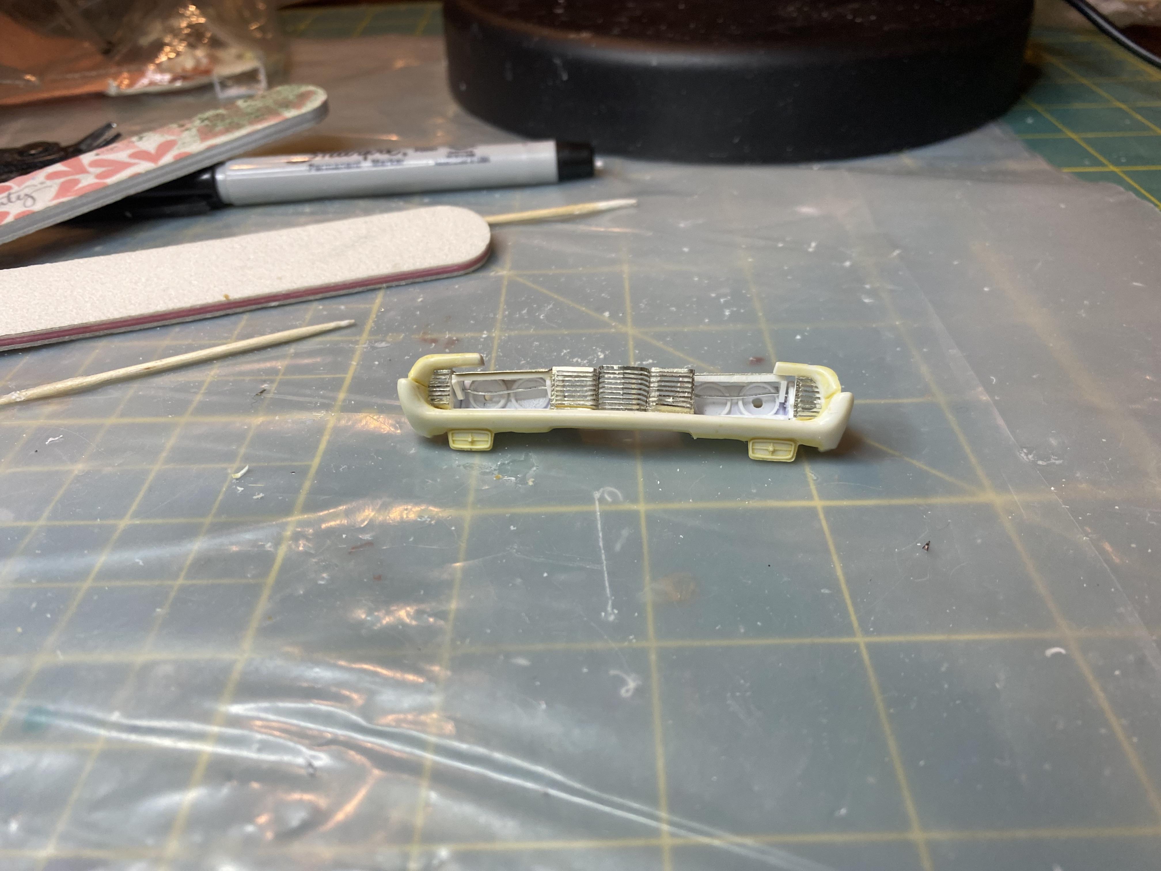

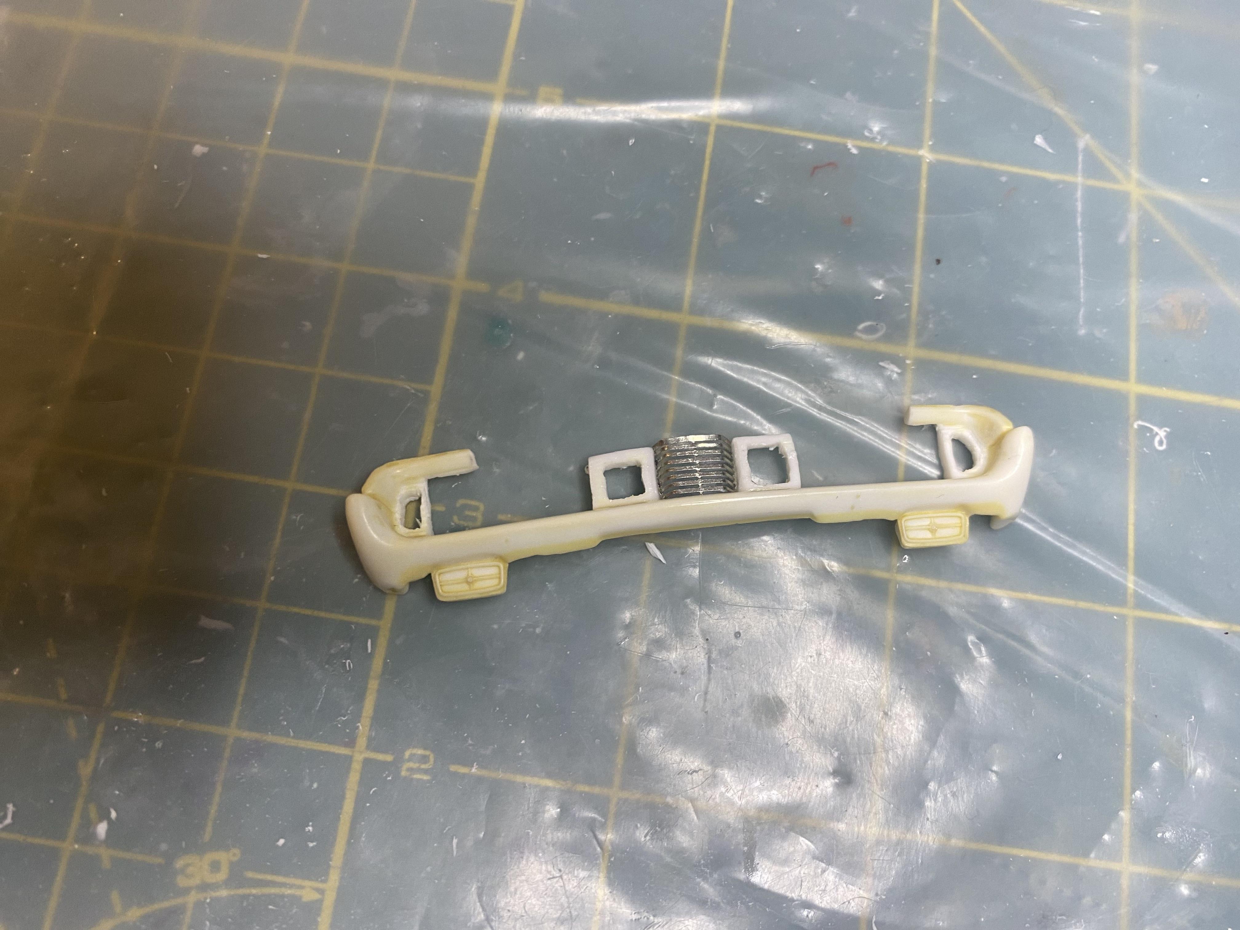

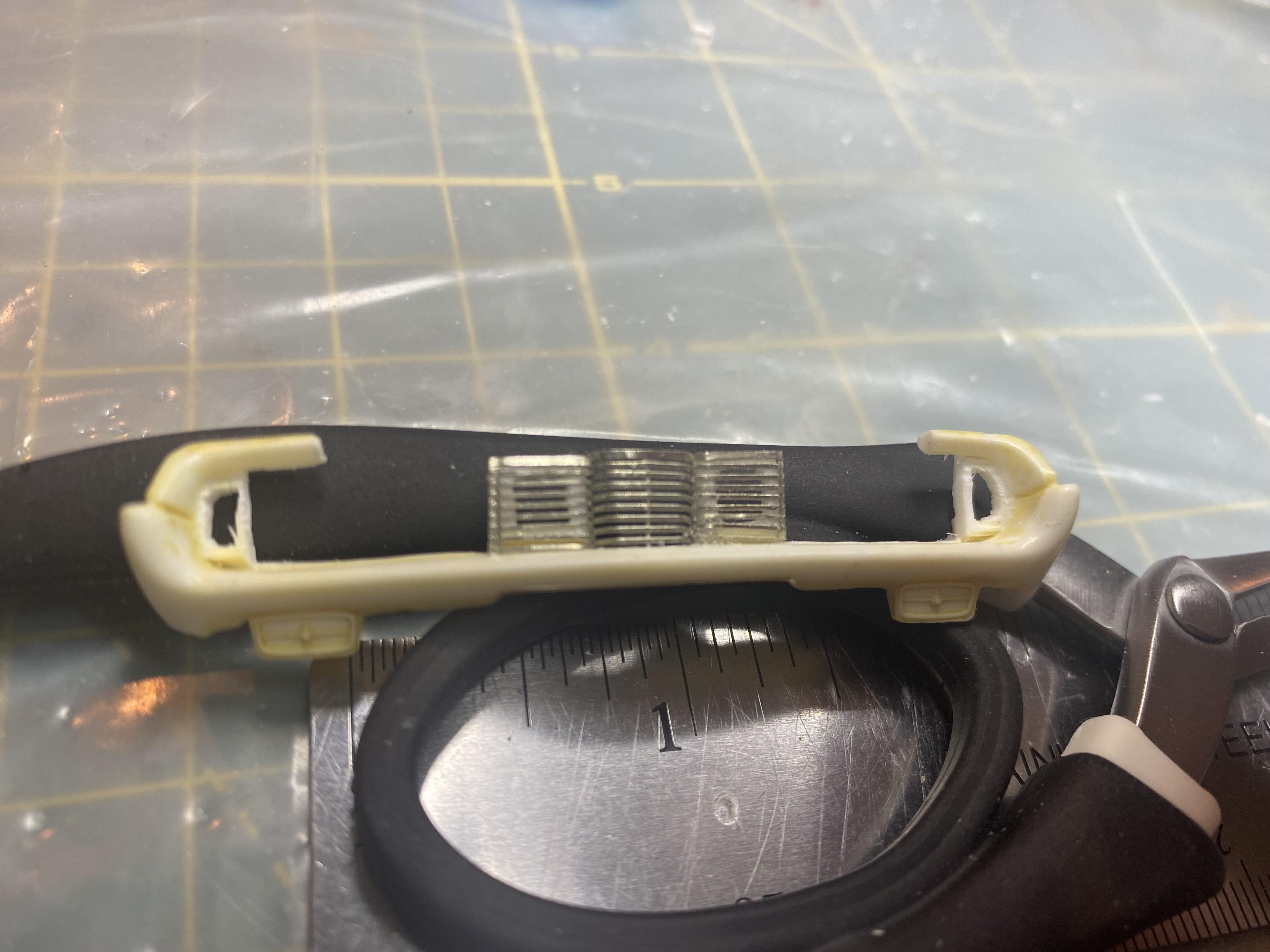

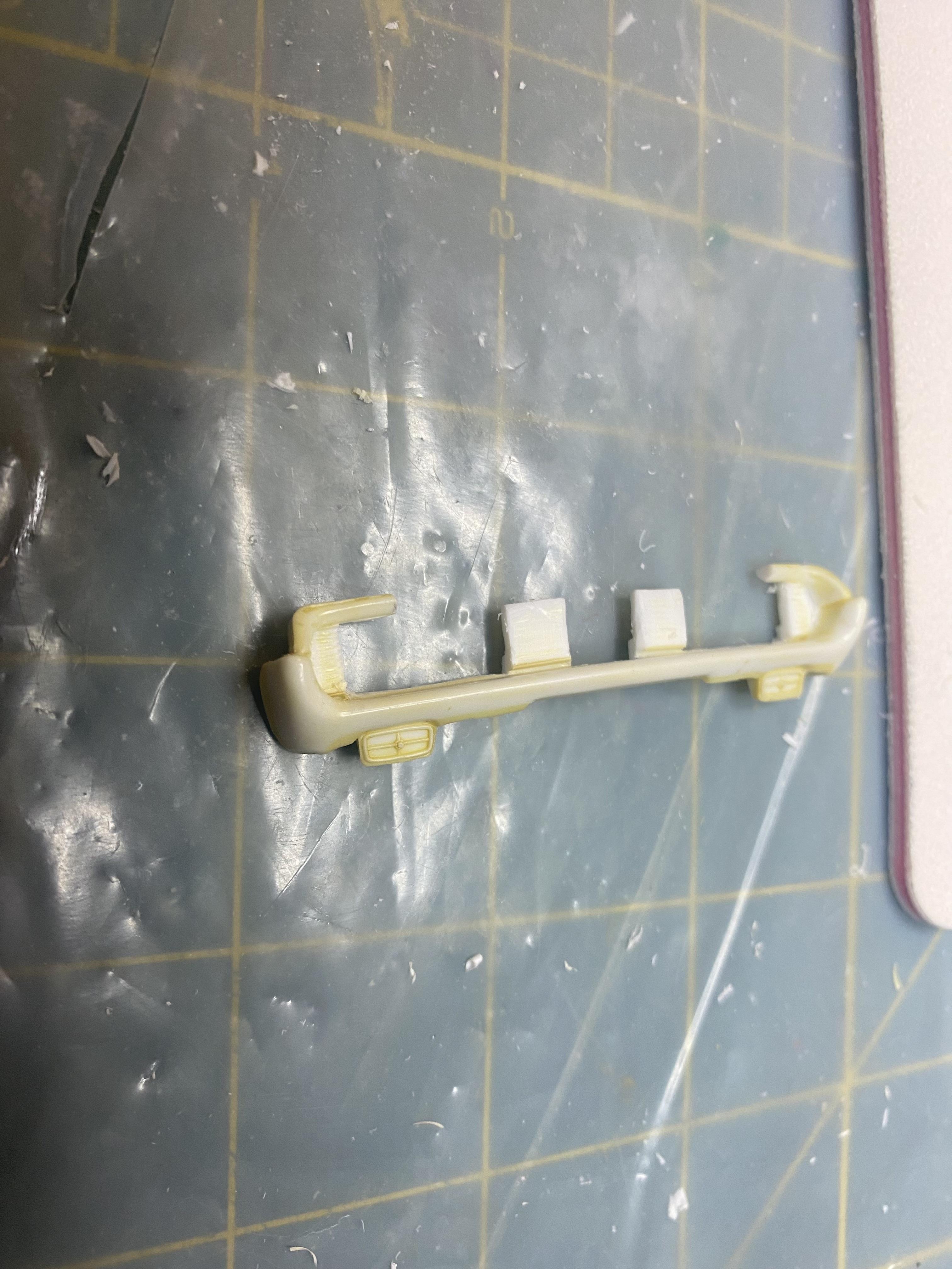

Modified the front bumper / grill to accept the photo-etch grill. I think it looks much better than the kit grill. In the last image the headlight buckets are set and not glued and pivots using wire to mock up not final.

The PE grill is a vast improvement!
David G.
I know right? ?

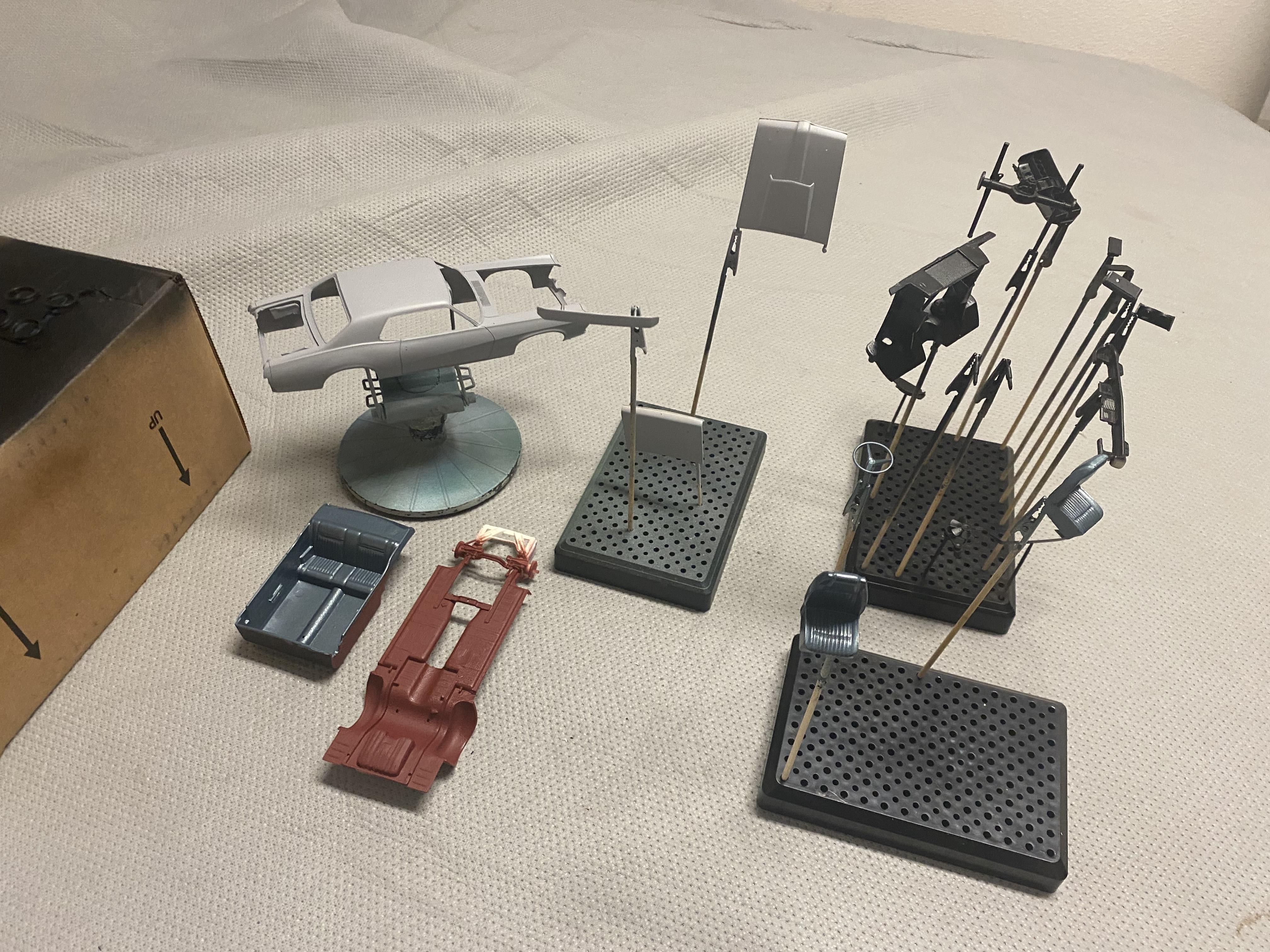

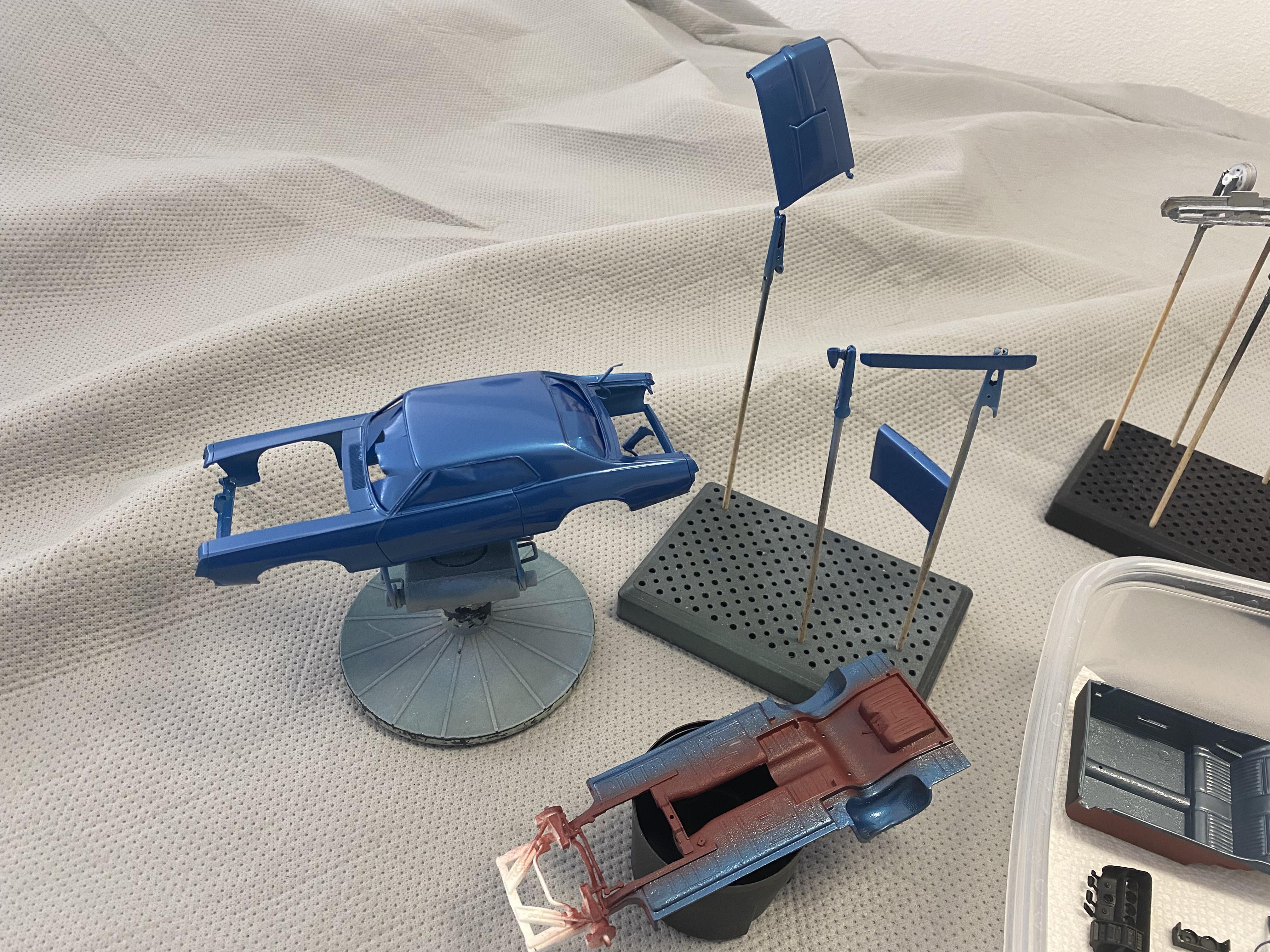

Starting to get color on most components. Got the base coat of Code 6 Bright (Acapulco) Blue on the body and parts.

28 minutes ago, Musclecarbuilder said:
Wow I am really liking that blue!
It is a nice color. Same color as my mother 67 Mustang Fastback. I built a replica of it a little while back.
Yeah it is beautiful, I painted my AMT 71' Mach 1 with that color. It came out really nice.
