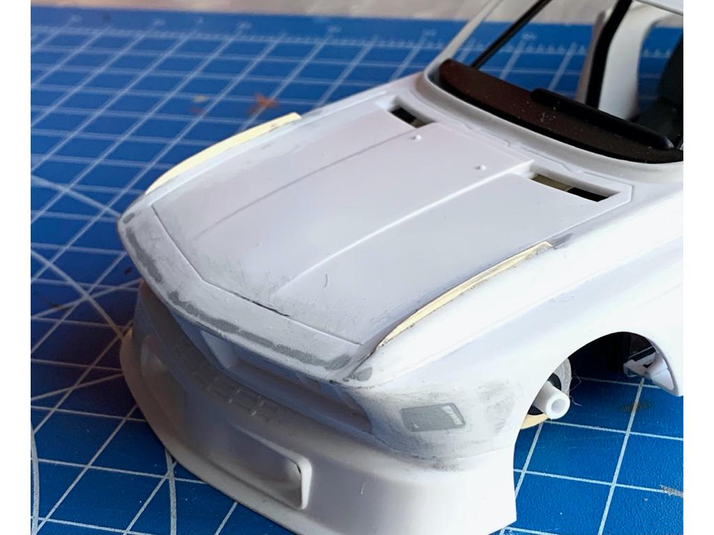

Pierre Rivard Posted October 5, 2024 Author Posted October 5, 2024 On 9/27/2024 at 7:20 PM, Dave B said: And I thought I had patented that sanding drum!!!! Looking really good Pierre, it's going to be the model you first envisaged. Love it. Dave B Absolutely Dave. Lots to do on this one and the Otaki body provides a better starting point than the other one.

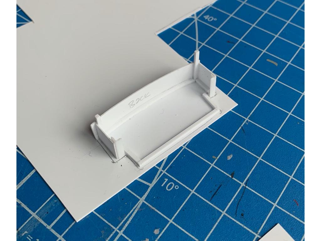

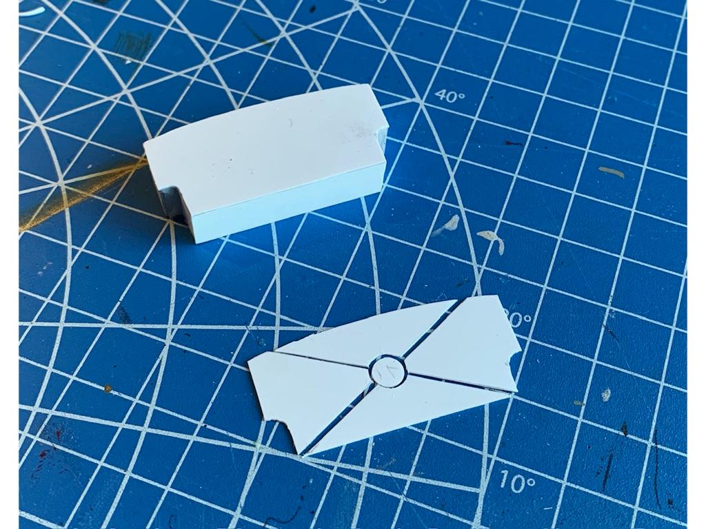

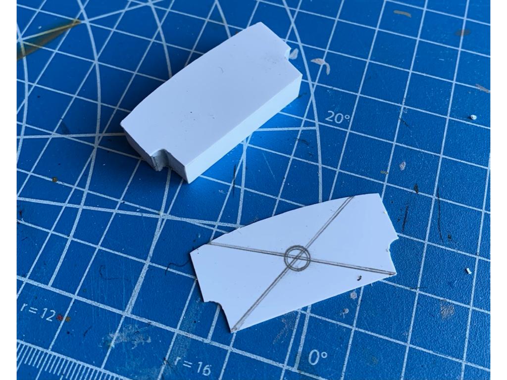

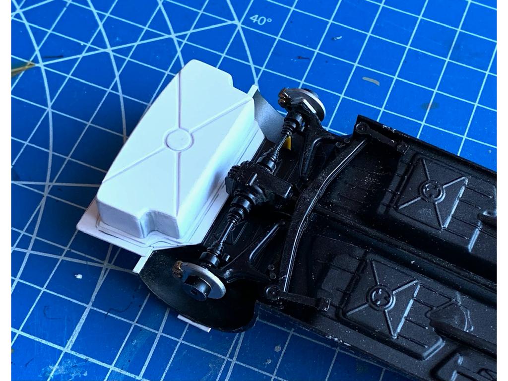

Pierre Rivard Posted October 5, 2024 Author Posted October 5, 2024 On the road car the rear part of the floorpan is occupied by the fuel tank and spare tire tub. The race car has this replaced by a deep tub holding the fuel cells. 8
MarkJ Posted October 5, 2024 Posted October 5, 2024 Wow, Pierre . That looks like a kit part. Looks just like the ref photo and it fits perfectly too. Your usual excellent creation of just what you needed. I don't know why it's called scratch building. Looks more like beautiful building to me. 1

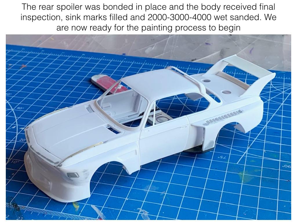

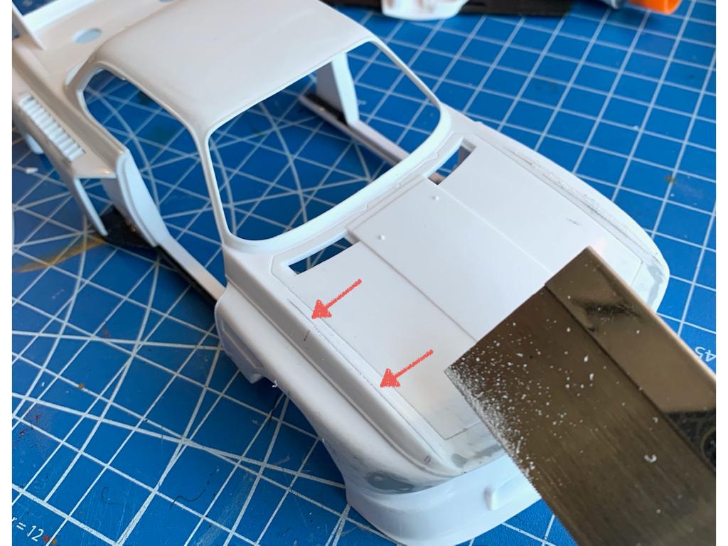

Pierre Rivard Posted October 11, 2024 Author Posted October 11, 2024 Now turning focus back to body mods & fabrication 4
MarkJ Posted October 11, 2024 Posted October 11, 2024 Pierre, Awesome body work again. So clean, so perfect. Can't wait to see some color on this baby.

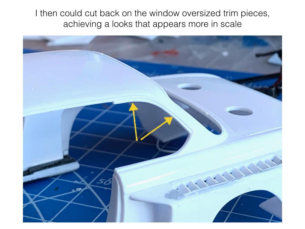

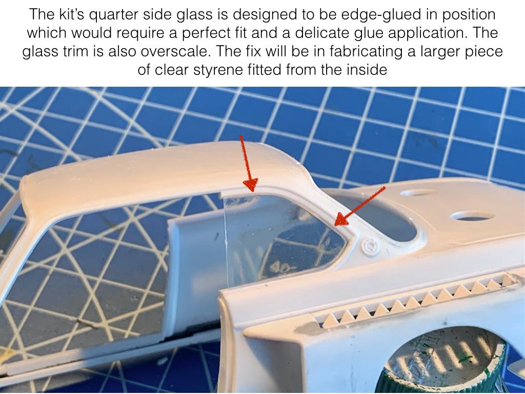

BK9300 Posted October 11, 2024 Posted October 11, 2024 I agree with Mark - beautiful fabrication and great trick with the styrene template for your quarter side glass.

Pierre Rivard Posted October 12, 2024 Author Posted October 12, 2024 15 hours ago, MarkJ said: Pierre, Awesome body work again. So clean, so perfect. Can't wait to see some color on this baby. Thanks Mark. It should have color done in about a week 14 hours ago, BK9300 said: I agree with Mark - beautiful fabrication and great trick with the styrene template for your quarter side glass. Thanks Brian, many fixes needed to make this body right but I think I'm there. 14 hours ago, JollySipper said: My favorite part is about to begin, the paint process! Can't wait to see how it turns out........ This is gonna be quite the special build! Paint is also my favorite part. 11 hours ago, absmiami said: Are we - brush - painting ? Of course! I'm not worried about paint but the LeMans decals that will follow are definite knee shakers for me...

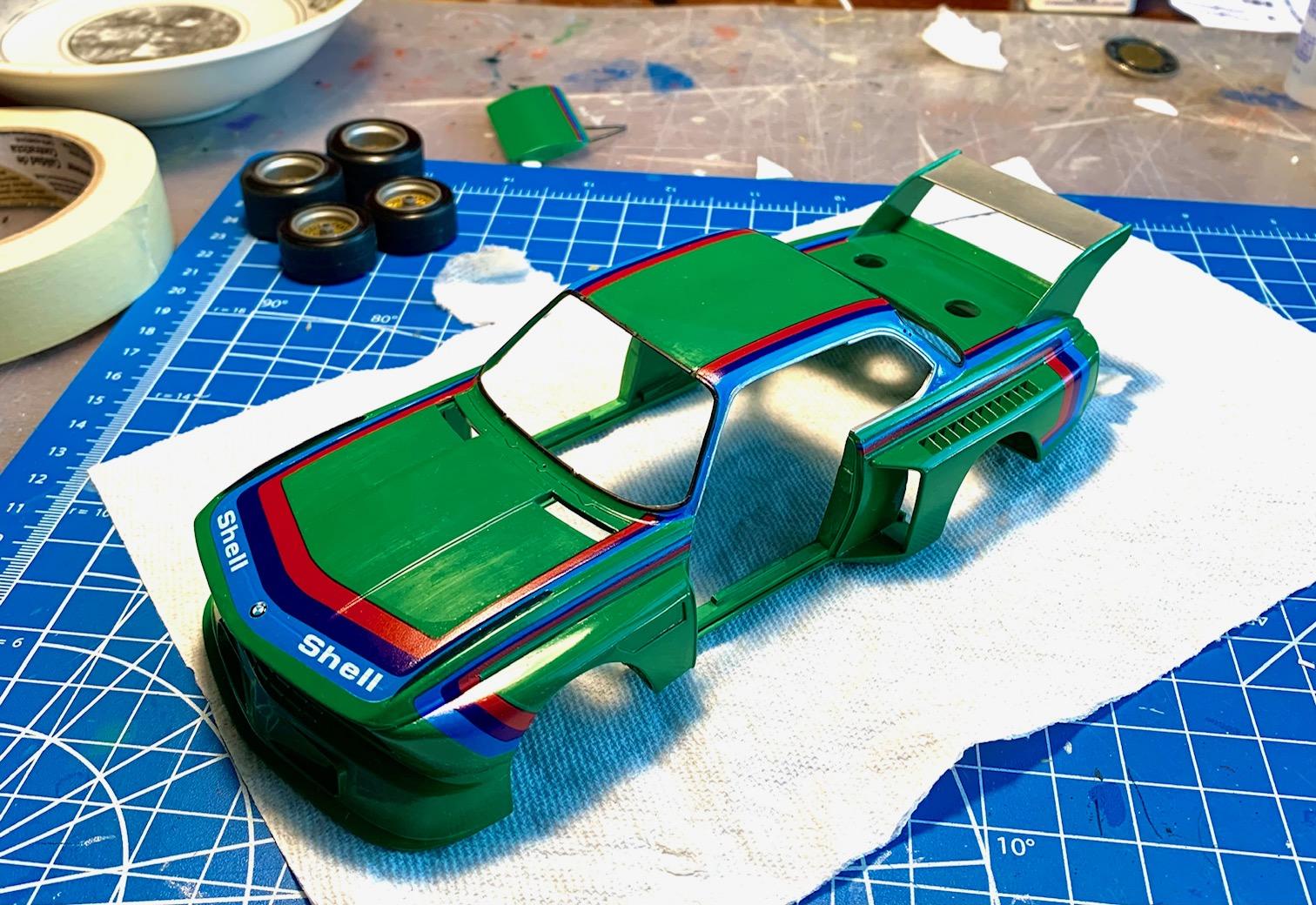

Pierre Rivard Posted October 28, 2024 Author Posted October 28, 2024 A small step for man.... ok, not that dramatic. Decals are what scare me the most about this build. Mainly because I am using a sheet from LeMans Decals and these have been giving me fits in the past. They are fragile & wrinkly and the surface a bit porous (or so it seems). This car has big stripes that will need to fit compound curves (fenders). I've decided to tackle decals before committing to building the interior and chassis. So far I have the complex decals laid out and have survived it by handling them very delicately. The make or break stripes are done, the rest will come later but none of them worry me at this stage. BIG RELIEF!!! 5
MarkJ Posted October 28, 2024 Posted October 28, 2024 Pierre, I forgot. Does the hood open on this build? Decals look perfect where I'm sitting.

Pierre Rivard Posted October 29, 2024 Author Posted October 29, 2024 16 hours ago, MarkJ said: Pierre, I forgot. Does the hood open on this build? Decals look perfect where I'm sitting. Hood is molded shut. I'm very happy with the decals. I can now breathe easier and carry on with this build.
Pierre Rivard Posted October 29, 2024 Author Posted October 29, 2024 2 hours ago, Mattilacken said: Great build! Delicate work on those fender gills! They must have been a Pita at some point Great work and as you say, wheels and tires is Everything on a build. Is it the light in the last pic that makes it look like burnthrough on the roof and hood? Thanks Anton. The fender gills were actually pretty easy to do once I had figured out a method of fabrication. You got me worried for a moment and I double checked my paint. No burn through but a few spots where my sand & polish has not fully restored the gloss level. I get that sometimes but the seal coat over decals usually evens the gloss quite well.
