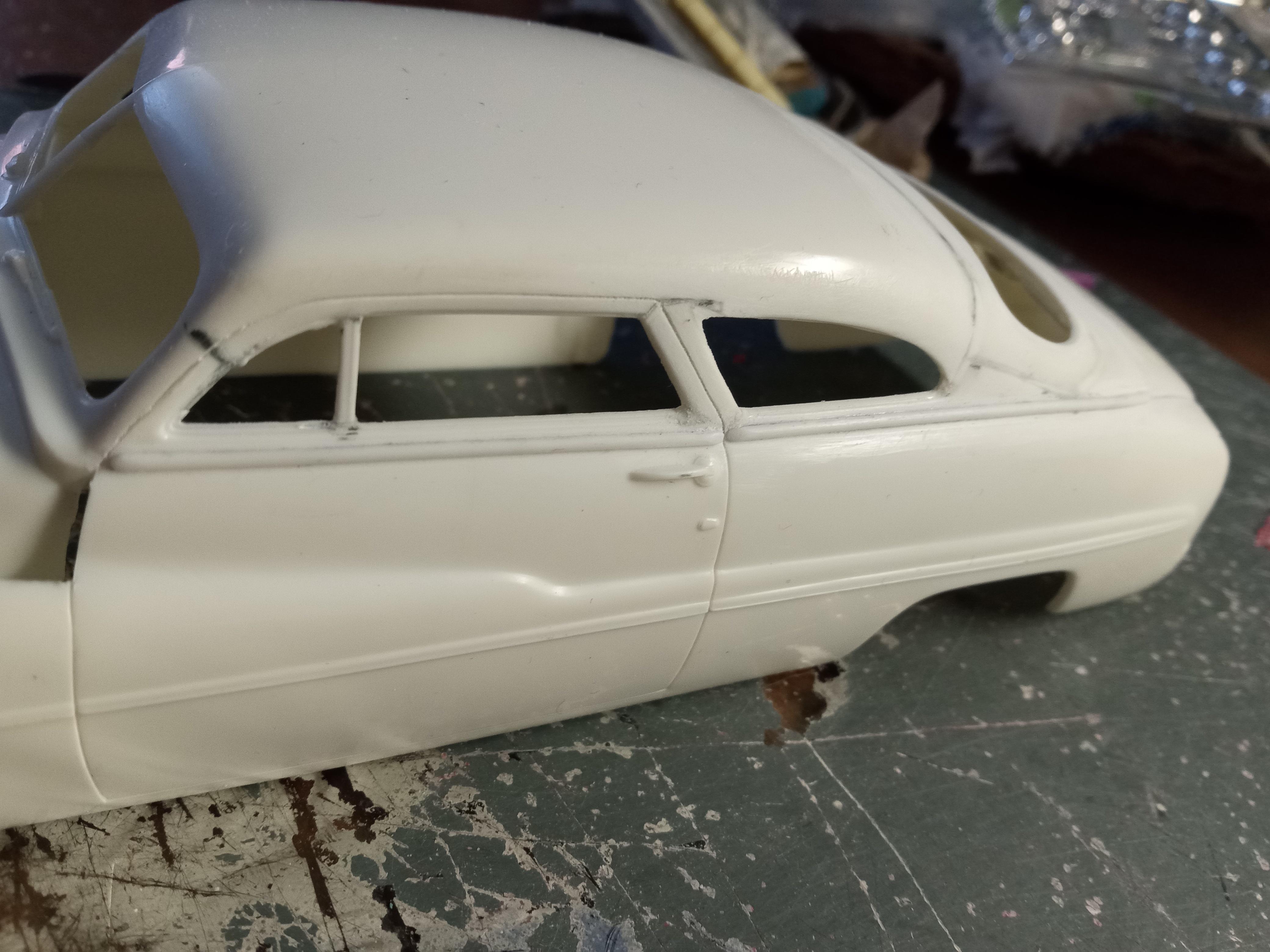

I've chopped a handful of Mercurys and it is not easy to get the top flowing from front to back, nor is it easy to get it even from left to right. You've done a fine job! On your next one, if you like you can keep a small center section (a 1/4 to 1/2in. will suffice) of the rear window attached to the top instead of cutting the rear window completely free. This small attached section can be a hinge that can be gently bent to rotate the window to lower it into place as the top moves forward and down to realign the A pillars. I also like how you angled the B pillars farther forward than where they normally line up after a chop! Looks way better in my eyes. Famed norcal customizer John Aiello did a similar thing on my 1:1 shoebox ford. He told me it was the same amount of work so why not! 😉image.png.c09a9c017b58e60e2c474ebc4f2b1f2a.png

On 2/4/2025 at 4:45 PM, Supernurd said:
I've roughed in the C pillars.  In Gene's tutorial he converts it to a hardtop but shows the process for adding them back in.  Most customizers delete the locks and door handles but I'm leaning toward keeping them just to be different.  I may keep the stock grille too.  And the flathead.  I'm more concerned with thinking about what to do about the headlight bezels.  The ones in the kit are horrible.
The slanted C pillars look fantastic! Did you make new ones or did you modify originals?
I used the originals, rescribed the lines, and filled with CA glue. Thanks for the interest!
