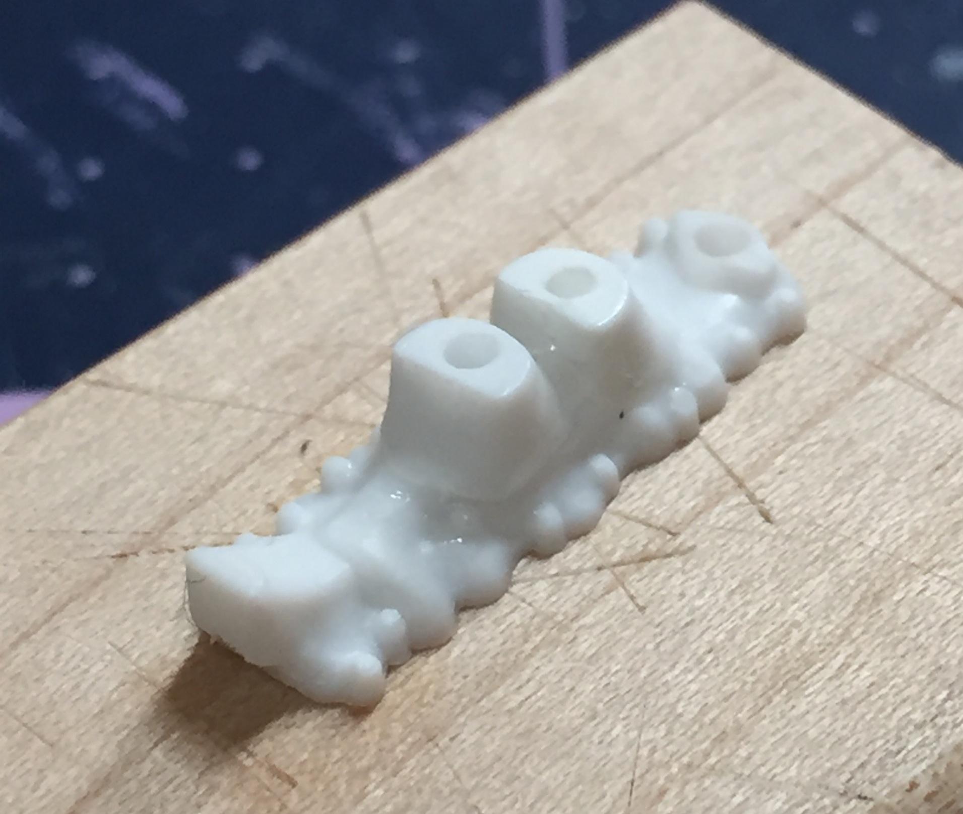

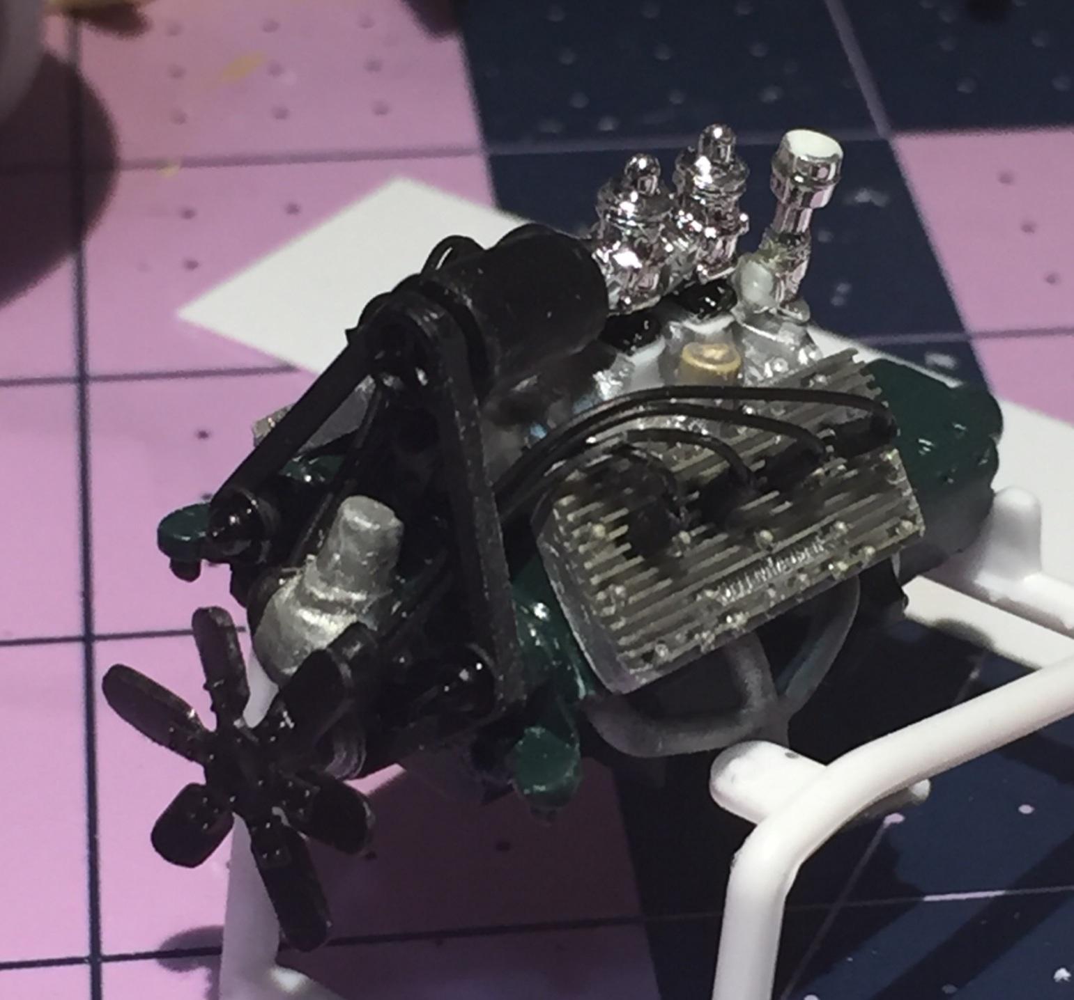

Got the engine a bit further along with MCG heads and a modified manifold, some wires too.  The interior tub was missing the mounting tabs that locate in slots in the firewall. I glued some pieces of .060x .156 into the slots for a way to secure the tub later.  If you build the Revell '40 Standard kit, you must add your own drain plug (black circle) to the gas tank (if you want one, that is 😅)  The red circle is just areas that had to be filled and ignore the red arrows. Then we have the Coke fenders after opening up the inner fenders to give the tub room. At this point the floor has been attached to the fender module.  At the bottom is the newly minted manifold. The original fuel pump has been replaced by an electric unit hidden in the trunk 🙂.

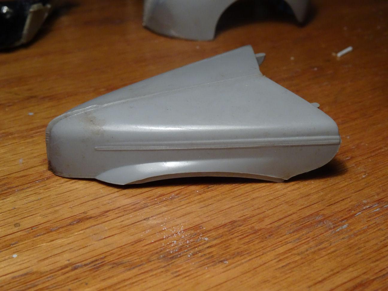

You want to try and save this poor guy, he has divining rods too.DSC01497.JPG.187af1942def6ba728e5eec762489a99.JPG
Look how much trim he has though.DSC01498.JPG.8360df4b7c1ea34e80c594ce3134b7cc.JPG

That's a nice looking hood, Len.

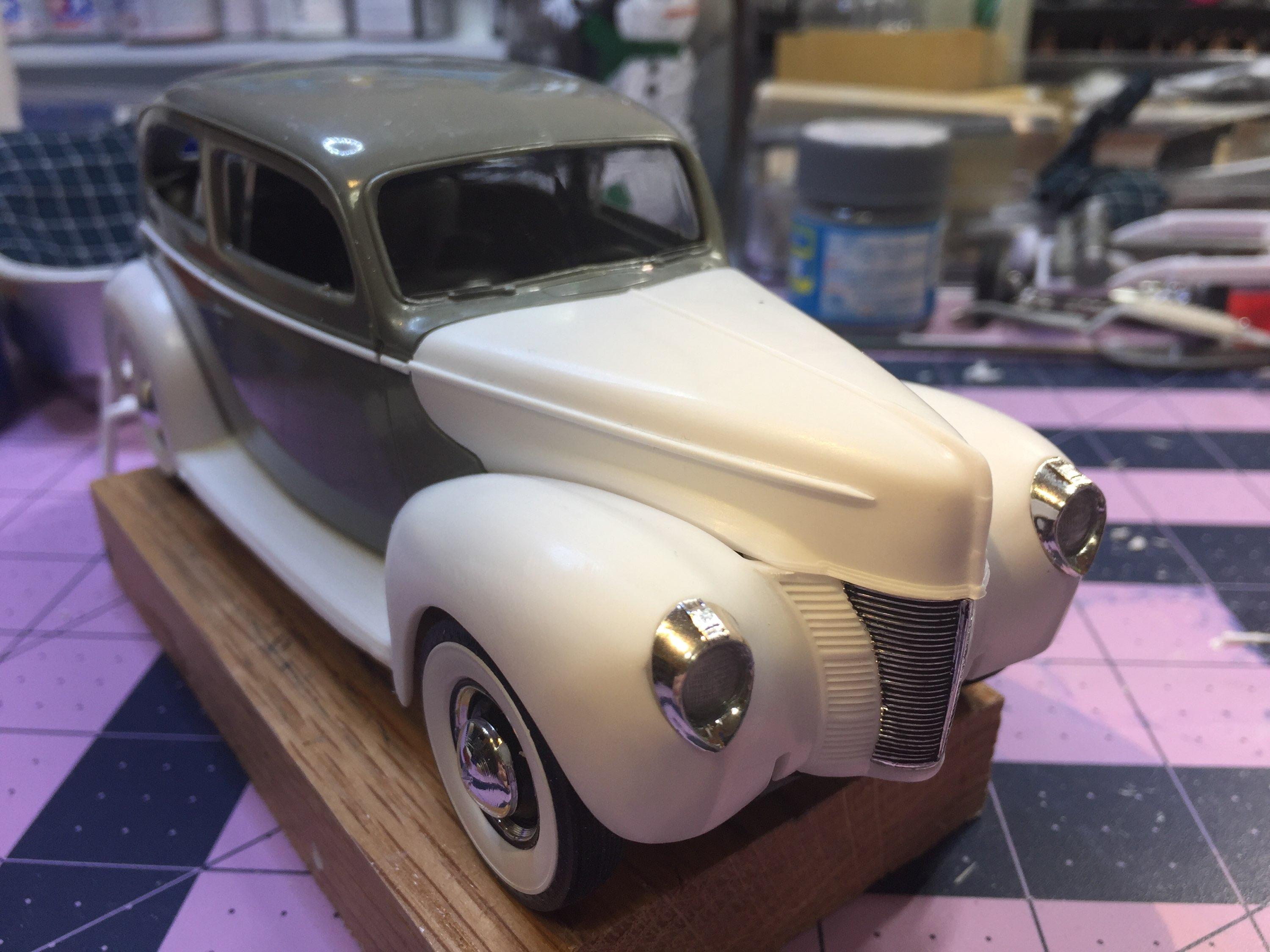

Because the chassis is Revell and the body is AMT, the bumper brackets needed to be attached to the frame and the body needed to be tweaked a bit. The front just needed a little enlarging of the slots. The rear was off a few mms.  The bottom corners of the body had to be patched up with CA and some small styrene bits.
The radiator is the Revell part as well as all four hoses. I added .020 brass to the hoses and drilled the outlets to help with subsequent assembly.
The hood hinges are quite free to move so I figgered a pair of  magnets might be a good idea.  I put the mounting in place in the hood and closed the hole behind the grille.

You want one, I have a few of these early ones.

When my tudor goes over a speed bump the hood will fly open and slam shut. The magnets are a necessity 😌.
They're getting along now but I had to promise the remains of the the Revell kit a serious top chop. Then I have to turn what's left of the AMT kit into some stupid diorama. I'm not doing that! 😠
