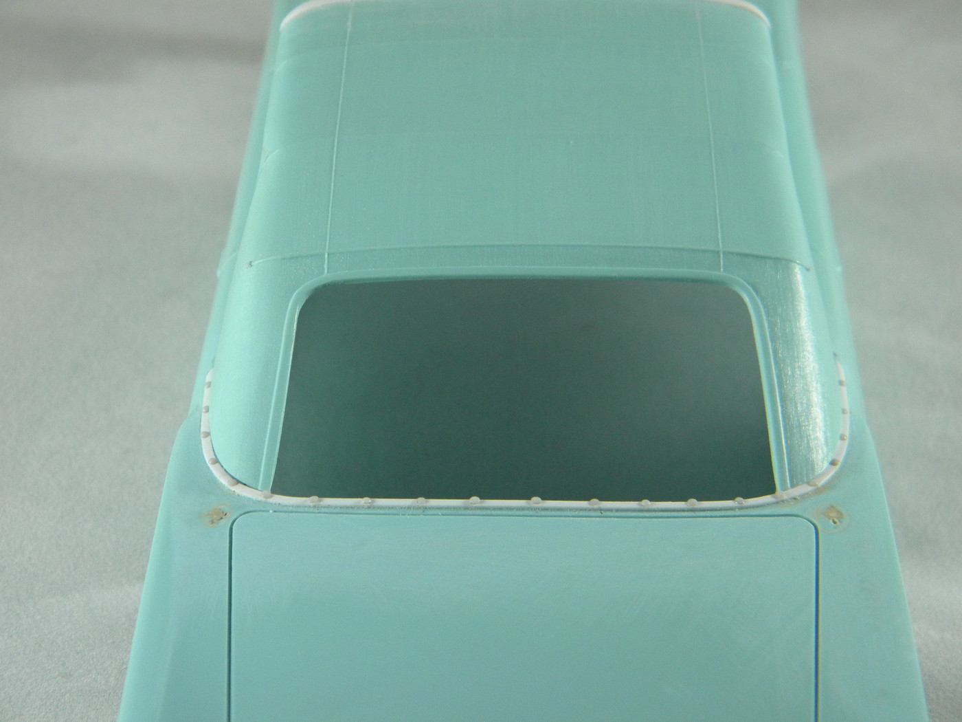

StevenGuthmiller Posted February 13 Posted February 13 I always just use thin evergreen rod. Drill holes of a corresponding size and glue in short pieces of rod. Once dry, trim the rods and sand down to the length needed. I've never used this method for a truck tonneau, but I use it frequently to add convertible top boot snap moldings. Steve 5
