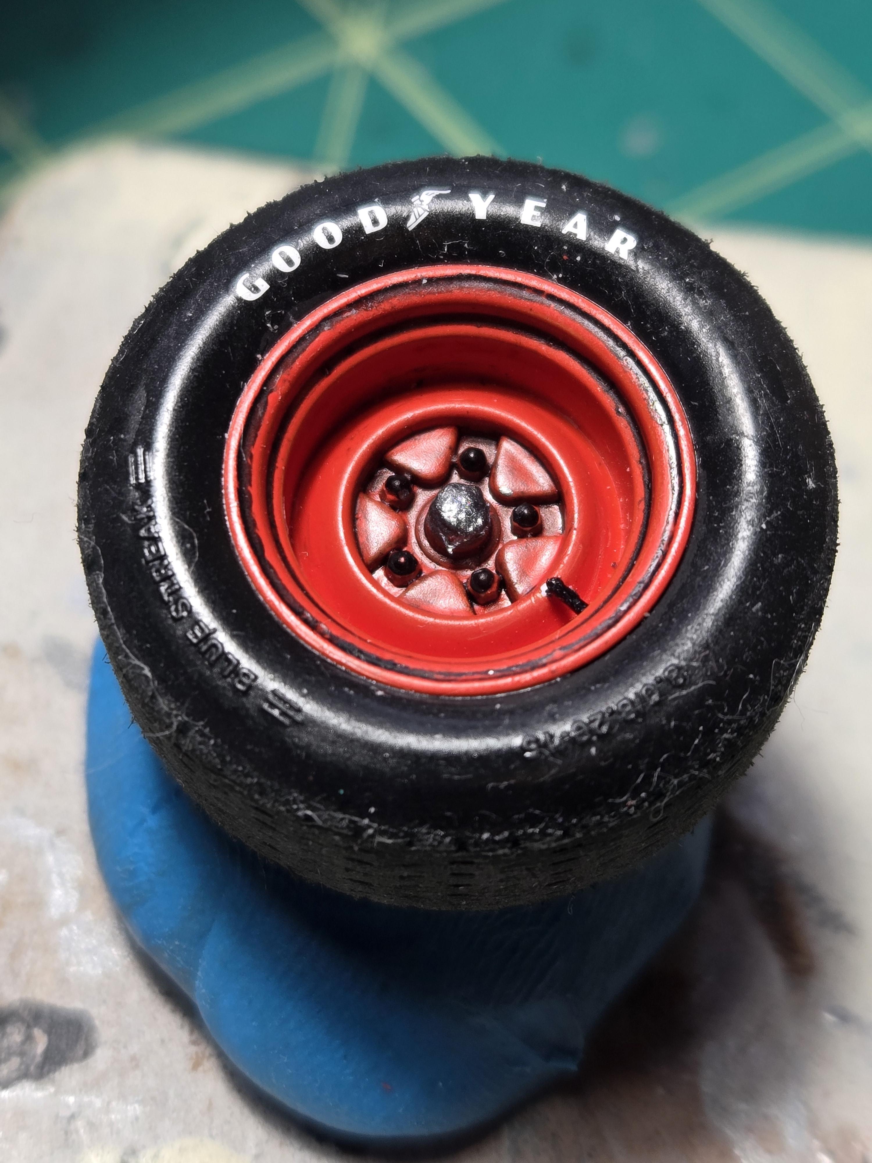

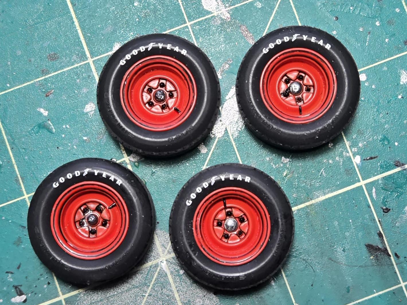

CA Whitecloud Posted February 20 Posted February 20 Tire Finishes- I purchased aftermarket tires and wheels, applied the decals and then a light shot of Testors Dullcoat. They looked really good. After a bit the dullcoat started to flake off. Since I already had the wheels in, I brushed on Vallejo Matte Finish. That gives off an almost fuzzy look. I'm afraid to use any solvents because I can't loose the decals. It is not a show stopper, just wonder about remedies and/or other techniques to add realism to the tires. Thanks in advance.
Chris V Posted February 20 Posted February 20 I'm afraid there's not much you can do about the set you have. Enamels and most types of lacquer won't work on vinyl/rubber parts. Enamels won't dry and will remain tacky, and lacquers have a tendency to flake off the soft surface. The best way to seal tire decals is to airbrush them with acrylic dull clear. However even acrylics are differently composed, so it's best to test their compatibility on a scrap piece of decal before applying them to the finished tire. Furthermore the decals need ample time to thoroughly dry and set before applying the clearcoat. 1
Shark Posted February 20 Posted February 20 I lightly sand the side walls with 400 grit wet paper, then wash the tires with a toothbrush and Dawn dish liquid. Let them air dry and then start coating with your product of choice. Mine is a light gloss clear coat, apply decals, light mist of clear smoke to tone down the lettering, then a coat of matte clear. I use Tamiya spray cans for all of this and wait a day or two between steps.
Fat Brian Posted February 20 Posted February 20 If the tires are the vinyl or rubber stuff you need Mr Super Clear. It's a bit pricey but will dry on materials other things won't. 1

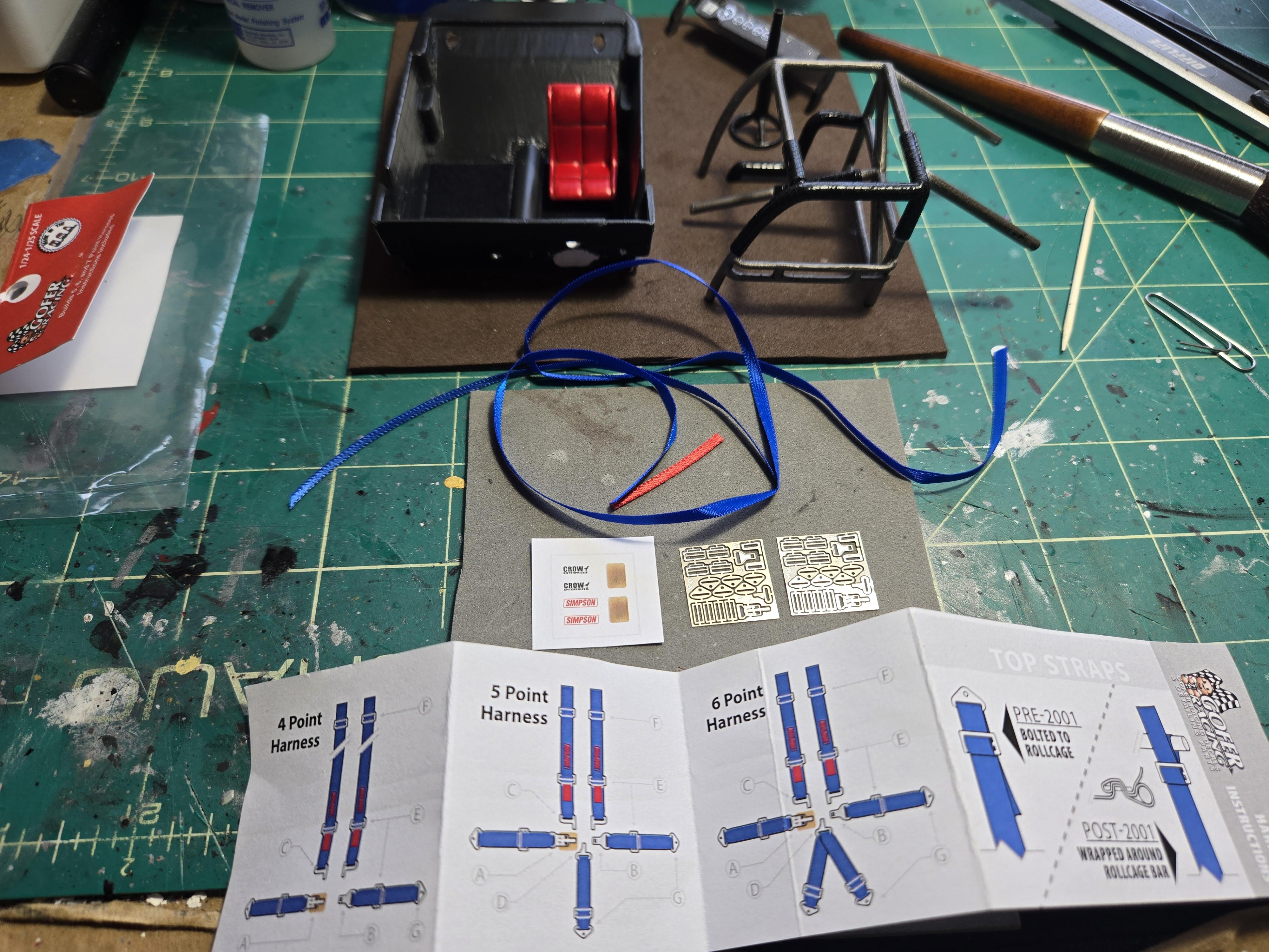

CA Whitecloud Posted April 1 Author Posted April 1 (edited) Racing Harnesses - How to Does anyone have any insight on assembling these add-ons from Gopher Racing? I'm going with the four-point connection. I've done single belts before, so I have a couple tricks handling the ribbon like shape cuts, burning the finished edges, and a little dark varnish to age and stiffen them up a bit. What I don't see is how the belts get threaded through the different buckles (the stops and starts). All thoughts appreciated. Edited April 1 by CA Whitecloud
stitchdup Posted April 1 Posted April 1 1 hour ago, CA Whitecloud said: Racing Harnesses - How to Does anyone have any insight on assembling these add-ons from Gopher Racing? I'm going with the four-point connection. I've done single belts before, so I have a couple tricks handling the ribbon like shape cuts, burning the finished edges, and a little dark varnish to age and stiffen them up a bit. What I don't see is how the belts get threaded through the different buckles (the stops and starts). All thoughts appreciated. have a look at the seatbelts in your car. a different style but the basics are the same and its much easier than trying to explain it. 1

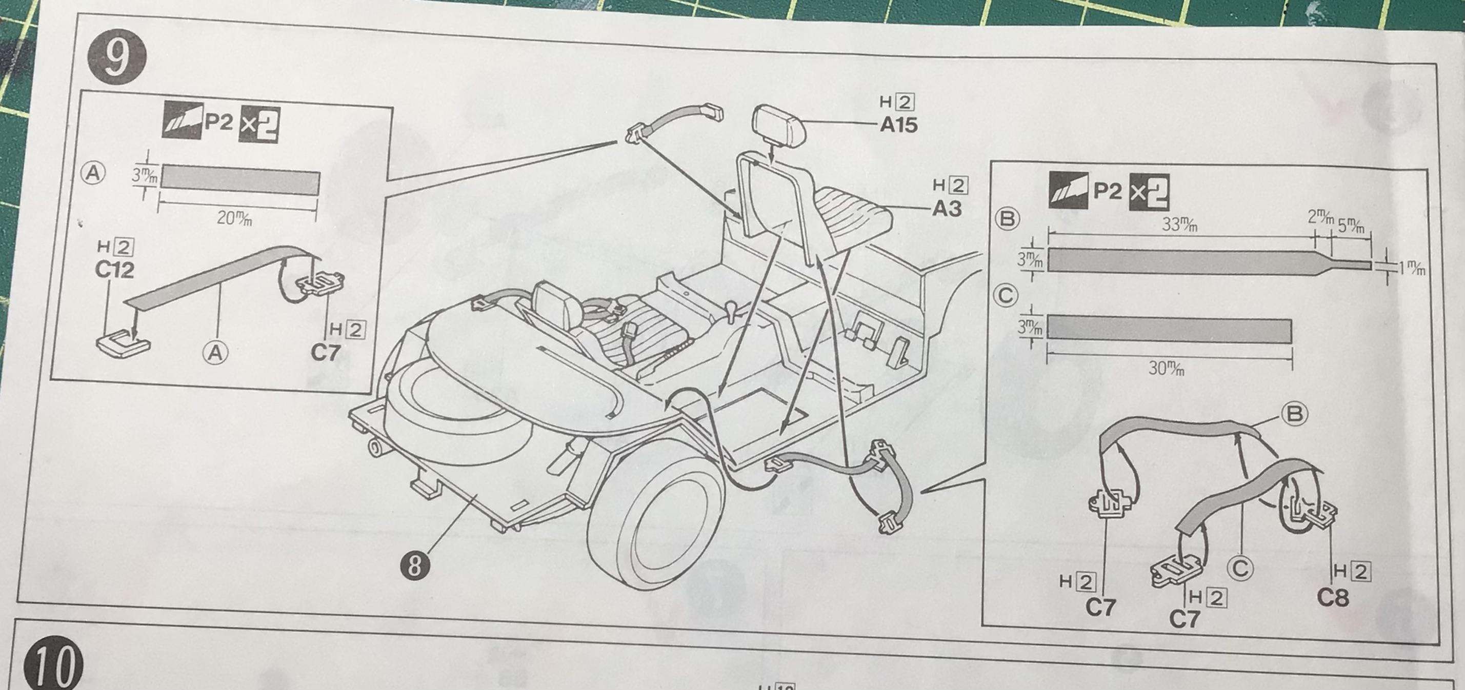

NOBLNG Posted April 2 Posted April 2 (edited) 8 hours ago, CA Whitecloud said: Racing Harnesses - How to Does anyone have any insight on assembling these add-ons from Gopher Racing? I'm going with the four-point connection. I've done single belts before, so I have a couple tricks handling the ribbon like shape cuts, burning the finished edges, and a little dark varnish to age and stiffen them up a bit. What I don't see is how the belts get threaded through the different buckles (the stops and starts). All thoughts appreciated. Don’t know if this helps, but the Fujimi kit I’m working on has this method in the instructions. Edited April 2 by NOBLNG

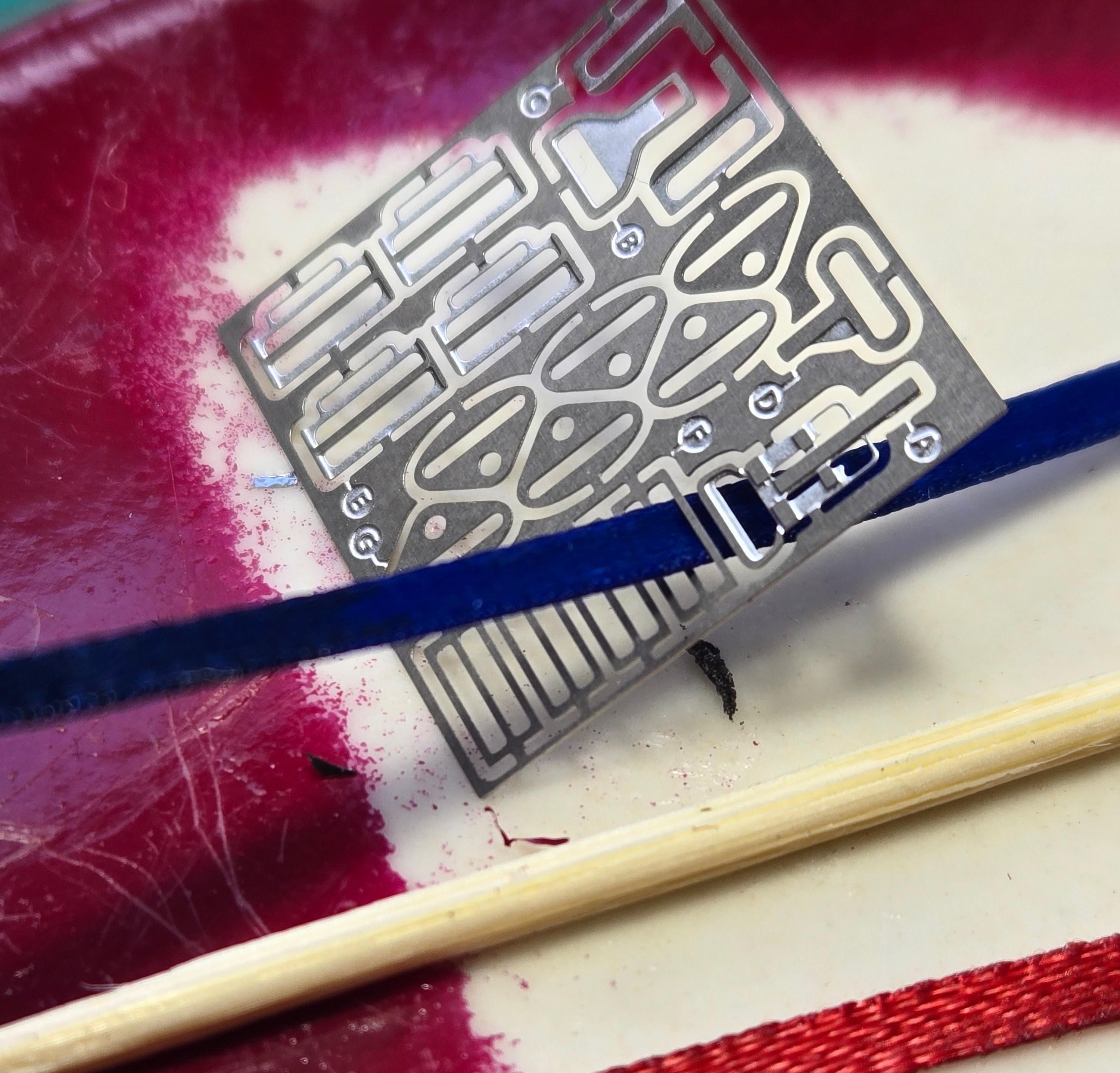

CA Whitecloud Posted April 4 Author Posted April 4 why are the buckles so obnoxiously wide? Or should I make a wider ribbon...or just go with it?
peteski Posted April 4 Posted April 4 (edited) Seat belts in real cars come in different width. Passenger var belts are narrower than racing belt harnesses. Sometimes racing harnesses uses multiple width belts. I'm sure you know that already. But in this case I suspect that the photoetched hardware is either designed for a larger scale model, or the belt material is the wrong size (I know, the packaging shows 1:24/25 SCALE). But clearly, something's off. Even the included instructions show the buckles and other hardware fitting tighter to the belts. Racing belts are usually 3" wide. That scales out to 3/25=0.12" in 1:25 scale or smidge smaller than 1/8". How wide is the belt material? If it is 1/8", then the photoetched metal pieces are designed for larger scale models. Edited April 4 by peteski 1

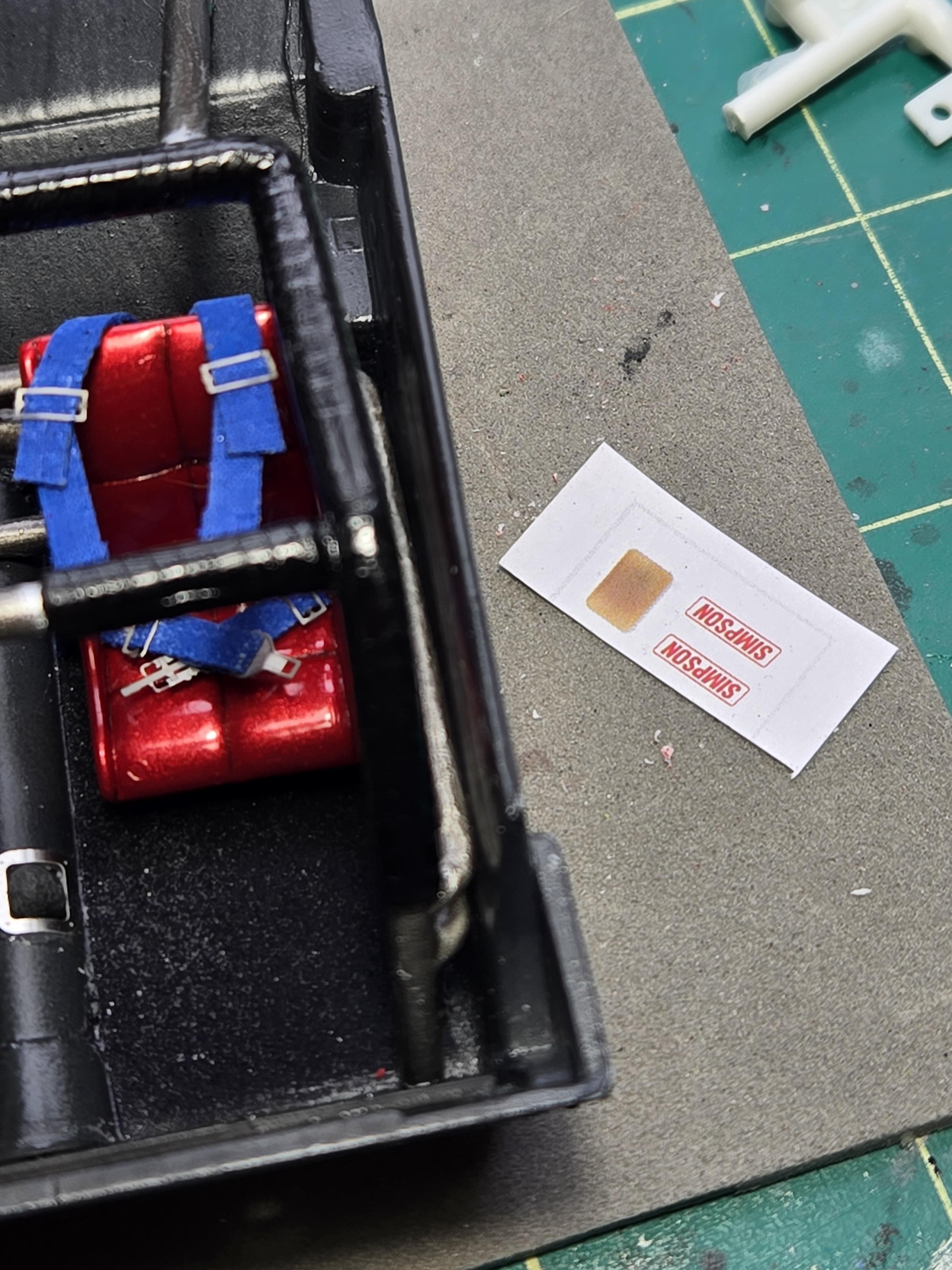

CA Whitecloud Posted April 9 Author Posted April 9 I know you all are waiting to see how this is going to play out. So here is where I'm landing with the seatbelts. I created my own straps from medical tape and blue paint. I think they look good. I had trouble judging the lengths between buckles. I cut holes in the seat sides for a pas-thru. I don't know if I want to shoe the lap belts bolted (cage or floor?) or just tuck them under the seat. Also, what to do with the little pics on plain paper? White glue? 2

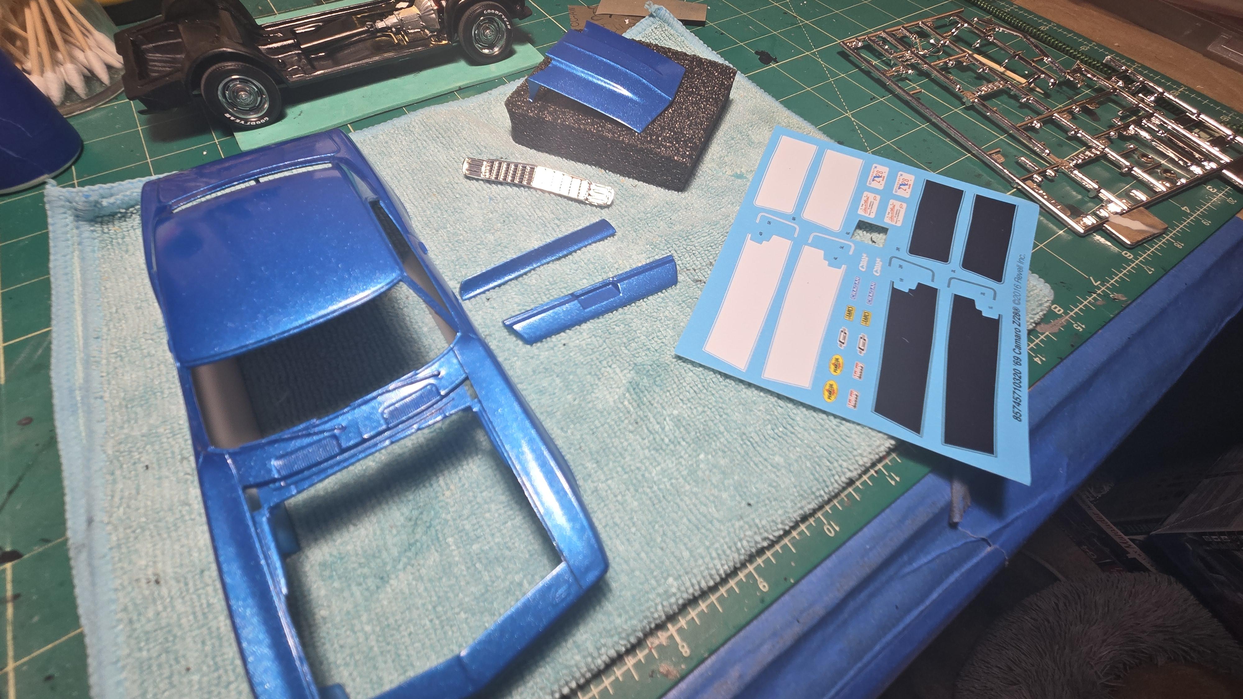

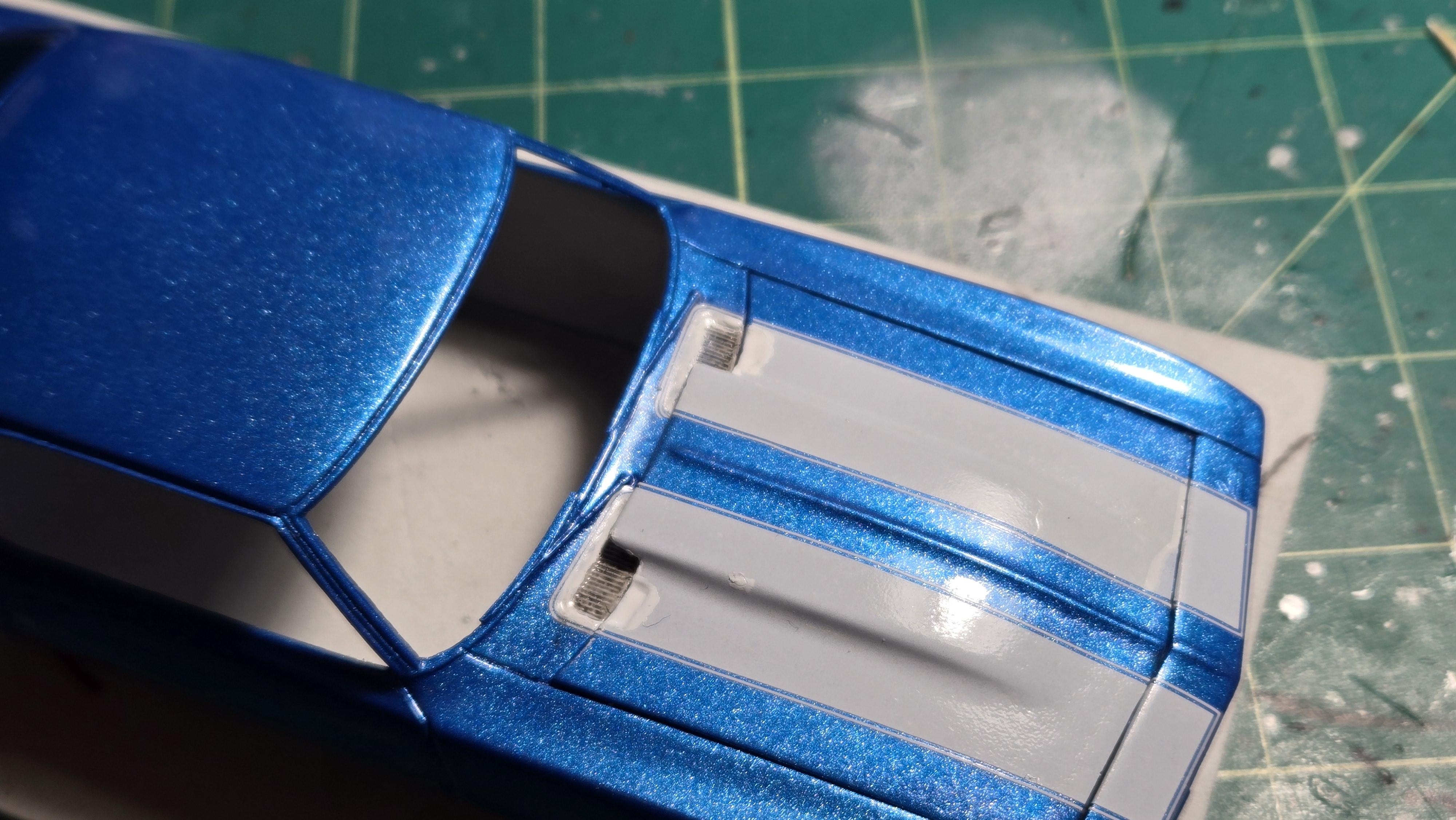

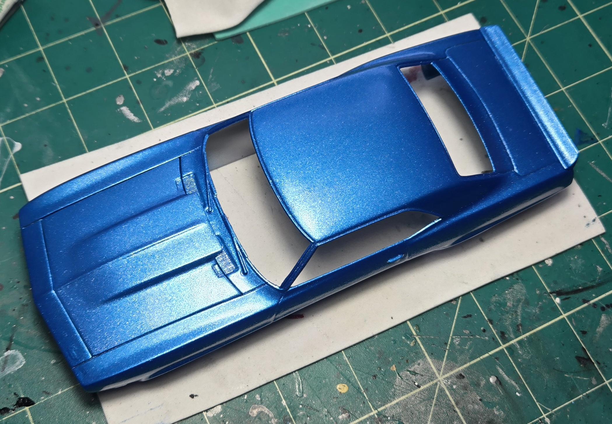

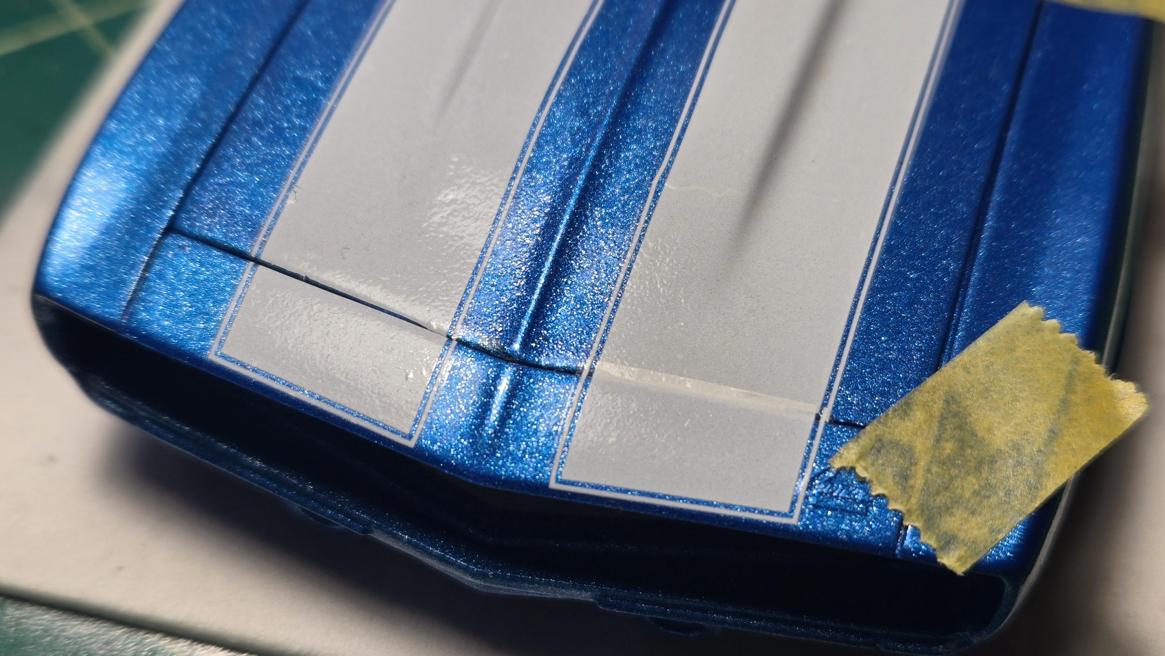

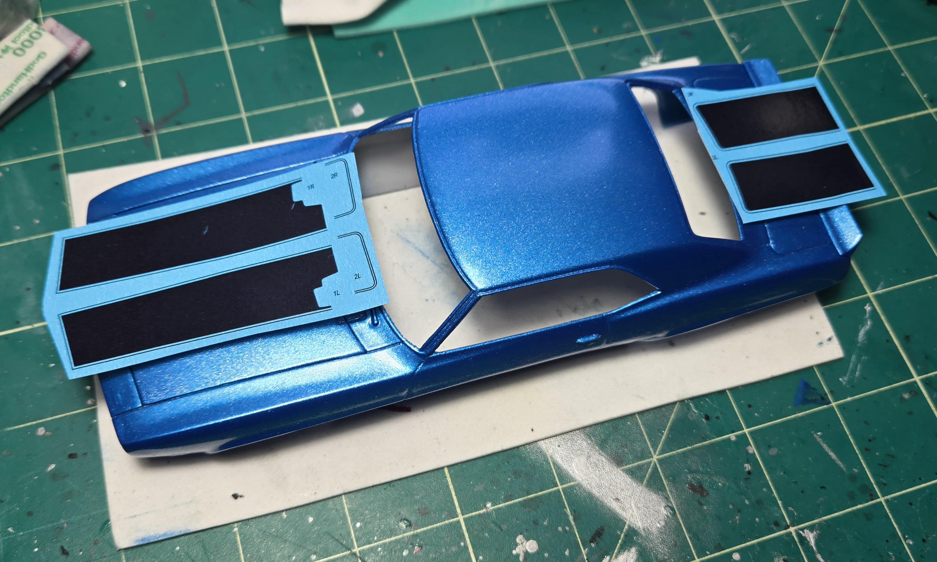

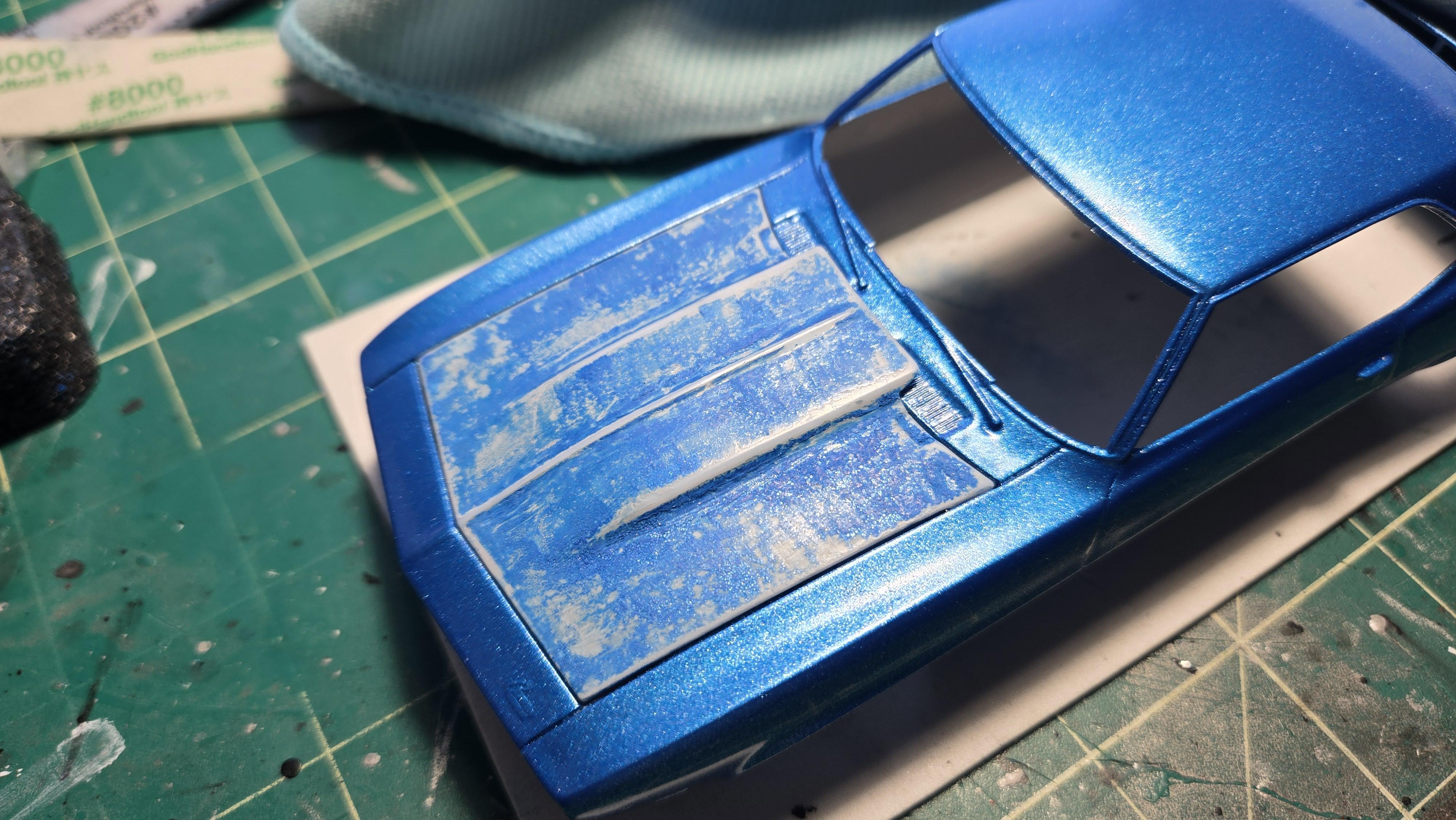

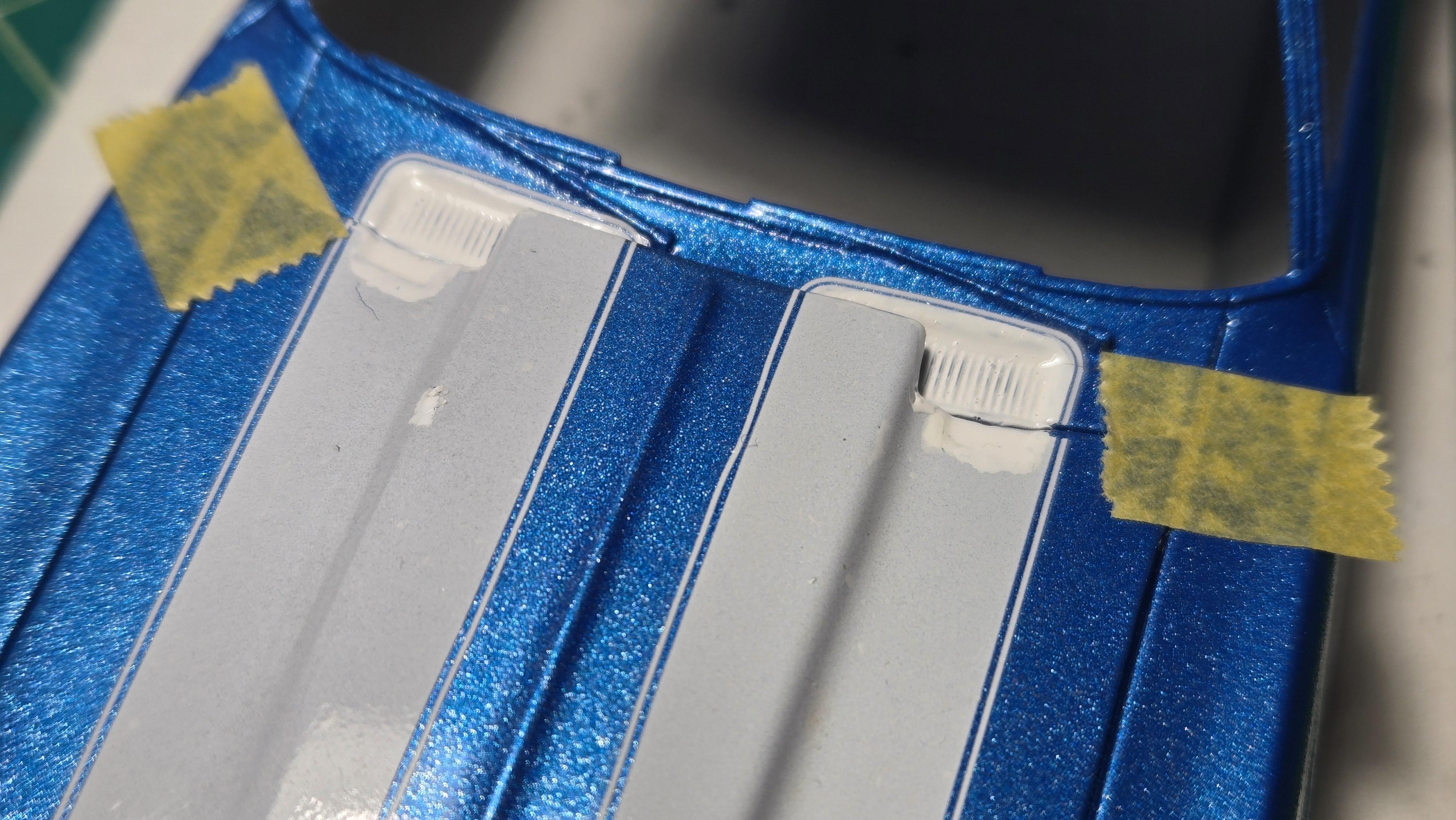

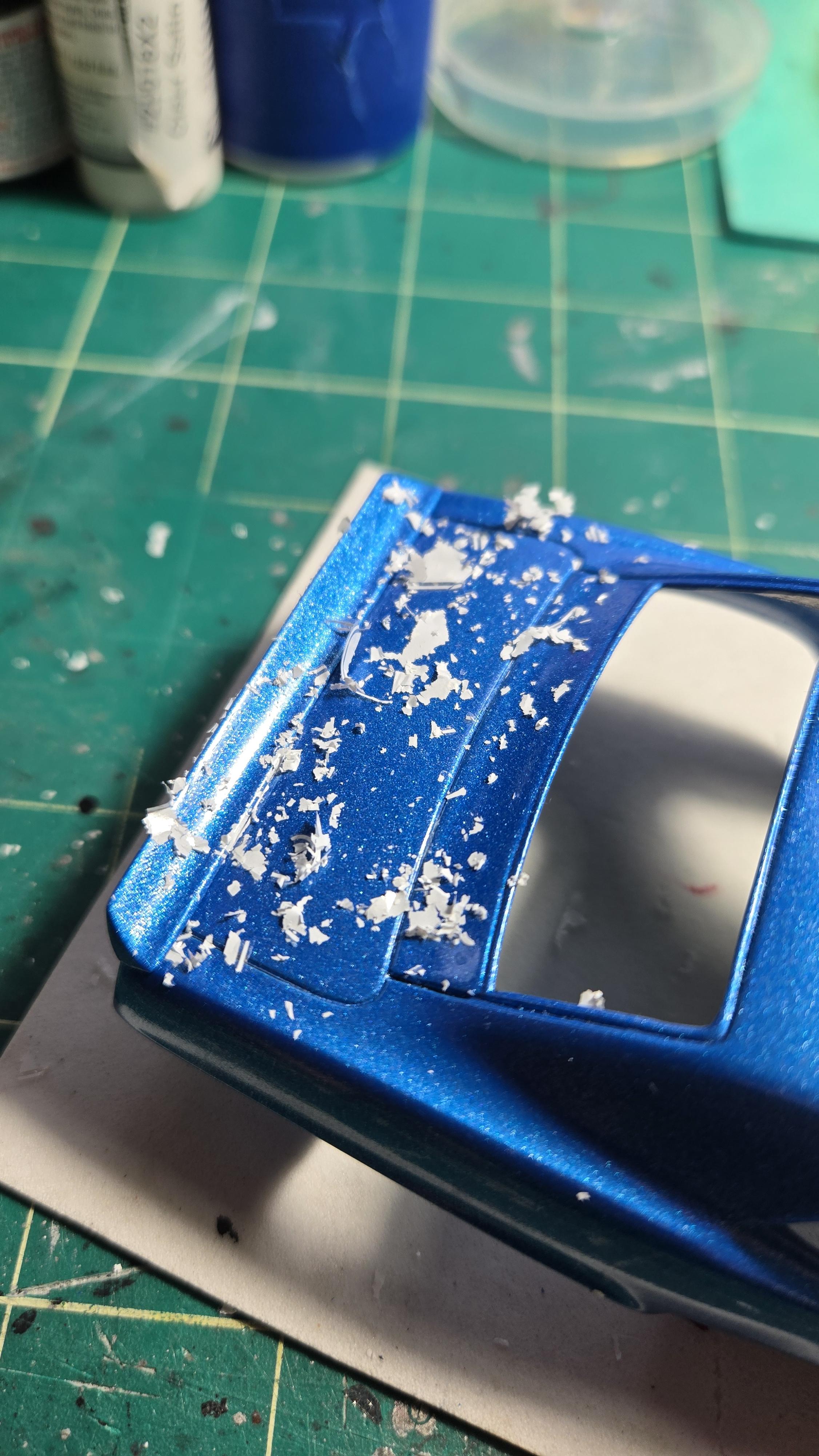

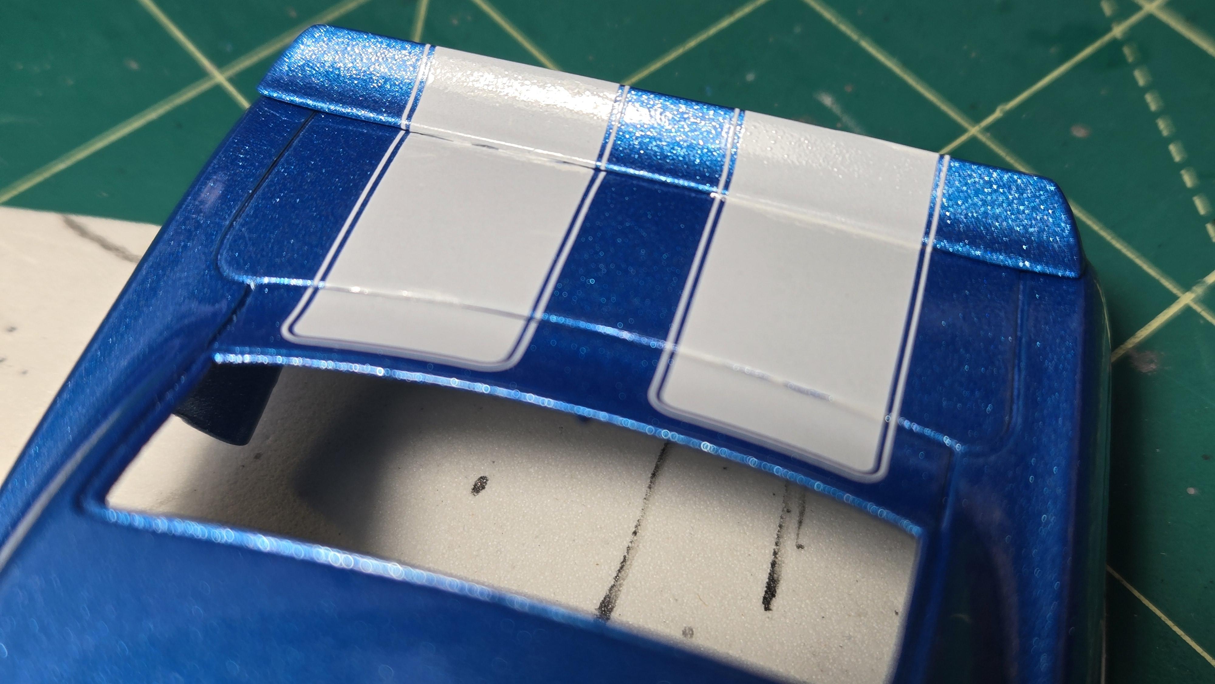

CA Whitecloud Posted November 13 Author Posted November 13 Decal Advice For starters, I'm miffed that the sheet has zero side or hood badges. No Z/28 emblems. The hood stripes are in one piece, except for the vent portion which, evidently, will need to be painted/filled in. I tried to perceiver, but you'll see where this goes. Tried cutting after application which kinda worked (left). I tried to measure and cut before applying, but I think my measurements were off (right). I tried to fill in the empty space. I could live with how the vents came out, but that notch in the hood gave me trouble. Besides, how hard is it to match WHITE? Again, the creases caused me grief. I could not get a clean/straight cut, yes with a new blade. It just got worse. Notice the patch job in front. I can't leave it like that, so.. Round 2 (Any advice?)
johnyrotten Posted November 13 Posted November 13 There's decal solutions to help with issues. Micromark has them, and Tamiya. Maybe that's the ticket.
NOBLNG Posted November 13 Posted November 13 You could tape the decals in place where they need to be, then mark the seams that need to be cut, and cut them into chunks before applying them? The paint won’t show through the black decals as bad as the white ones, so touch-ups if necessary won’t be as obvious. 1
