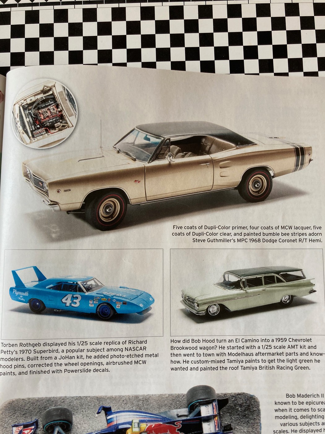

         With lacquers, multiple coat systems are not only possible, but in many cases desirable.
         Using lacquer products, I routinely use as many as 15 coats of primer, color and clear producing no detail hide whatsoever.
         I won't go into the rationale for using that many coats at this time, but there are legitimate reasons for it.
         Using the same scenario above, should an additional coat, or 2, or 3, be required when using a lacquer, no problem.
         It's just a matter of adding more paint without the inherent problems you're probably going to encounter when adding additional coats of enamel.

On a side note, I too have more than my fair share of trophies, plaques, ribbons, and magazine appearances with my projects, but I never attribute that success to a particular product that was used during the build.
The accolades should always be given to the craftsman in those circumstances, and not the materials that were used.

It took 50+ years of experience.
And again, you're bringing your emotions back into it.
I'm not "cutting Rustoleum down".
I'm merely citing facts.
If you're interested, the reasoning for the number of coats are as follows.
With the primer, I'm using an initial coat or two to achieve full coverage and using it to check for body work imperfections.
The remaining 2 or 3 coats are used as guide coats to insure that body work is to my standards, and to make sure that there is an ample barrier against the hot solvents in the lacquer paint to be used.
With the color coats, the airbrush lacquers that I use are somewhat transparent in nature, so more coats means more color uniformity, color depth and uniform coverage.
The number of clear coats not only helps to provide depth of color, (ie, helping the color to "pop") but as I utilize a cutting and polishing regimen on all of my models, the more clear that you can apply without obscuring detail, the less likely you are to burn through the clear down to the color coats, or beyond, during the process.
I've been using this process for the past 10 or 15 years and in that time, I might have encountered one instance where a paint job had to be stripped due to a paint issue, so it's been working very well for me.
If I were using Rustoleum, I would fully expect to have to cut that number way down to 4 or less coats, and it's my opinion that my paint work would suffer for it.
Believe me, I've used numerous different types of paint, including Rustoleum and other enamels over the past 5 decades, and I've never had the type of paint success with my projects as I have in recent years.
Seams to me as if I'm on the right track.
