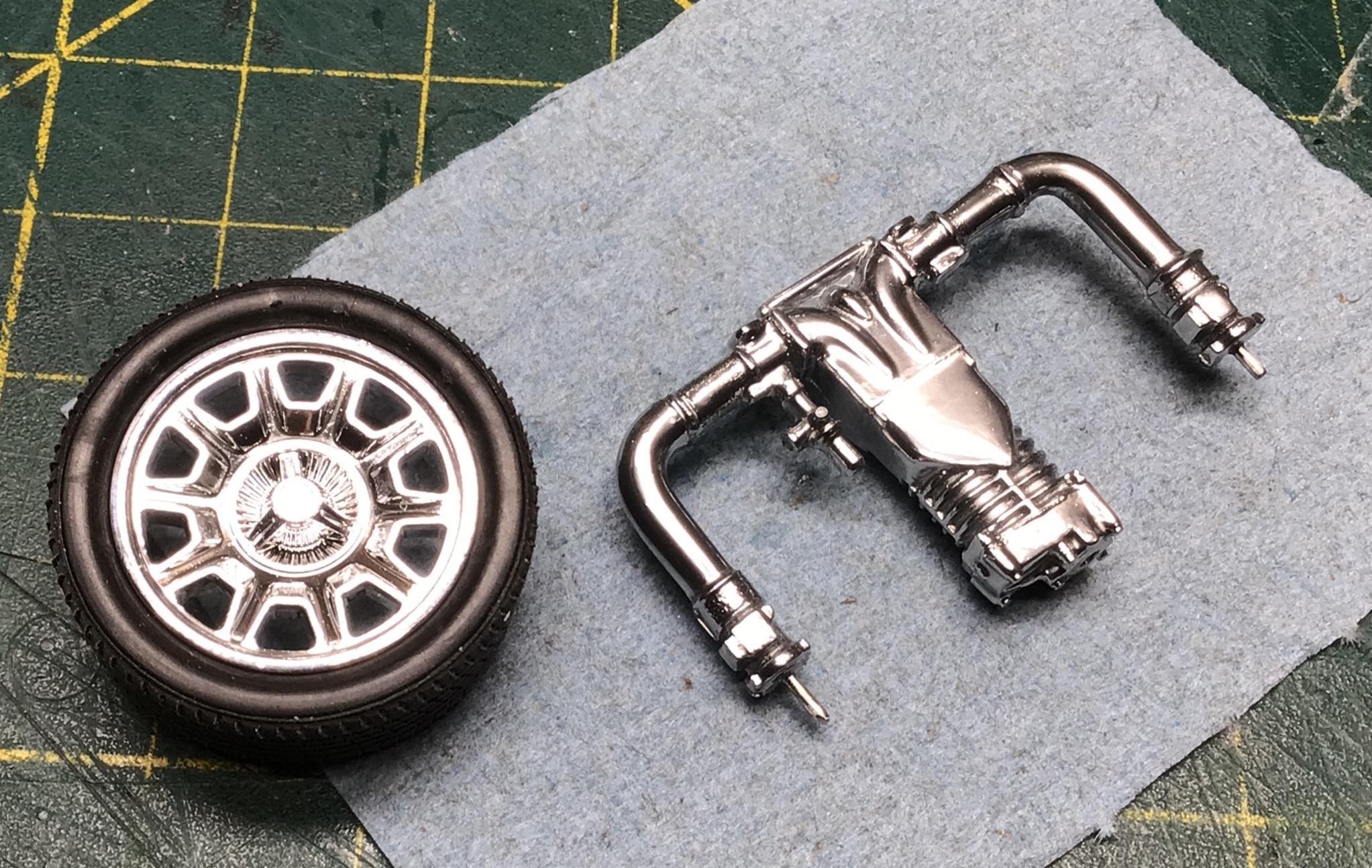

NOBLNG Posted April 10 Posted April 10 (edited) This blower has one coat of Revell Chrom straight from the  can. Not sure how long I let it dry…but then it was dipped in pledge twice. The wheel has the kit chrome for comparison.  BMF on the left and Chrom with a pledge dip on the right. More info here: https://www.modelcarsmag.com/forums/topic/181804-revell-spray-chrome-test/page/7/ Edited April 10 by NOBLNG 2 1
