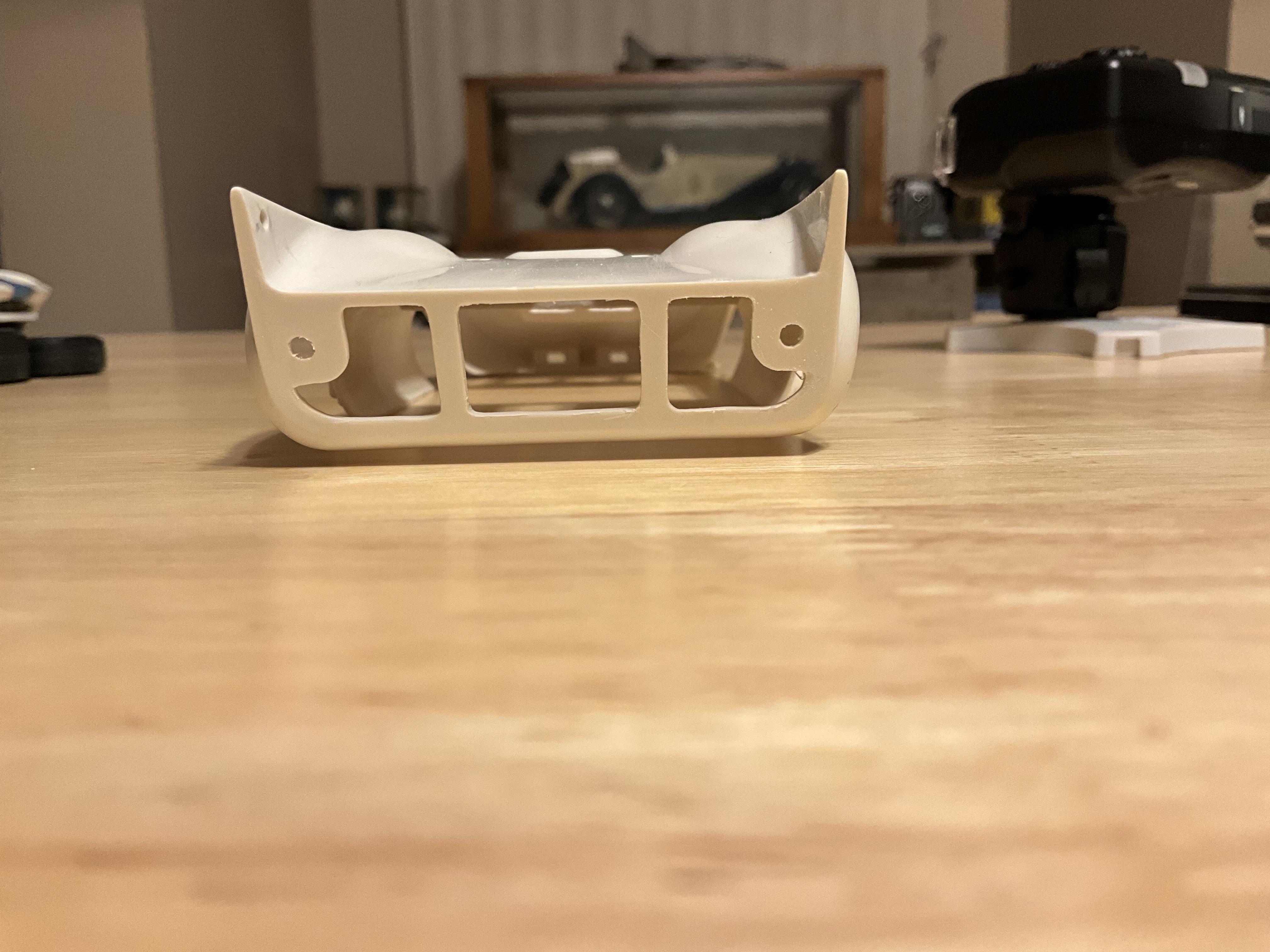

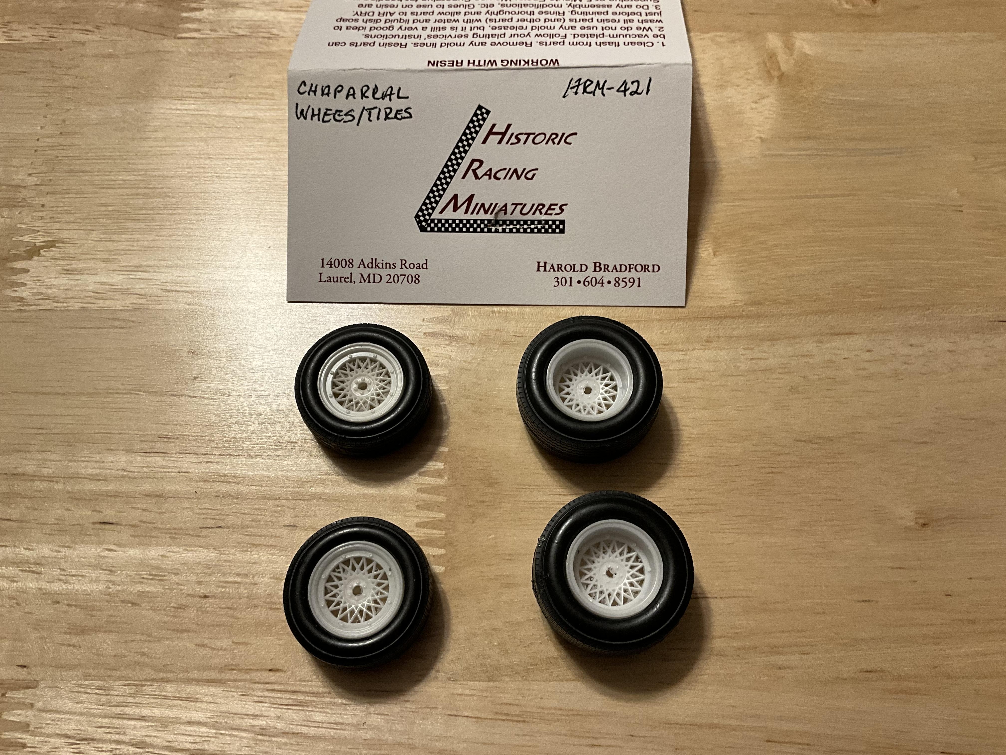

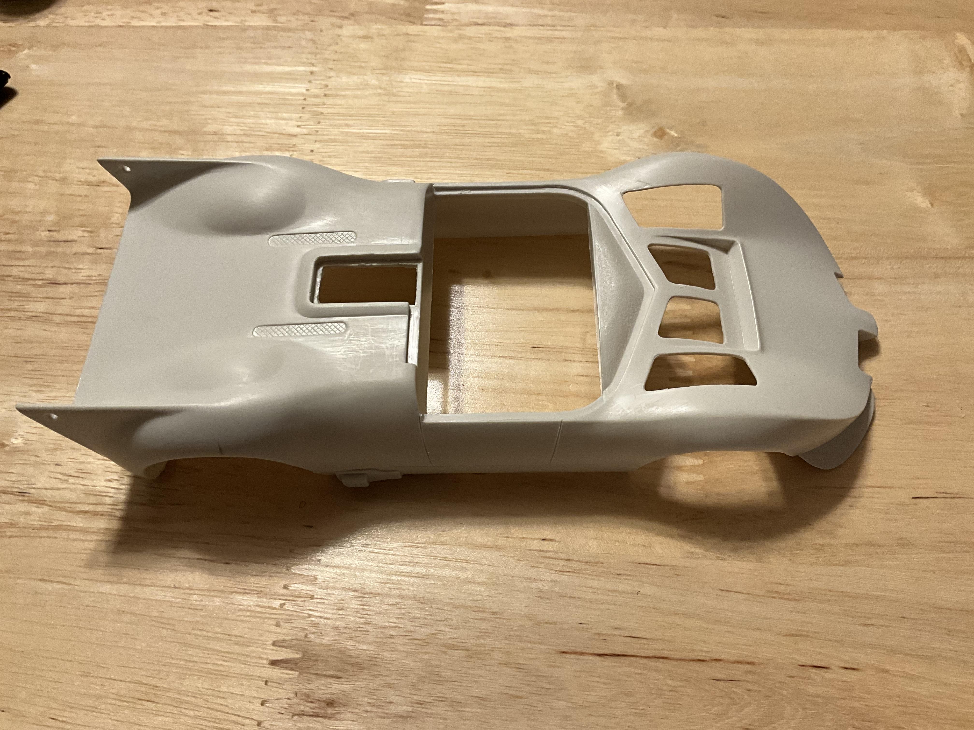

Mark W Posted April 11 Posted April 11 After sending the Wintersteen Grand Sport under glass, I decided to undertake a less stressful project . This will be a curbside Chaparral 2C. The first mod was to use a set of HRM wheel/tire set. This has to be the most beautiful Chaparral wheels and tires I’ve seen! So far I’ve opened the screen areas as I feel there is no I know way to make them realistic. There is a lot of talk about the color of the Chaparrals. I plan now to go with Ermine white, a 60’s Chevrolet color. Feel free to add to this topic as far as color or any mod I can add to make it a better model. I would also like a source for the “66” decals with a clear background. The kit ones aren’t bad as they are an off white. 3
dwc43 Posted April 11 Posted April 11 I have one of those that I started and boxed back up. I need to find it and finish it. Not a bad idea opening up the rear screens and putting some wire in there would look great. I cut an engine in half and put that in my car. I should have cut the floor pan out and put the hole engine in there. Maybe I will since my skills have improved a lot since I started that kit. 1

Pierre Rivard Posted April 11 Posted April 11 Another great racing car build to follow. How fortunate that you have the HRM wheels. Much better than modifying the kit wheels like I had to do for a 2D build. 1
Mark W Posted April 11 Author Posted April 11 On 4/11/2025 at 12:26 PM, Pierre Rivard said: Another great racing car build to follow. How fortunate that you have the HRM wheels. Much better than modifying the kit wheels like I had to do for a 2D build. Expand They are beautiful wheels. I do have another set for a future 2D build.

Mark W Posted April 11 Author Posted April 11 On 4/11/2025 at 12:14 PM, dwc43 said: I have one of those that I started and boxed back up. I need to find it and finish it. Not a bad idea opening up the rear screens and putting some wire in there would look great. I cut an engine in half and put that in my car. I should have cut the floor pan out and put the hole engine in there. Maybe I will since my skills have improved a lot since I started that kit. Expand I plan on much the same, some sort of engine top half with the Webers. Maybe a full engine since this will be the early 2C with the exhaust stacks exiting on top. Whichever is easier. 1

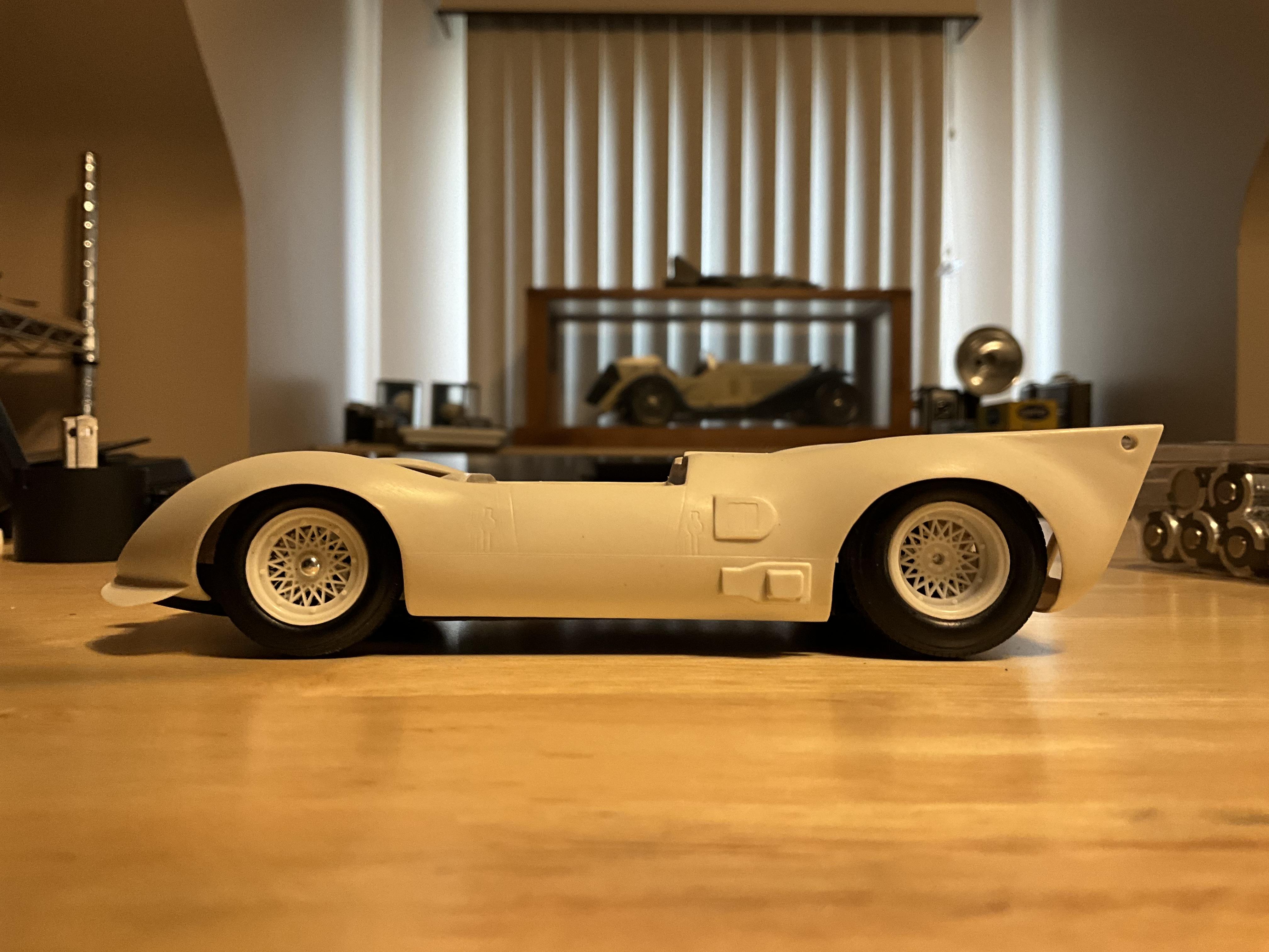

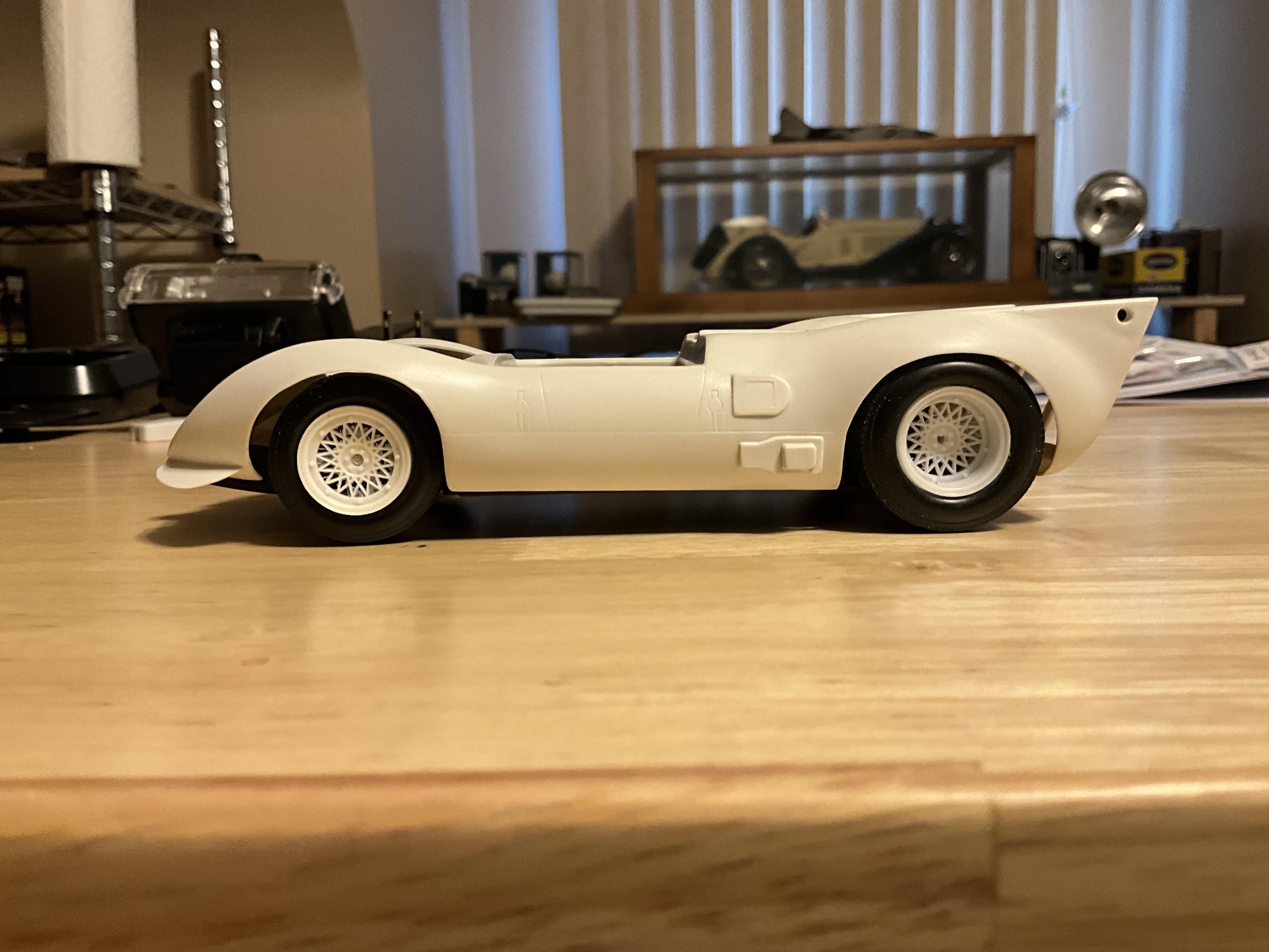

Mark W Posted April 14 Author Posted April 14 (edited) I did a mockup and found that it was setting high in the front (or low in the rear). Decided to lower the front to level it off. What do you think. The tires tucked up in the wheel well a bit look ok? Edited April 14 by Mark W Added photo 3

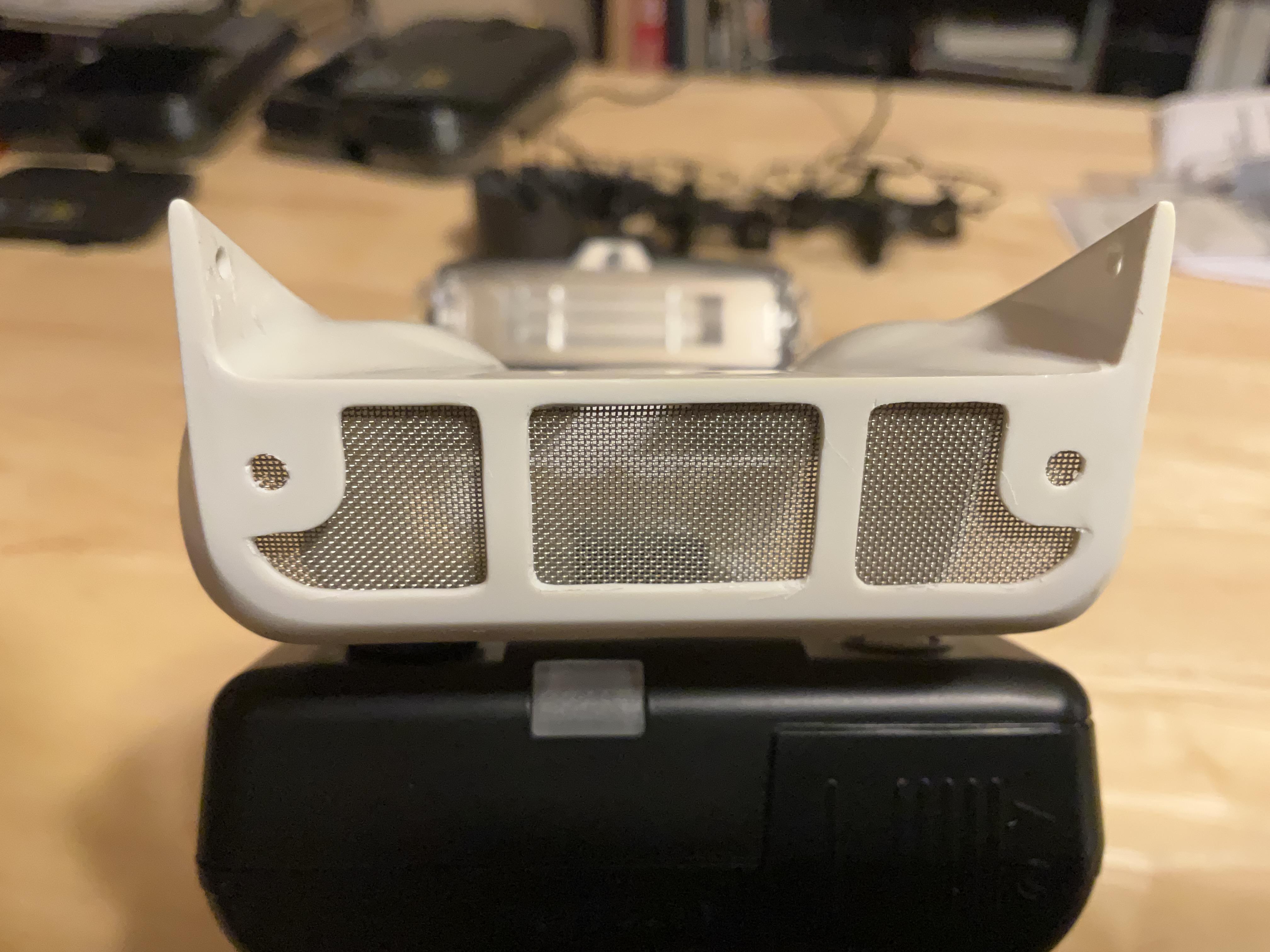

Justin Porter Posted April 14 Posted April 14 On 4/11/2025 at 12:47 AM, Mark W said: After sending the Wintersteen Grand Sport under glass, I decided to undertake a less stressful project . This will be a curbside Chaparral 2C. The first mod was to use a set of HRM wheel/tire set. This has to be the most beautiful Chaparral wheels and tires I’ve seen! So far I’ve opened the screen areas as I feel there is no I know way to make them realistic. There is a lot of talk about the color of the Chaparrals. I plan now to go with Ermine white, a 60’s Chevrolet color. Feel free to add to this topic as far as color or any mod I can add to make it a better model. I would also like a source for the “66” decals with a clear background. The kit ones aren’t bad as they are an off white. Expand Looking like a good start. Hasegawa sells a nice variety of "bulk" photoetch screens in different patterns. You might find something that suits the mesh you're looking for. 2
Pierre Rivard Posted April 14 Posted April 14 I think it looks very good. Perhaps raise the rear just a tiny bit (1 mm). Love the HRM wheels. 1
Mark W Posted April 14 Author Posted April 14 On 4/14/2025 at 8:02 PM, Pierre Rivard said: I think it looks very good. Perhaps raise the rear just a tiny bit (1 mm). Love the HRM wheels. Expand I was leaning that way, just wanted other’s opinion.
Mark W Posted April 14 Author Posted April 14 On 4/14/2025 at 6:40 PM, Justin Porter said: Looking like a good start. Hasegawa sells a nice variety of "bulk" photoetch screens in different patterns. You might find something that suits the mesh you're looking for. Expand I’ll check it out Justin, it has to be a pretty fine mesh. 1
Mark W Posted April 16 Author Posted April 16 A few spacer, a little filing and the ride height was adjusted. Now on to the screens and cockpit! 2

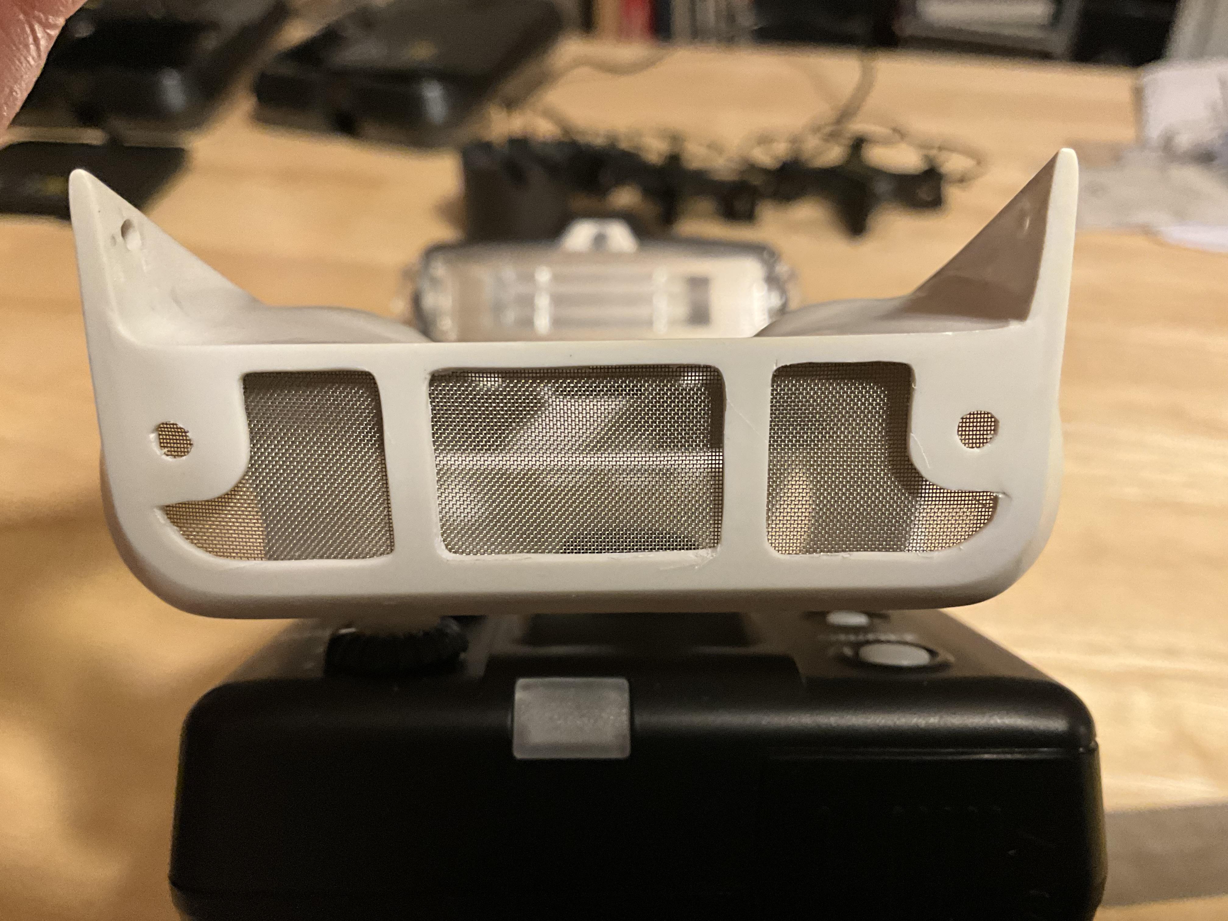

Belugawrx Posted April 17 Posted April 17 I think the smaller weave one..where did you source that Mark..? I am in need of some that size. 2
Ace-Garageguy Posted April 17 Posted April 17 Looking really good. I was very curious about the accuracy of the Arii kit, and now I know. Thanks a bunch for posting this build here. 1
dwc43 Posted April 17 Posted April 17 Smaller one for sure. Don't want to see the empty hole behind it, unless you put an engine in the back of it too. 1
Pierre Rivard Posted April 17 Posted April 17 I like them both. My guess is you have a 30 mesh and 40 mesh there. If I had to choose I would go with the 40. 1

Mark W Posted April 18 Author Posted April 18 On 4/17/2025 at 1:01 AM, Belugawrx said: I think the smaller weave one..where did you source that Mark..? I am in need of some that size. Expand Bruce, I got various screen sizes from an industrial hydraulic filter. I should have some extra, how much do you need. 1

Mark W Posted April 18 Author Posted April 18 On 4/17/2025 at 12:36 PM, dwc43 said: Smaller one for sure. Don't want to see the empty hole behind it, unless you put an engine in the back of it too. Expand On 4/17/2025 at 8:56 PM, Pierre Rivard said: I like them both. My guess is you have a 30 mesh and 40 mesh there. If I had to choose I would go with the 40. Expand On 4/17/2025 at 1:01 AM, Belugawrx said: I think the smaller weave one..where did you source that Mark..? I am in need of some that size. Expand Great, the fine it shall be! 1
