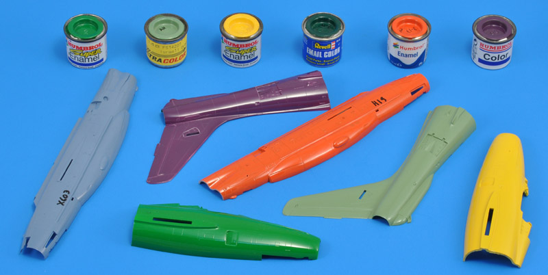

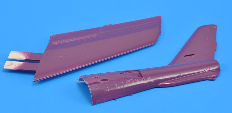

robdebie Posted May 14 Posted May 14 Watch this video, you'll be impressed! https://www.youtube.com/watch?v=lCKZ_fo4eW0 I bought a Paasche H after seeing this, and it gives me identical results. Here are some tests with all enamel brands that I had in stock. No polishing, no clear coat, one paint session. Rob
Jon Haigwood Posted May 15 Author Posted May 15 On 5/14/2025 at 10:41 PM, robdebie said: Watch this video, you'll be impressed! https://www.youtube.com/watch?v=lCKZ_fo4eW0 I bought a Paasche H after seeing this, and it gives me identical results. Here are some tests with all enamel brands that I had in stock. No polishing, no clear coat, one paint session. Rob Expand Very good info there. I have 2 Iwatas , NEO & Eclipse, 2 Badger Patriots and a Passche H with a #3 tip. I normal use MCW lacquer or Createx Candy20 on 1/2th cars. My thoughts are with the larger paint surfaces do I need to use something larger ?
