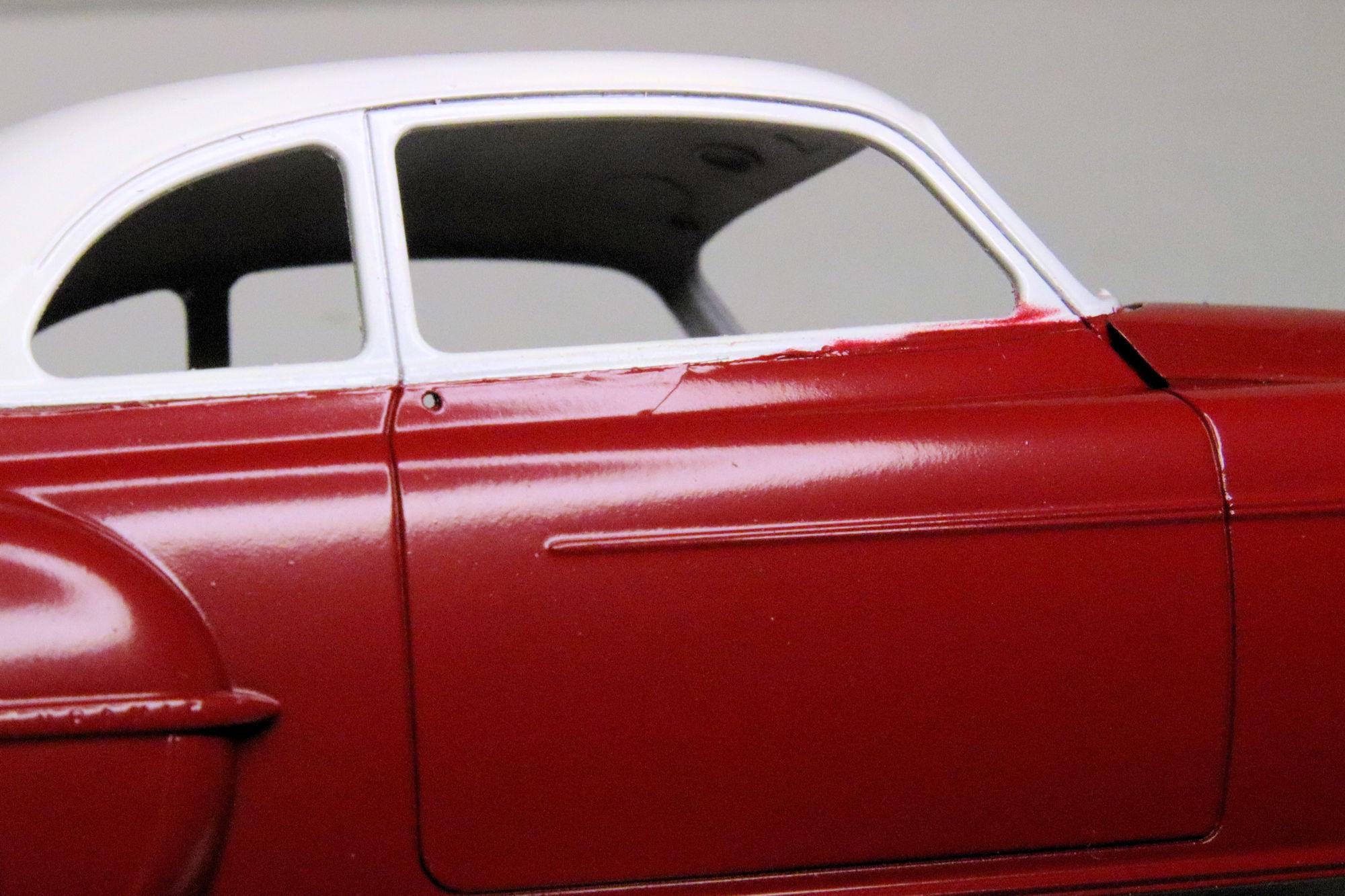

It's time to paint the main body color. This time I decided to try using BMF as a masking agent.
Making up the balance of the coverage with masking tape.
Smoothed down, cleaned up, re-primed and ready for red!
After a little drying time I removed the masking and I'm rather pleased with the results. The line left by the foil is cleaner than what would have been left by most masking tapes and paint piling is minimal.
There will be a little cleanup & touchup to do but there almost always is. I'll probably use foil masking again but I will have to develop and refine some my techniques for working with it.

Always amazing how paint will creep under almost any type of tape. Have sometimes given a light coat of Gloss Clear around the edges after masking and before using any other color coat. Usually, but not always, this sort of seals the edge along the tape and any bleed thru should be clear and hopefully undetectable. Before removing the tape just lightly run your #11 along the edge to "break" any bond between the clear and the tape.
  • Like 1
Thank you David. I did discover that sealing effect you mentioned.
Part way through the unmasking I noticed that the paint was starting to tear. Of course, I stopped and grabbed my trusty hobby knife and made a cut all the rest of the way around the trim line. This is the event I was referring to when I said I ..."have to develop and refine some my techniques for working with it." in the earlier post.
:D
Thanks again for your comment.
David G.
