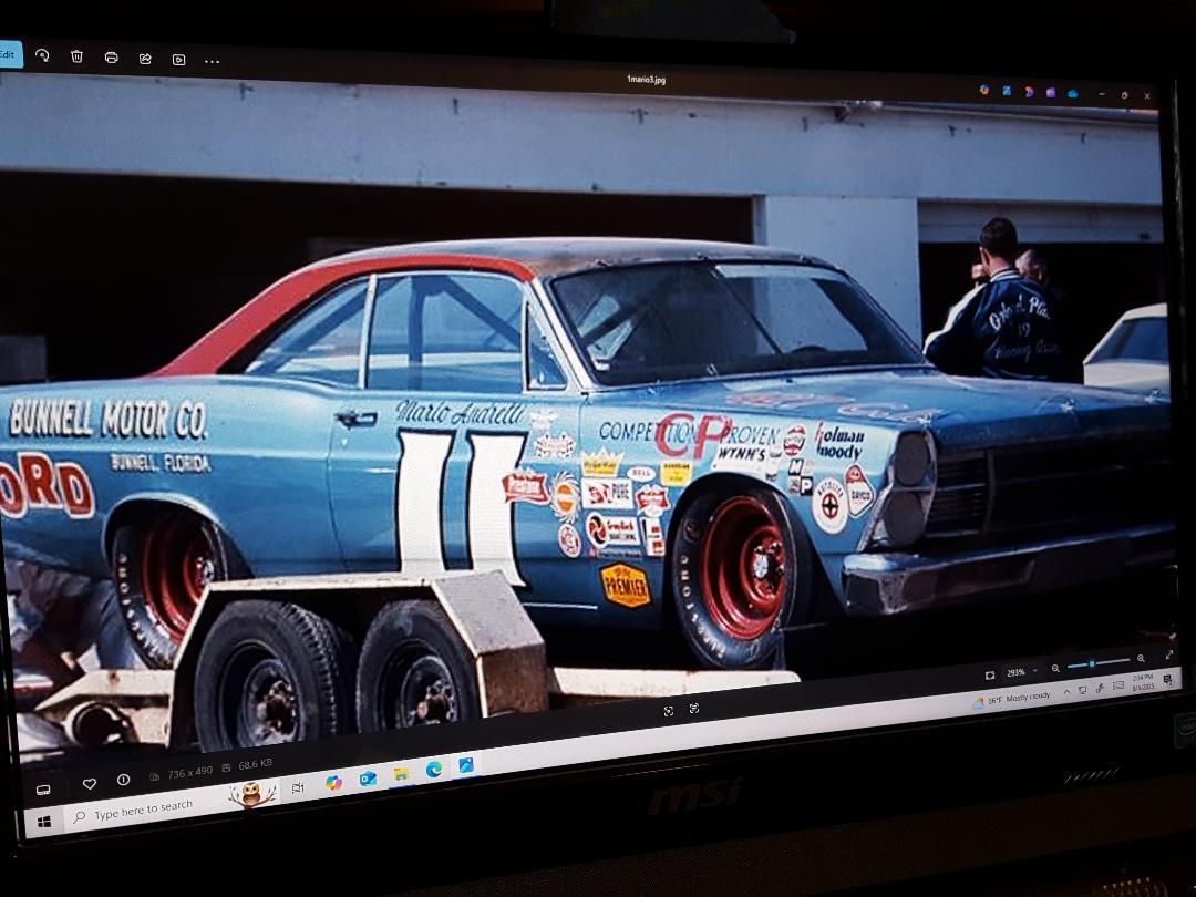

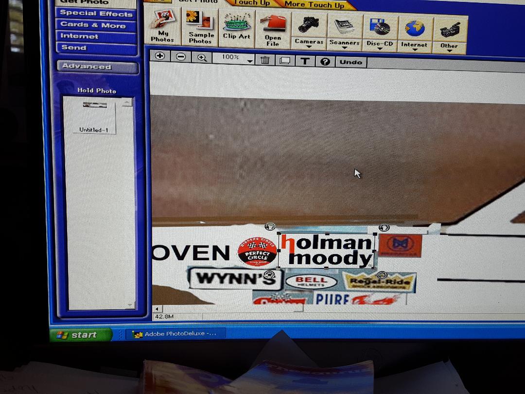

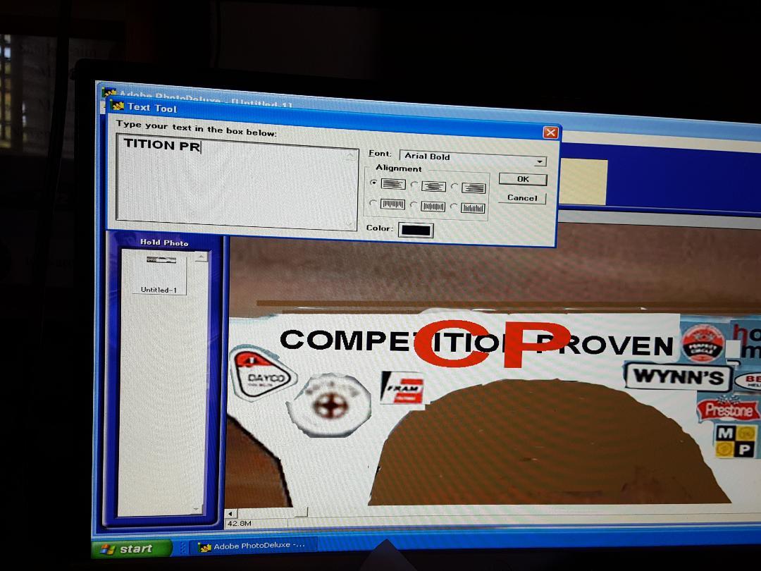

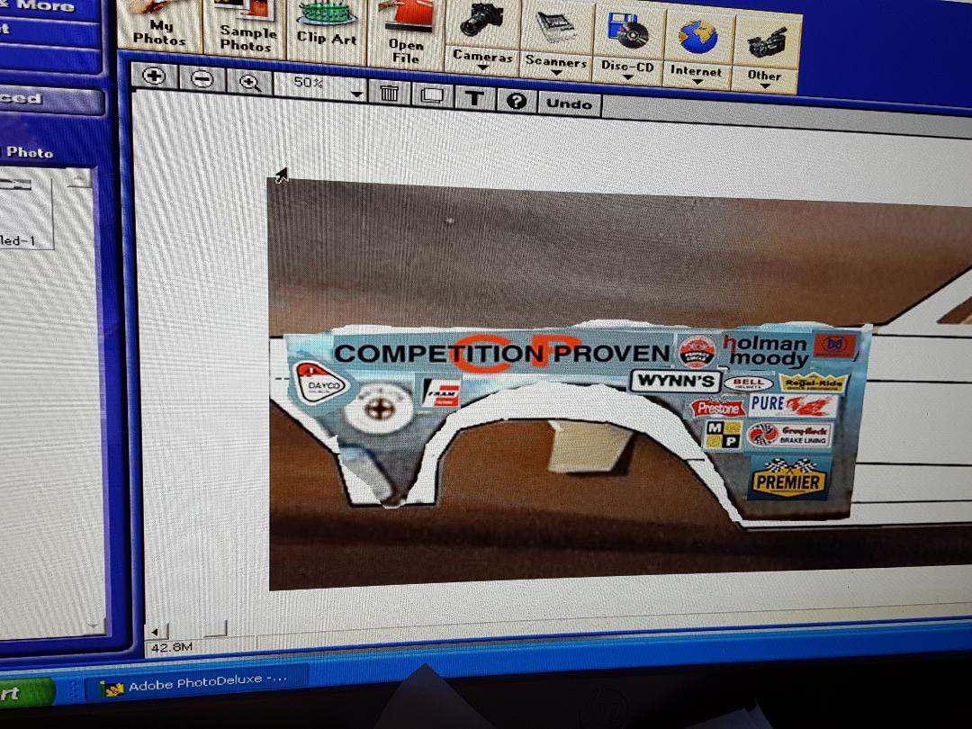

MarkJ Posted Wednesday at 03:20 PM Posted Wednesday at 03:20 PM Finally getting around to doing this one. I will again glue the hood shut to streamline everything. Nascar engines back then were not that uncommon to look at so a lot of time can be saved leaving the hood shut. I will take time in the wip doing a basic look at how I make my own decals. As you will see, it's really not that hard to do or expensive except for the decal paper. below is the kit I'm using. 2

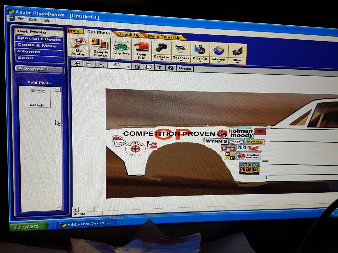

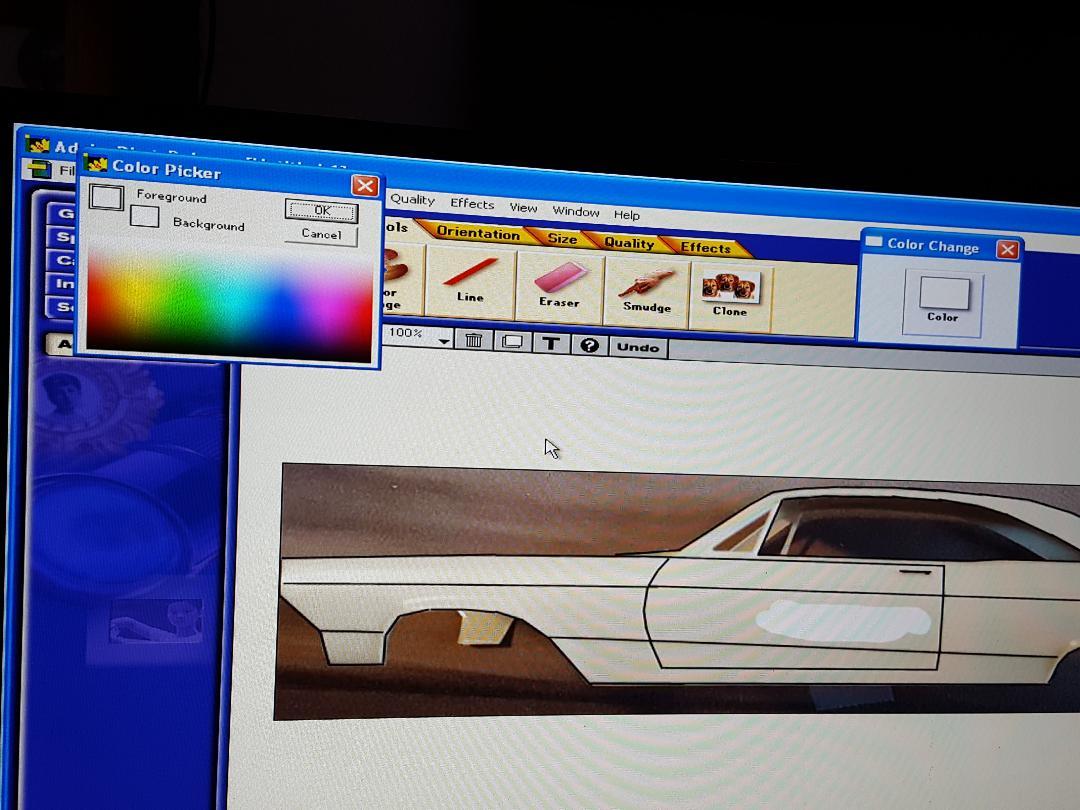

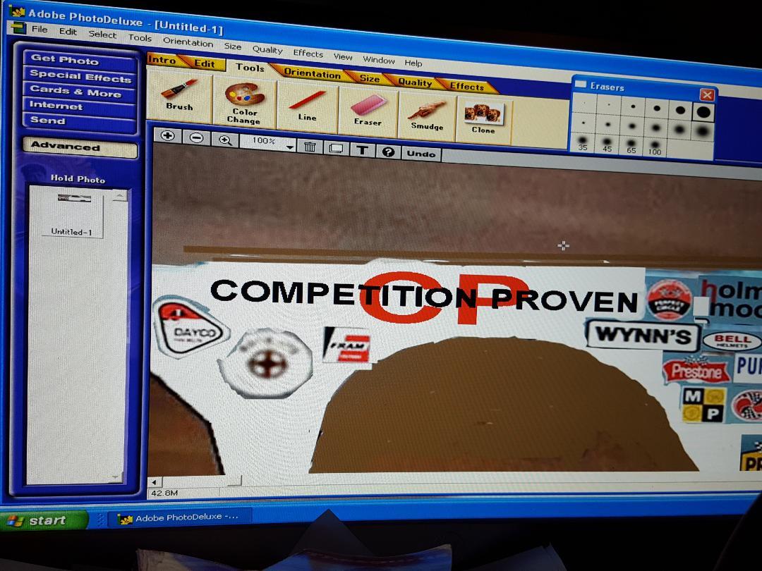

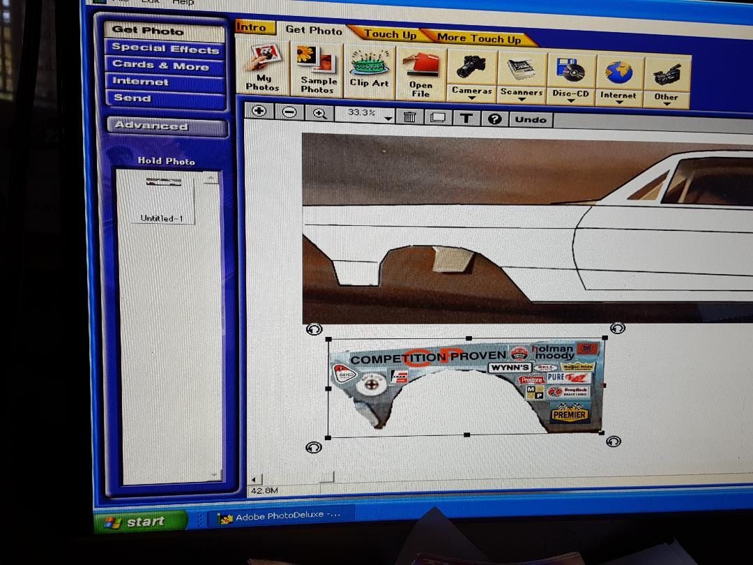

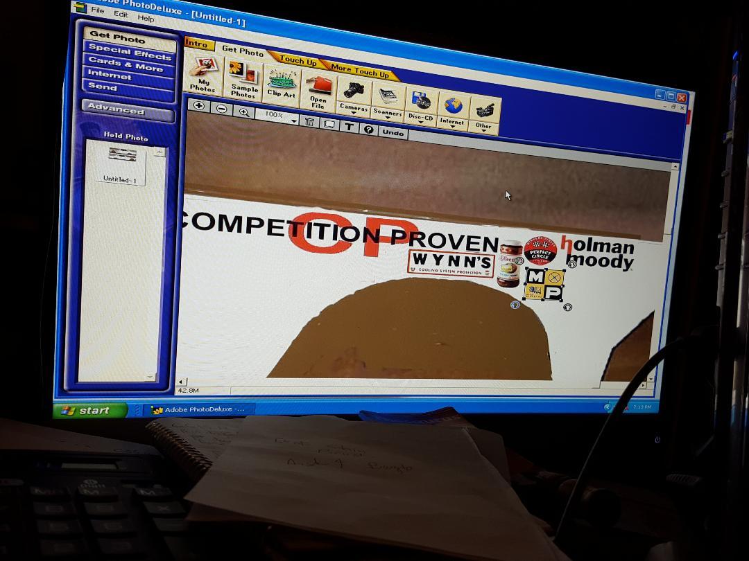

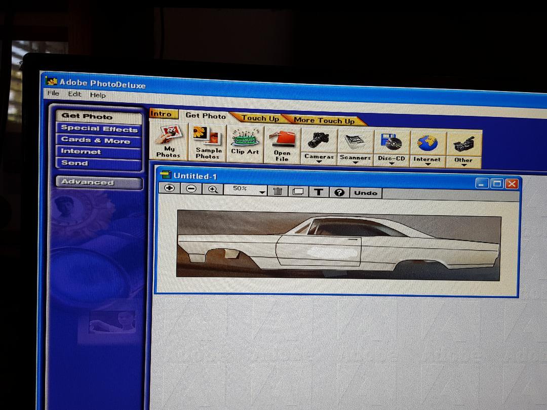

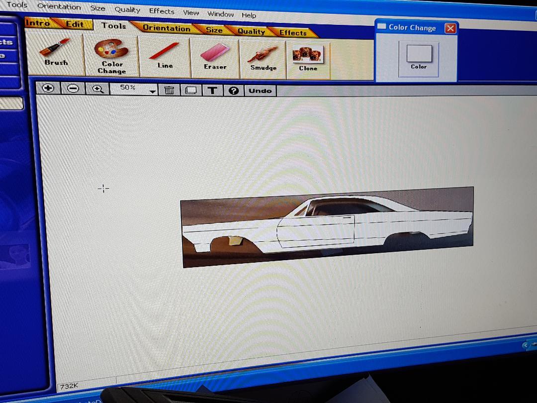

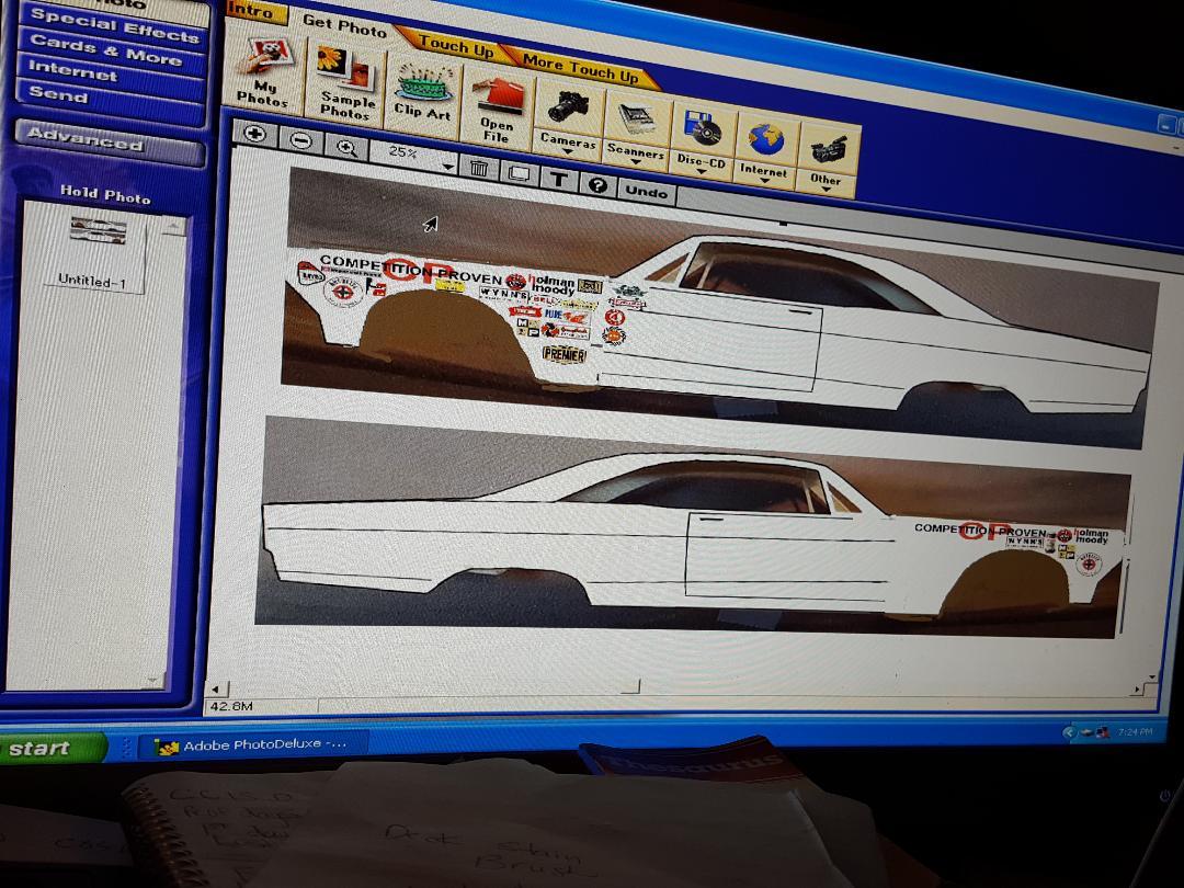

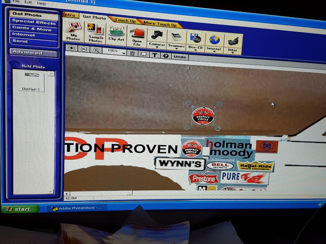

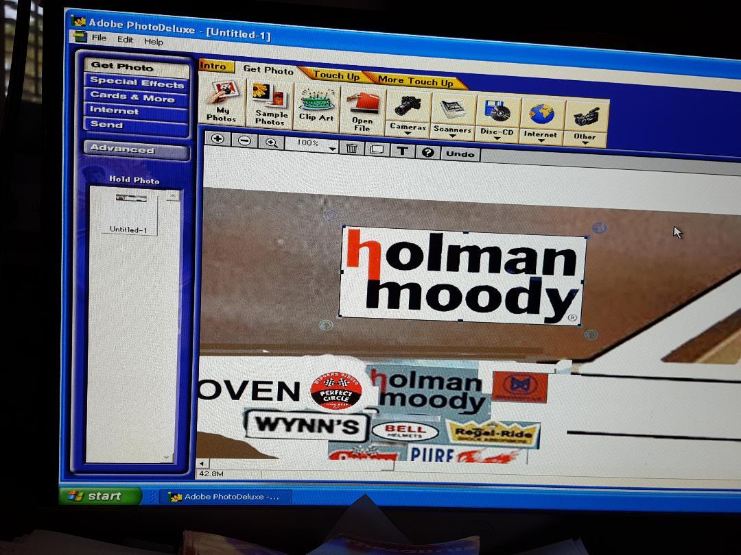

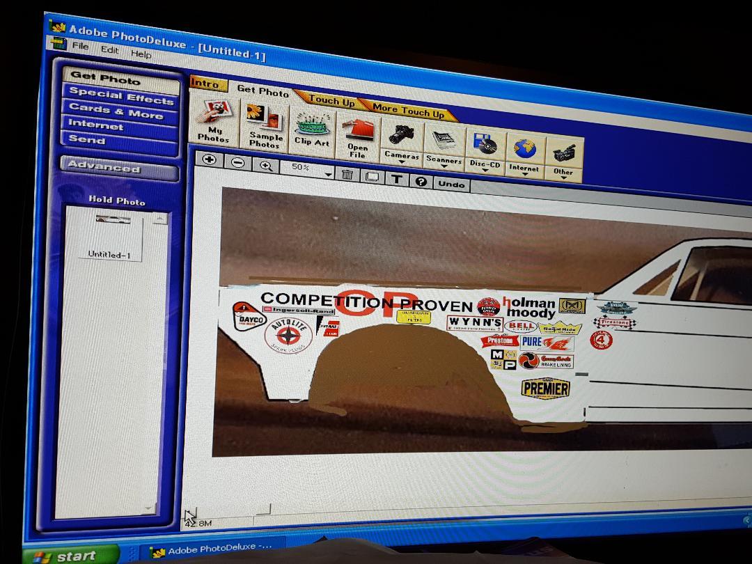

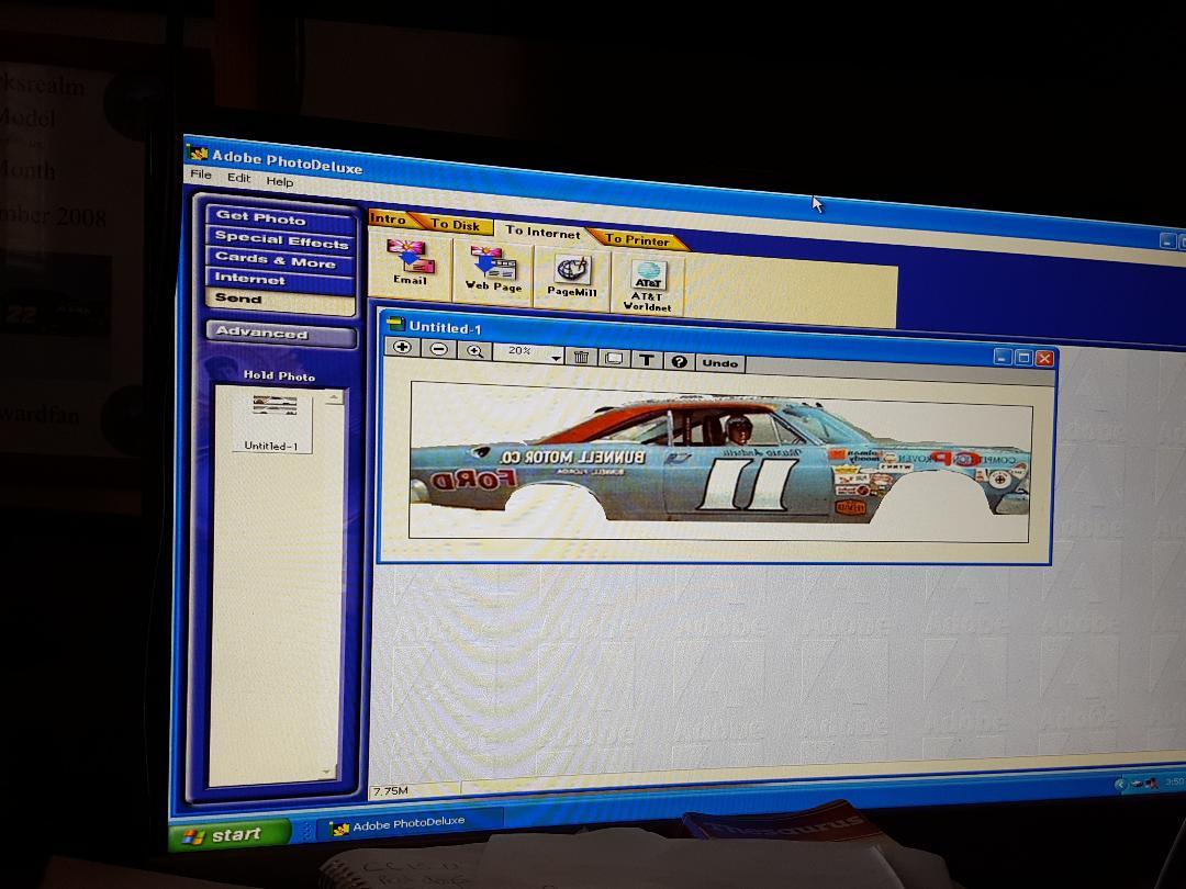

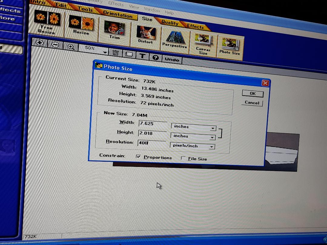

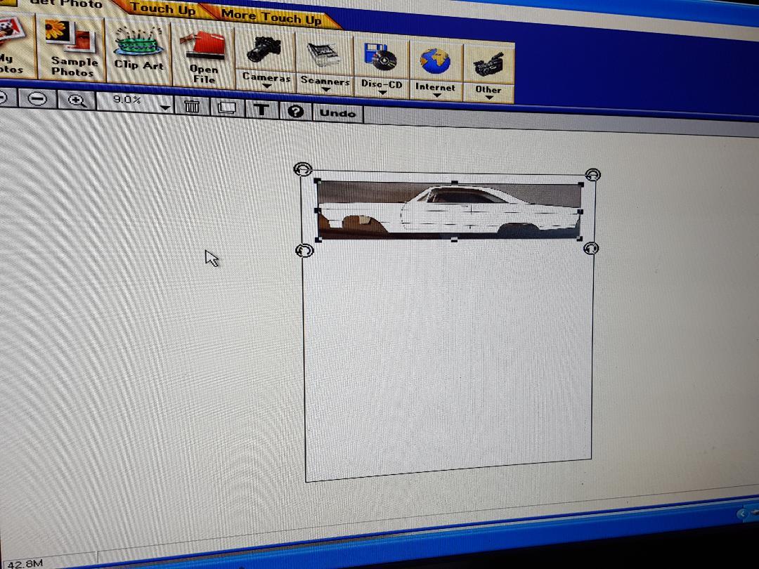

MarkJ Posted Thursday at 10:53 PM Author Posted Thursday at 10:53 PM First thing to do is take profile shots of the model body, left, right and top. These photos will be made into 7.625-inch-long pictures and place on an 8.5x11 inch file that is 400 pixels per inch in size. The decals are made on this file and will fit the model exactly as you see them as we go on.

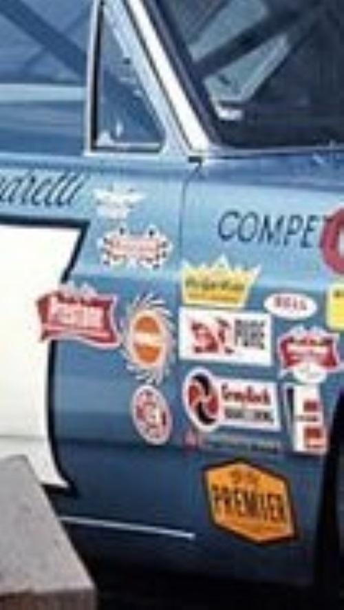

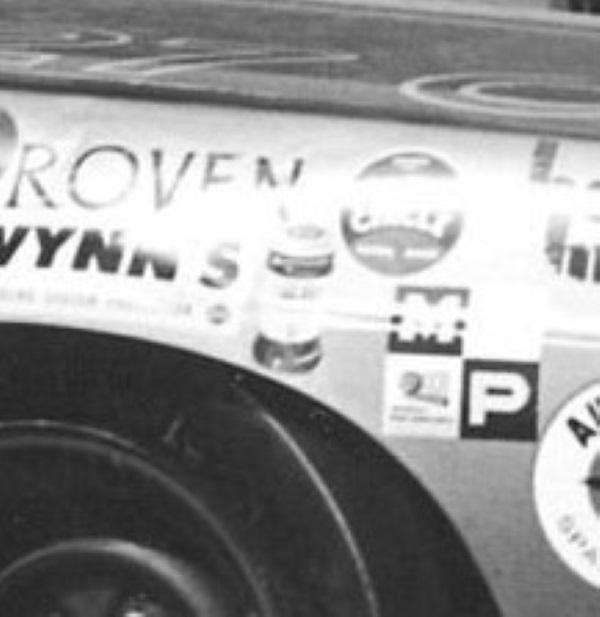

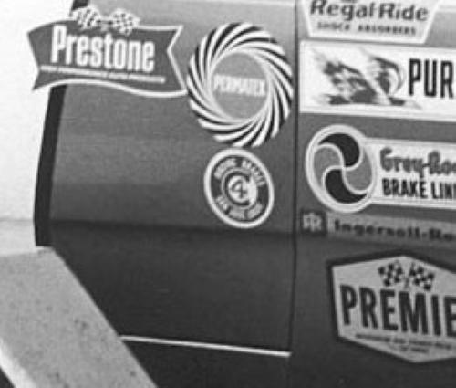

MarkJ Posted 1 hour ago Author Posted 1 hour ago Are any of you guys familiar with a decal from 1967 that has c4 in the middle of it. Its red and black and the 4 is inside the c right in the middle of a round decal. Any help would be greatly appreciated.
Shark Posted 5 minutes ago Posted 5 minutes ago Mark, do you have a picture of it. I just looked at the Slixx Andretti sheet and didn't see nothing like that. Also checked some 60's contingency sheets and didn't see anything.
