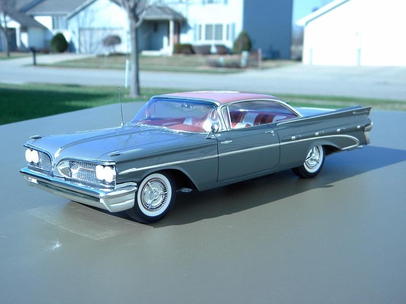

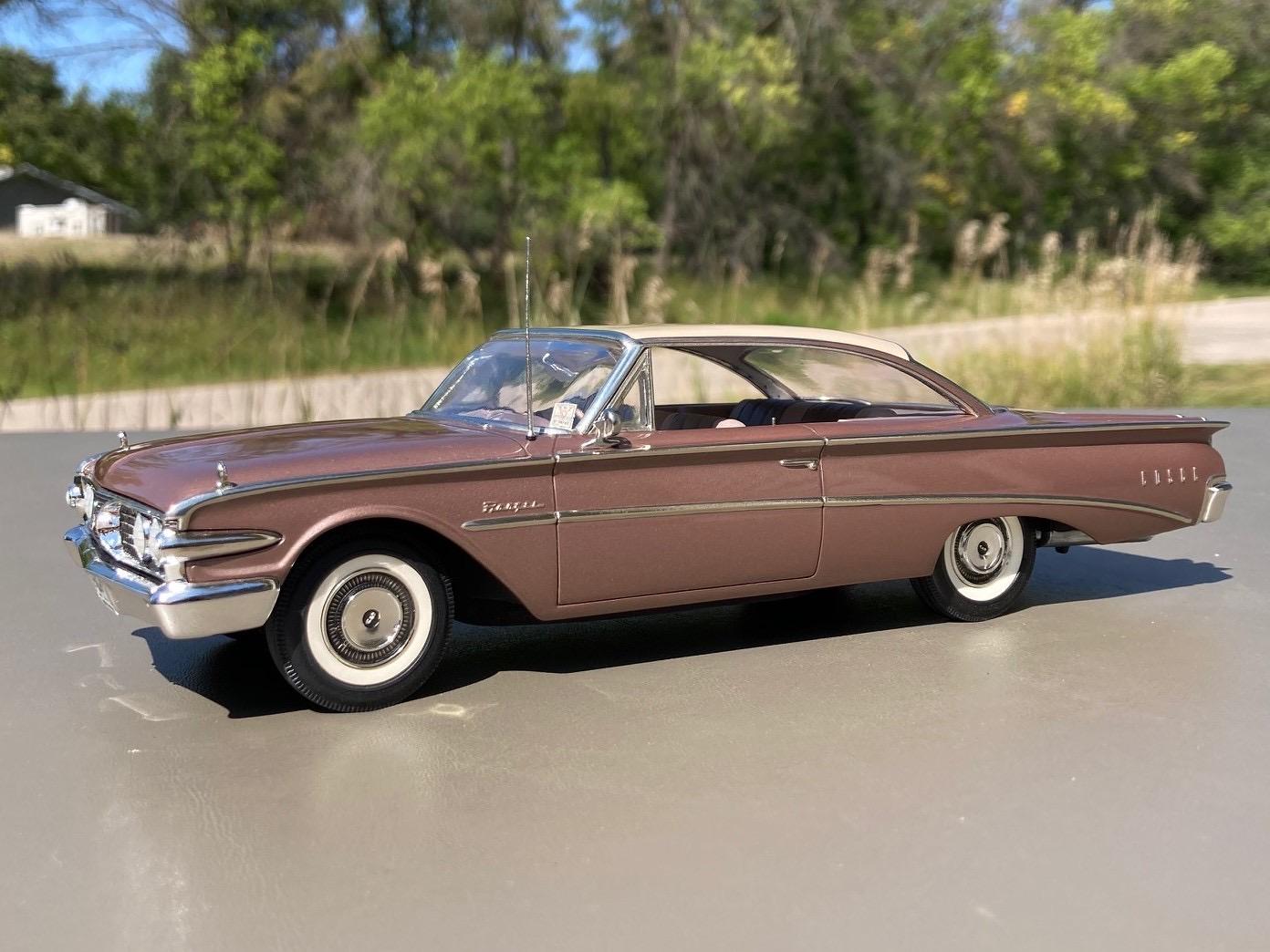

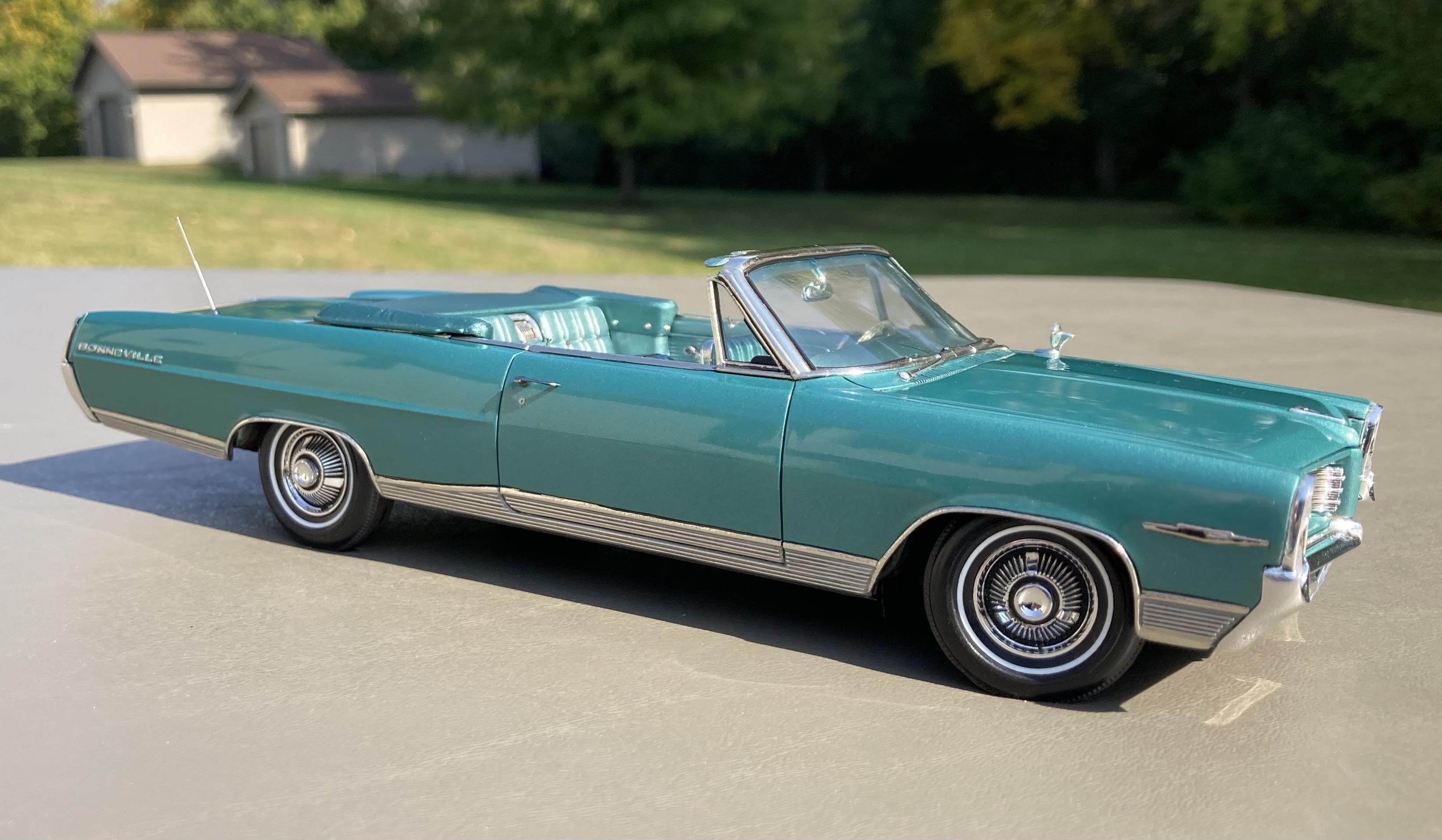

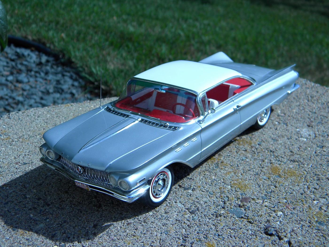

7 hours ago, StevenGuthmiller said:
BMF.
678118BD-F762-4FB4-A6A3-D57D4AF0BC01.jpeg.01a2d661d2af7095ef8c33c28dac0433.jpeg52F386C9-2EBA-4EF6-B9AC-E750EAE034DB.jpeg.33b8c2a2f3beed4efcb985c35fe813af.jpegDC6146CE-B0A9-4999-A78C-A3AEA1593F2D.jpeg.f89bd4a801abb6cc5364dc893010678a.jpegIMG_3414.jpeg.7f03e56aa359550b8e098d36ac783e05.jpeg
Steve
Think I might need to do a few tutorials on this one, looks pretty tricky
Don
Don
Make sure you get the “New Improved Chrome”. None of the other versions (Chrome, Super Brite Chrome, etc) are as good and some are not useable at all.

All I can add to this is to be sure the area you are foiling is as smooth as you can get it. Any roughness in the surface will show up and ruin the chrome effect. 2-3000 grit and even polish the area. Just as you would the paint job.
good luck
  • Like 1
good luck
Agreed.
If you polish your paint jobs anyway, you’ll just polish the trim by association.
A smooth glossy base is the order of the day when it comes to BMF.
Take your time, do the trim in sections, (and in several pieces if necessary) start in the middle of a particular molding and work your way towards the ends to prevent wrinkles.
If you’re doing a body length molding, do each section separately, (ie, front fender, door, rear quarter)
Do windshield frames in several pieces with the realization that there are molding seams on the real vehicle, and place your overlaps as such.
Do difficult areas such as vent windows in several pieces.
On a triangular vent window, I usually do the bottom, A pillar, and vent post separately.
To take that even farther, I’ll often do the front vent window section separate from the drip molding and windshield A pillar molding. Any time that you have a natural separation between moldings is a good place to break to prevent tears, wrinkles, etc.
Once applied, burnish the edges well and then polish vigorously for a chrome like shine.
Just like anything else that’s worth learning, it takes a little bit of time to get the hang of, and plenty of patience, but it’s absolutely worth the effort.
As I often tell people that don’t want to take the time to learn, or put forth the effort, go to a model car show sometime and you’ll quickly learn that in the vast number of cases, the winners are using foil for their trim.
Likewise, with few exceptions, the best builders on the planet are all using foil as well.
All of that said, don’t let people tell you that foiling is somehow exceedingly difficult, it’s not really all that tough.
You’ll learn as you go.
Several decades ago when I first started using it, it probably took me no more than a few builds before I began to understand the properties of the material, and started to get good at it.
I won’t say that it’s my favorite thing to do, but it is without a doubt one of the most transformational operations that you can do on a model car.
Steve
