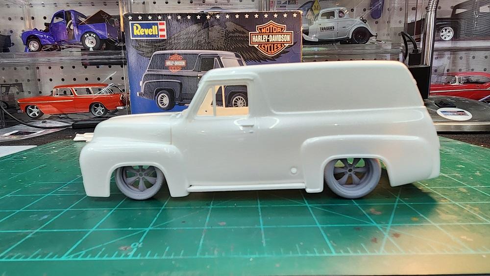

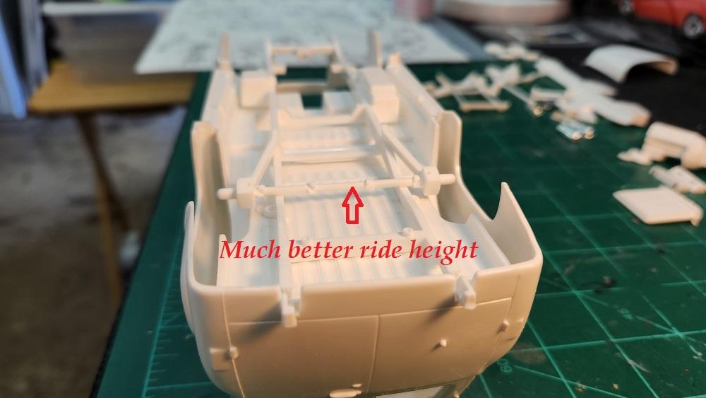

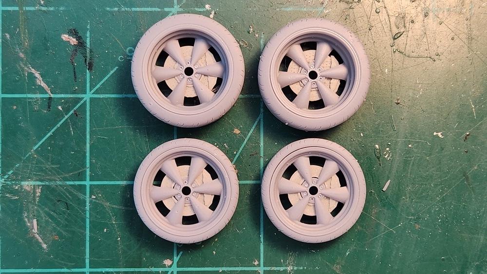

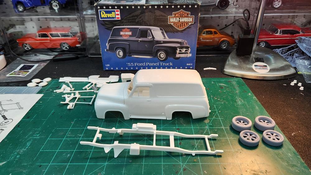

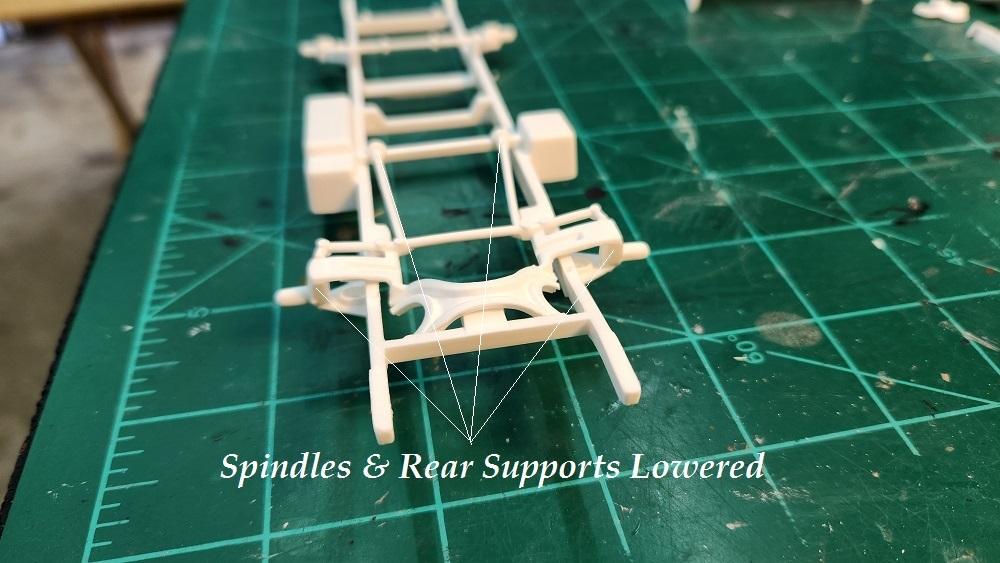

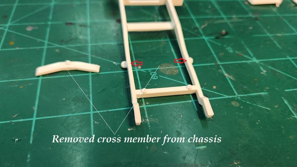

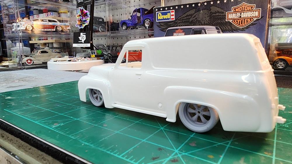

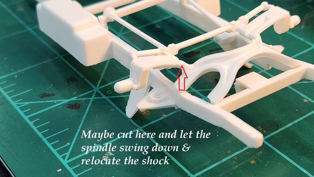

Zippi Posted August 18 Posted August 18 (edited) Next victim up on the bench fellows. I got a look at this kit this morning and realized right off the bat that the ride height is not good. I have selected the American Torque Thrust 6 lug wheels that I printed out and they look pretty nice on the mock-up. I removed the cross member in the rear to let the axle drop about 1/8" and it's looking pretty good now. On to the front. I always have trouble getting the front end lowered. Edited August 18 by Zippi 12
TopherMcGinnis Posted August 18 Posted August 18 That'll be a cool ride. I built that one a couple decades ago 😳 1
Zippi Posted August 18 Author Posted August 18 4 hours ago, TopherMcGinnis said: That'll be a cool ride. I built that one a couple decades ago 😳 Thanks. Should be a nice build. Boy thats a lot of restate to throw some paint on. 1
Zippi Posted August 19 Author Posted August 19 11 hours ago, TopherMcGinnis said: Good Ole Slab Side! Yeah, that's a slab of plastic for sure.
Zippi Posted August 19 Author Posted August 19 9 hours ago, meechum68 said: Nice planning! This should be slick! Thanks Michael. Yeah, if I don't plan these builds out I'll get into trouble pretty quick. 1

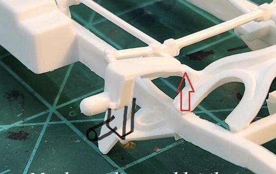

NOBLNG Posted August 20 Posted August 20 Nice project Bob.😎 Another way you could lower the front is to re-locate the spindle? 1

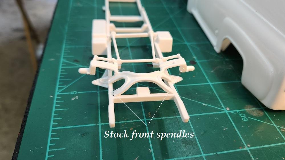

Zippi Posted August 20 Author Posted August 20 (edited) On 8/20/2025 at 8:02 AM, NOBLNG said: Nice project Bob.😎 Another way you could lower the front is to re-locate the spindle? Thanks Greg. Yup, I dropped the whole assembly and the spindle is now bottomed out on the bottom A arm. Edited August 22 by Zippi 1
Zippi Posted August 20 Author Posted August 20 The front spindles have been lowered for the nice looking ride height. Everything is looking good but won't know for sure until I get the wheels assembled and slide the wheels on all 4 spindles. 4
David G. Posted August 20 Posted August 20 Wow Bob, that's about as low as it can get! Now all we need is functional air bags! David G.
Zippi Posted August 21 Author Posted August 21 22 hours ago, David G. said: Wow Bob, that's about as low as it can get! Now all we need is functional air bags! David G. Yup. She's bottomed out.

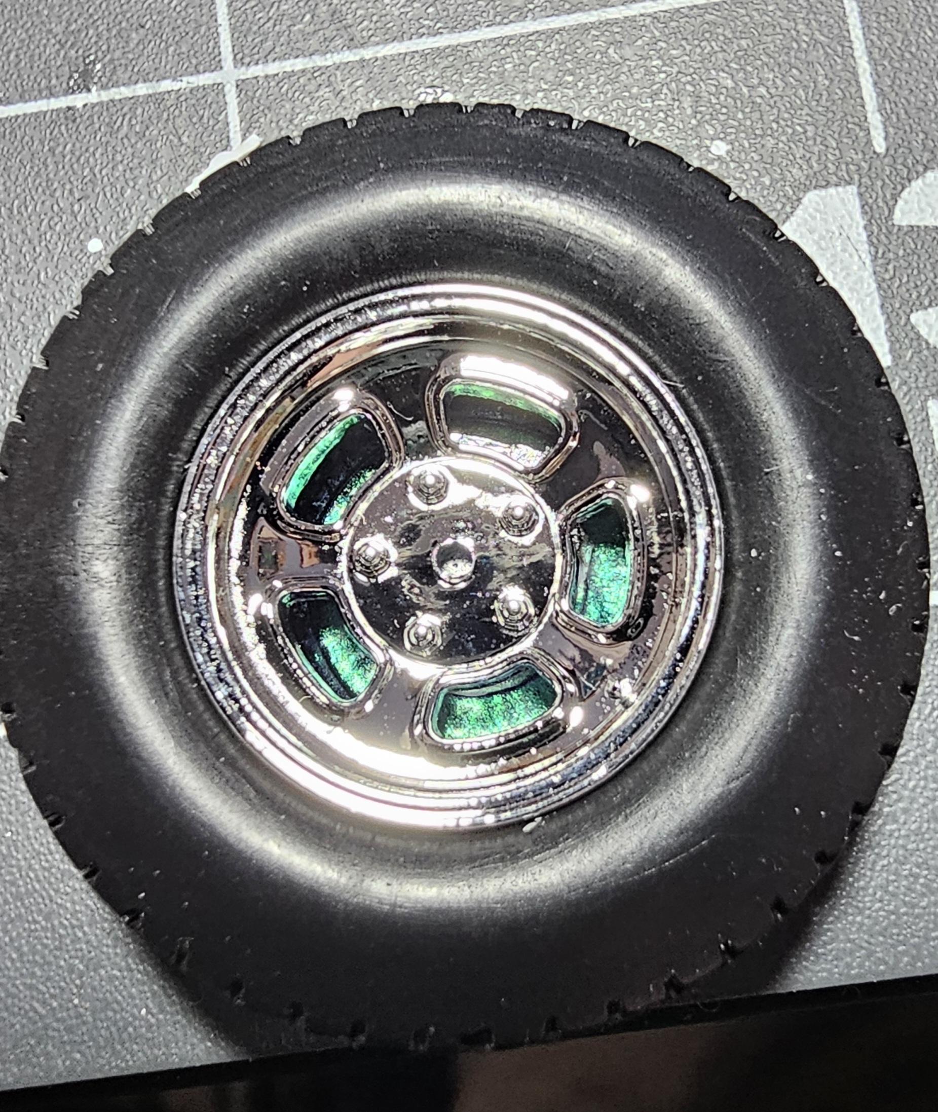

Zippi Posted August 21 Author Posted August 21 I found some rotors and disc brakes. Got them fitted to the wheels and looking good. I'm thinking red for the calipers. 3

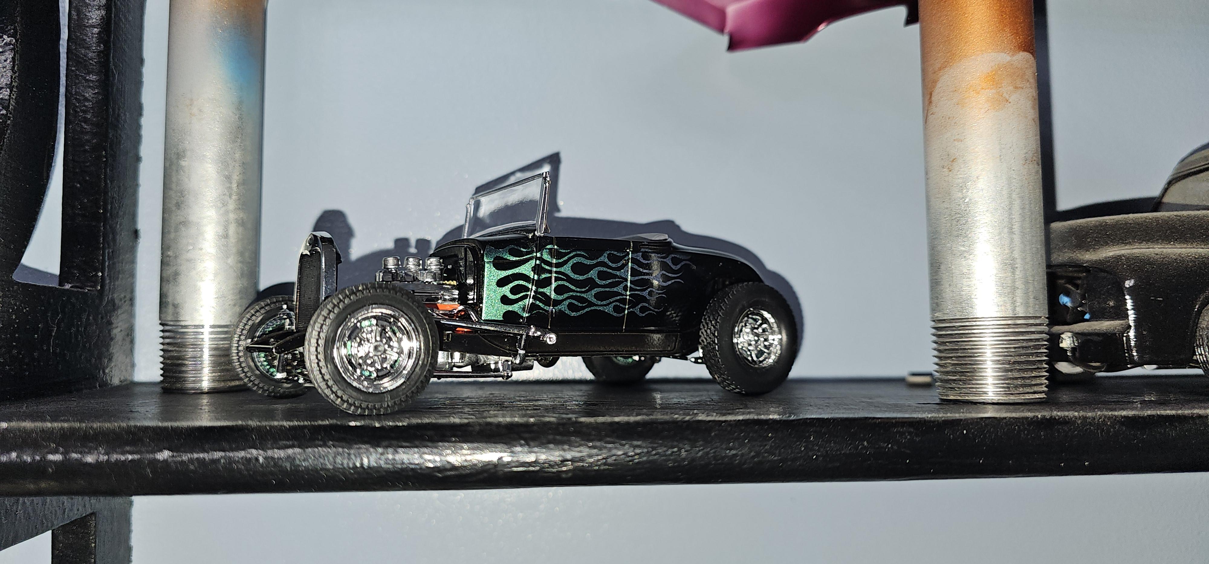

TopherMcGinnis Posted August 21 Posted August 21 3 hours ago, Zippi said: I found some rotors and disc brakes. Got them fitted to the wheels and looking good. I'm thinking red for the calipers. What color(s) are you using on the body/interior? Maybe match an accent color? I painted the drums for the '29 Roadster with the same paint as the flames. 1
Zippi Posted August 21 Author Posted August 21 3 hours ago, TopherMcGinnis said: What color(s) are you using on the body/interior? Maybe match an accent color? I painted the drums for the '29 Roadster with the same paint as the flames. Nice looking Topher. Haven't got a color locked down just yet.

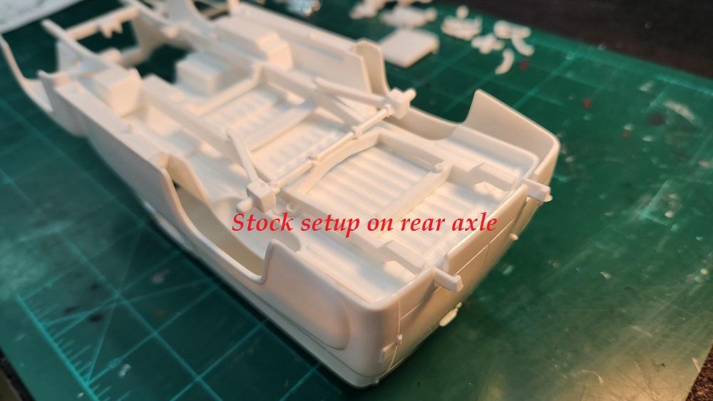

FoMoCo66 Posted August 22 Posted August 22 Nice work Bob, you really got that mopar front end LOW. I have never owned this kit so just one question, where is the differential on the rear axle, how do you get power to spin the rear? 1

Zippi Posted August 22 Author Posted August 22 8 hours ago, FoMoCo66 said: Nice work Bob, you really got that mopar front end LOW. I have never owned this kit so just one question, where is the differential on the rear axle, how do you get power to spin the rear? The differenial is two piece and it sandwiches the rear axle between the two halfs. 1
