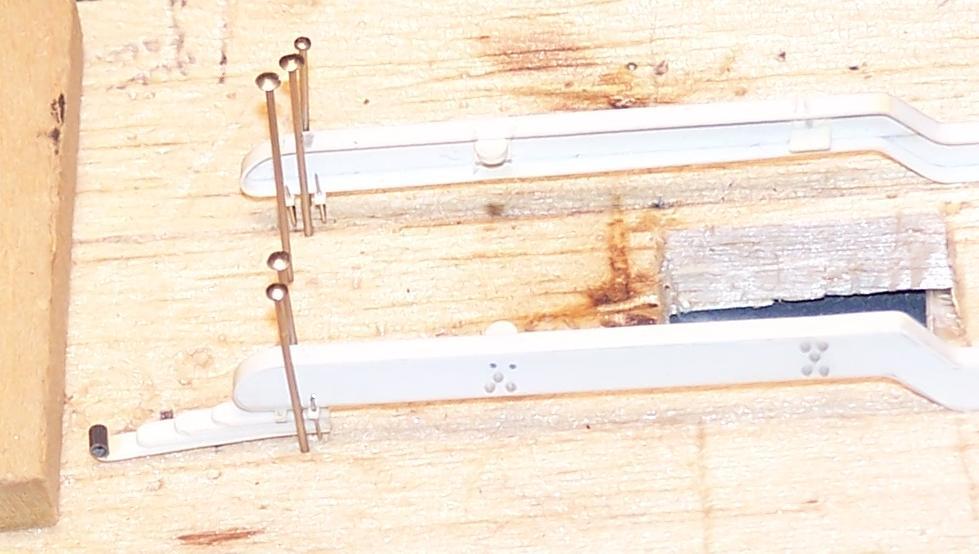

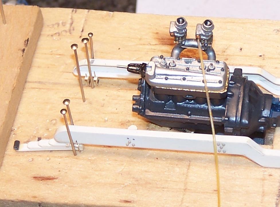

Ace-Garageguy Posted yesterday at 02:00 PM Posted yesterday at 02:00 PM 10 hours ago, Harv Mushman said: Should I scratchbuild a chassis (e.g. rails/xmembers), and if so, how? I looked through Evergreen and Plastruct and neither seemed to have suitable channel (approx 9.5x3"). Straight channel wouldn't do you all that much good, as the rails are tapered in the rear and curved/shaped/tapered in front. One way to fab them (and the way I'd do it) would be to draw them out in profile (after research and suitable scaling), cut two identical outer walls from something like .020" or .030" styrene sheet, and carefully attach the top and bottom flanges (which CAN be made from straight sections of strip stock). Make the crossmembers from suitable channel. As for the rest of the chassis details, just break each part down into basic shapes, and fabrication becomes relatively straightforward. A little tricky, but entirely doable with some patience. There are some threads on here where similar procedures have achieved strikingly fine models. 2
