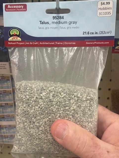

TexasRoadWarrior Posted 8 hours ago Posted 8 hours ago 1 hour ago, Elrodbeckham said: what do you guys use to put a gravel driveway on a diorama. beckham Depending on where you live, and what scale you're working in, if you have a Michael's near by, you can get different colored crushed stone and use that. It comes in different sizes as well as colors so you should have a decent choice. You could also use model railroad ballast although that may be the wrong scale for you. I believe the largest scale on that is G scale. You might also want to get model scenery cement to hold the stone down. Woodland Scenics makes a good one, probably get that at your LHS. I've also thinned out White PVA (Elmer's Glue) and used that as well
