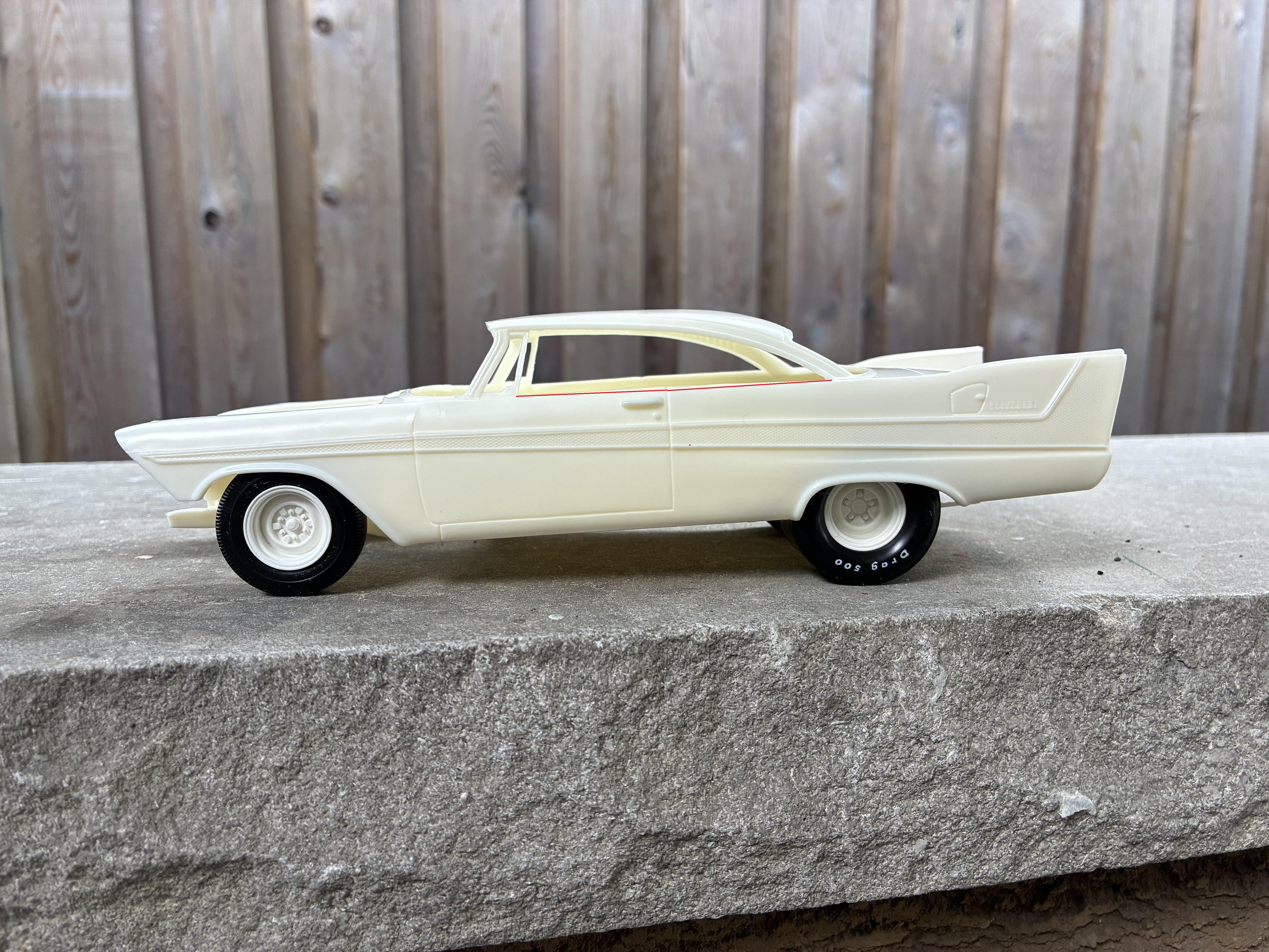

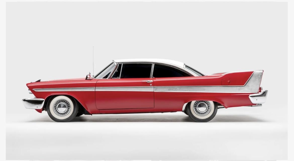

Horrorshow Posted September 11 Posted September 11 Seems like the AMT Christine kit’s roof is too low. I measured both pictures, I know angles are different ect., and it definitely looks lower. Curious what others think. 1
Rob Hall Posted September 11 Posted September 11 That kit has some proportion issues with the roof and rear quarters. I recall lots of discussion here when it was first released 20+ years ago. 1 1
Matt Bacon Posted September 12 Posted September 12 I think to really be able to tell you need to put a block of black foam to fill the glasshouse, and stand well back and zoom in with the camera. As it is, the line of the nearside window is hard to see because of the “view through” of the far side. Standing further away will reduce the fish-eye distortion of the camera lens and give you something more directly comparable with the real car picture. best, M.
Ulf Posted September 12 Posted September 12 My tip is to hold a piece of paper inside the body and draw the outline of the opening, cut it out, and place it on the iPhone screen. You should get an idea of whether the proportions are correct. Pictures are difficult; few are accurate representations, and many product images are manipulated. 2
Ace-Garageguy Posted September 12 Posted September 12 I can tell you one thing right off. The line over the side glass is way wrong. Look at the real car shot; the line is straight, almost dead parallel with the line at the top of the doorskin. On the model, that line over the door glass starts sloping down almost immediately. The discrepancy is not a camera or lens artifact. It's just wrong. There are other issues, but that one jumps out and does indeed make the roof look too low...though it may actually be too low even at the front. 4
mikos Posted September 12 Posted September 12 It looks too low due to the slope of the side windows like Bill mentioned. If you straighten that section out, may need to add/spice in a new drip rail section in that area, it would look closer to the real car. It’s correctable with a little work.

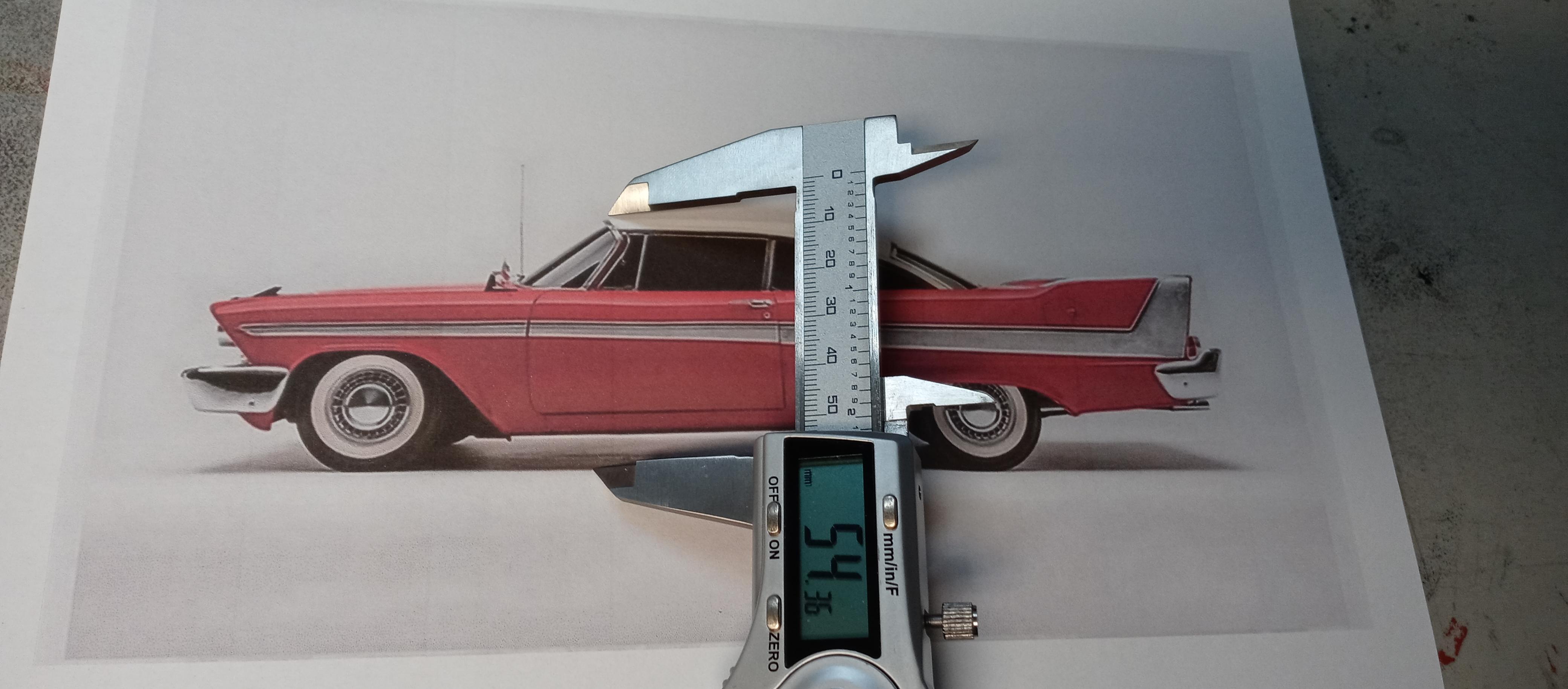

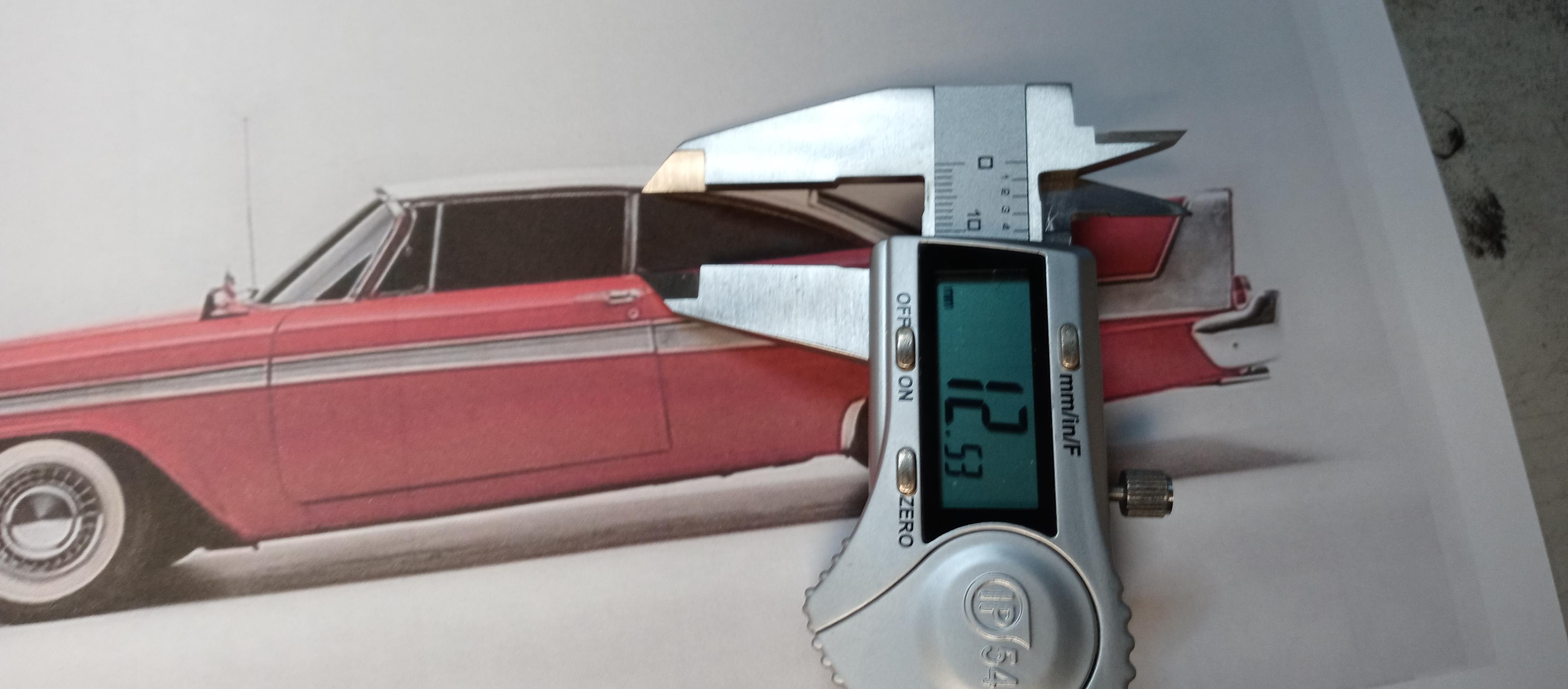

Justin Porter Posted September 12 Posted September 12 A fun experiment goes like this. According to How Stuff Works, a 1958 Plymouth stands 53.5" tall. If we convert that to measurements that dial calipers like, that's 1359mm. Divided by 25 that gives us a scale height of 54.36mm. If we take Horrorshow's side profile picture and play around with resizing percentages until it prints at a height of 54.36 we get a 1/25th scale side profile of a real 1958 Plymouth. We then can take a measurement of the side window aperture at the place where it looks the worst to my eye and on the real Plymouth it measures out at 12.53mm. Now all we need is someone with dial calipers and an AMT Belvedere to check their own findings. I will also grant this is just rough calculations based on 10 minutes of Google and playing with my printer. 1 1
Can-Con Posted September 13 Posted September 13 This has been discussed to death here in the past. Yes, the roof is too low, yes, the side trim isn't strait and yes, the engine has the wrong intake for the serise engine. 1

Sledsel Posted September 15 Posted September 15 On 9/11/2025 at 6:17 PM, Horrorshow said: Seems like the AMT Christine kit’s roof is too low. I measured both pictures, I know angles are different ect., and it definitely looks lower. Curious what others think. I sanded and reshaped the window openings where the red line is. The door is kicked up in the rear. Mine came out looking much better but the build is not finished. No filling was needed as there is enough material.
mikos Posted September 15 Posted September 15 (edited) 2 hours ago, Sledsel said: I sanded and reshaped the window openings where the red line is. The door is kicked up in the rear. Mine came out looking much better but the build is not finished. No filling was needed as there is enough material. You may still have to correct the curve in the upper drip rail above the door. In the pics of the real car above, it starts to slope down dramatically when you near the B-pillar of the window area. Edited September 15 by mikos 1
