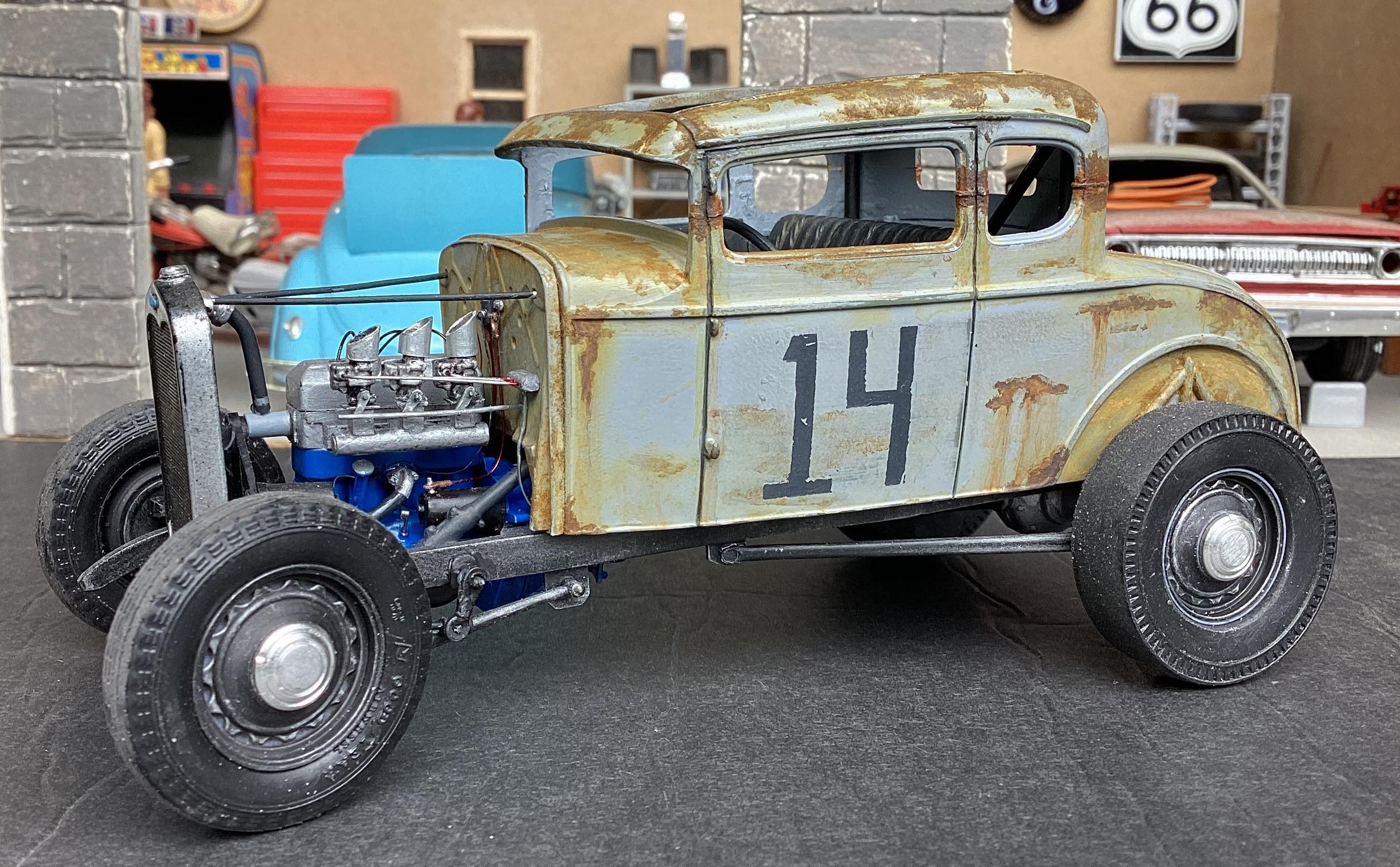

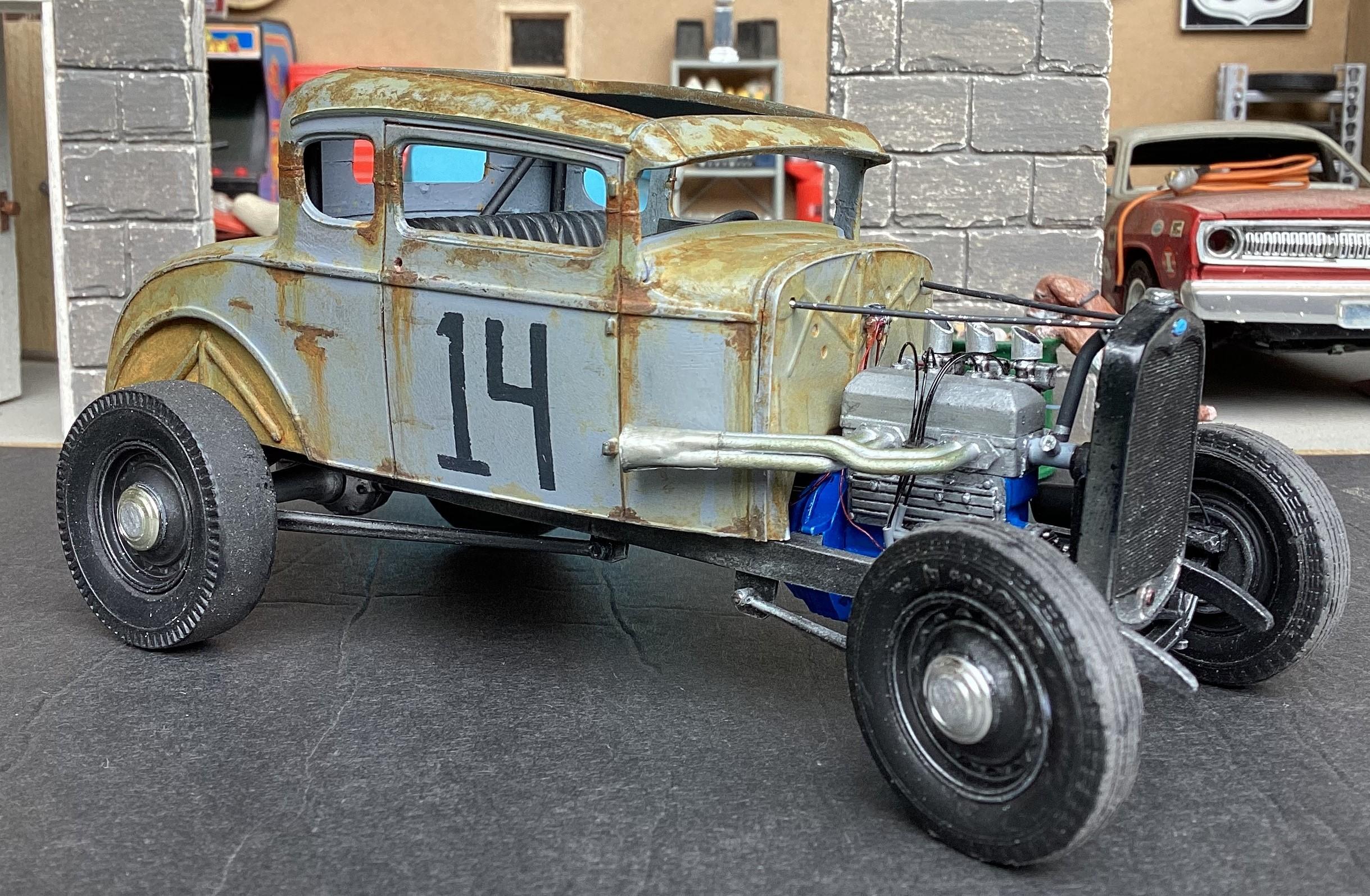

Dennis Lacy Posted September 20 Posted September 20 @bill-e-boy This sounds like a fun project. There was a resurgence of interest in early Ford 4-cylinder performance in the 60’s thanks to the formation of the Forever Four Cylinder club. They even ran a rail dragster. ARDUN never originally made a Model A/B head but they do exist now as a modern day creation. I knew a guy that ran one in his 29 Roadster Pickup. It sure looked neat! Inspired by that, some years back I created an ARDUN 4 in scale using a Revell block and a head & rocker cover from a Revell 50 F1 Pickup kit with a scratch built intake. I put it in an old Revell parts pack Dragmaster frame. I’ll leave a few pics to help inspire your conversion. 6

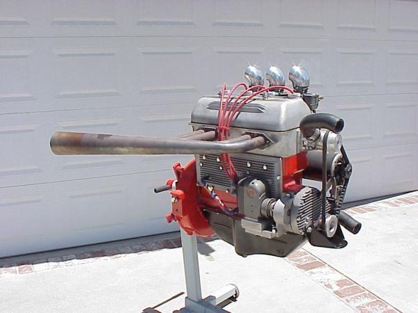

mchook Posted Thursday at 04:20 PM Posted Thursday at 04:20 PM Great project, I can't wait to see it come together. This reminds me of the A that I built a while back. I remember you commenting on it. Incase you don't remember, here's some more inspiration pics to check out. 2
bill-e-boy Posted Thursday at 07:00 PM Author Posted Thursday at 07:00 PM (edited) Thanks for the pix of the real deal Mark. A picture is worth a thousand words. I have been scouring the inter web looking for pictures of an Ardun headed banger. Lots of words mentioning a Frick head - good and bad - but alas no pictures. Your photo answers some of the gray areas I have like how to implement the ignition and water pump. I had in mind to fit a pump to the front of the head where a water outlet already exists similar to what you have done. But I was heading down the thought road of a front mounted distributor or magneto on an angle drive but space is limited as I need room for a blower drive set up and your pix shows a mag mounted off the rear of the cam drive - perfect I do like your headers and the mana-free inlet manifold too. And yup Sid - three two's are what I have in mind and I will need to Neanderthal build an adaptor to fit the blower. I need to scratch build an intake manifold too. Edited Thursday at 07:07 PM by bill-e-boy 2

mchook Posted Thursday at 10:54 PM Posted Thursday at 10:54 PM (edited) Looking great! I found some more pics of that engine in a car. Edited Thursday at 10:55 PM by mchook 1 1
sidcharles Posted Thursday at 11:08 PM Posted Thursday at 11:08 PM those first two pictures definitely show all the good stuff. thanks for posting them. 2
