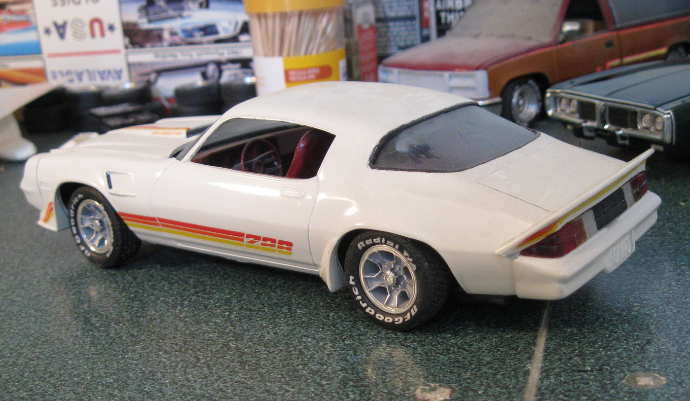

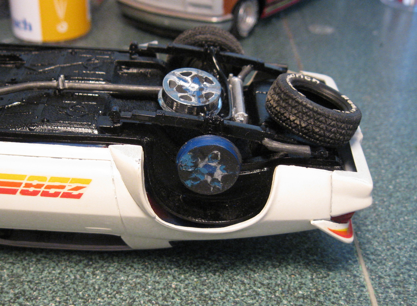

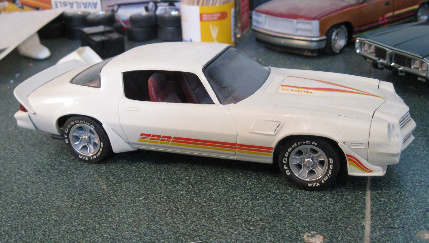

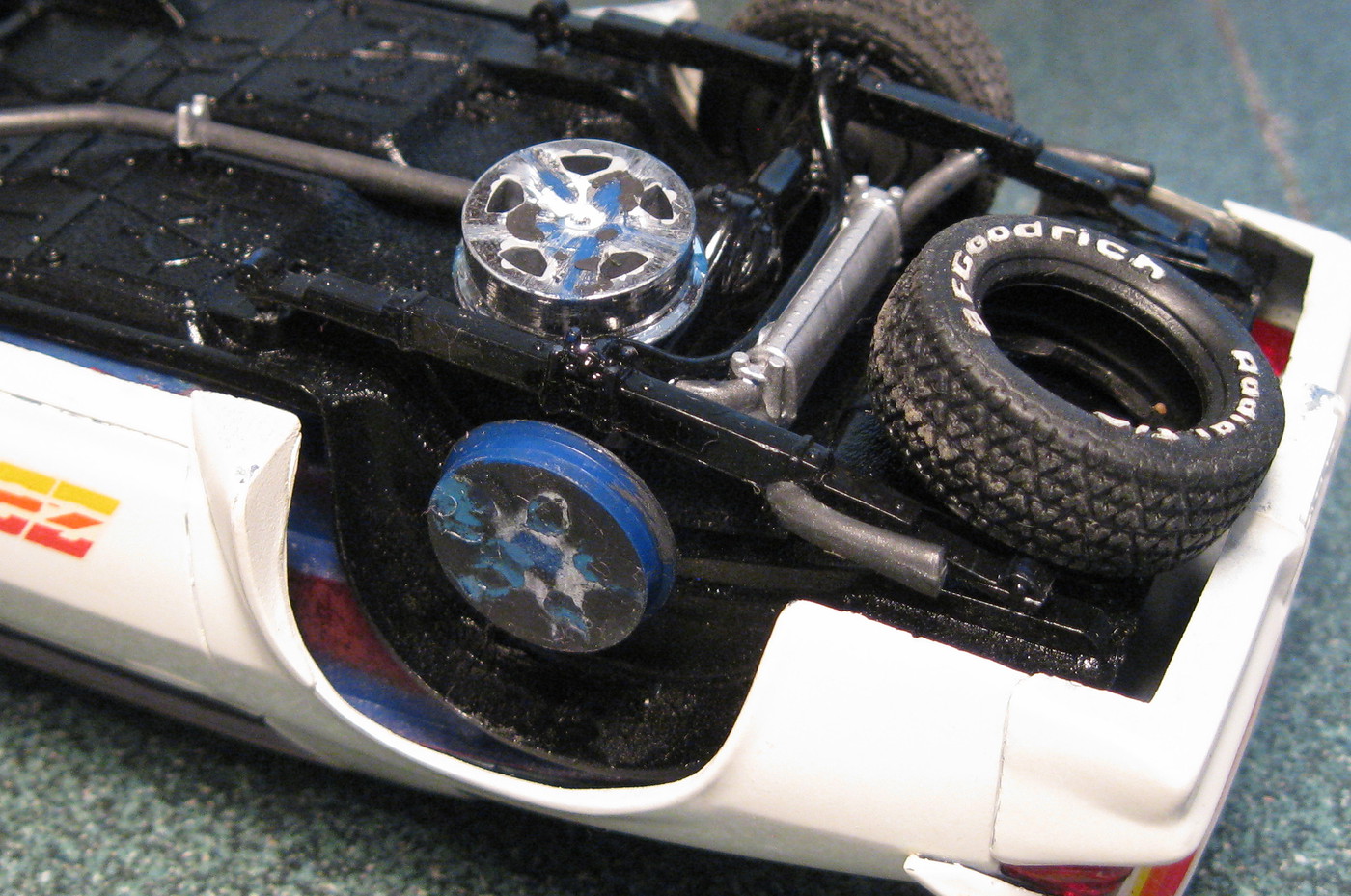

Can-Con Posted September 13 Posted September 13 As everyone knows, they always eat the plastic they come in contact with. Well, maybe not always , , I built this MPC annual '81 Z-28 Camaro over 35 years ago. Didn't like the tires that came in the annual kit so just used some from another then current kit. The infamous BFG Radial T/As that "ALWAYS" eat the plastic. So, remember, this kit has been wearing these tires for over 35 years, probably closer to 40. Pulled one apart and this is what I found , , , No damage whatsoever. So, Why? I didn't do anything to protect the plastic from the tires, didn't even paint the surfaces where they meet. Was it the blue plastic? Were the tires made in a different plant? Different country? Dumb luck??? Don't know but this has been my experiences with these tires for the most part. But, seriously, were the ones in the Canadian boxes, sold in Canada made in a different plant with a different eormula for the vinyl then the ones from the U.S. ???
Bugatti Fan Posted September 13 Posted September 13 Who knows ? Best to err on the side of caution and put some sort of barrier between the vinyl tyres and the plastic of the wheel. Paint or foil. Not sure whether necessary or not on wheels that are vacuum posted though. I expect someone will know.
Mark Posted September 13 Posted September 13 Pure luck. Earlier this year, I spotted damage on the wheels of a '72 GTO I had built in the early Eighties using those tires. The kit inner wheels, and the outers ("honeycomb" wheels from a mid-Seventies MPC Chevy Monza) were all painted on their outer surfaces (outers were stripped of plating). Still got the gumball effect. Took it apart, edges of outers and inners were softened. Sanded all of that off, repainted the wheel edges, and reassembled. Tires used this time were AMT hollow Goodyear Polyglas with molded-in lettering, same as I used on a '71 Trans-Am rebuild I did around the same time as the Goat. No problems noted with the Trans-Am.

peteski Posted September 14 Posted September 14 (edited) It is the luck of the draw. Tire melt is a real thing. The vinyl mixture used to mold the tires can vary in composition. The melt is caused by the plasticizer leaching out of the PVC material. Virgin vinyl (PVC) is a hard plastic (most modern sewage plumbing is made of PVC). To make the PVC soft, a chemical called plasticizer is added to the PVC, making it soft. That stuff can leach out of the the tire PVC material, and when it comes in contact with polystyrene or ABS (both are hard plastics used for molding model kit parts) the plasticizer will try to make those hard plastics soft, thus the infamous "melt" happens. Why some vinyl tires leach plasticizers while others don't is anybody's guess. There might be different formulations of PVC and or plasticizer being used at the time by the model company. Some might leach the plasticizer while others don't Over the years model kit tires were also made from materials other then PVC. Those usually do not cause any adverse reactions. Most Japanese kits have tires made from rubber. Those do not cause any problems but they can get brittle in time. Best solution would seem to make the tires from the same hard plastic as other parts of the kit, then just paint them "rubber" color. Since models are mostly static, model tires do not have to be soft to look realistic. Not even sure how that trend started. Edited September 14 by peteski 1
