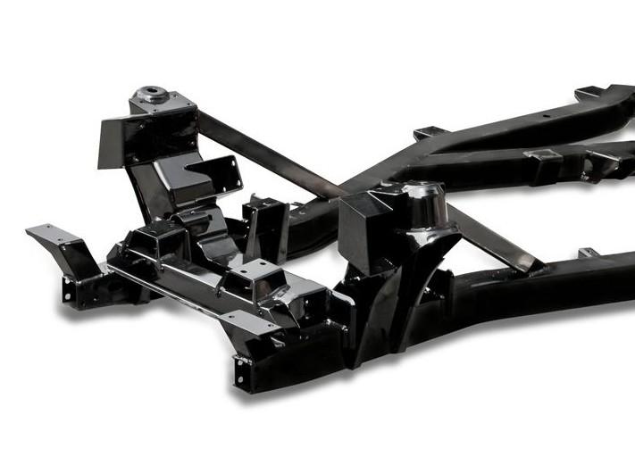

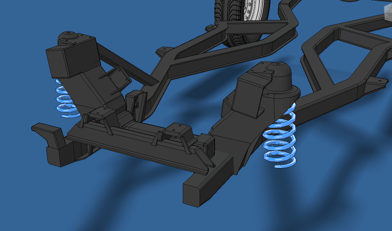

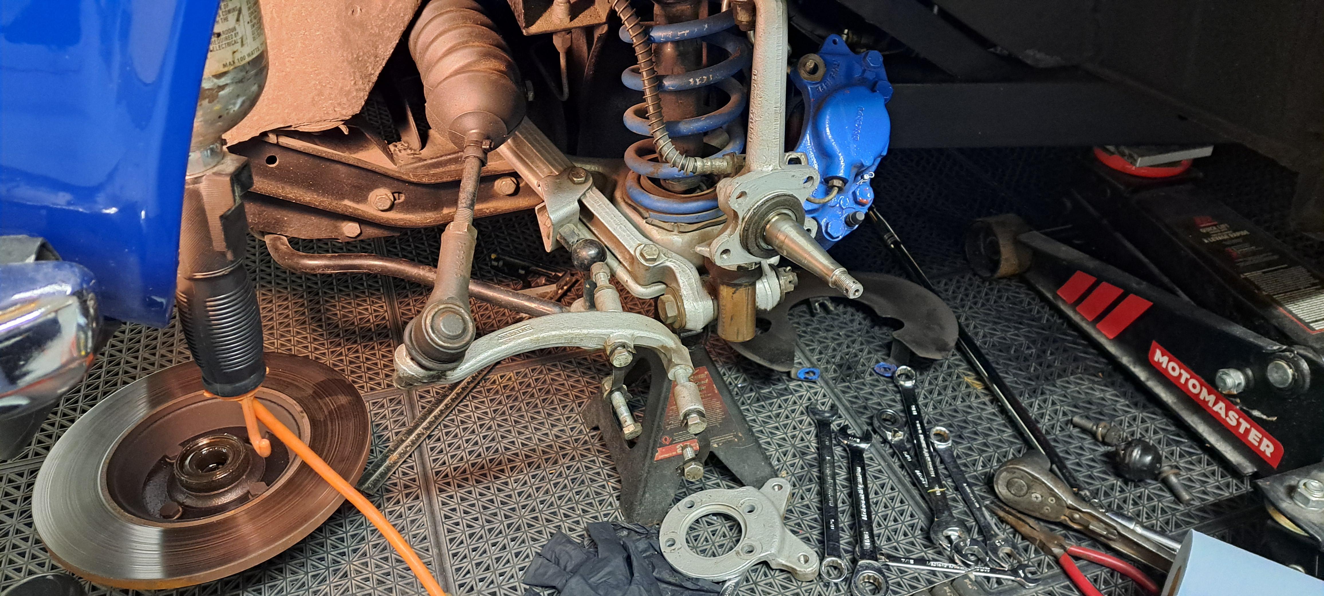

I'm slowly (very slowly) progressing with the frame modeling. It's very difficult to measure directly on my car since not much of the frame is visible.  I removed the caliber and disc to better measure the front suspension turret but there's still alot of guess work. I'll be able to ajust the suspension components as I go along so in the end, I don't think it will matter all that much.
So far
And a real frame

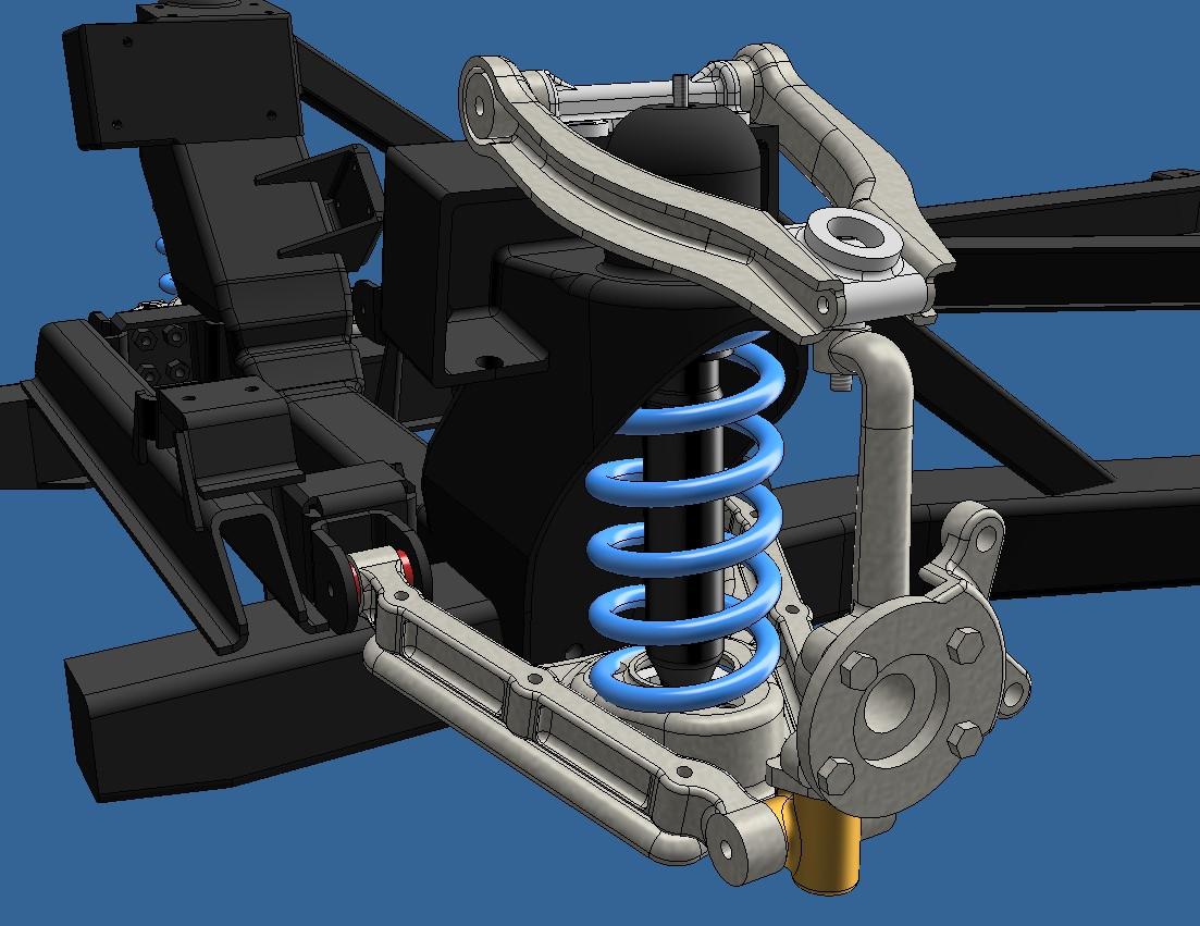

The front end is almost done.  I added the disc, hubs, calipers, steering levers and a bunch of bolts. It's starting to look like something.
I originally painted the calipers red but I have since repainted then blue to match the body color.  The calipers on the model will also be bleu.
