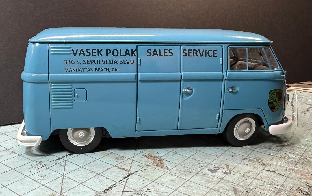

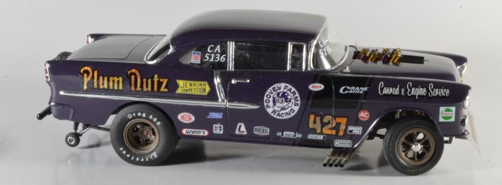

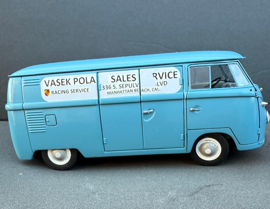

oldcarfan Posted yesterday at 12:17 AM Posted yesterday at 12:17 AM I'm looking for a better decal option than Micro Scale paper. I've used both the laser and the ink jet kind and had problems with the paper breaking up on application. Backstory: A couple years ago I printed decals using Micro Scale laser paper. I found the decals to be brittle, even with the recommended clear coat. I made them work, but it was frustrating. For my Datsun pickup box truck I tried decal paper made for coffee cups. This paper works well but is a little thick and kind of rubbery. Yesterday I made some more using using new Micro Scale paper and the decals broke into several pieces while being applied and peeled off when dry. I tried several techniques including hot, warm and cold water and none made a difference with or without Micro Set/Sol. This a picture of the decals printed on white Micro Scale laser paper. They were put on and allowed to dry for a day. I went to check this morning and parts of them had peeled away and landed on the work bench. These were put on over white vinyl, but the ones on fresh smooth paint reacted the same. Below are decals made using the coffee cup decal paper. They went on well and seem to have stuck with no problem.

DJMar Posted 16 hours ago Posted 16 hours ago I've used Bare Metal's Expert Choice for the last 15+ years and have been pretty happy with it. They have it for inkjet and laser printers, in both clear and white. To be fair, I've printed emblems, logos, and other relatively small stuff (bumper stickers) with it. I do find it a bit thick. I've never had an issue with it not adhering. It handles enamel & acrylic clears well. It's also inexpensive, about $8-10 for a 3 pack of 8.5x11 sheets.
