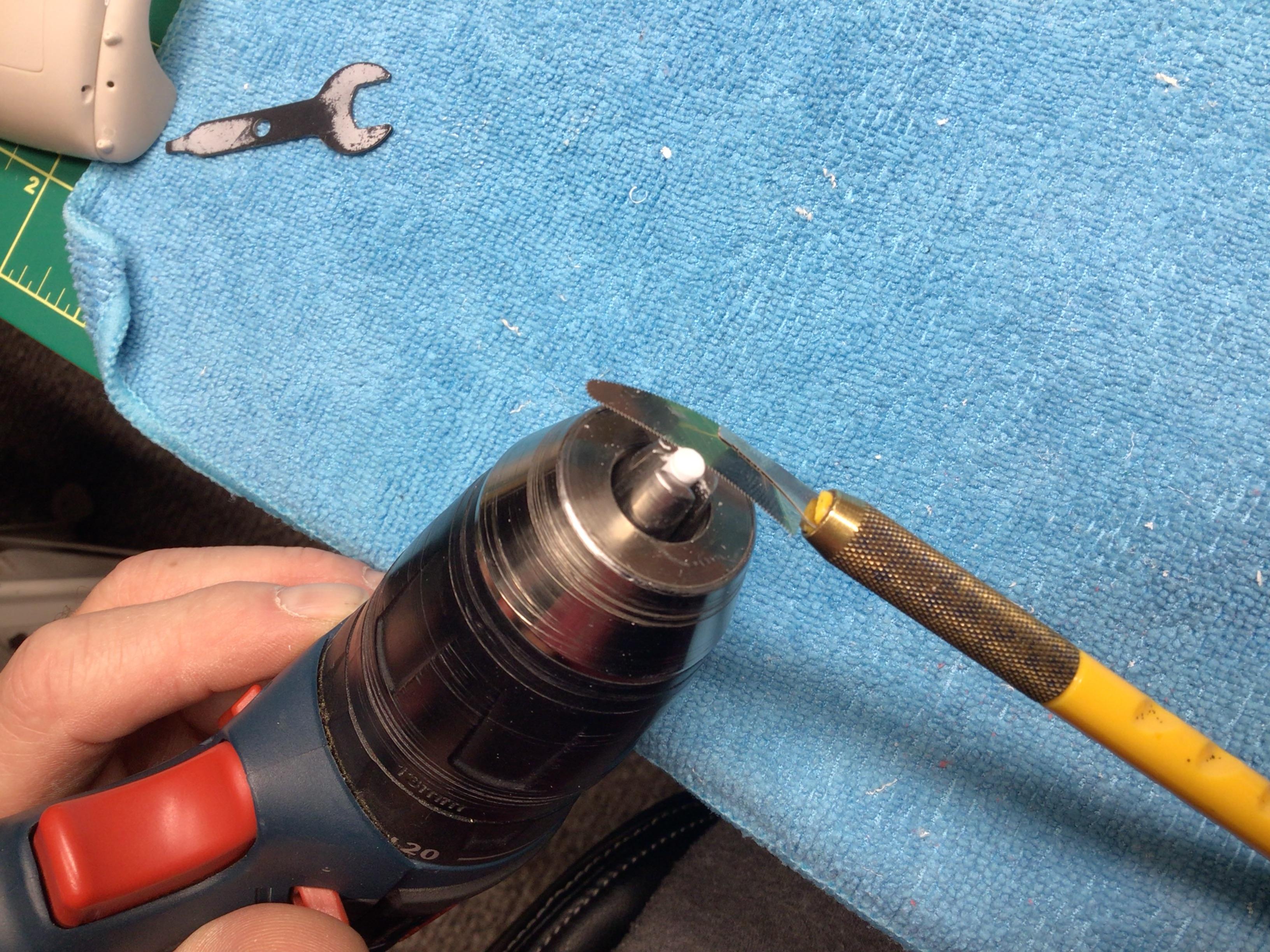

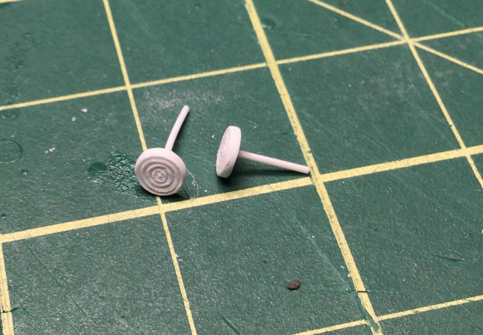

NOBLNG Posted November 1 Posted November 1 (edited) Itβs not what you think!π I made these for my β37 Chevy Cabriolet from some 0.156β Evergreen rod. I clamped a short section of scrap photo etch saw blade in a pair of forceps and just pushed it against the spinning Evergreen to scrape the circular pattern on the end. Then used the jaws of the drill as a guage for cutting the pad loose. Edit: You could make vintage brake and clutch pedals like this maybe. Edited November 3 by NOBLNG 6
Straightliner59 Posted November 2 Posted November 2 That will surely come in handy, at some point. Thanks, Greg!
Kanada Kustoms Posted November 2 Posted November 2 They came out great... Good problem solving to come up with that way to make them.Β Great tip! 1
dragstk Posted November 2 Posted November 2 Now that is a great tip. Simple, effective. Thanks Greg 1
peteski Posted November 3 Posted November 3 I should have also mentioned that while the technique and results are excellent, I am confused by the "Photo Etch Step Pads" subject line.Β When I brought up the thread I expected some photoetched metal step pads, but the only photoetched thing is a saw blade used as a shaping tool for the plastic steps. "Simple and easy technique for making step pads" would have IMO been more descriptive.
