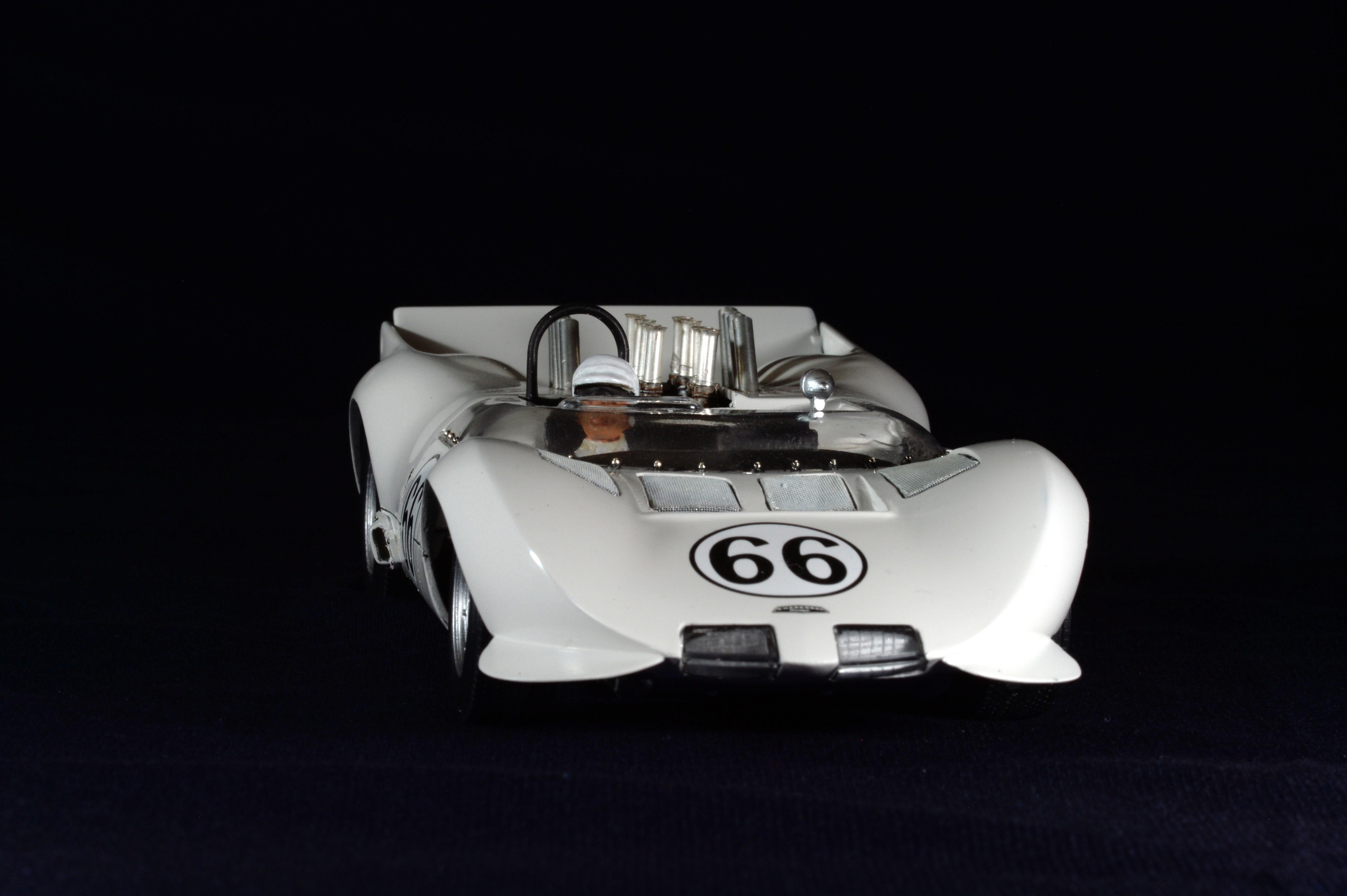

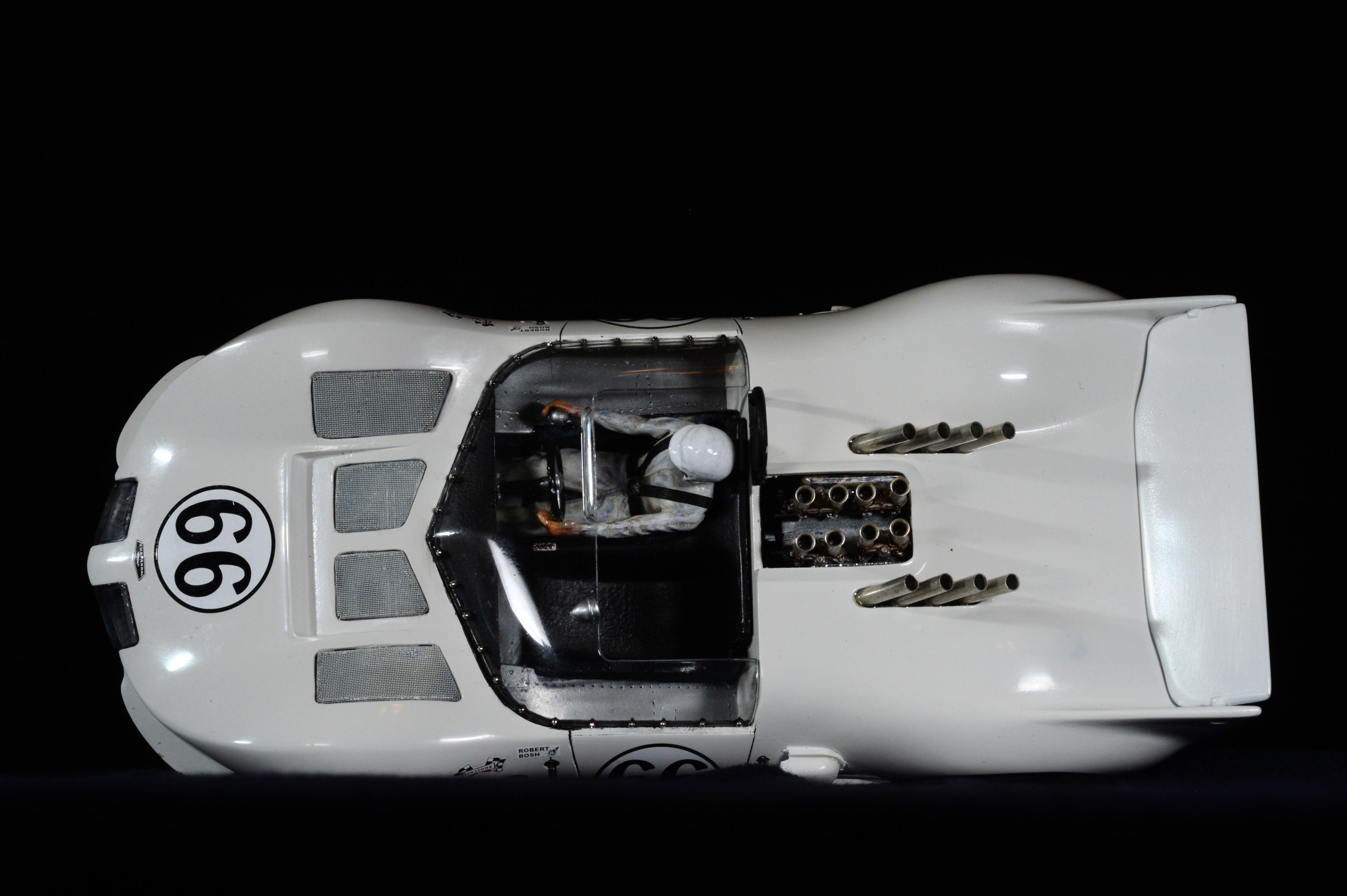

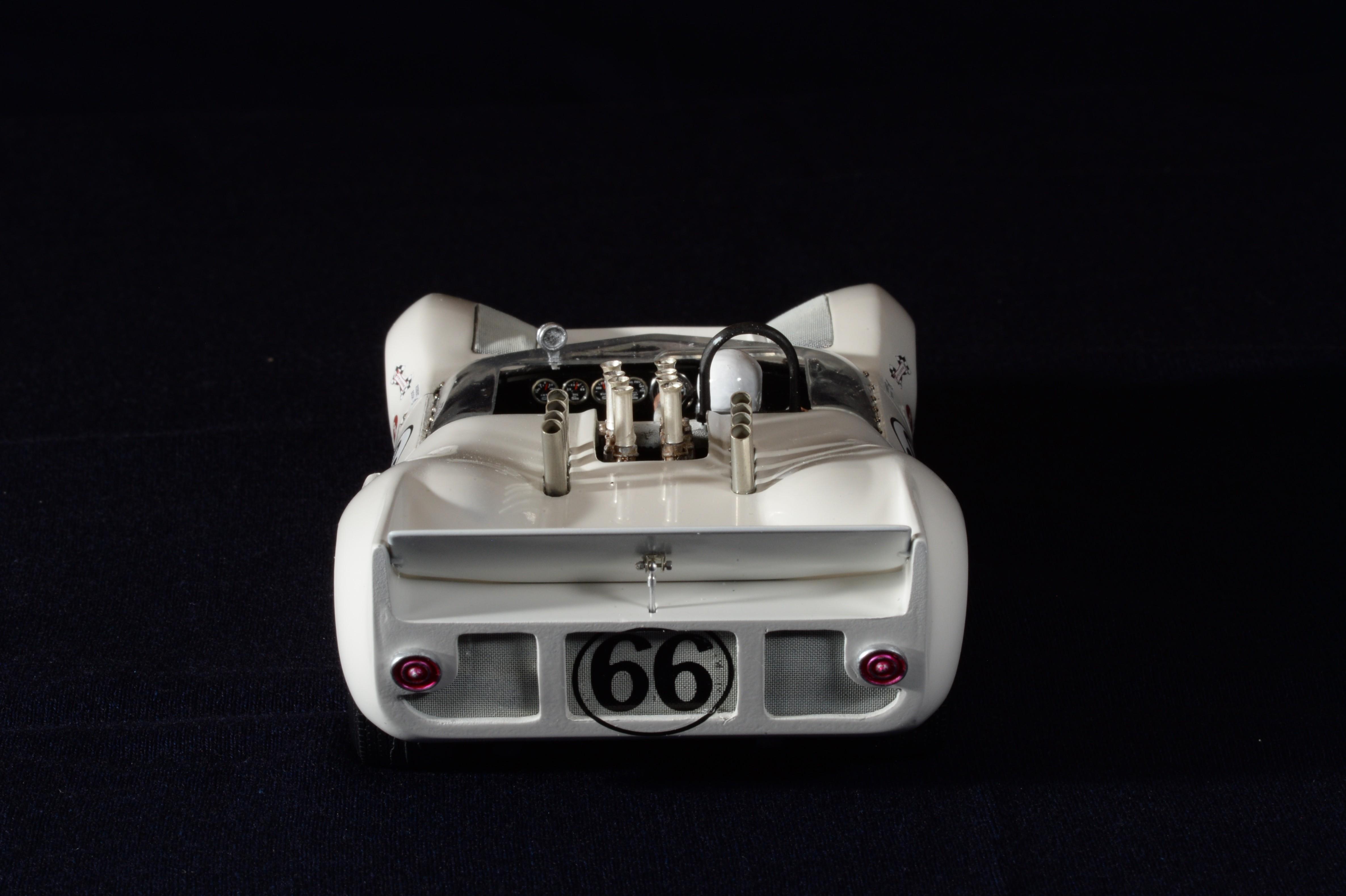

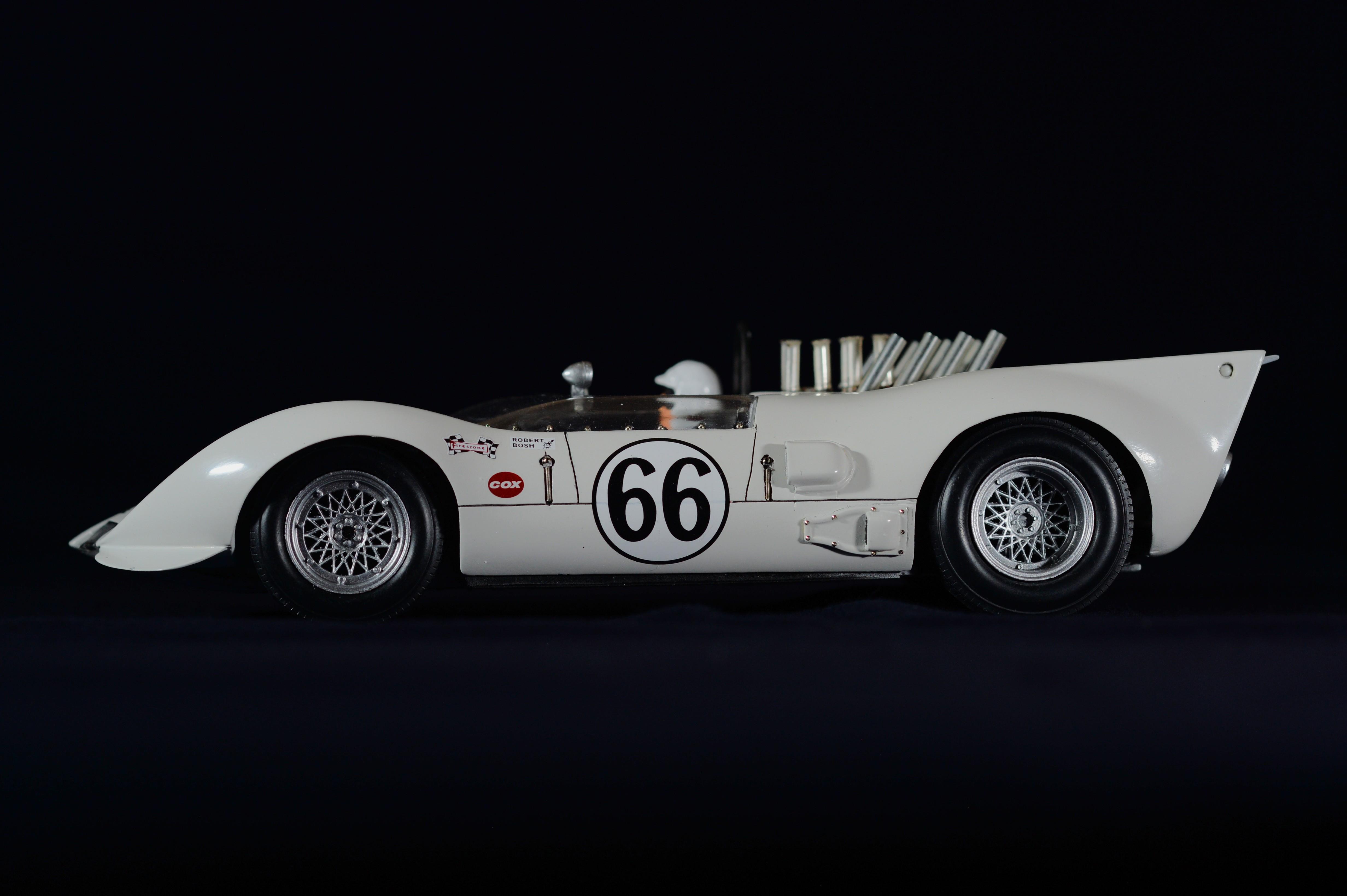

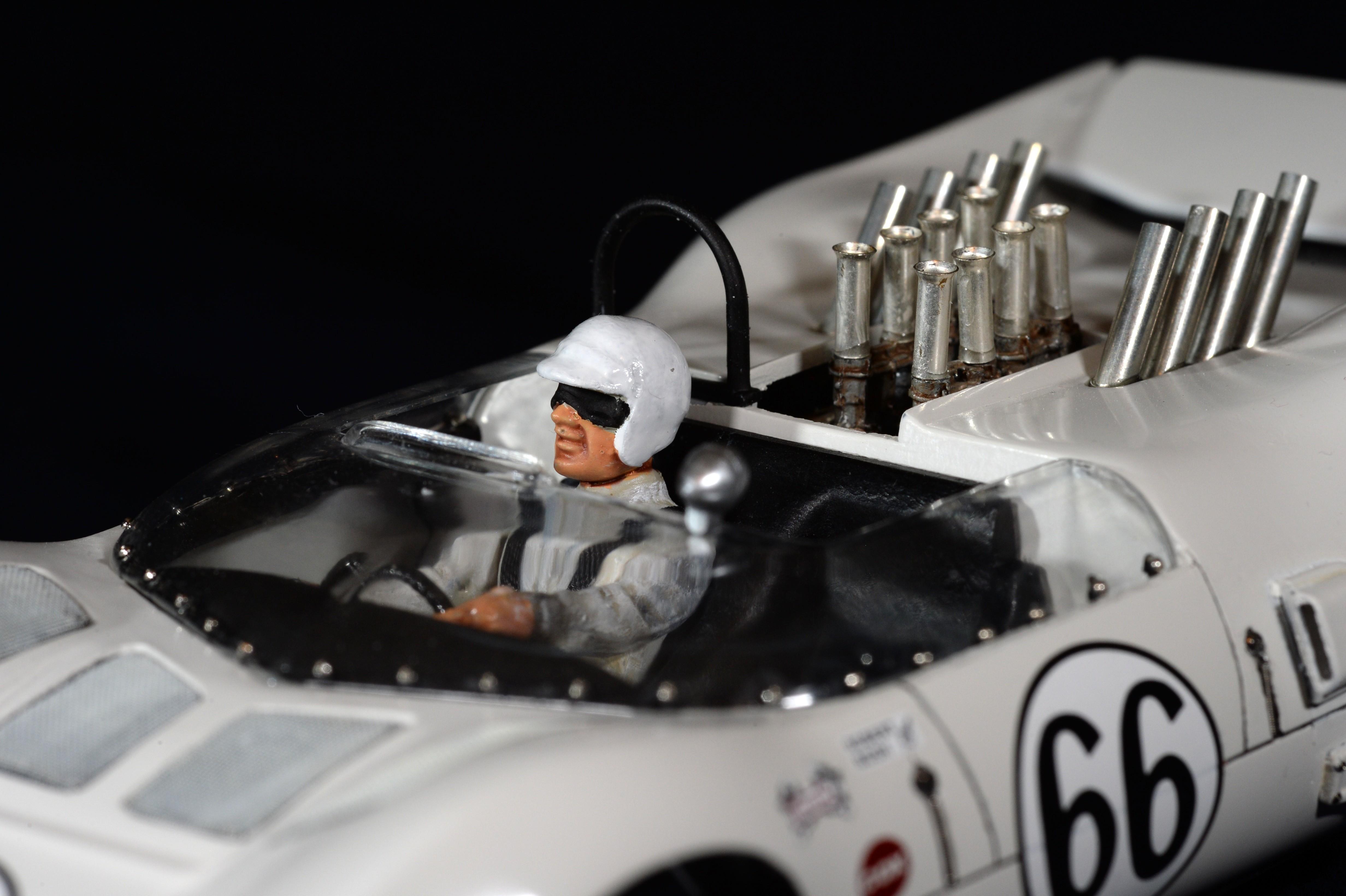

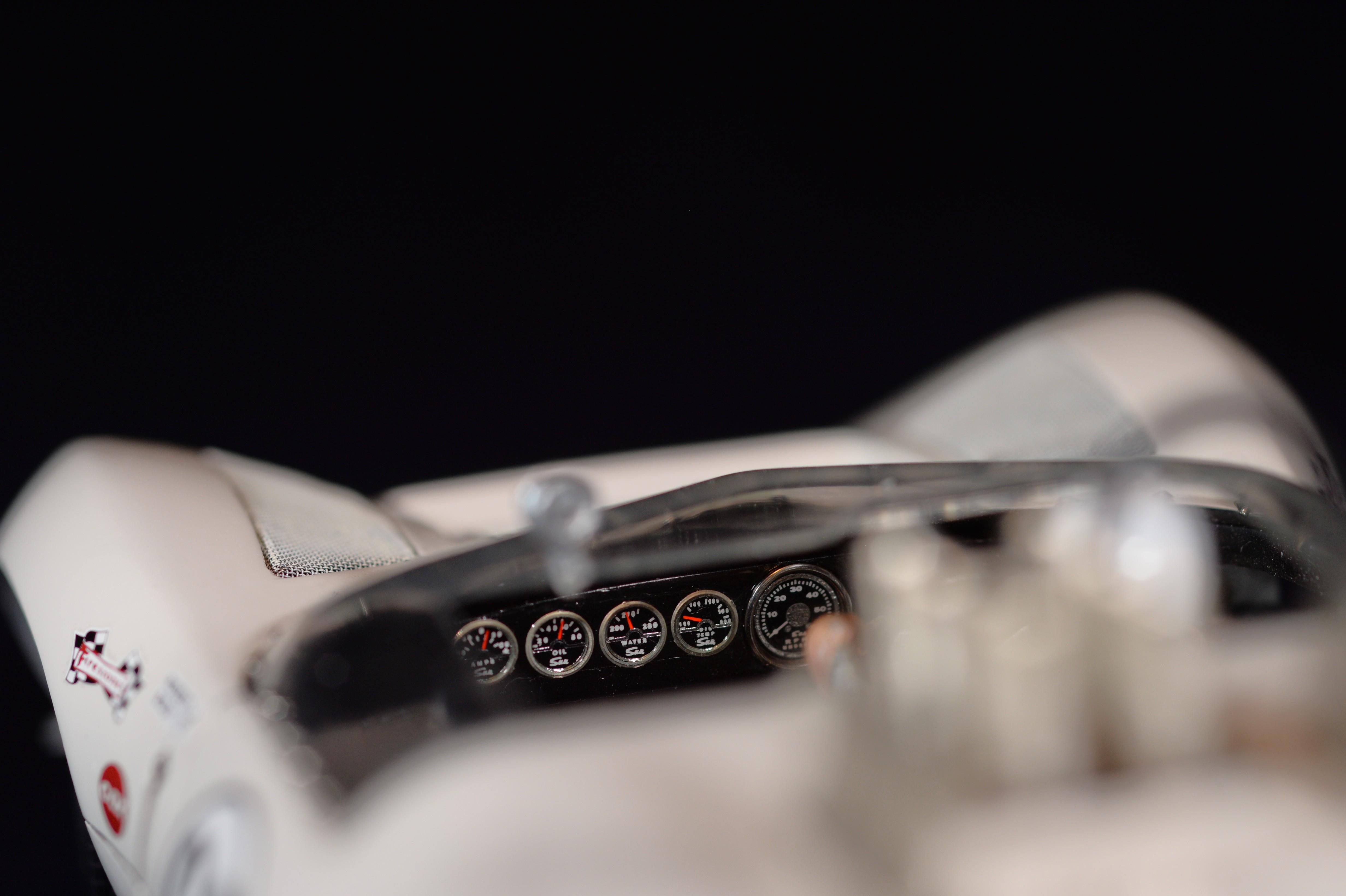

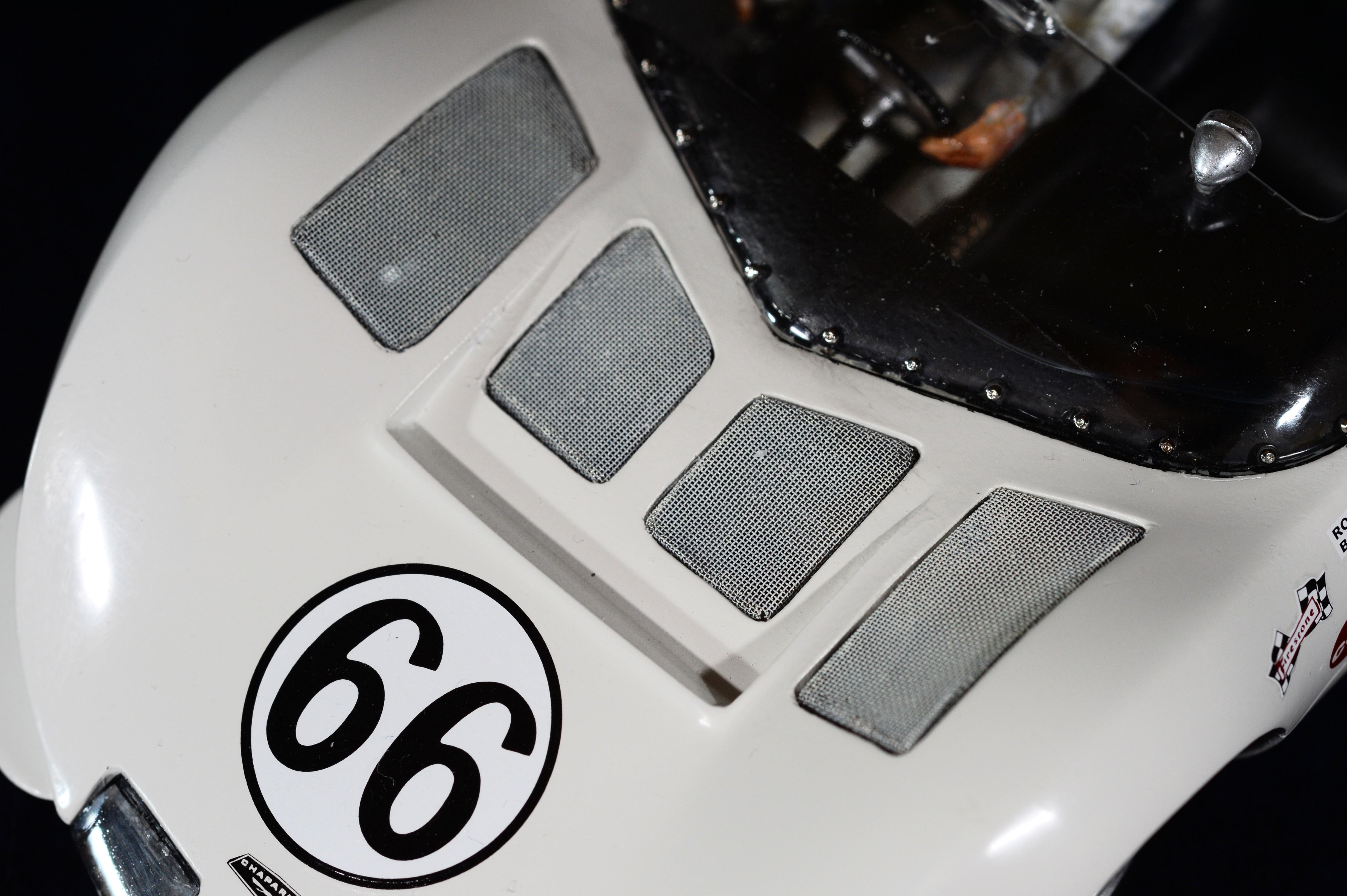

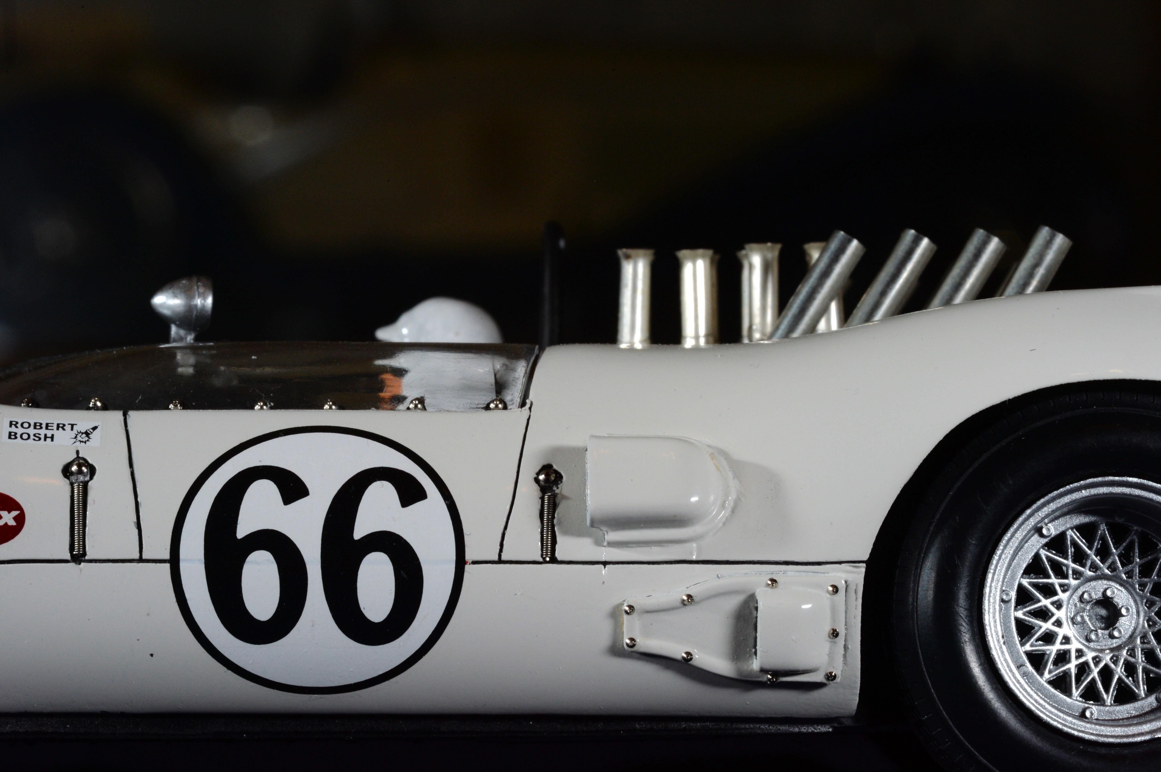

Mark W Posted Sunday at 04:00 PM Posted Sunday at 04:00 PM Finally calling this one done! Started with the ARII kit and added the interior, floor pan, inner duct work and engine from the Union Chaparral 2E, as they were the same on the 1:1 cars. Gages are decals with metal bezels. The "pipes" are electrical furrels attached to the Union engine. The wheels and tires along with the side scoops (relocated to the proper position) came from HRM. Decals are VRM and the body clips are scratch.Also added the screws (Top Studio) to the windscreen. Paint is Model Car World Ermine white. Hope you like it! 6

kensar Posted 18 hours ago Posted 18 hours ago As has already been said, great looking model and photography, too. The metal mesh really looks good and the electrical furrels worked out perfectly. 1

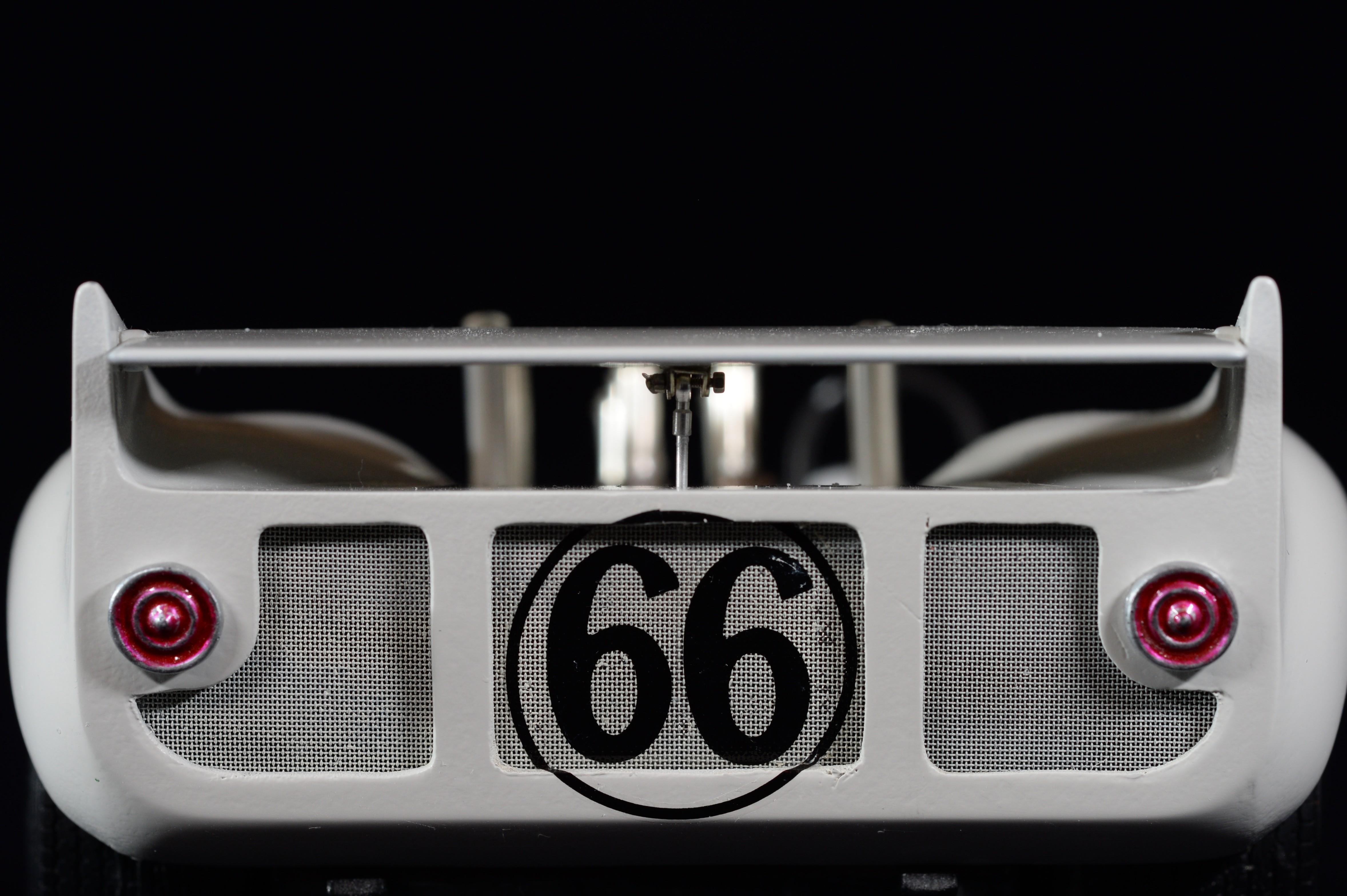

Straightliner59 Posted 15 hours ago Posted 15 hours ago It looks fantastic! I especially love this shot! Excellent work, Mark. 1

Mark W Posted 6 hours ago Author Posted 6 hours ago On 11/2/2025 at 12:43 PM, 1959scudetto said: VERY nice - I love it ! Thanks Helmut, your input on this build was invaluable. btw, I found out the higher height of the rear spoiler you showed is on the later version of this car, along with the right side scoop. The ARII car is the early version, but you need to add the exhaust rising from the rear deck, not out the back. It also had risers on the carbs, so they stuck up higher from the bodywork.

Mark W Posted 6 hours ago Author Posted 6 hours ago 12 hours ago, kensar said: As has already been said, great looking model and photography, too. The metal mesh really looks good and the electrical furrels worked out perfectly. Thanks Ken. A lot of work went into this, glad you liked it.

Mark W Posted 6 hours ago Author Posted 6 hours ago 9 hours ago, Straightliner59 said: It looks fantastic! I especially love this shot! Excellent work, Mark. Thanks Dan, I know you followed this build. Really appreciate the compliment. But I did have inspiration for this shot. 1
