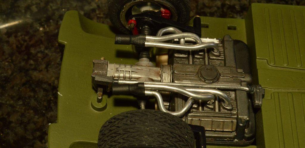

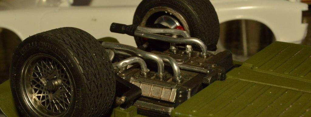

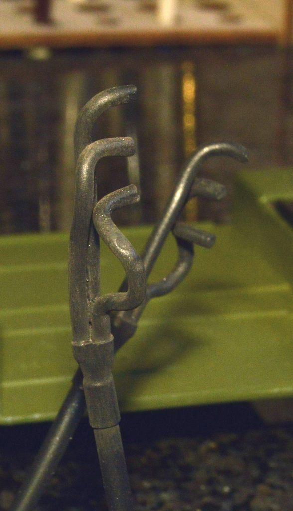

Straightliner59 Posted 3 hours ago Posted 3 hours ago 10 hours ago, SpeedAndViolence said: My main goal is to be able to bend styrene rod to make roll cages, and solder for exhaust tubes. Plastruct's ABS, or the stuff in the Ebay link I posted above work great for roll cages, etc. (they're the same material). Just work it slowly to shape with your fingers--their warmth will help with the process. For headers, I would recommend aluminum armature wire. It comes in several gauges, it bends easily, and it's much lighter than solder. I posted the interior of my Super Gas Vega, above. I built that cage using the ABS. I drill and pin the joints. I built the headers for this Porsche from armature wire. I don't recall the gauge, but it's .062". It's uniformly sized, as to diameter, and round, as well. Hope this helps.
