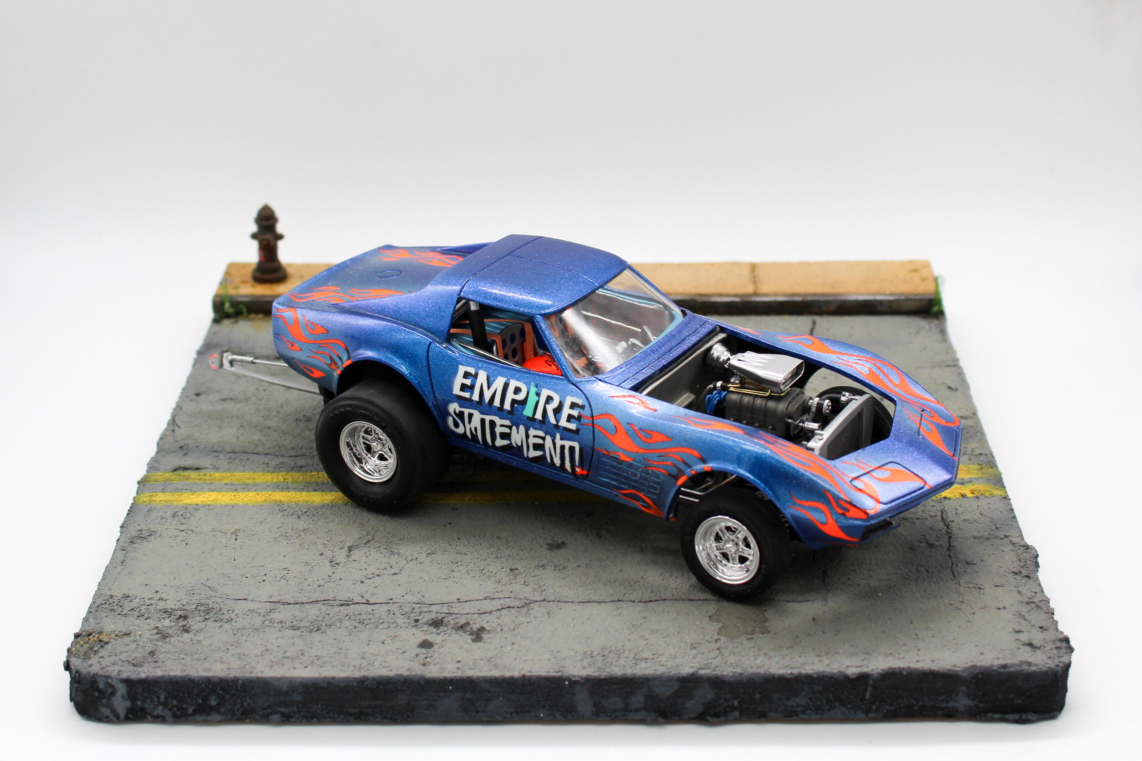

Pearl Ex are mica powders but finer than some other brands I've used. My wife and I both use pearl and metallic mica powders in art work. Pearl Ex isn't the only game in town but you have seen the effect it gives in Mike's Corvettes, so who can argue !

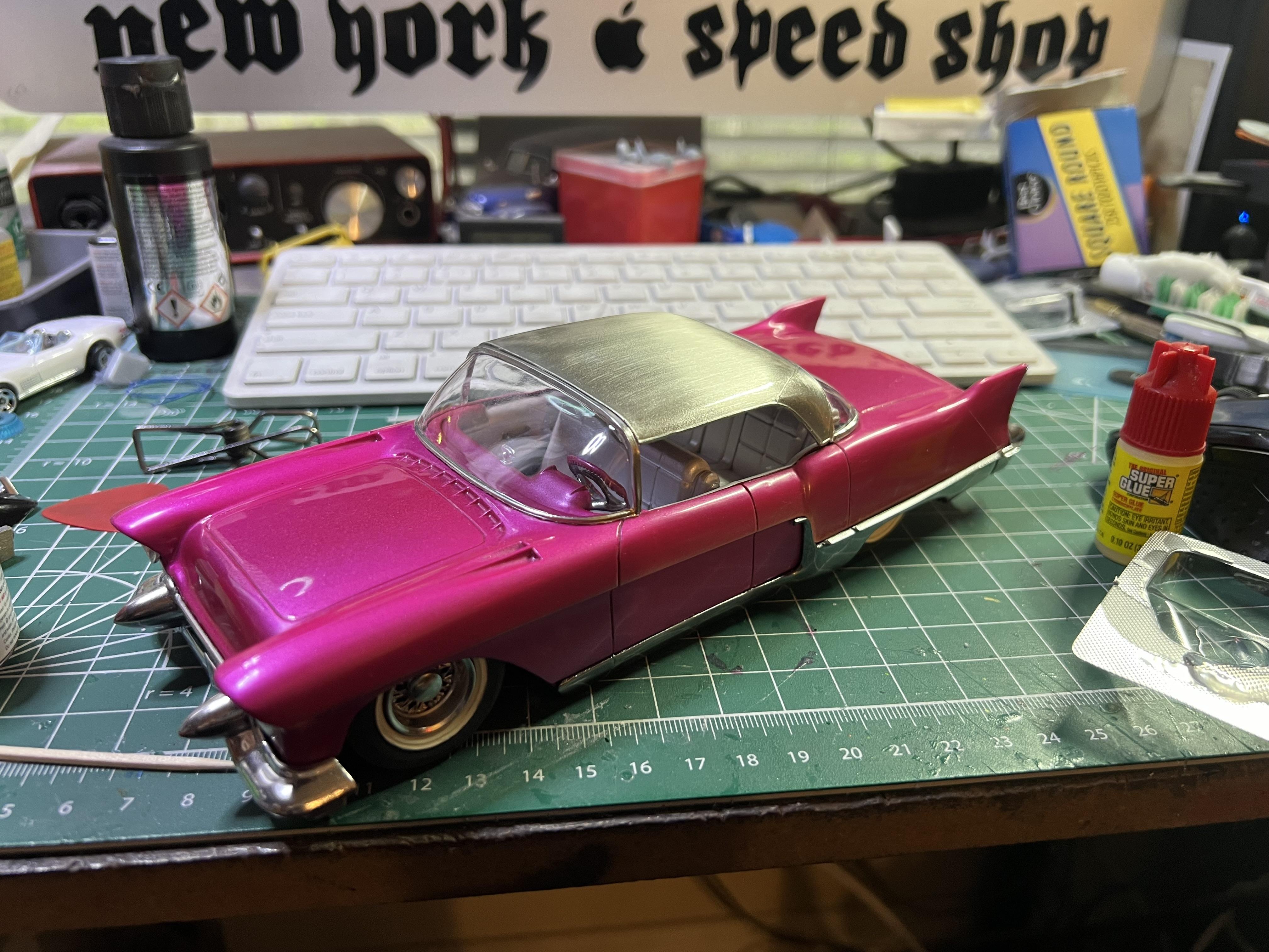

Some paintjobs I did with Pearl Ex…the Caddy shows a color-shifting effect the most obviously, but you can go way more extreme or more subtle depending on the number of layers and the intended effect…
