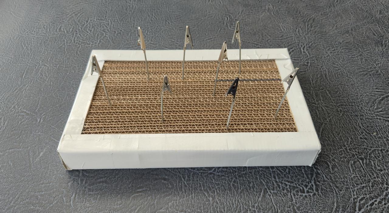

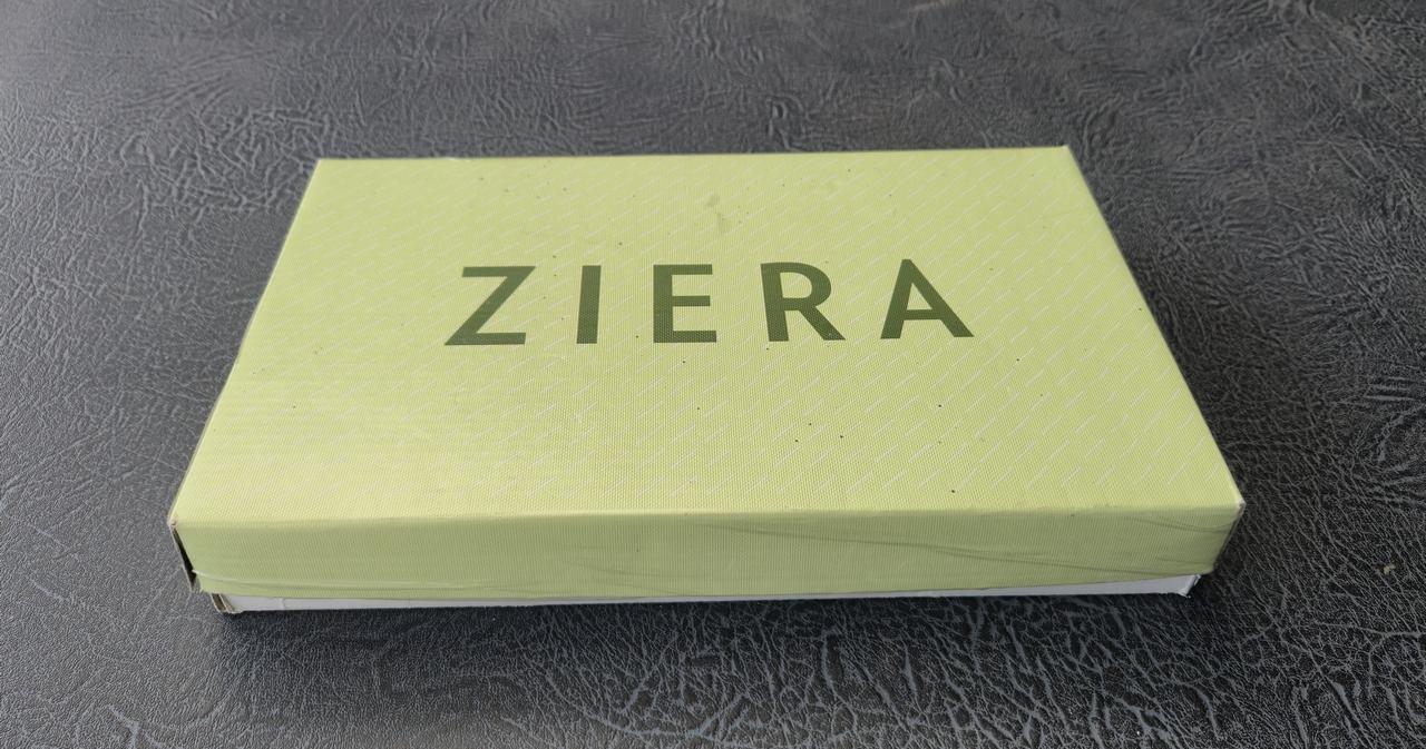

Chris B Posted Tuesday at 08:53 PM Posted Tuesday at 08:53 PM (edited) I saw something like this on a YouTube clip the other day and it got me thinking. I rummaged through the local supermarket cardboard box pile looking for a suitable corrugated cardboard box with suitable sized coronations (With there permission of coarse) I cut strips using the width of a steel ruler to get all of the strips the same with an hobby knife cut them all the same length to fit into an old shoe box that a model kit came packaged in that I had brought online. Once I had enough of them I glued them all together with PVA glue. I cut the shoe box down to the desired height and then glued the stack of cardboard into the box and folded the top of the box down to form a frame. The lid still fits the box to protect the coronations when not in use I think I have got a pretty good useful clip holder for next to nothing the only thing that cost me anything was the PVA glue and I brought that over 20 years ago Edited Tuesday at 10:04 PM by Chris B 4
iBorg Posted Tuesday at 09:32 PM Posted Tuesday at 09:32 PM You can also find similar corrugated in pet stores as cat scratching posts. 3
NOBLNG Posted yesterday at 07:43 AM Posted yesterday at 07:43 AM I’ve made a bunch of them the same way, but only about 4”x5”. That way they fit in the dehydrator easily. Scratching posts might have catnip in them so if you have cats it may not be a good idea. 1 1
Bainford Posted 22 hours ago Posted 22 hours ago Neat idea. Better then the block of oasis (green foam block used by flower arrangers) that I currently use, which makes its own crumbly dust. 2

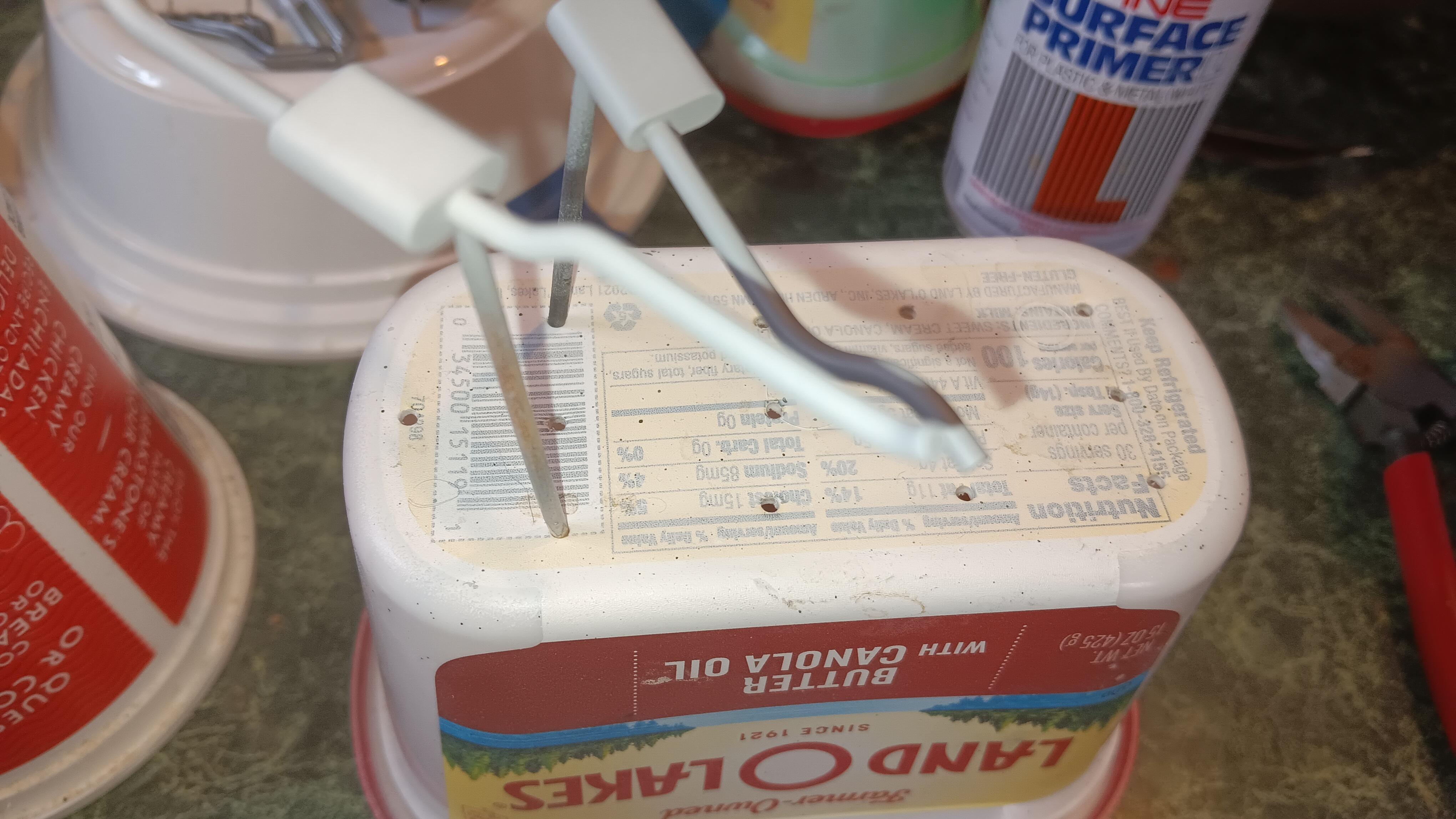

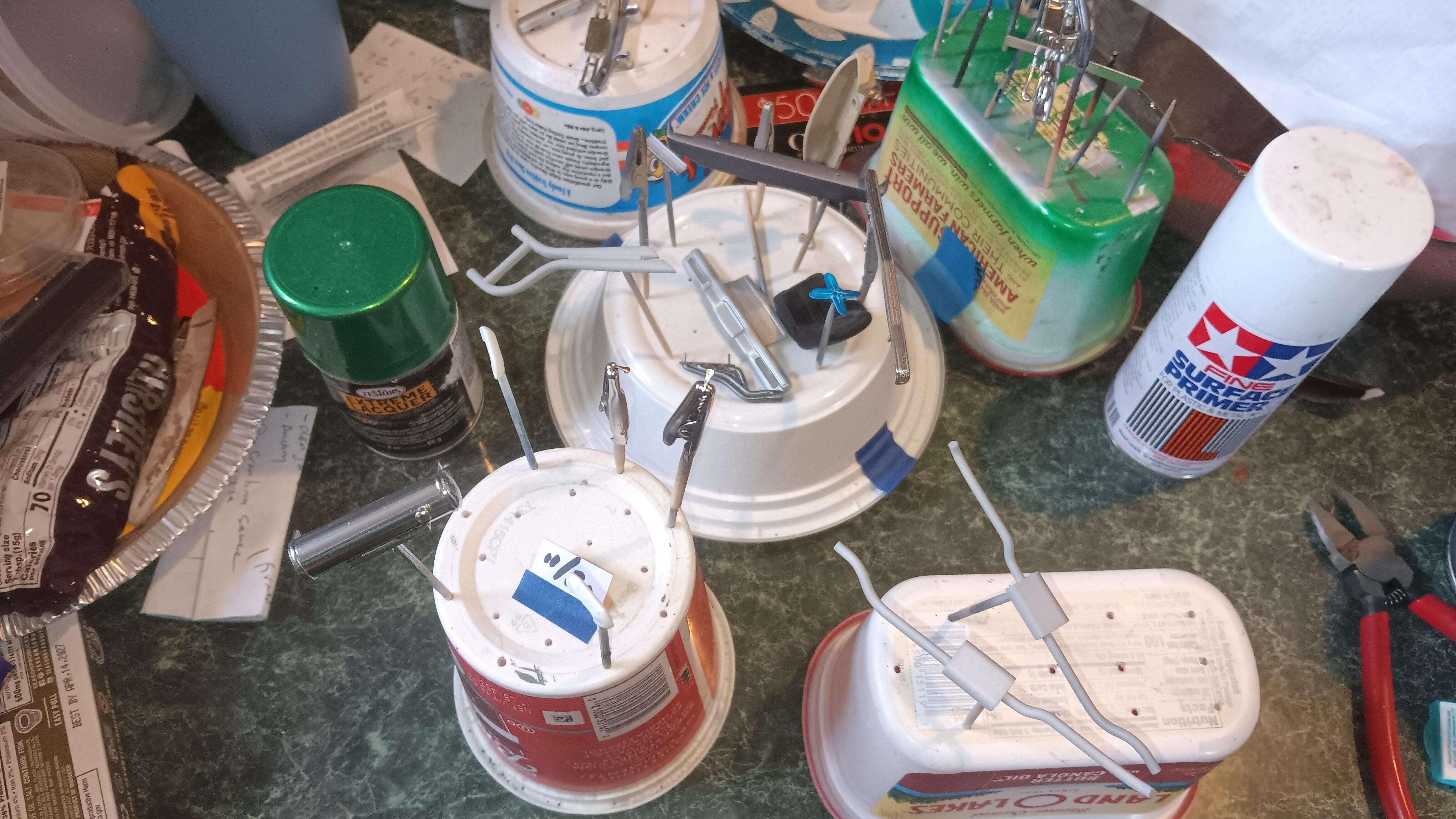

bobss396 Posted 21 hours ago Posted 21 hours ago I use old butter tubs turned upside down. I'll take some pix later. I tape the lids on, hot melt something inside so it won't tip over or have the wind take off with it. I poke holes in the bottom and use toothpicks to hold the parts. 1

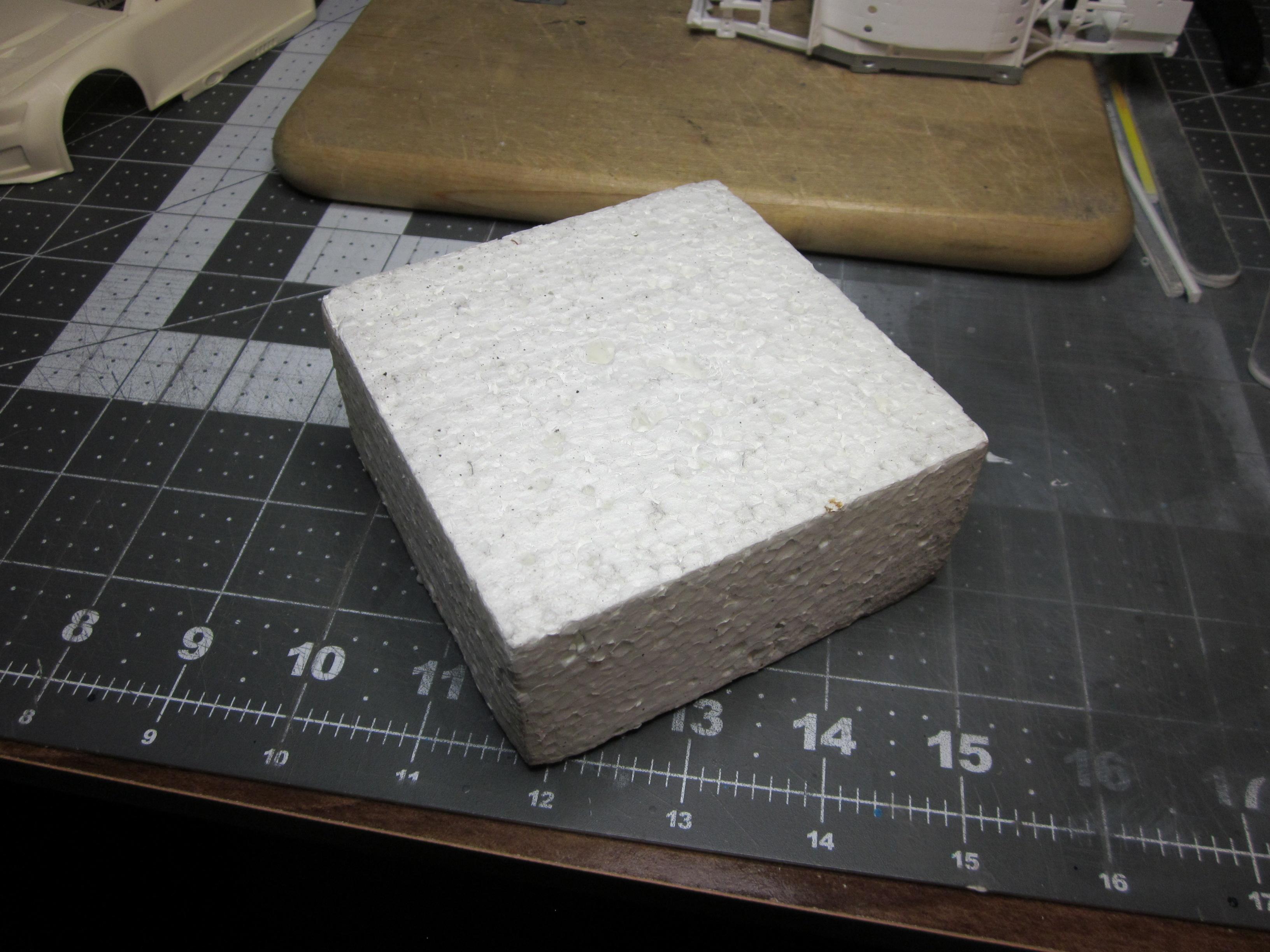

Speedpro Posted 17 hours ago Posted 17 hours ago Some good ideas here. I use these foam blocks that are used in packaging. They last a long time and you can use any size diameter part holder. They measure 3 3/4 x 3 3/4. Sounds small, but they hold alot of parts 1
Chris B Posted 16 hours ago Author Posted 16 hours ago 11 hours ago, NOBLNG said: I’ve made a bunch of them the same way, but only about 4”x5”. That way they fit in the dehydrator easily. Scratching posts might have catnip in them so if you have cats it may not be a good idea. My dehydrator is a good size, I did think of that and checked before I got too far to check that it would fit
Chris B Posted 16 hours ago Author Posted 16 hours ago 5 hours ago, Bainford said: Neat idea. Better then the block of oasis (green foam block used by flower arrangers) that I currently use, which makes its own crumbly dust. And they wear out with time
bobss396 Posted 14 hours ago Posted 14 hours ago I had a butter tub with a wire handle on it. The handle allowed me to place it in the dehydrator very easily. I'll have to make up another one.
