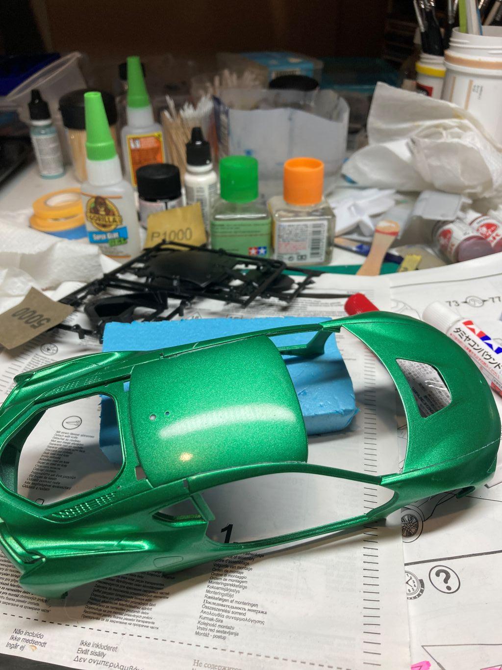

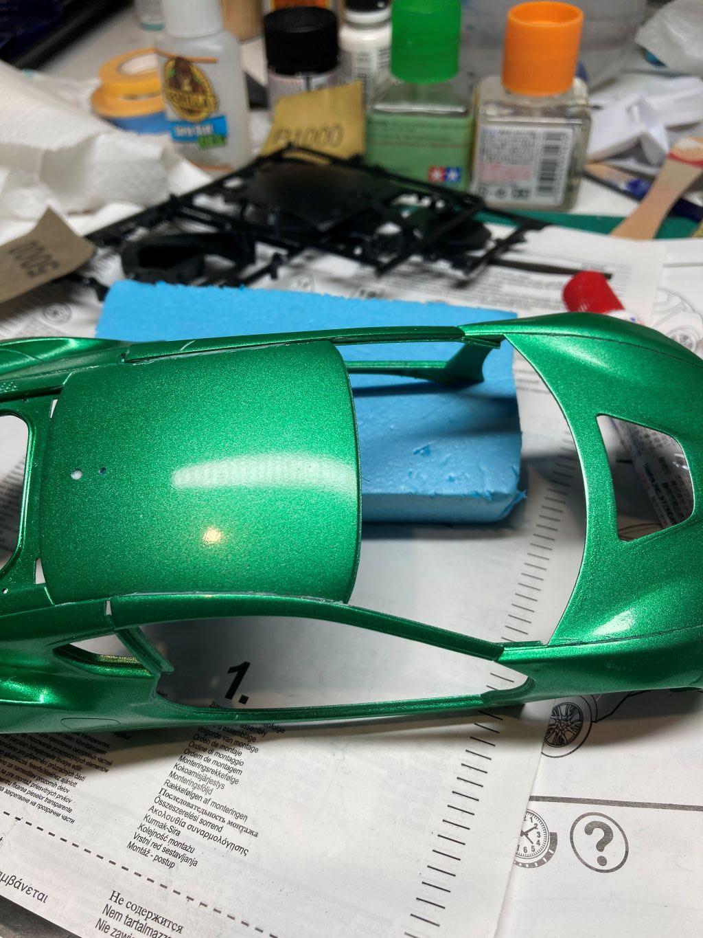

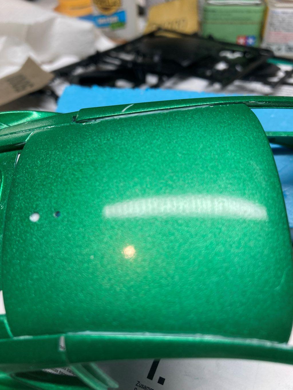

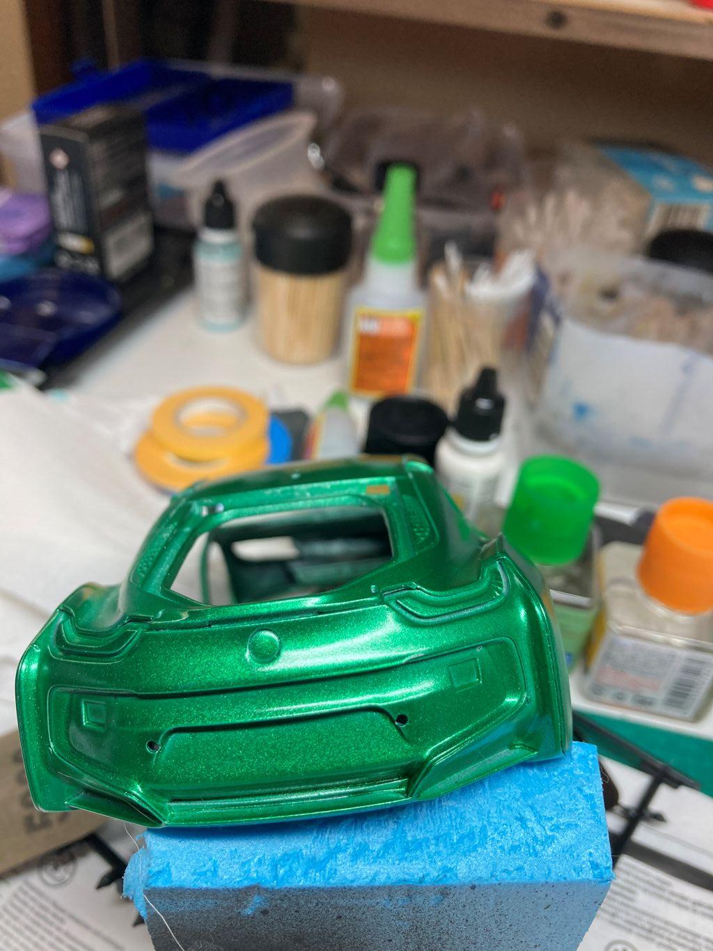

Donny Posted 12 hours ago Author Posted 12 hours ago Here is what it looks like. Some things to fix, but basically this is what the paint looks like. Don 1
johnyrotten Posted 2 hours ago Posted 2 hours ago (edited) That doesn't look bad at all Don. Personally I'd clear it and polish it out. I bet that would polish as it sits. Edited 2 hours ago by johnyrotten 1
