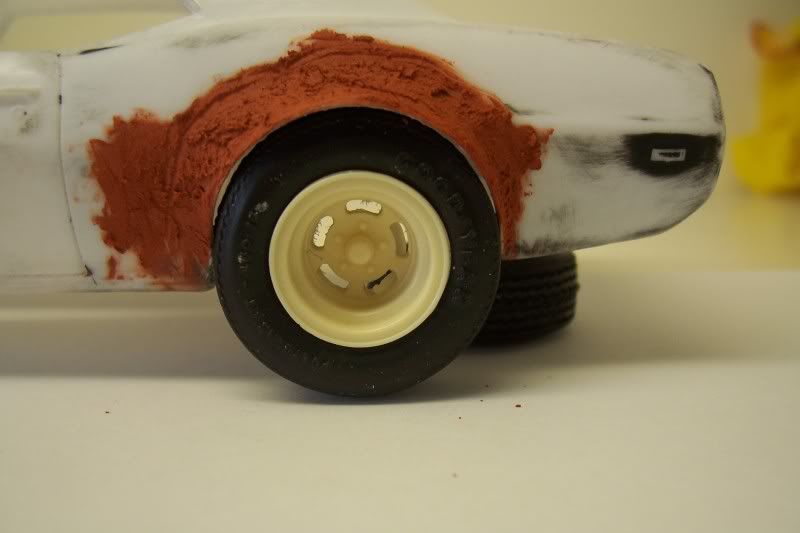

loudcherokee Posted June 29, 2009 Posted June 29, 2009 I also use the red stuff, Bondo glazing and spot putty. Works great, and can be sanded smooth for nice contour lines and filling lines. I also agree with laying it on thin, or it will crack. I'd like to add an additional tip for this putty. When you use it, be sure to squeeze some out on a "palette" or old tupperware lid. You may see some watery substance come out, and then the thicker putty. MIX THIS WELL! If you dont mix it up on your palette, the putty can attack your plastic and actually melt it. I used the bondo here for these fender flares - Hope this helps. LC
